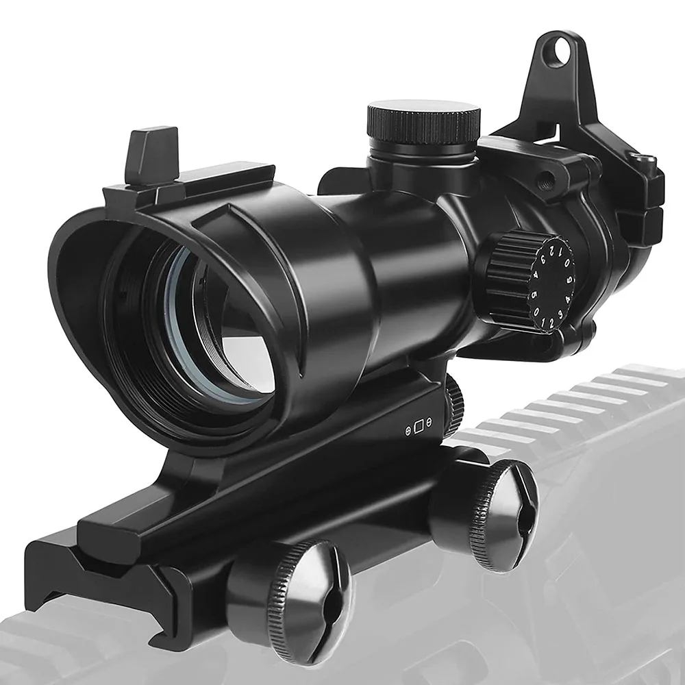

Fake ACOG
https://www.aliexpress.com/item/1005005265940373.html?spm=a2g0o.productlist.main.17.71047WdW7WdWfv&algo_pvid=11c2d956-f540-4e95-a2a5-53e562b6628e&algo_exp_id=11c2d956-f540-4e95-a2a5-53e562b6628e-8&pdp_npi=3%40dis!AUD!89.22!44.61!!!!!%40210219c216874282734483843d0777!12000032415327483!sea!AU!2489966829&curPageLogUid=Qz41TCnuEM1n
Fake 3x

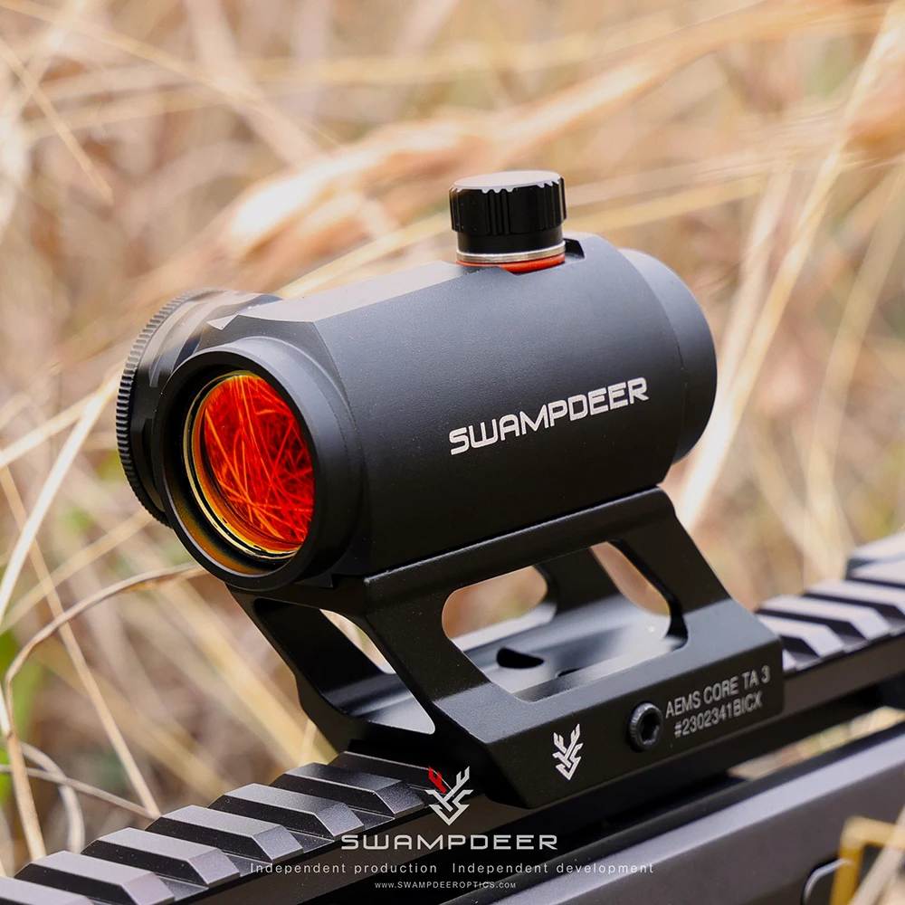

Fake Micro RDS
