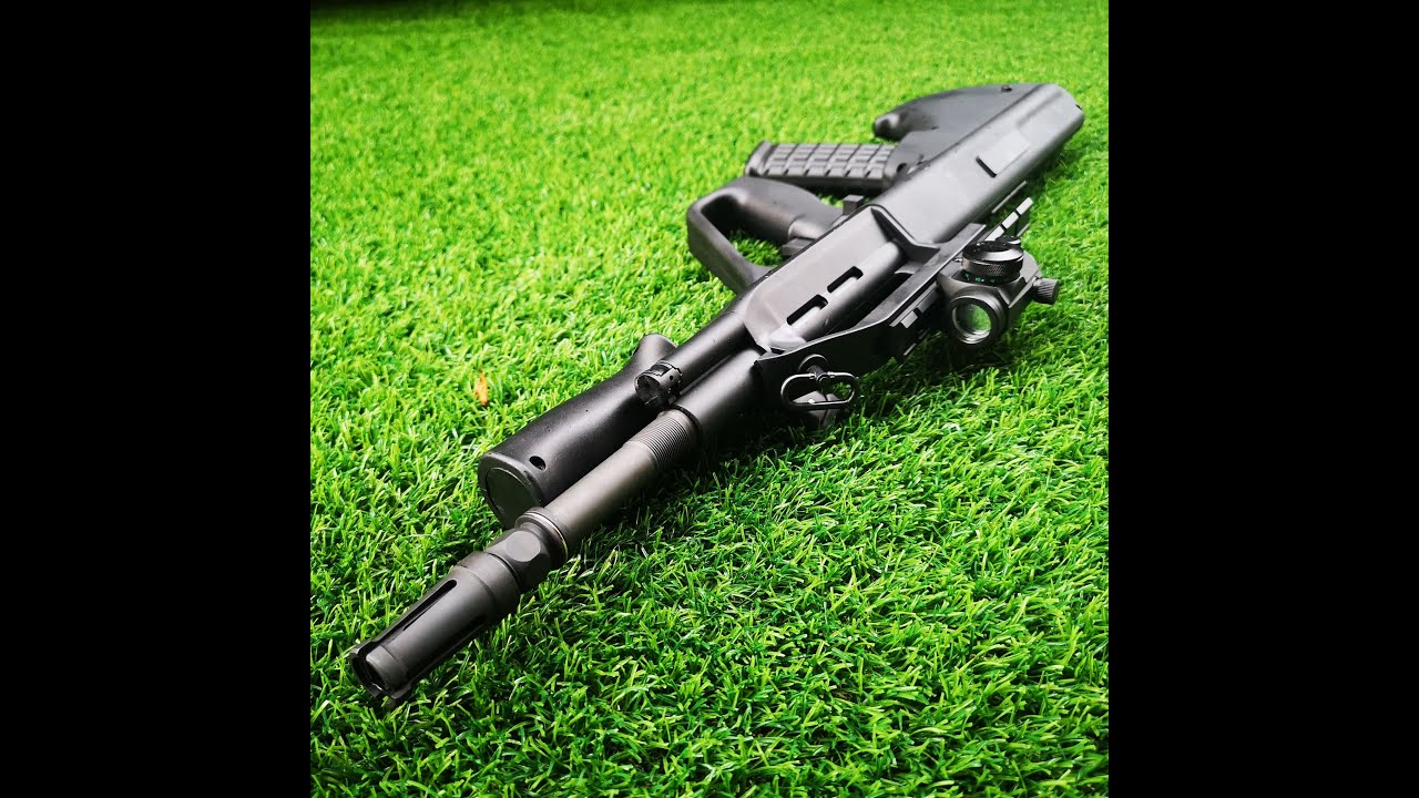

Hi , just purchased a LH aug and was wondering what gear box parts are compatible, gears , plunger, cylinder, ext ext .
Should take just about any standard part except trigger and maybe motor.
Someone who knows more about them should show up soon thou.
Just about to build my second LH AUG… Gearbox wise it’s all pretty much Gen 8. I think the nozzle is proprietry, can’t remember from my first build although it looks Gen 8. The t piece is definitely proprietry.
I just bought one too and when it gets here it’s getting a 460 short shaft high torque motor, metal gears, stronger tappet spring, 100% cylinder, upgraded cylinder head and nozzle, good ol’ greenie o ring, M100 spring, alloy IB, and a steel shorty outer barrel. Plan to run it on 7.4v lipo, not looking for high ROF with it. Motor’s only 18,000rpm anyhoo.
If you don’t want to go too far, a 100% cylinder with a better o ring, an M90 or 1.18 unequal spring and an alloy IB should get you around the 270-280 mark.

Afaik nothing is Gen 8 related or fits. It’s a LH V2/V3 of their own hybrid.
Has it’s own specific Cylinder head and nozzle which is hybrid. Aluminum was available and made a huge difference out the gate so try find that. I had a look on ebay not there anymore, might find on Ali. Usually blue anodized.
You’ll want one of these LH AUG MOSFET – MASTR BLASTR he bought a heap going out of business. Easier and quicker than ali. Been ok by the bits I have purchased, poo pooed by some others in the past.
Try and keep to a 1.18mm spring and 2s you’ll have no problems. I went the 2nd fet mod to take the load off the board on mine yet the board still fried due to a meltdown on the mag side of the board which the 2nd fet mod does not cover. ![]()
I have a V3 alloy gb and Aug specific t238 to go in next time it breaks but thus far it has been going ok. On the to do list. No I’m not telling @JazzyWard what colour the GB is or be trying to buy it off me ![]()
Printed t pieces are shit, go with standard. Put a ss 450mm 7.3mm barrel in full cylinder, alloy head and nozzle ,1.18mm, 300fps all day ![]()
