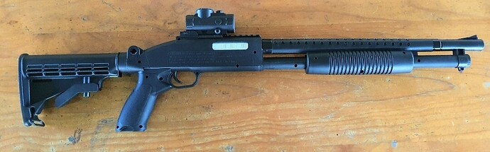

Hanke M97 manual pump action shotgun.
With an M100 spring giving it 300+FPS, an alloy inner barrel, a decent hopup and a restrictor to limit feed to only one gel per pump, it’s one of the most accurate and reliable snipers out there.
Keep in mind that the limiting factor with range in this hobby is the gel itself. No matter how much air you put behind it, it weighs next to nothing and it’s always going to lose impetus after 20 metres or so. :person_shrugging:

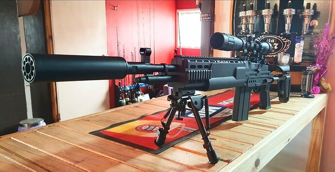

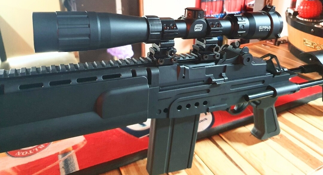

BF M14 EBR, monster modified gearbox in it, very accurate and good range. New units still available too.

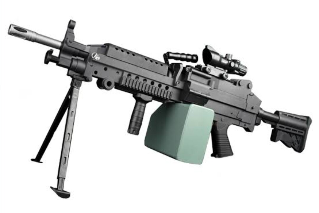

The other good full auto option is an M249 SAW, Minimi. Gen 8 style box that loves upgrades and can be turned into an absolute beast, and a mag capacity that is just insane.
Both cheap, both still available and both excellent platforms for performance upgrades, the SAW being the easiest. :+1:

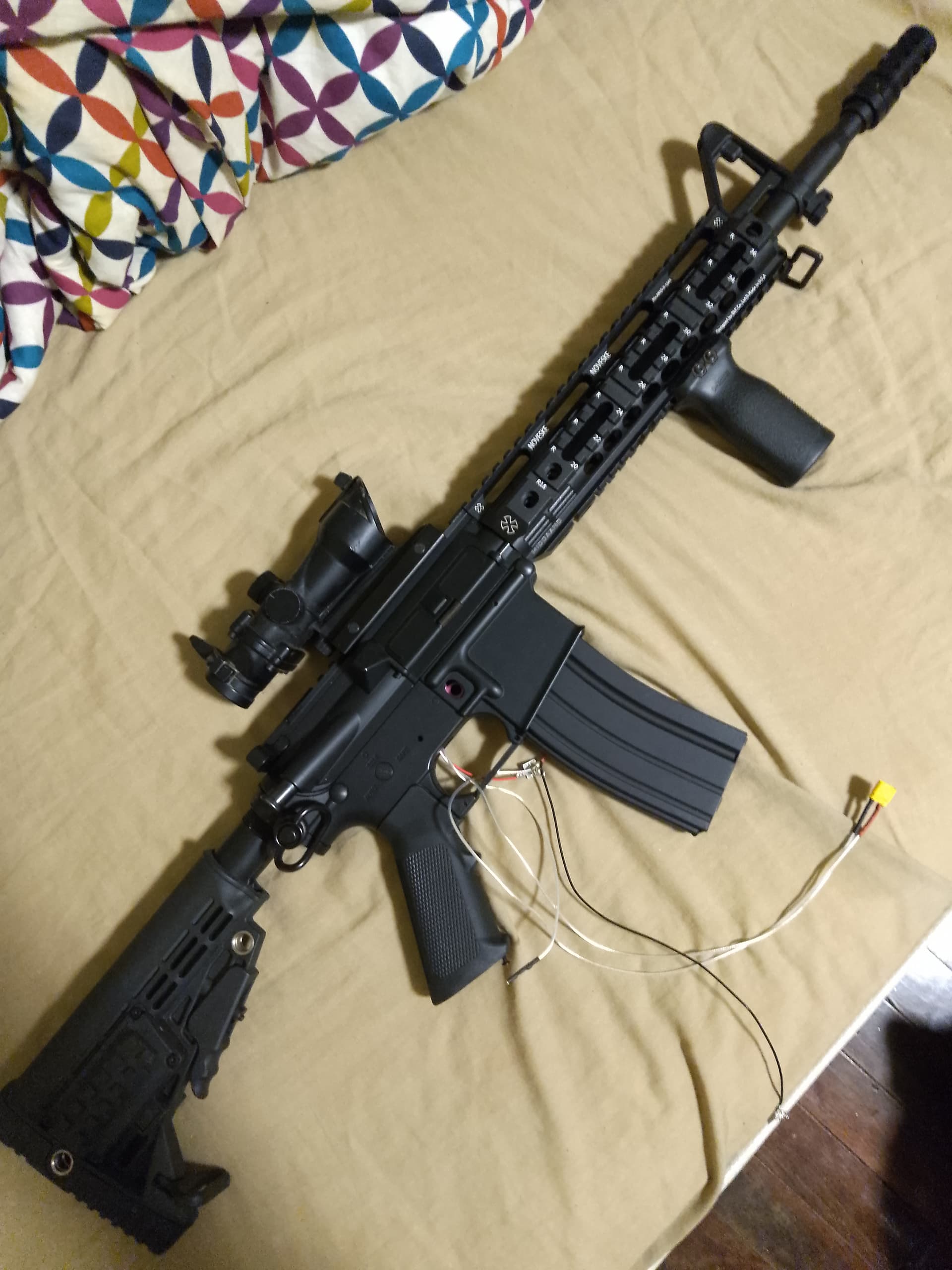

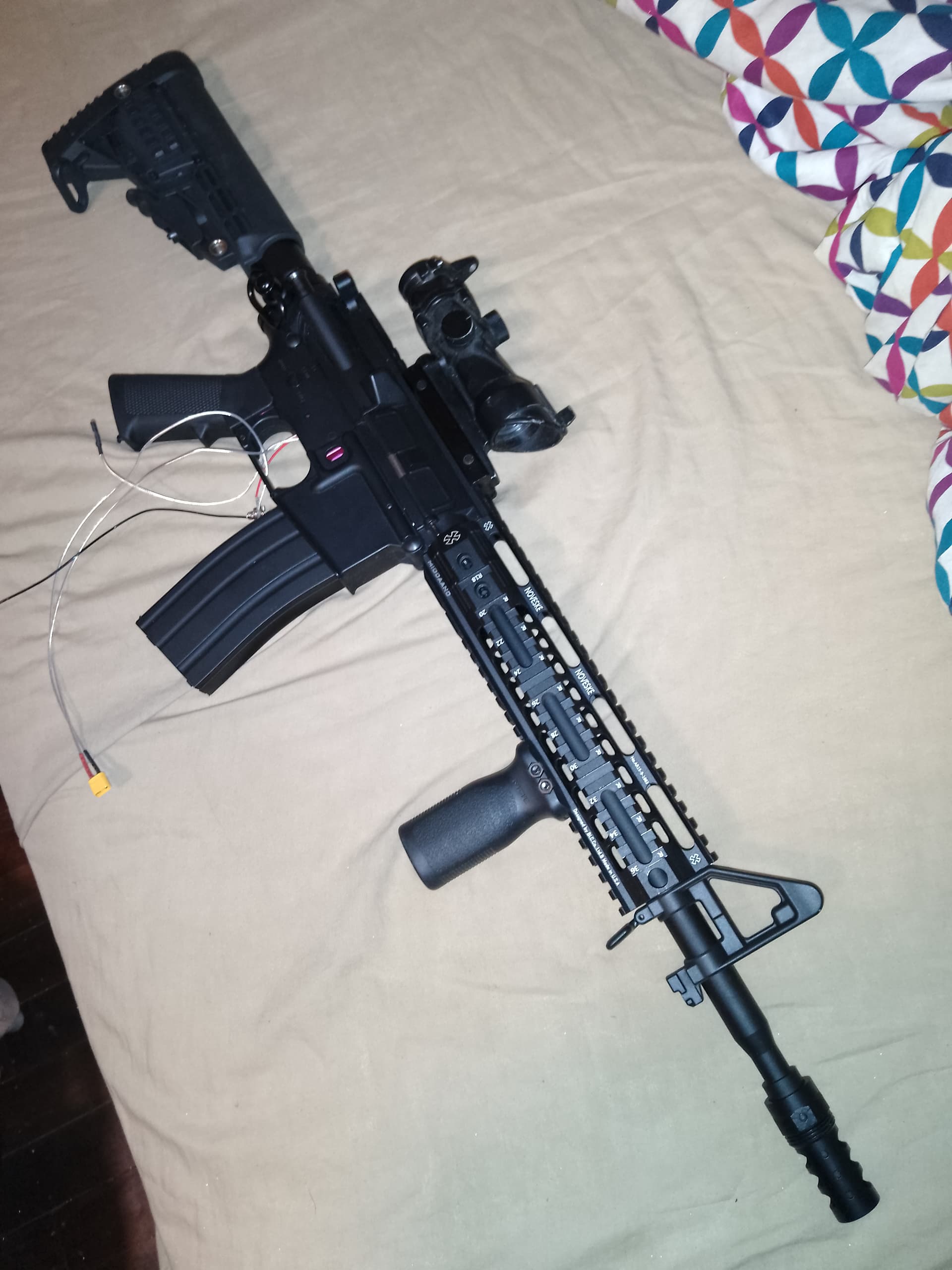

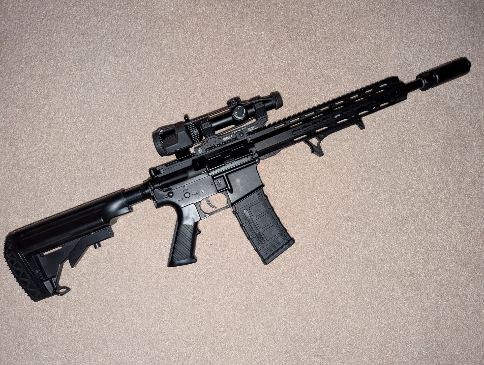

  1. custom built (not an actual) M16.
    This went through originally a gen9, and over time became a full metal blaster with a MK V2M gearbox. 380mm inner barrel. M110 spring, 18:1 gears and a fast motor (can’t remember what is in it it’s had a few!)
    380fps 25rps. It has just been a good long range blaster, they sail well and always raise eyebrows for the range.

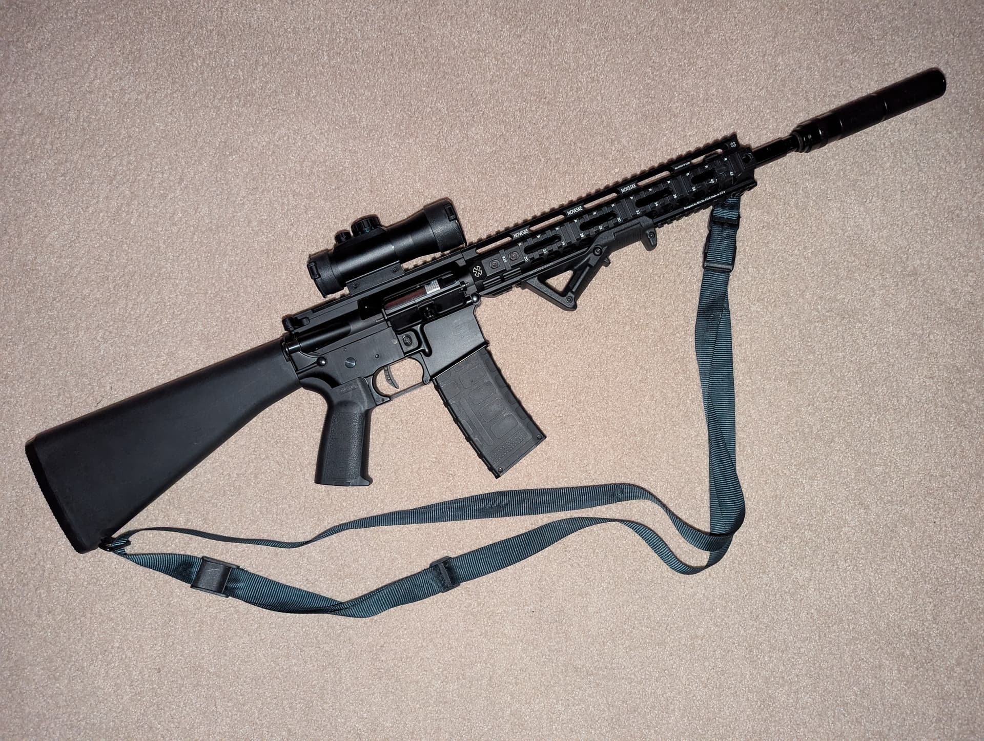

Building a solid metal M4 definitely allows for a VERY solid handguard/inner/outer barrel setup, along with plenty of options for the required barrel lengths through the endless possibilities of accessories available for these particular models. :ok_hand:
I can’t remember the length of the barrel that was in this one, but I think it was a 400, finishing about halfway into the flash hider.
Shorter handguard than yours Rok, but around the same overall length with the triangle sight and tapered outer barrel.:thinking:
