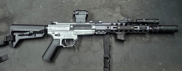

According to my Chinese friends, RokSolid here has the gen 1 version made by an unnamed manufacturer who has since disappeared off the market. Later, Ku Wu Ji made the gen 2 and then gen 3. The gen 2 had a bunch of problems which got fixed in the gen 3 but still has some problems and “special snowflake” features you have to deal with. For example the battery terminals are soldered the other way around and use a special 3D printed base. Mags also need to be slightly dremmeled for a reliable feed. I gave up and just handed mine over to our team tech to assemble as I have no where close to the amount of skills needed to put it together.
Mine with nylon receiver
