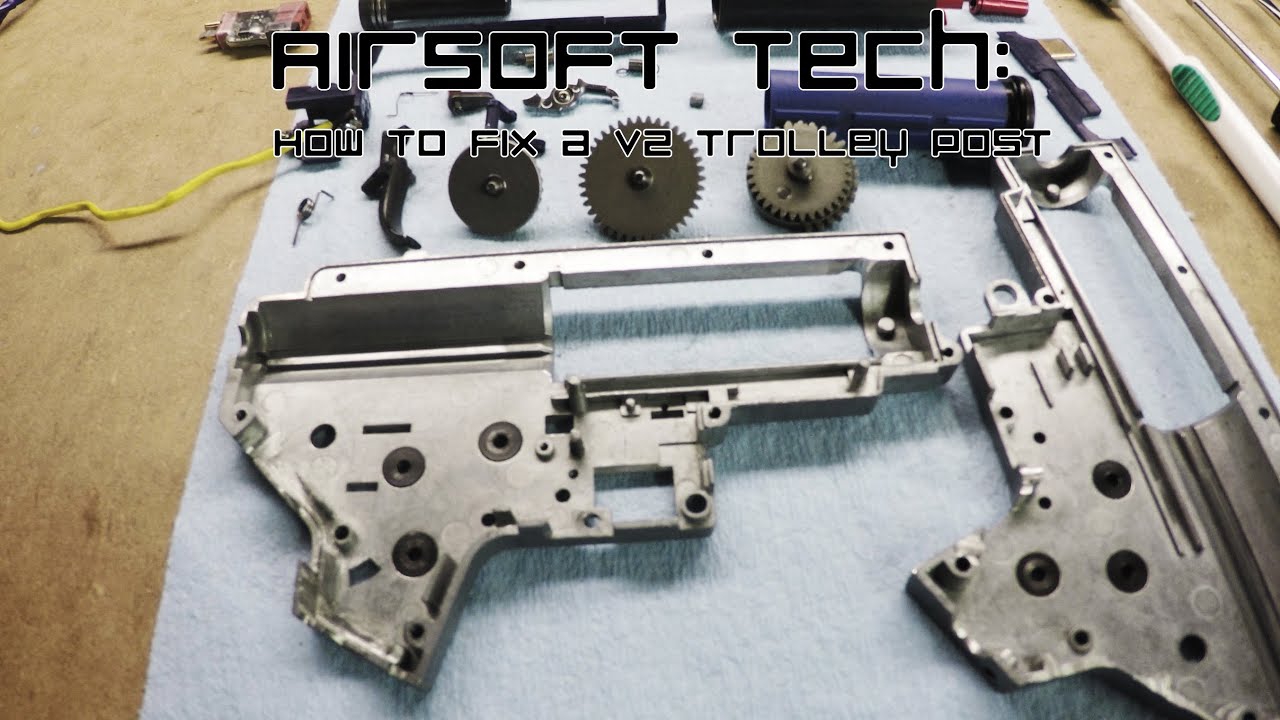

Basically these areas circled show the trigger trolley return spring, and hidden underneath the gear wheel behind it is a small metal lever that switches the trigger block between semi and full auto.
I’ll try and dig out a gearbox to take some proper pics of the parts that @DChapo mentioned in the comments above :+1:
is it the black part behind the trigger? so the cutoff lever?
EDIT (i took this pic from a youtube video bcs i dont have the proper tools to disassemble my blaster lol)

Yes that’s the cut-off lever right there, which may have come loose/, out of alignment, or the trigger block spring possibly as well… which is what @DChapo was commenting about :+1:
It has that tiny little spring just visible that connects with the selector lever plate, and it’s very easy for them to become dislodged, the same with the larger trigger block spring next to it😒

Sorry yeah I meant the cut-off lever, not deselector.
SLR gearboxes are apparently notorious for having issues with the cut-off lever, or the early ones at least, not sure if they fixed it in some of the later units.
That and the trigger itself were a bit funky in them, the trigger was slightly shorter and weren’t always engage the trigger switch properly but would usually happen in conjuction with the cut-off lever issue.
That’s the only issue I’ve ever run into with my SLRs at least.

There are JingJi specific triggers that have a longer tag that interface with the trigger switch to prevent the slipping issues, they must have the trigger sitting lower in the box than others or something.
You can replace the cut-off lever with a metal one, the stock was plastic from memory so might be prone to bending or warping.
Just had a thought they maybe the trigger spring has popped out of it’s setting off the pull is suddenly lighter. Usually if the cut-off is the issue it doesn’t reset the trigger switch on semi and it clicks when pulled but you can fix it by shooting in full auto a bit and forcing a reset.
