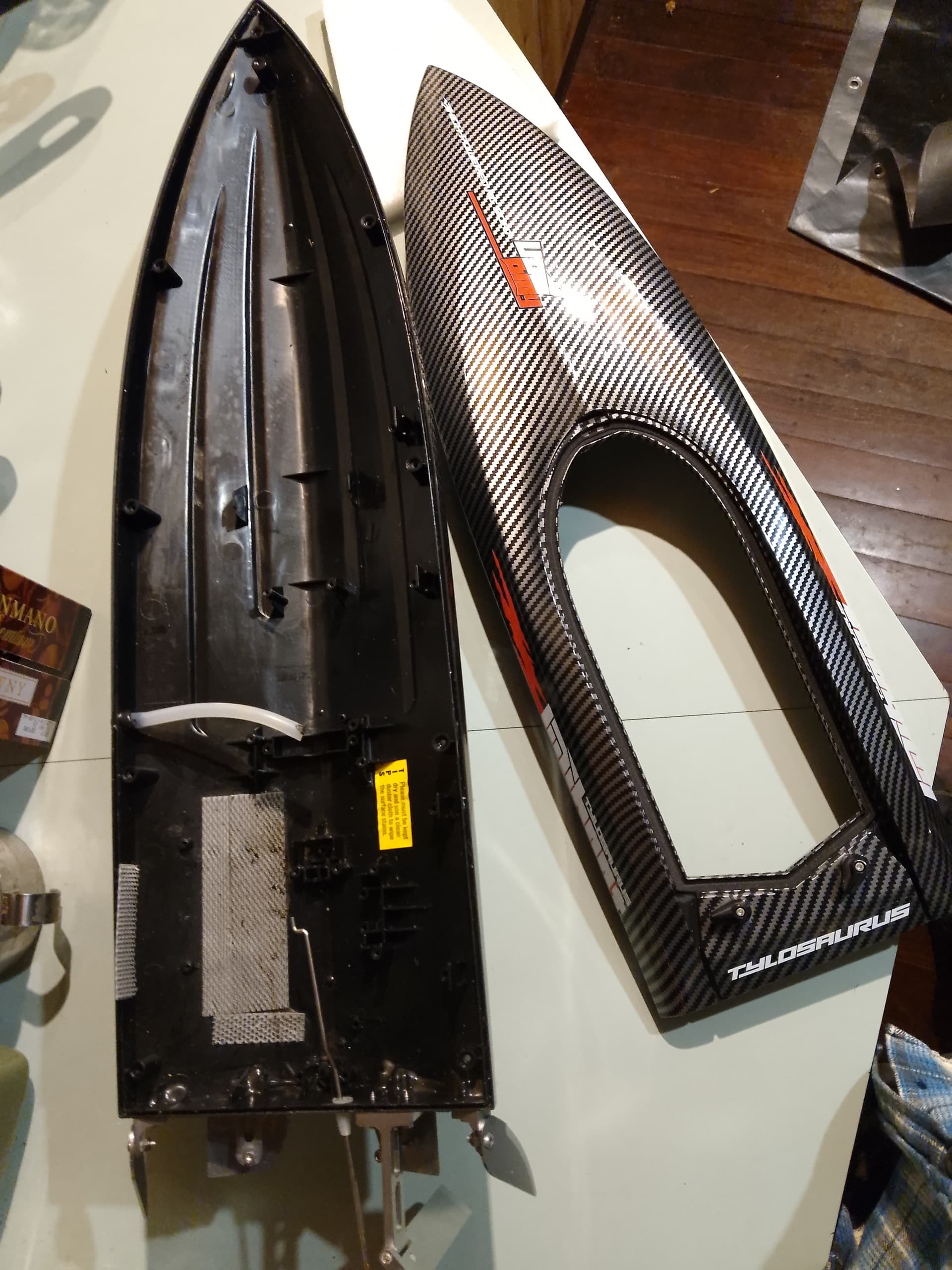

Pushing on through the next few builds to get my RC Speedboats to survive the Modifications that I’m hammering into them! :joy:
I’m loving the fact that the UDIRC boats allow you to “split” the product, the same as pulling apart Gelbaster bodies and Gearboxes to do shit that shouldn’t be done! :rofl:
Got plenty of modifications planned, and am taking into account COG and multiple other mechanical/physics calculations into effect.
Basically remove all of these parts and castings that are in my way to achieve the modifications that I’m looking to achieve.
Looking to mount the ESC, Reciever in the original Battery position, Epoxy the new Motor Mount much closer to the Stern, and then calculate and use the centre of the Hull to install the batteries to be able to play with CG fore and aft, along with getting the associated weight down as low as possible within the Hull. :ok_hand:
Just loving the fact that these particular models are designed pretty much the same as Gelblasters, in the sense that they are designed to be able to “split” the components to be able to work on them, not one piece moulded products that are impossible to work on. :ok_hand::clap::tada:

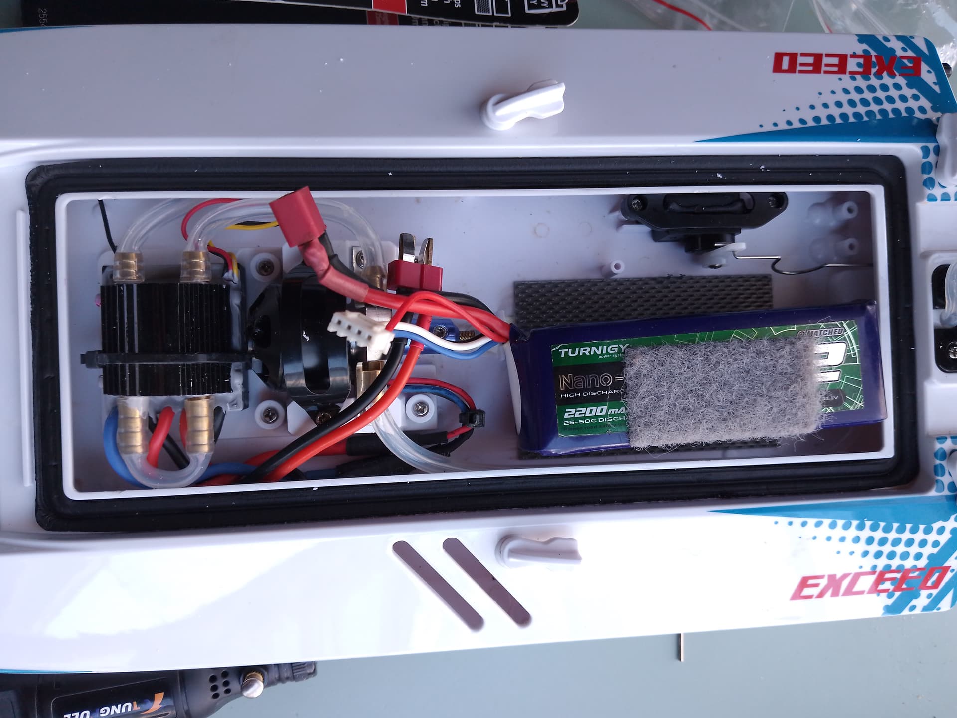

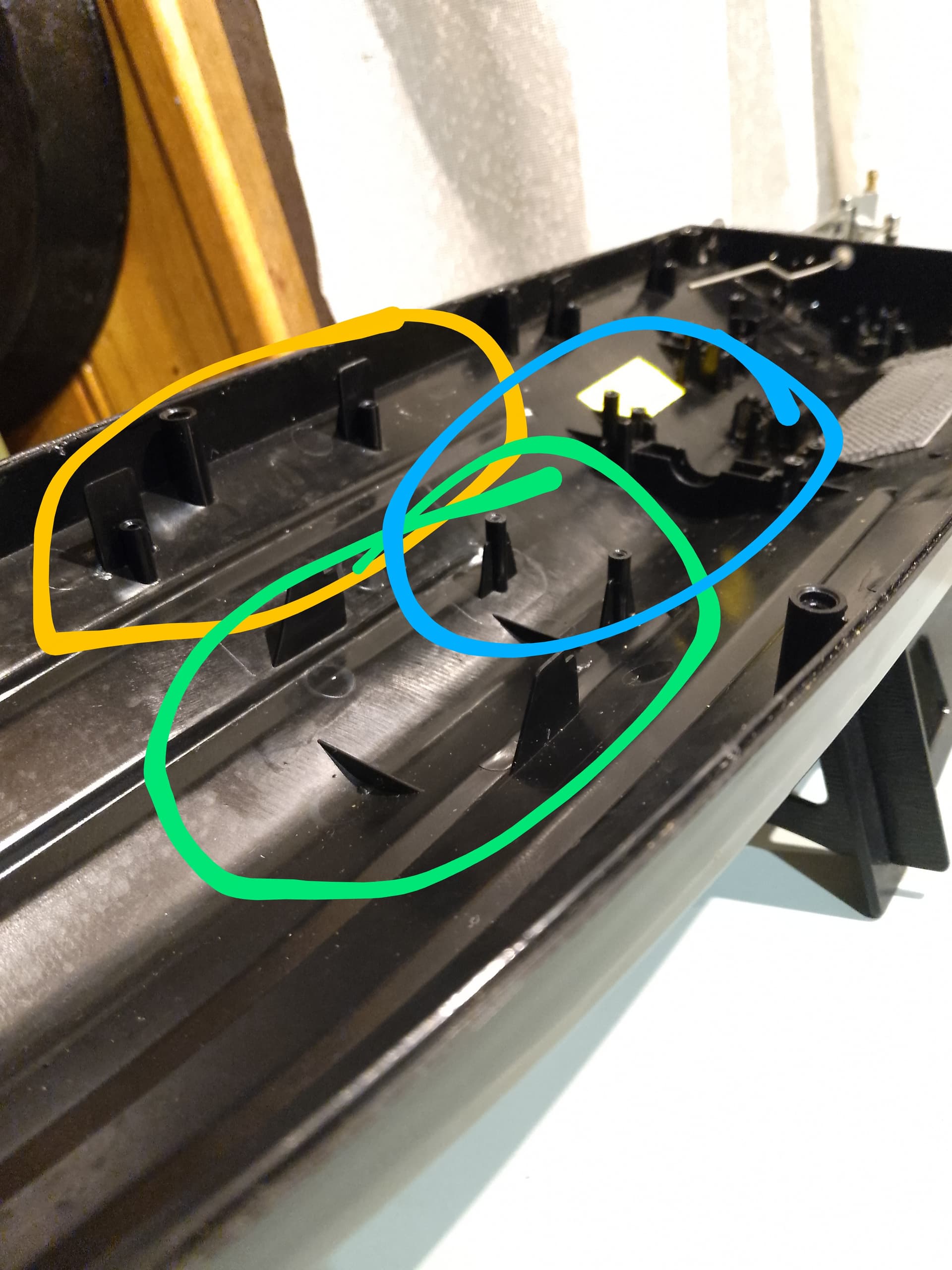

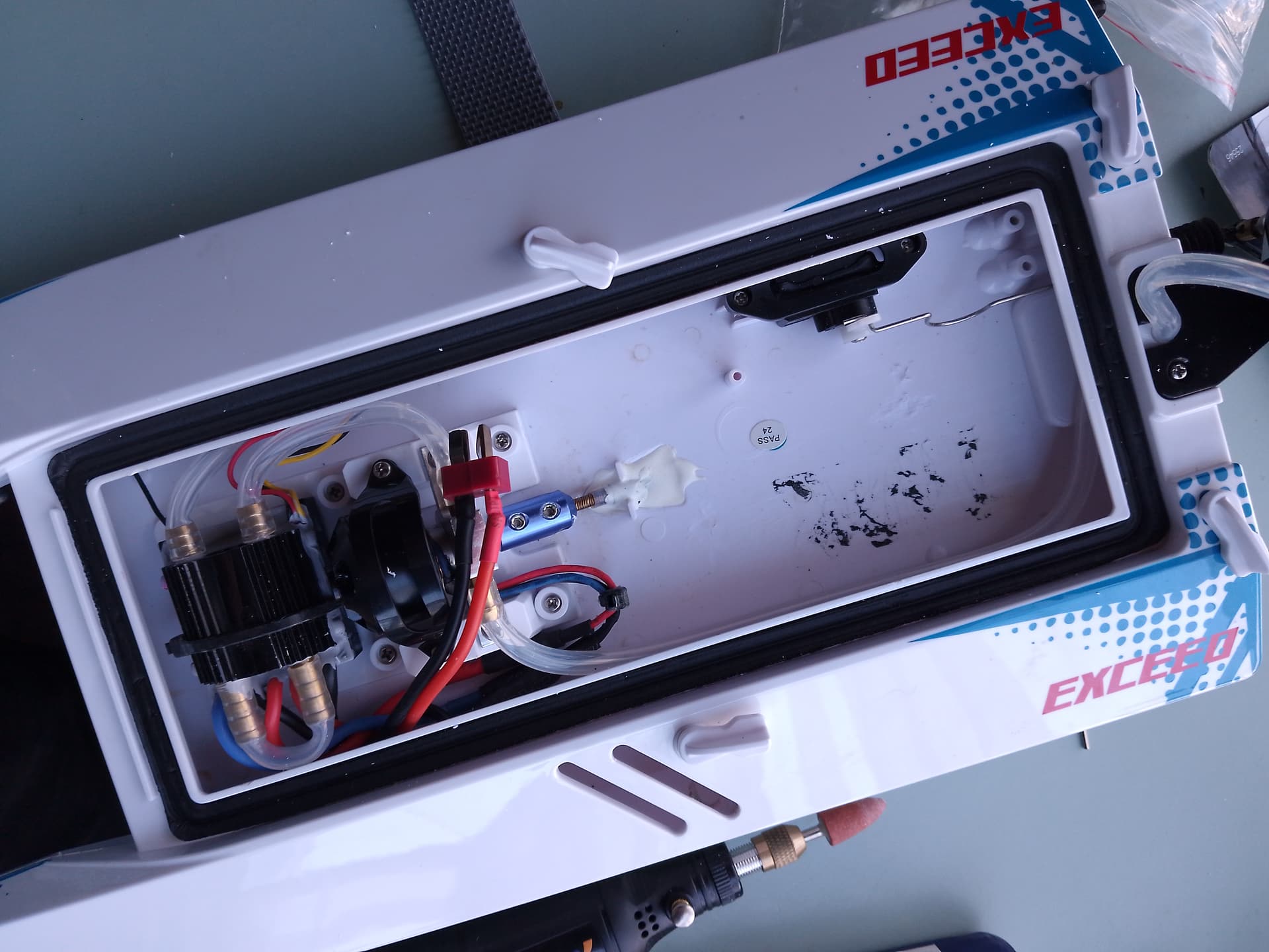

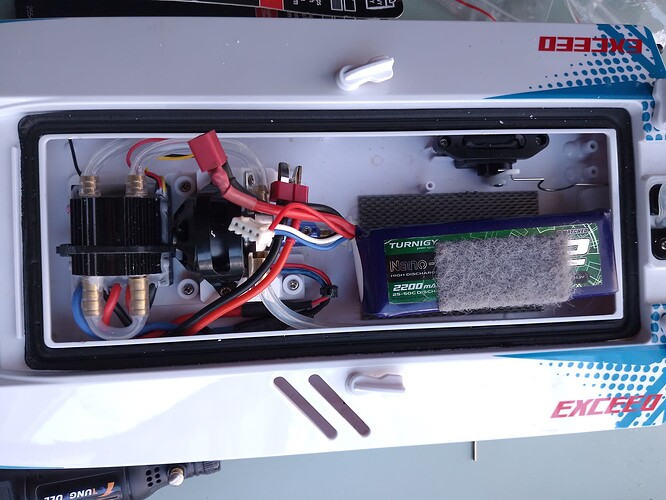

In typical Docs Mods fashion, tore into it with the cordless tools straight away, removing the stock battery locking Post and other moulded posts that wouldn’t allow me to run my larger sized 2200mAh 3S batteries over the stock 1200mAh 3S units…,…for now :wink: as already have 4S batteries that were ordered to squeeze into this little puppy for future performance upgrades.
Now you see them…
Now ya don’t!

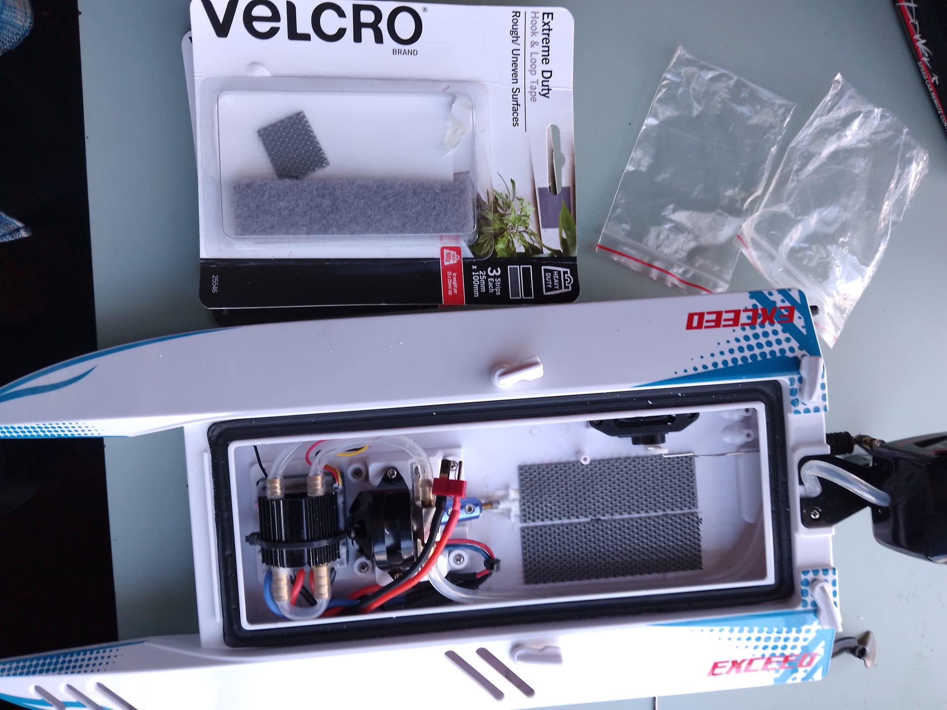

Apply my standard high strength Velcro and Voilà, can fit whatever is required and move shit around to adjust the weight and balance in the Hull for the best handling characteristics. :ok_hand:
Has a tiny 30A ESC and pissy little Motor, so that’s the next on the “to do” list to replace with MOAR POWER!
Have already done plenty of research on the mods that the Mad Asian Race Club members do to get these things absolutely ripping, so plenty more fun to be had yet! :raised_hands:

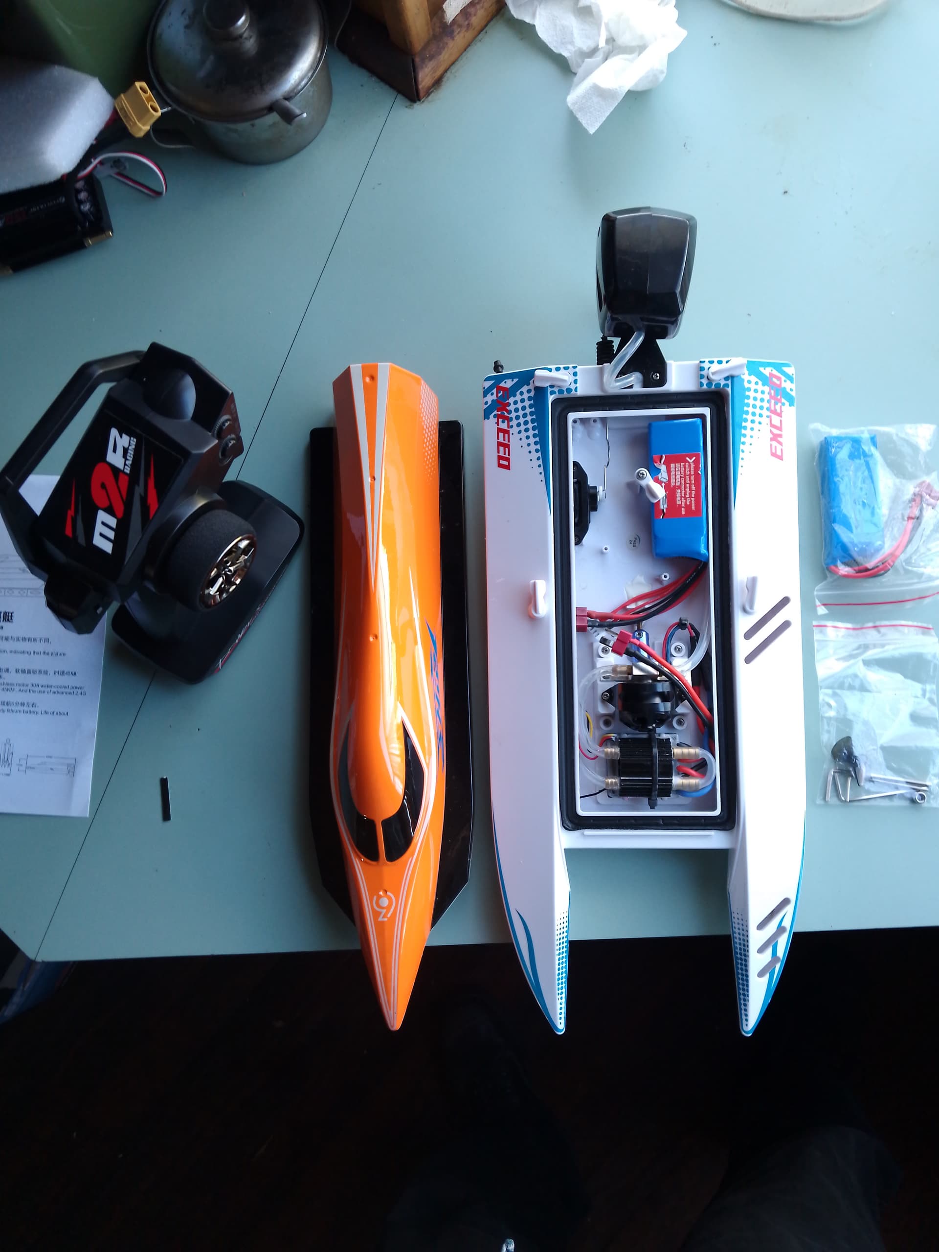

Must admit that the stock 25-30kph speed is a little timid after running all the other Speedboats, but it’s still great fun, unpredictable as hell just like the Mad Flow Tunnel Hull, but at much slower speeds and less resultant carnage. :stuck_out_tongue_winking_eye:

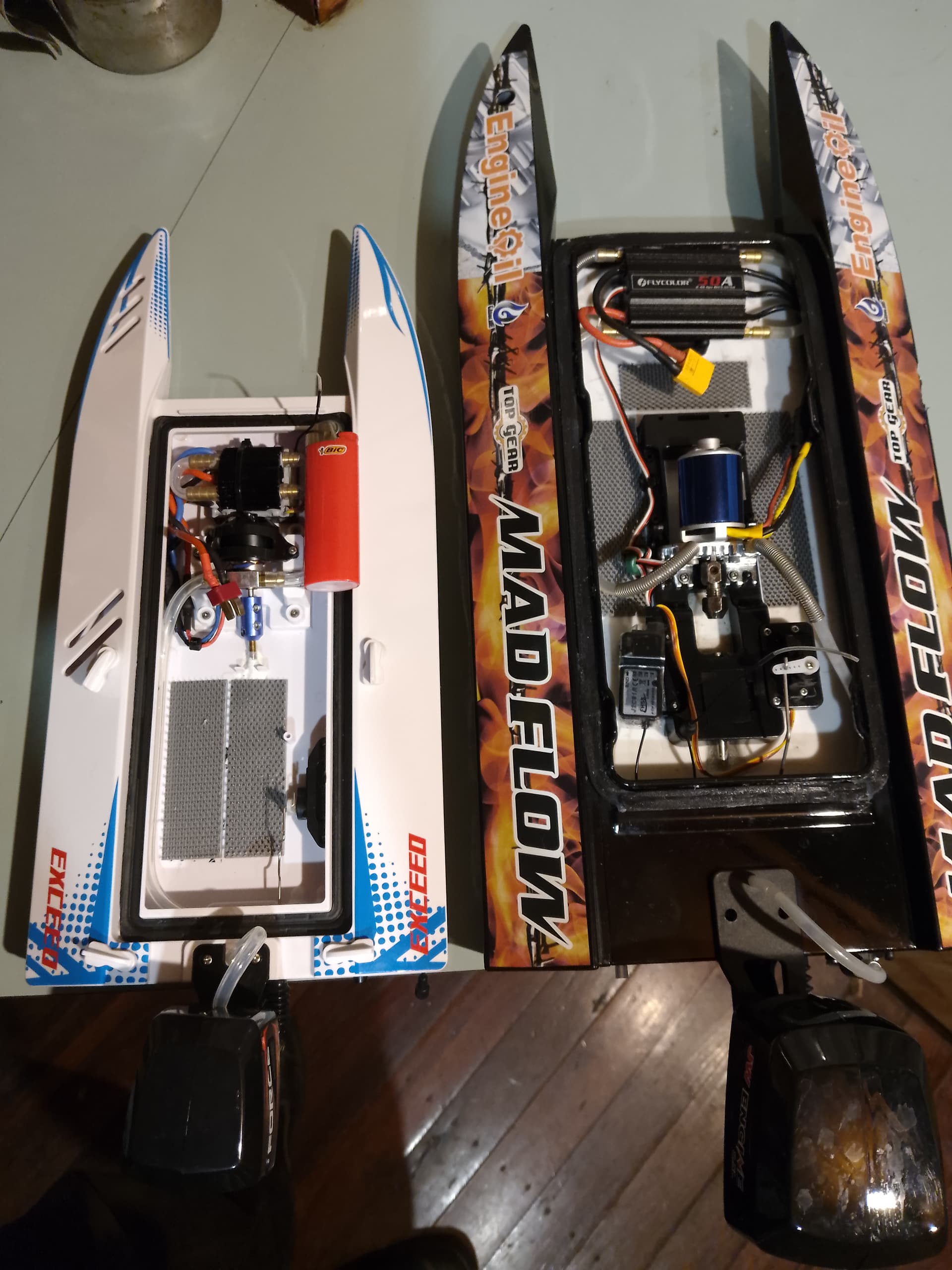

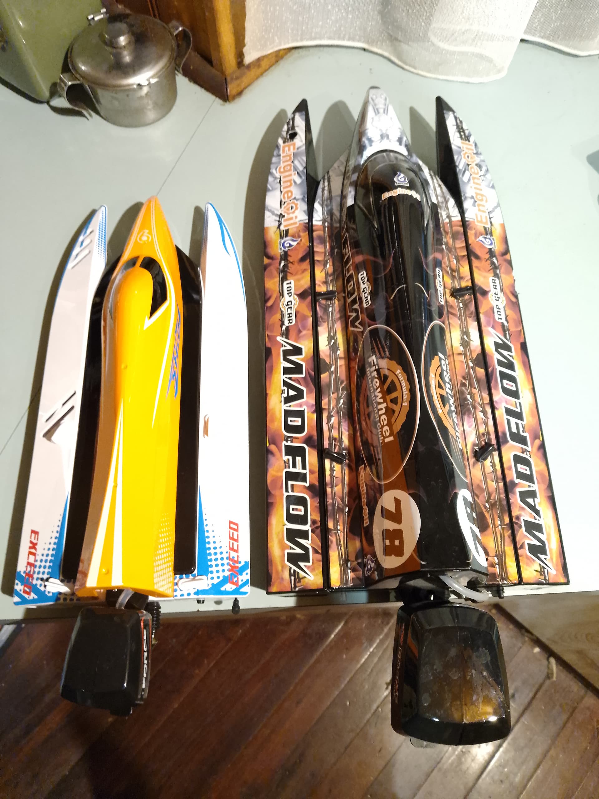

The not so obvious issue here is the much smaller size of this model…
…and resultant lack of workspace for upgrading the internals, especially when you put it alongside the Mad Flow, it becomes obvious pretty quickly that there aint much room for go-fast gear. :thinking:

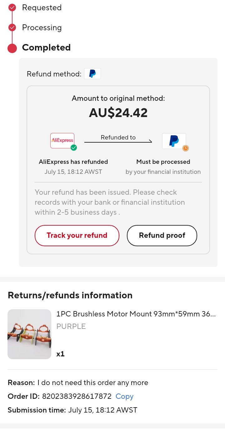

Problem is that even though you select the specific parts in the list available when purchasing those products, it’s not until AFTER the payment has gone through that the glitches appear in their online ordering systems where the parts that you ordered come back as a completely different sized product on the order confirmation receipt. :face_with_symbols_over_mouth:
Gotta check the details after EVERY single purchase to ensure that the items you select at the checkout actually match the the items that have been verified in the order. :face_exhaling:
Have ordered and immediately "refunded about 7 items in the last 12 hours, then having to find other suppliers where their product selection at the checkout actually matches the items that you have selected.

Class example of cancelling orders.

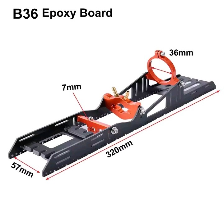

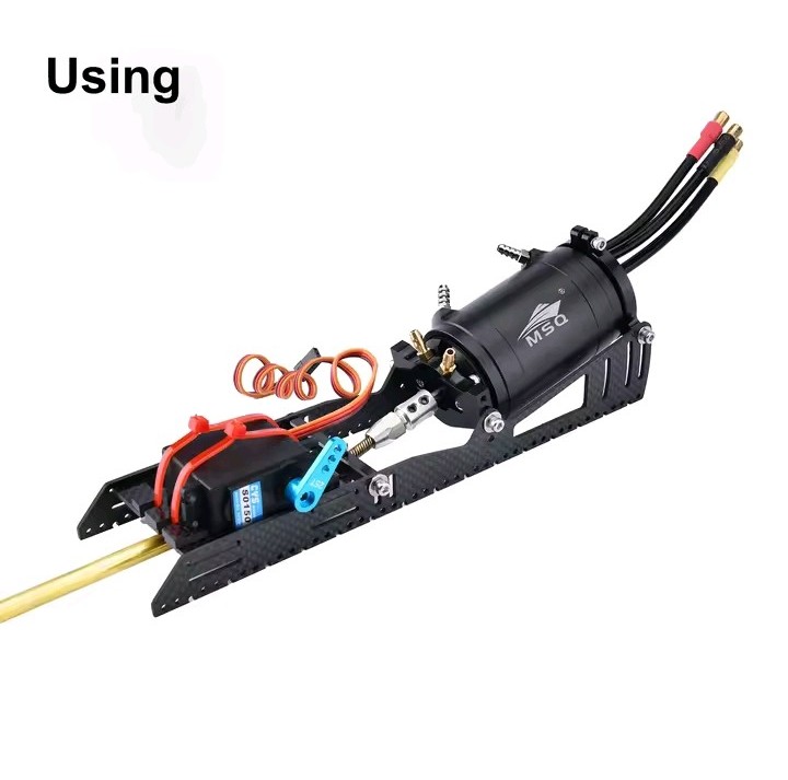

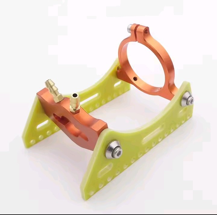

Had this in my shopping cart for a while to fit into the TYLOSAURUS.

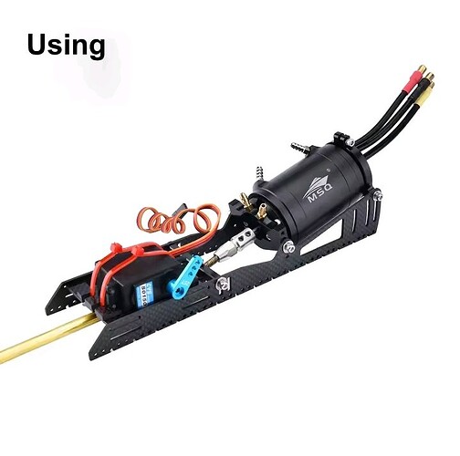

Simple custom motor mount to get the job done for $25. :+1:
But after finally hitting the “Buy Now” button, these setups suddenly appeared in the screen underneath them!
Fully set up frame rigs with EVERYTHING that could ever wish for In a custom build for $14 !
I hit that “cancel order” button in lightning speed on the original single motor mount purchase straight away!
Full length adjustable motor mounts, drive tube mounts and steering Servo/ battery mounts all in one piece for $10 cheaper! :flushed:
(Just the framework obviously, illustration for final assembly using your own parts.)
Certainly pays to shop around and do your research.:ok_hand:
The only mods I’ll have to do is drill out that standard 7mm driveshaft mount to suit my custom 9mm OD driveshaft with all the 8mm ID upgraded internal goodies and Robert’s ya Father’s Brother!:grin:

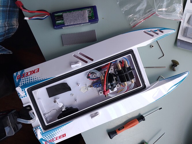

Was doing some more stupid mods with the little Orange 915 Tunnel Hull yesterday, as not overly impressed with the stock speed, even though pretty quick for such a small model Speedboat, those mad Asian modifiers definitely have shown how fast you can actually make them!
Fitted a Stainless 40mm Prop in place of the stock 32mm plastic version, and that definitely woke it up almost doubling the speed. :ok_hand:
Had charged a small 4S battery that I can squeeze in there, but left the battery plug adaptor at home, so didn’t get to give it a whirl. :face_with_diagonal_mouth:
There’s a 90% chance that it will let the LUCAS smoke out of the tiny little 30A ESC, but hey, don’t know if you don’t try!
