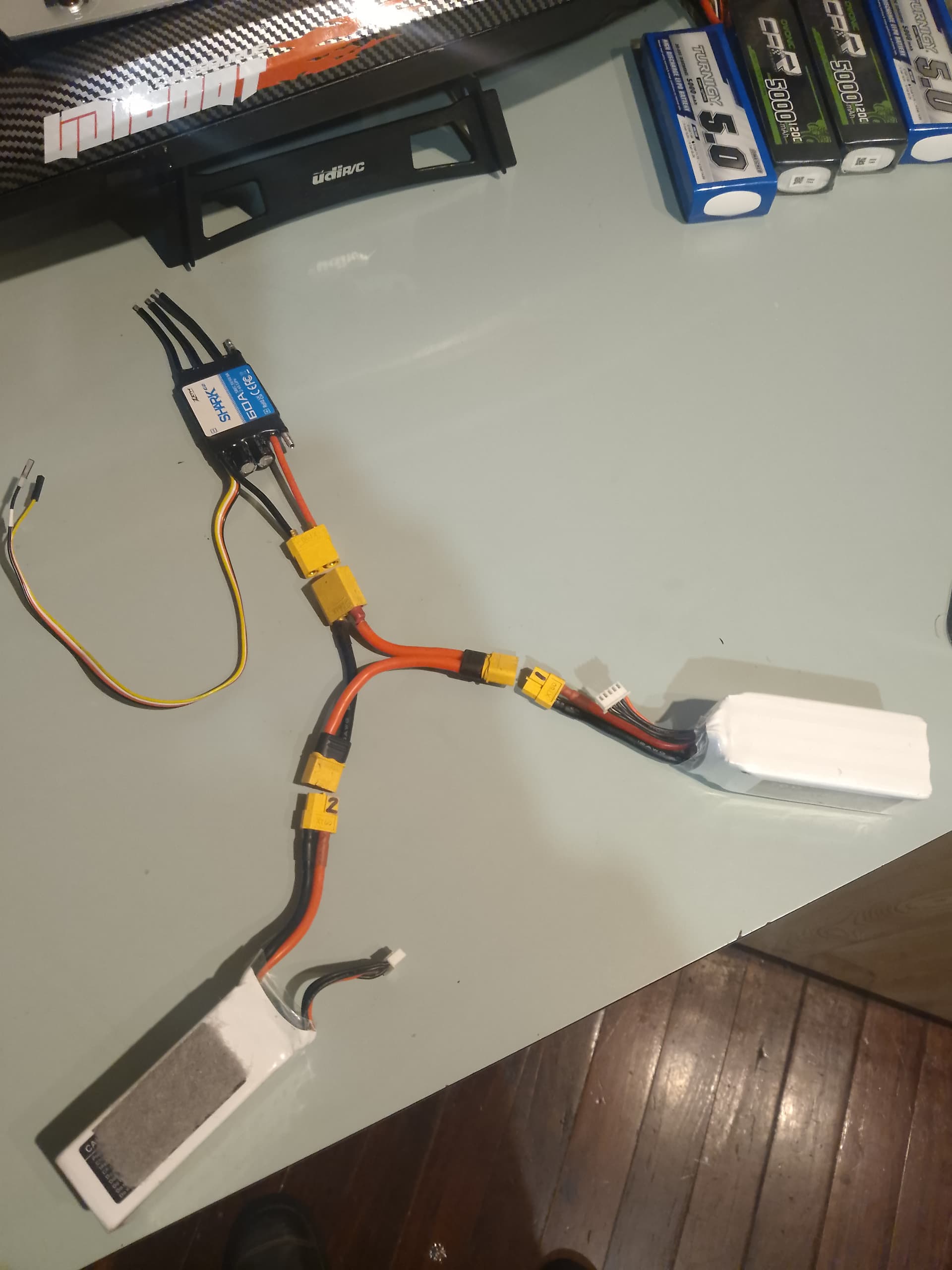

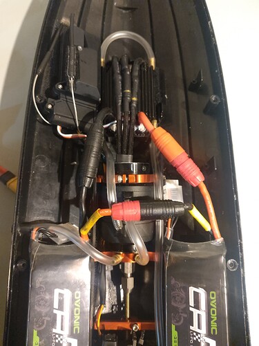

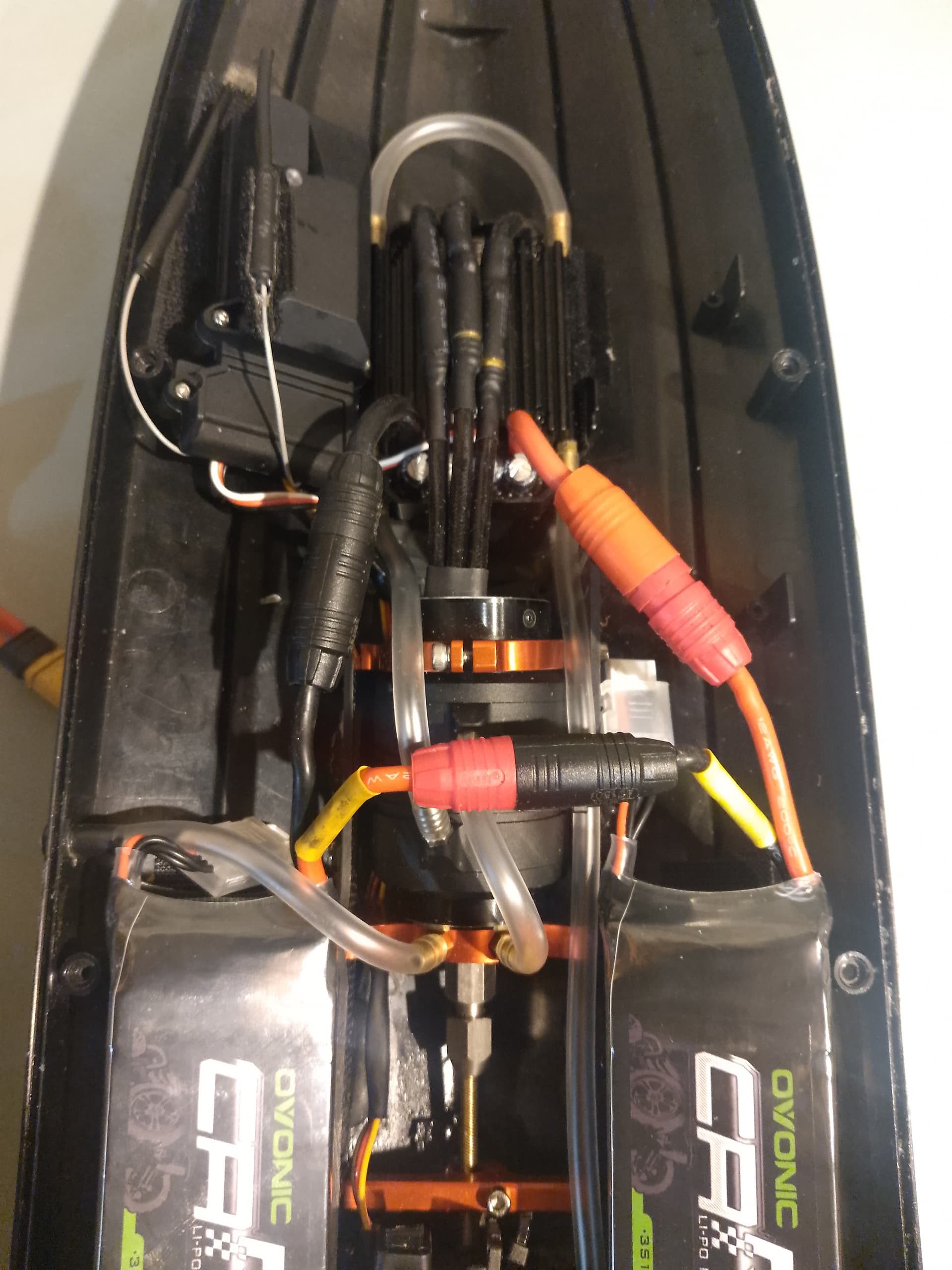

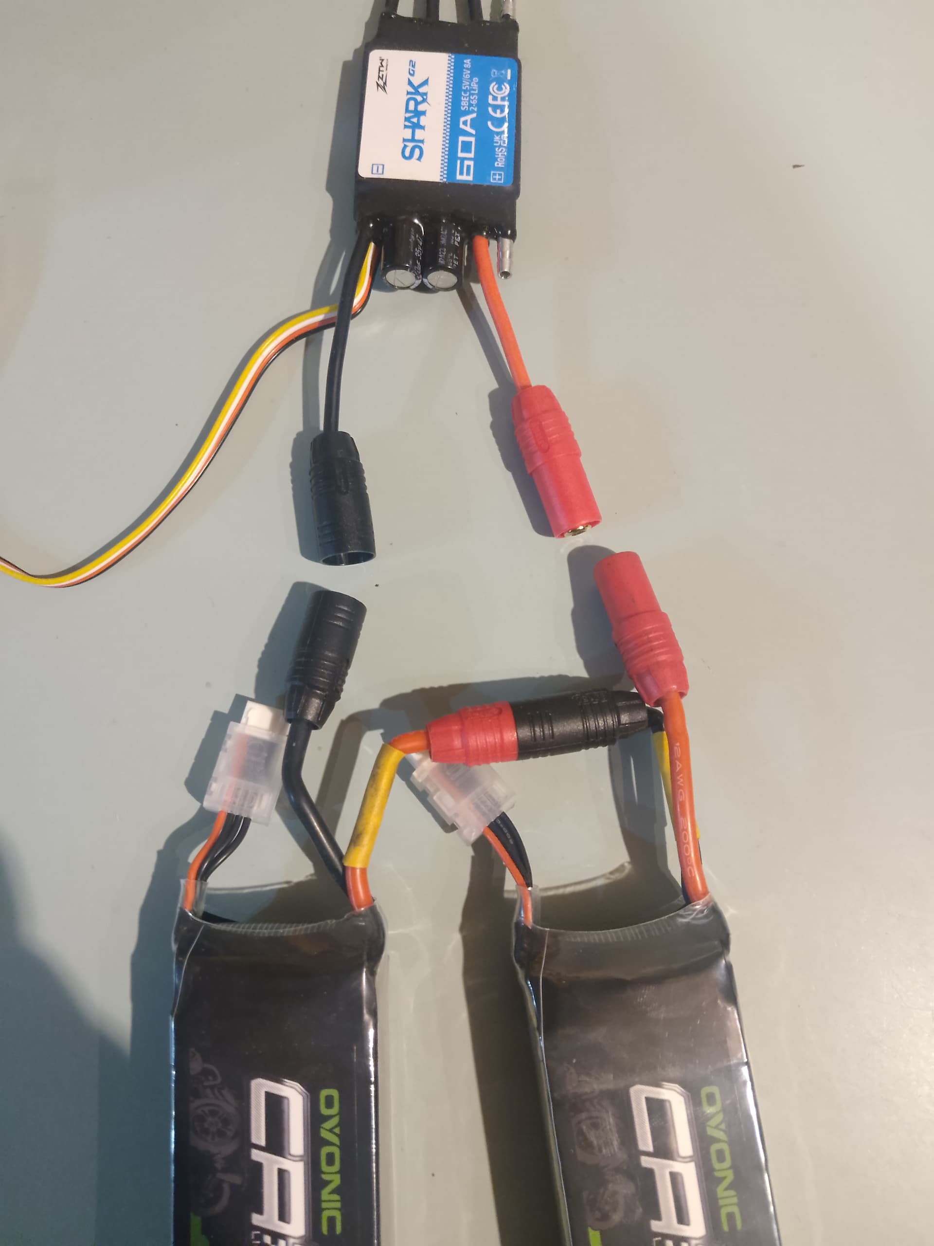

Forgot to detail the reasons behind all the chopping of wires and fitting stupidly large connectors to this whole system.
Standard procedure is to fit multiple plugs and adaptor cables to be able to run two batteries in series or parallel to run the system.
The problem here is that this adds multiple plugs and extra cabling to connect the whole setup together.
Every single extra millimetre of wire, and every single extra plug adds additional resistance throughout the whole system.
Resistance equals voltage drop, ripple currents and extreme heat buildup through every wire and connection.
Here’s the “industry standard” for piggybacking dual batteries in Series connection using adaptor leads and plugs.
If you count everything together, that’s 9 power cables and 12 individual wire connections in the “series” system between the Batteries and the ESC, whereas “parallel” connection would require 10 cables and 14 wire connections!:open_mouth:
That’s a shitonne of plugs and long cable lengths just to get power from the batteries to the ESC, with every step of the process using different cables, different Amp rated plugs, all robbing power, delaying power delivery and adding plenty of heat and resistance into the whole powertrain.

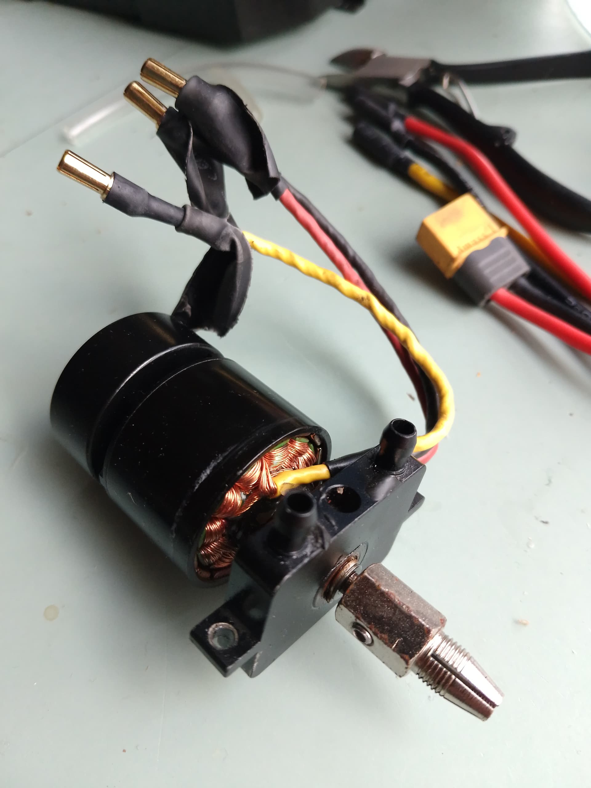

Here’s the system I modified to overcome all of these issues.
Chopped the Battery leads and ESC power leads as short as possible, then fitted massively oversized 150A single plugs designed to be able to connect directly to each other in either Series or Parallel configuration directly to the ESC individually, without the need for adaptor cables adding extra cable lengths or plugs to slow down power delivery.
So we have gone from 9 cables and 12 individual wire connections to 6 cables and 6 wire connections, with the original set-up requiring twin 60A battery plugs feeding into a single 90A plug to the ESC, now it’s simply 150A plugs straight off and across the batteries feeding directly into 150A plugs to the 150A constant/900A burst current rated ESC.:ok_hand:
Might not look like much, but notice how much shorter the system is compared to the first pic in this post, and on paper through the electrical engineering calculator, the difference is night and day!
There ain’t NOTHING stopping that MOAR POWER instantly getting to where it needs to be!:stuck_out_tongue_winking_eye:

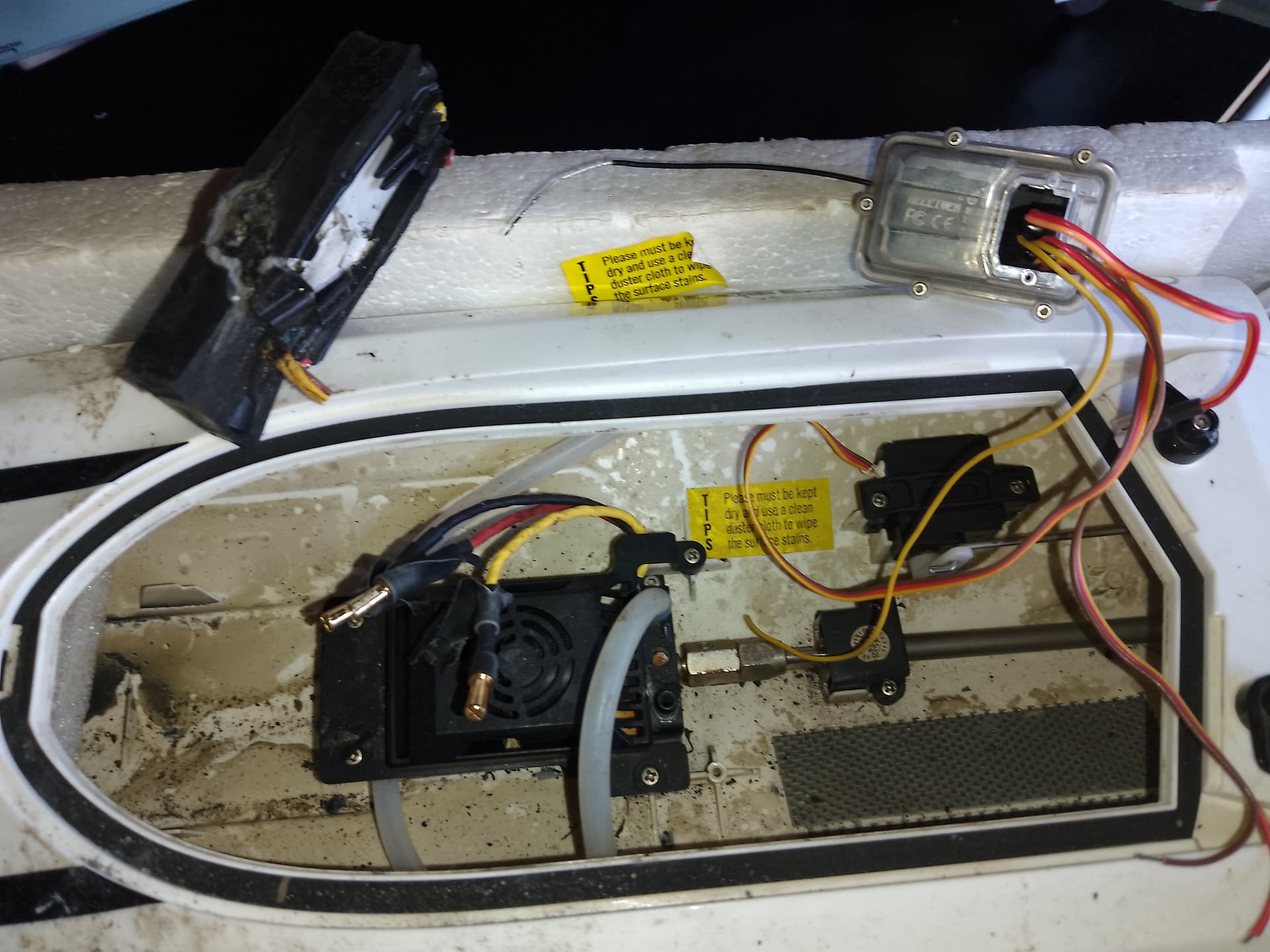

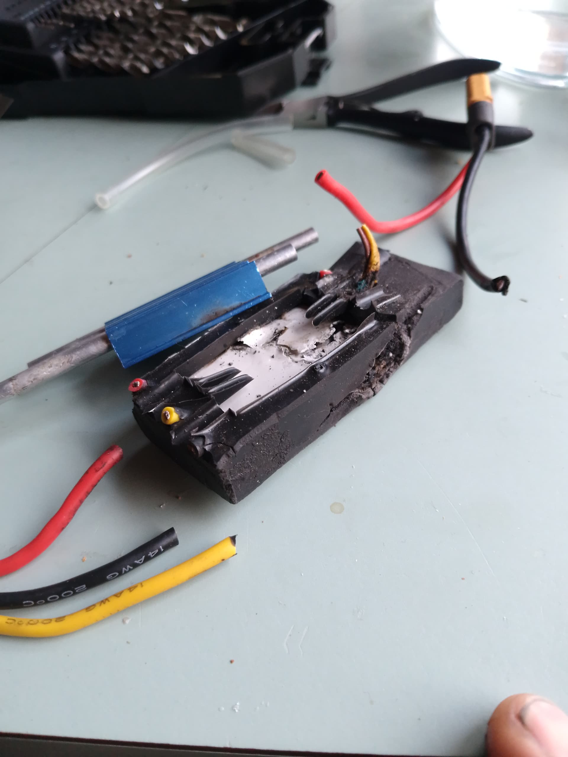

Salvaging whatever I can out of the old Bonfire Submarine Boat for future projects.

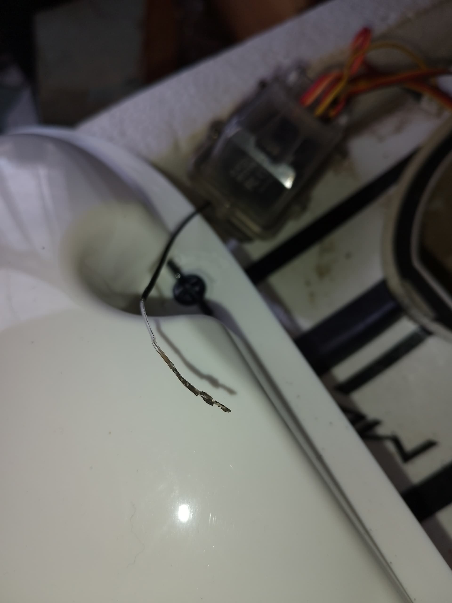

Gonna test out the old RX to see if it still works, but has signs of the Aerial wire possibly having contacted a +positive wire somewhere in the chaos and looking a little charred, so I don’t have very high hopes!
If anyone knows what cooked Electronics smells like, you would know why I’m keen to get this stripped out and fkd off to the storage unit and out of the house ASAP!:joy:
On a happy note, I managed to unseize the motor with a bit of INOX MX3 and appears like it might live to see another day,
But otherwise, everything else is literally TOAST!:stuck_out_tongue_winking_eye:

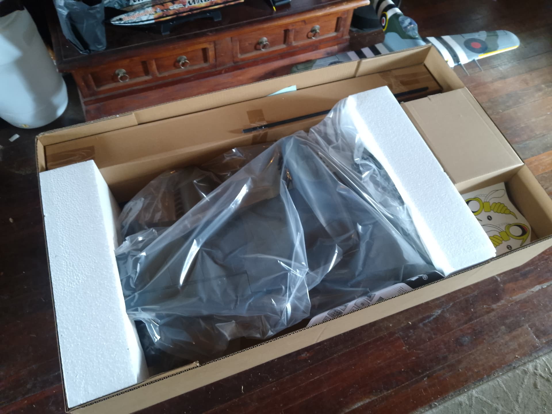

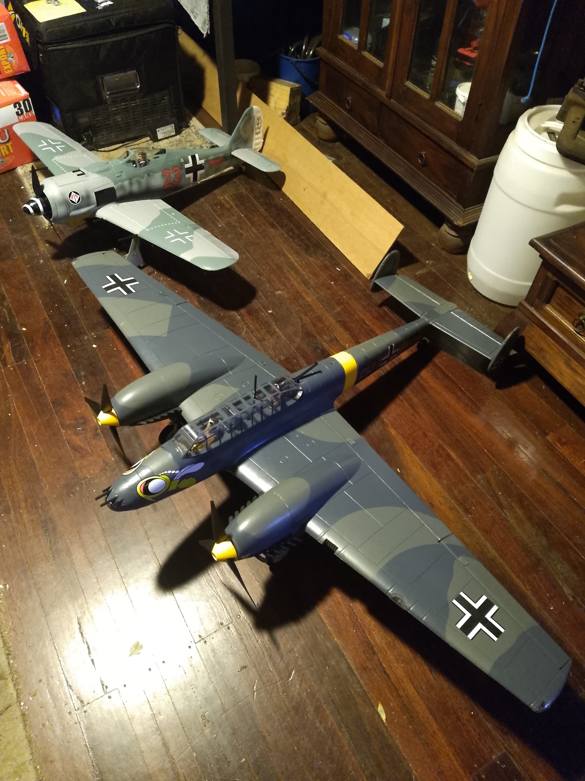

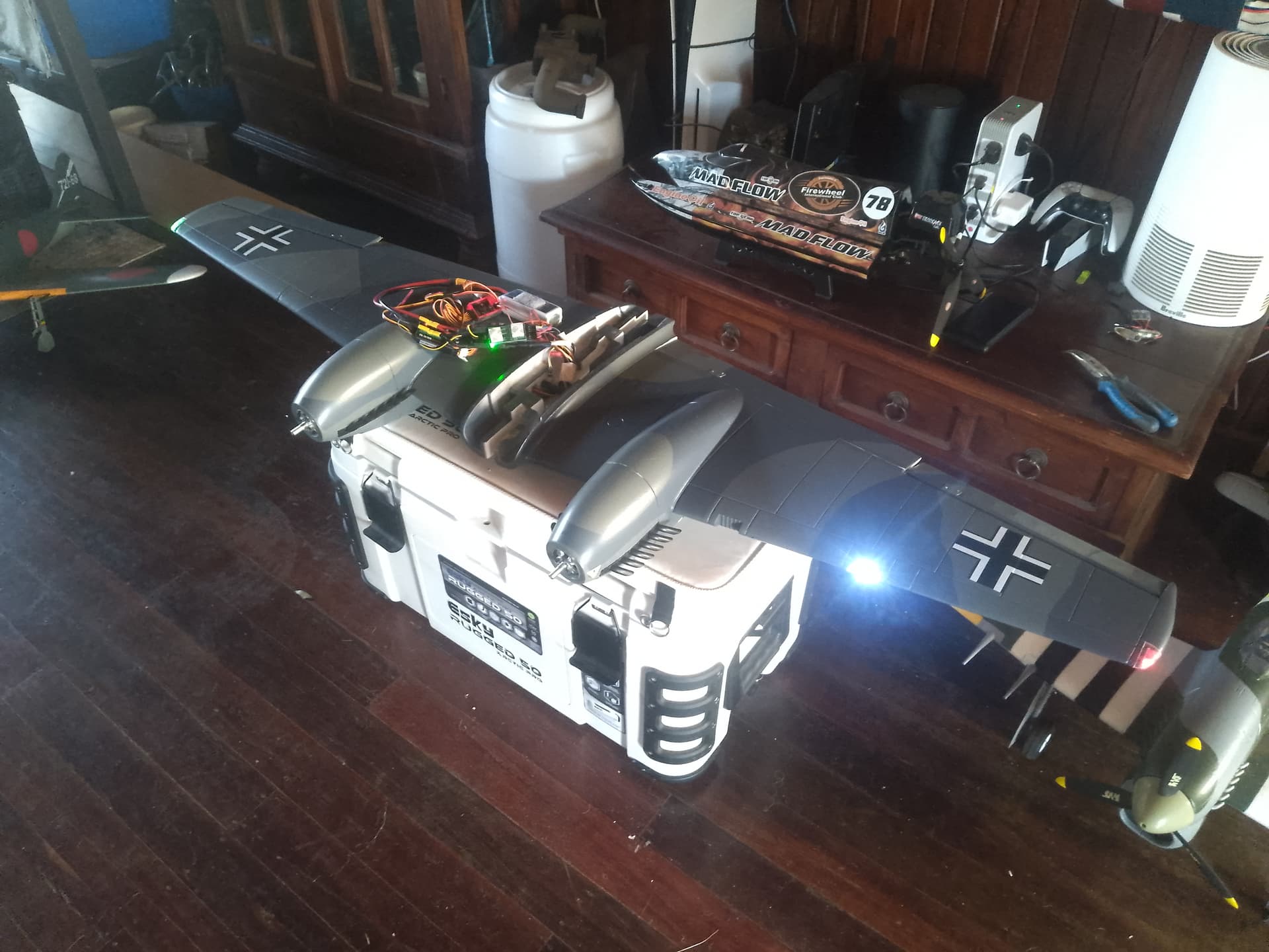

Yes, the Bf110 actually got delivered before lunch yesterday, which is much earlier than the usual 4-6 p.m. delivery.
With all the wind and rain outside I didn’t even hear the delivery driver, just a thump on the veranda outside, thinking something had blown over or a branch dropping out of the trees.
Went outside and found this HUGE bloody box just starting to soak up the rain blowing in, so luckily I checked the sound of something dropping on the decking before it got totally drenched!

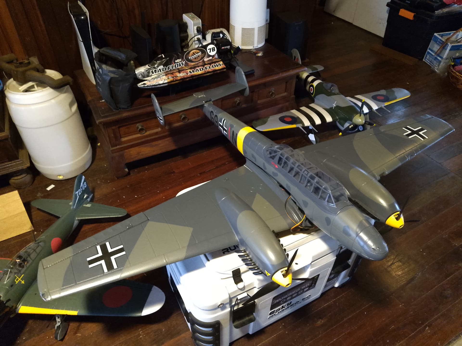

It was too large to throw on the bed in the spare room like I normally do, and my workbench is taken up with the Speedboat that I’m currently finishing building, so improvised with a spare Esky to unpack and then transfer the individual components into the spare room.:+1:

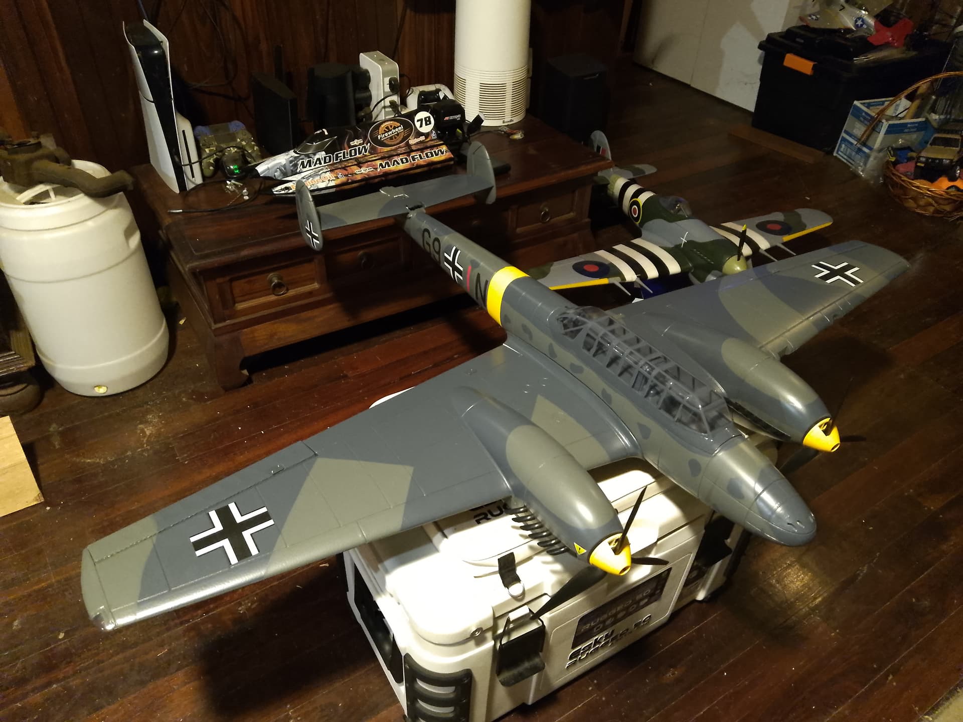

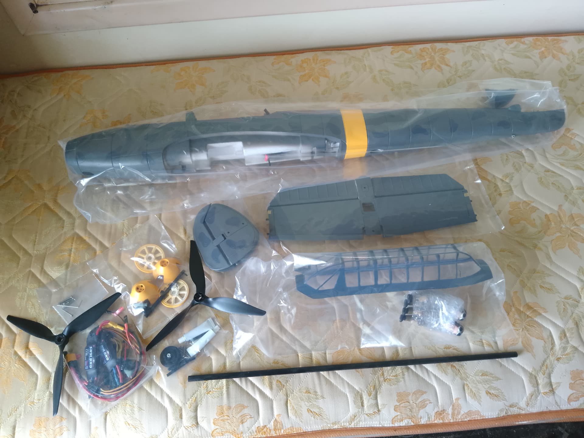

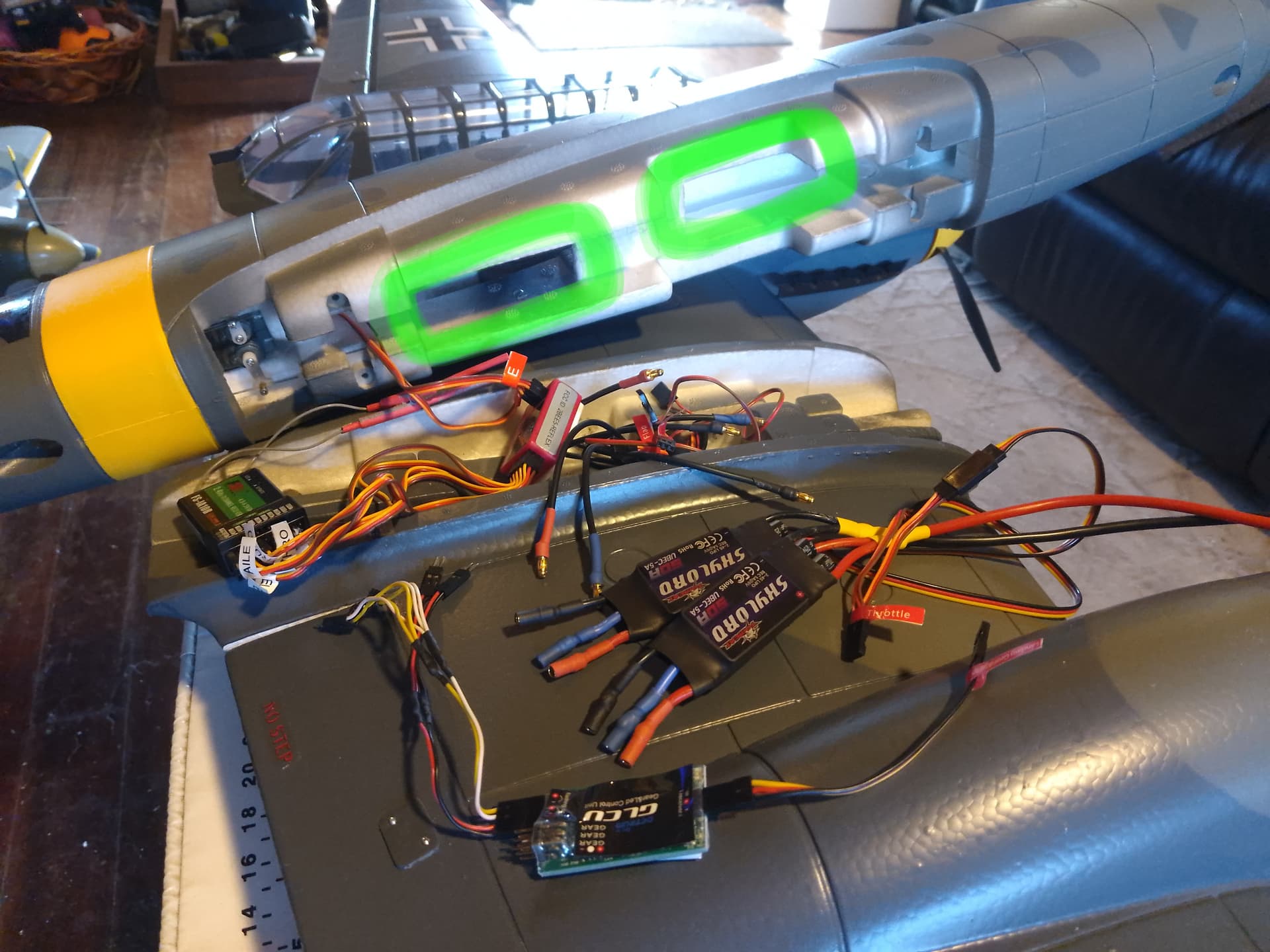

It was immediately apparent just how large this beauty was going to be compared with the same scale single seat fighter aircraft.

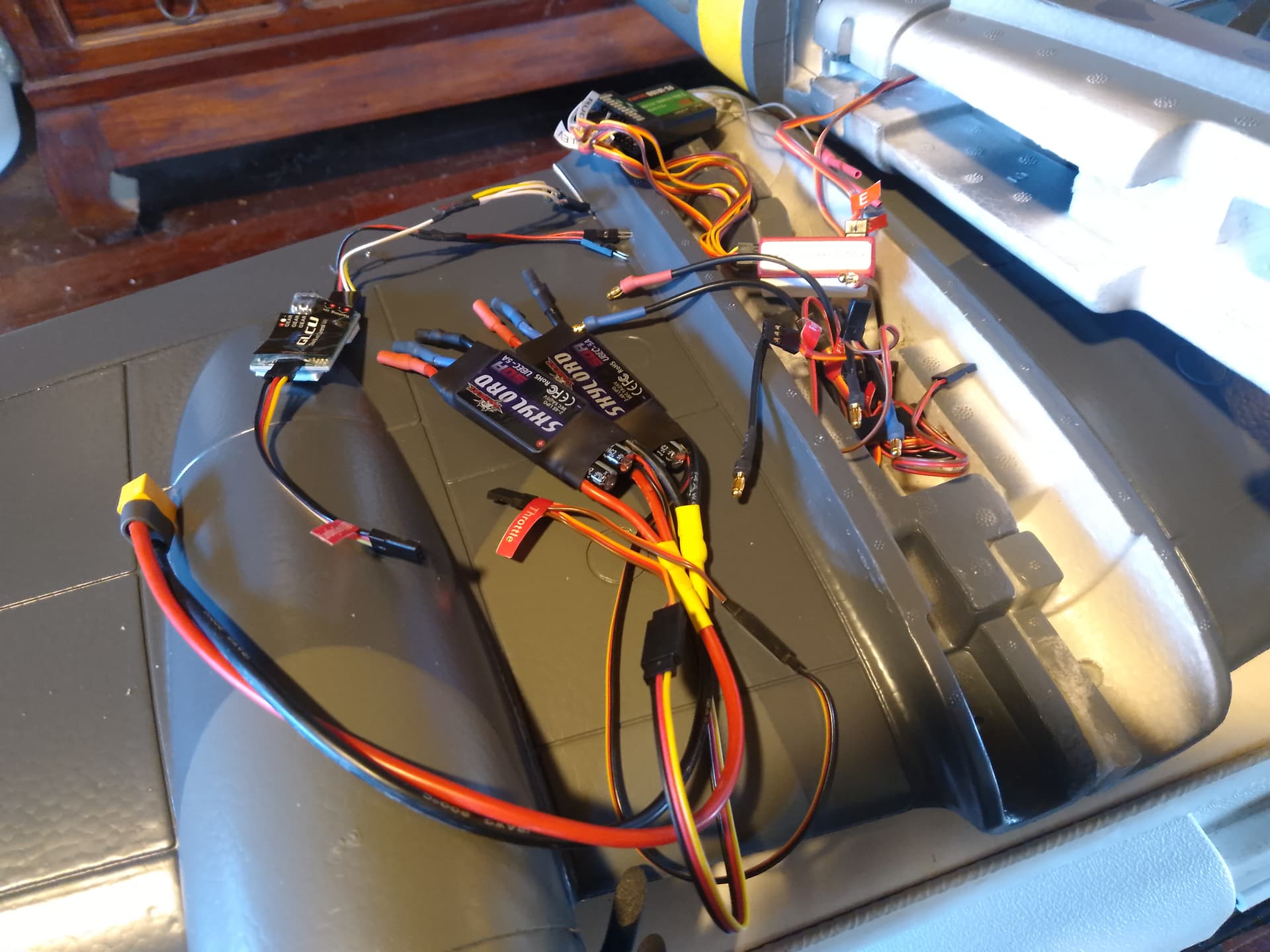

Rough loose assembly testing out parts fitment before I begin the journey of finding out what space I have available to fit all the various electronics into and still have room for everything to bolt together properly.
Only have 2 tiny thin slots in the underside of the fuselage between the wing mounts (highlighted green) to somehow fit all of these electronics and wiring into, and already modifying internal bulkheads to try and get airflow through these tiny compartments to avoid any overheating failures.
After much chin scratching and many different attempts trying out different combinations, I think that I might just have found a set-up that’s finally going to allow enough room for all the Electronics and wiring for the Wing to actually fit snug to the fuselage.:raised_hands:
So yeah, won’t fix anything permanently just yet, will wait a few more days of beard stroking and a few more Beers whilst reviewing everything until I’m certain that I’ve got the right plan in place before final assembly.:grin:
Oh yeah, there’s also some nice retractable landing gear and huge landing/takeoff flaps underneath, but won’t be able to work on those until all the electronics are completed and the RX/TX bound and operating switches configured.
