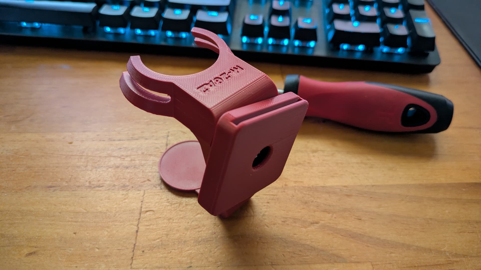

Changed the clamp position so the nade can sit parallel so you can tie the pin to the vest so you could just pull it straight out and the pin would get yanked out in the process, I designed it to screw onto a molle plate so the orientation can be adjusted to suit
Does feel a little looser compared to the first one but giving it a shake it didn’t come out, will need to test on an actual kit still.

Still needs some tweaking for the mount, trying a simple slot and see how that goes.

Pretty good, of all the times I’ve given it a good shaking it’s only come out once.
Will need adjust the belt loop, tried it on one of mine and wouldn’t fit, not satisfied with the retention screw either.

Just an update, altered the clamp slightly and it feels a lot more rigid whilst still being yankable.
Adjusted the belt mount, didn’t due to that metal cover on the end to stop the material from fraying, also adjusted the positioning lugs to bit a bit more fixed, once it’s aligned how you want you just tighten it, maybe a bit of thread lock on the screw, but you only need to loosen it slightly to adjust it afterwards.
