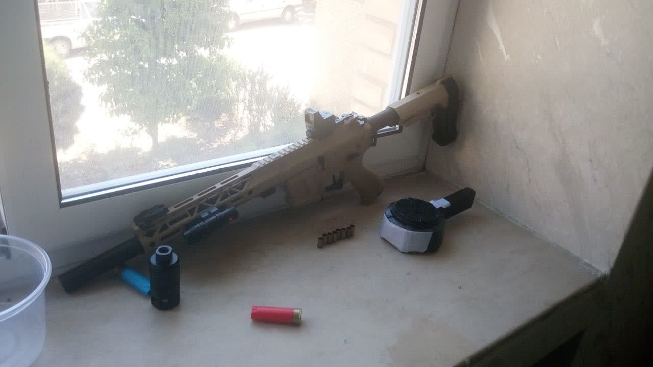

Project finished in the past , but this is recent and my tg arp9 v4
  • homemade drum mag
  • black blowback plate cnc-ed
  • mock supp with metal hop made from a dunlop chrome guitar slide and 14mm thread muzzle of the gun ( muzzle got cut , then that hop like slide was duct taped to that and then inserted into the suppressor and made the suppressor lock tight
  • colorizing the safety indicators ( safe red , semi and auto black )
  • buttstock indicator hole made ( gun’s fully refurbished from a stock piece of dirt into a legendry 350 fps gun )
    it had metal gears , green oring and best seal ootb , i just changed nozzle , piston head and the spring to m95
    now the gun can shoot like 40 meters to be exact even further ( i’ve shot 50 meters and it was when the gel ball fell ) this could compete with spring airsoft guns for real and it’s superior accuracy that could hit tin cans at 35 meters accurately and making them fall down ( with the blue filthy gels ngl )
well , this gun broke , so i wanted to give a tribute to this legend ( mag broke and i abandoned the gun cause there was no mag for it lol )
Have you tried pulling the mag apart, to see if you can fix it.?
Gels left in the mag can shrink, and jam it up for future gels…
The magazine completely broke lol
It was a gle 817 s like glock thingy drum combined with the arp9 standard magazine and duct taped
