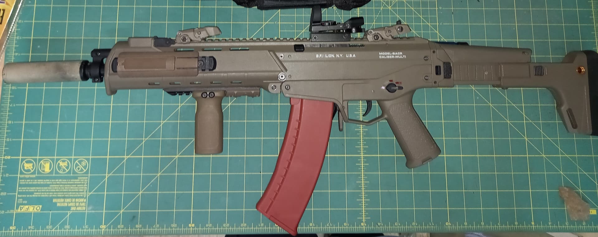

ACR/R now with stock gearbox and m100 spring. 290 fps. Did have metal gears, etc but needs new gears. Built to play at Nuketown but never made it. Reasonably accurate at 40m on auto
Cut out for battery - still needs finishing off
Cut out at rear of gearbox to get wires through without chafing
Battery in stock
Battery is a tight fit once cheek riser is installed

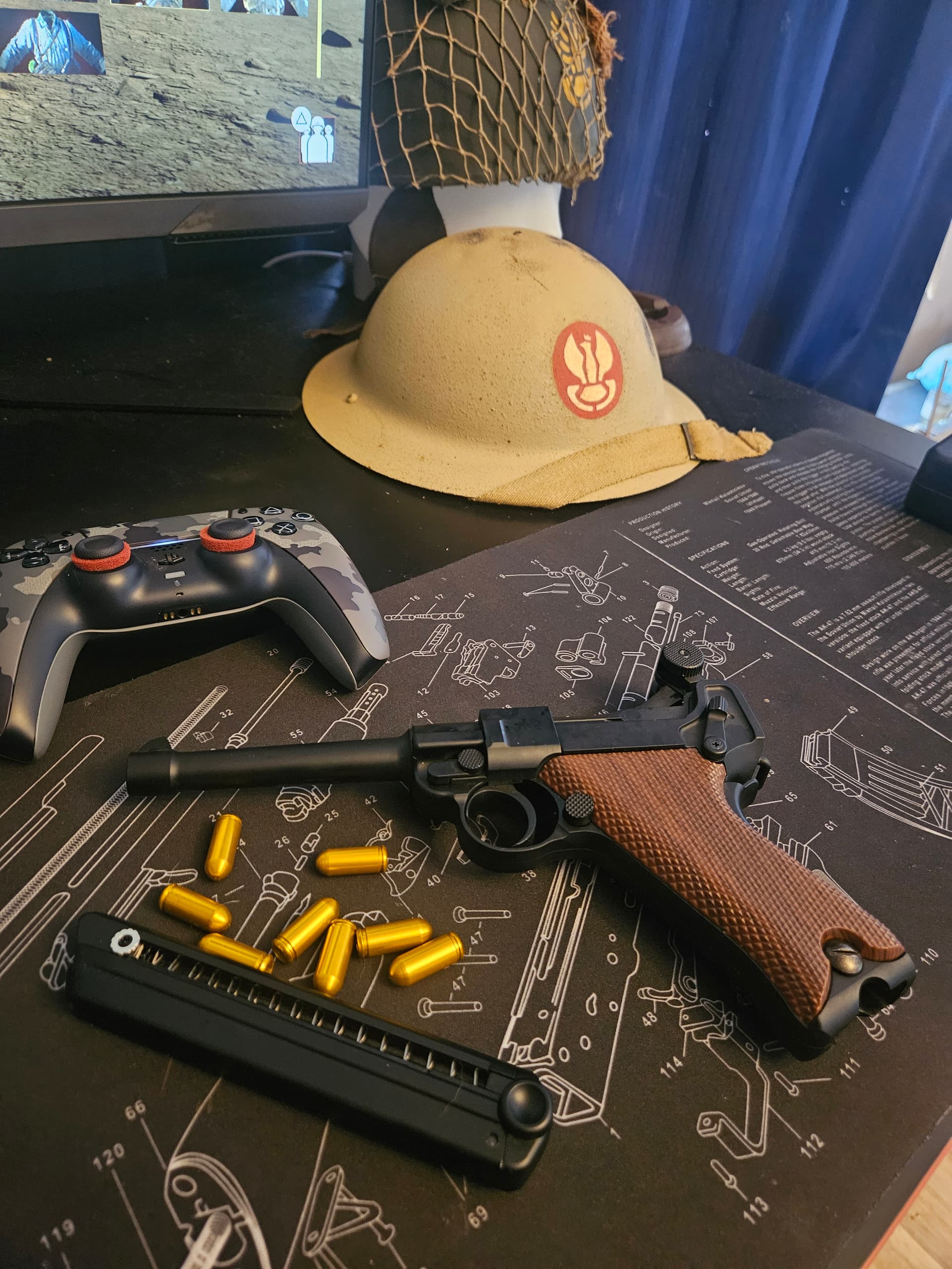

Kele P08 luger picked up from X Force today. $140. Not a blaster. Shell eject replica toy only. Not too bad for a toy replica. Plastic grips feel crappy. Metal mag, full metal frame, laser pointer activates on trigger pull, locks open when empty. 8 replica rounds included. Does not shoot gels or darts.
