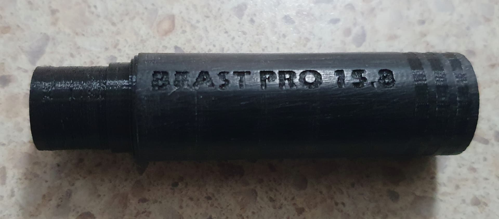

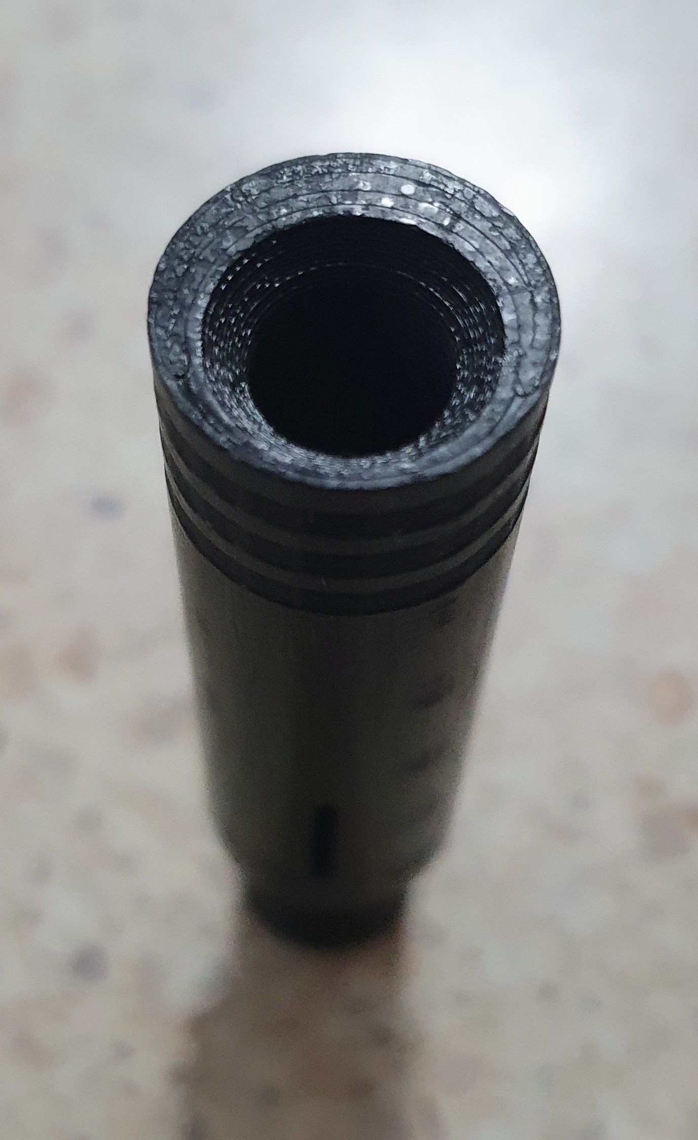

I’ve never bought or used one of these 3D printed hop ups before, but saw them on Ebay and decided to give one a go.
Interesting how it’s the angle of the bore that imparts the top spin and definitely a different design to the old textured tongue jobbies.
Happy to report that it works quiet well! On my Scorpion EVO 3 at about 260FPS, at any rate. :+1: Won’t suit every blaster due to it’s bulk though.

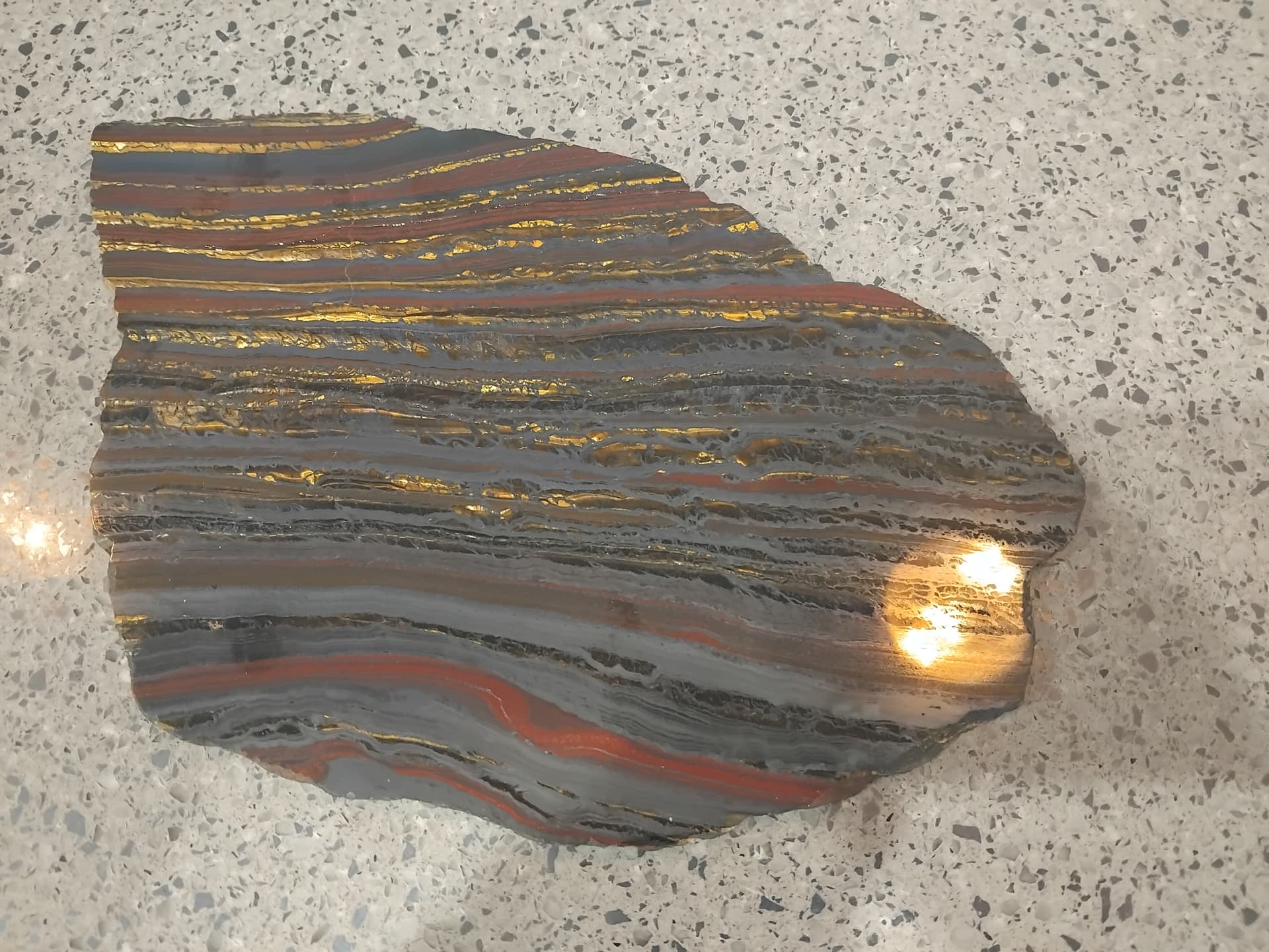

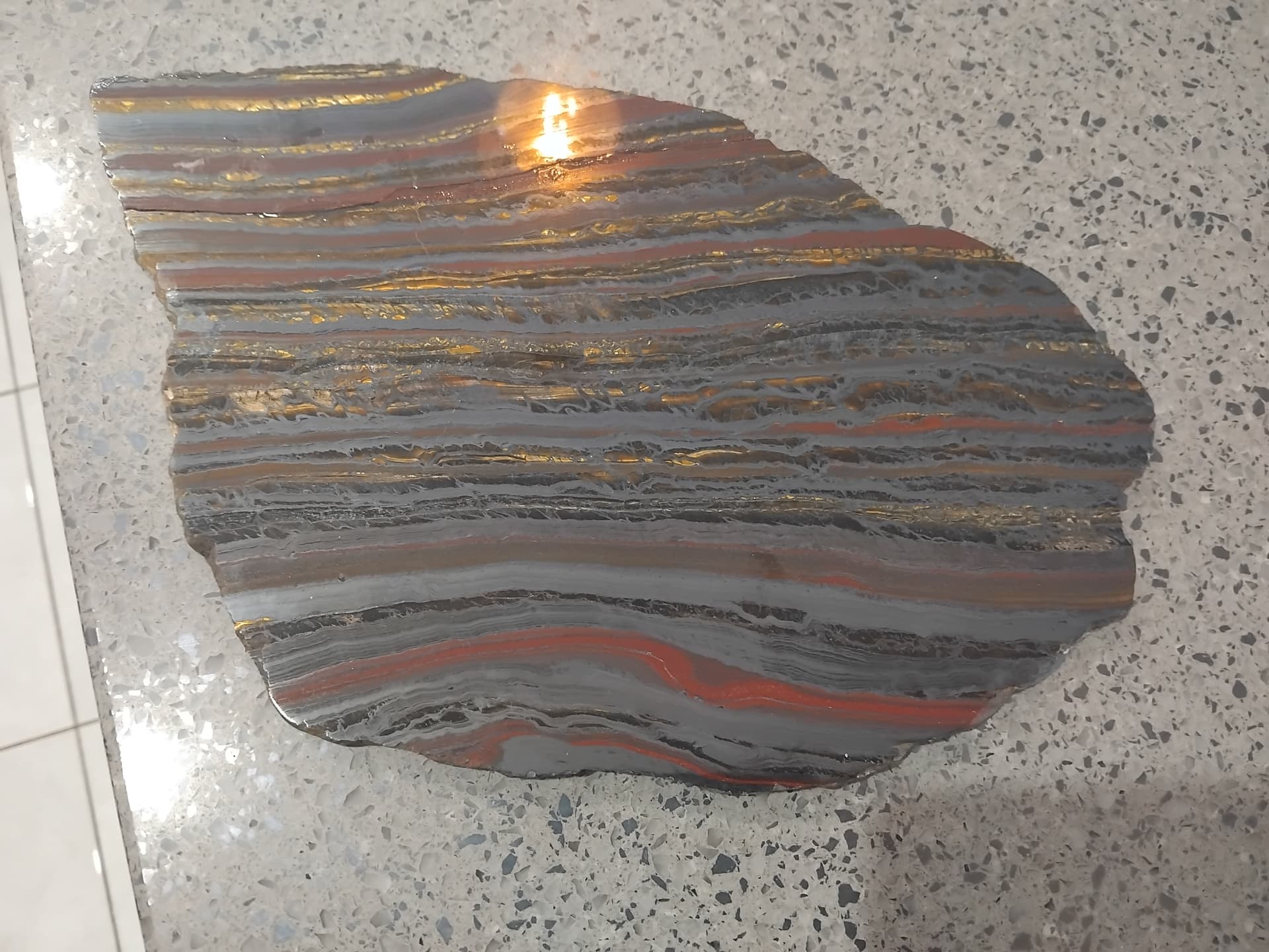

Tiger iron ore is a stromatolite, originating from WA.
Over billions of years, as the rocks formed, bacteria got trapped in successive layers, and got deposited as different coloured veins.
the intense pressure warped the rock over time, and produces varying patterns.
The result is beautiful vertical patterns of rock ore, formed and deposited over Billions of years, that polish well up and produce stunning display pieces.
And, not even expensive…
This is indoor lighting, they look best under full sunlight.
they slice them about 10mm thick, so there is a bit of weight…but strong winds got the better and blew mine over. Lets see if araldite does the job.
