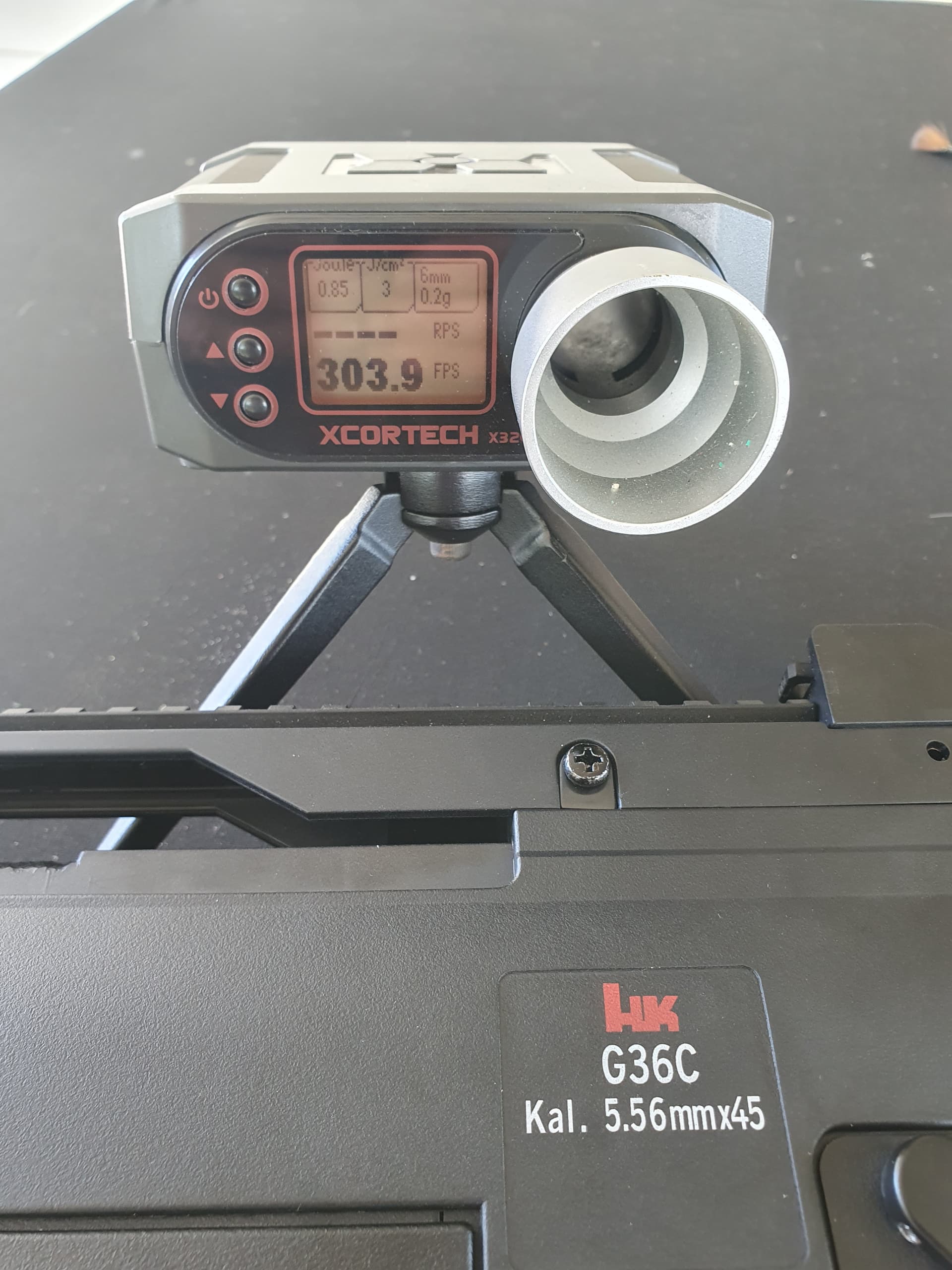

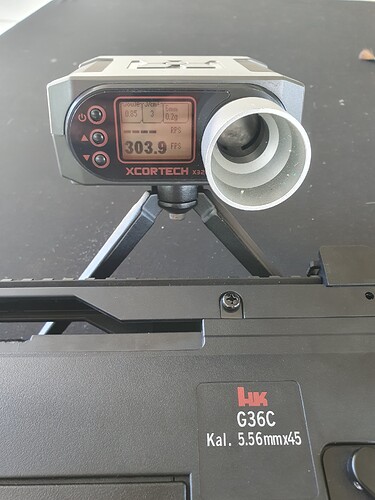

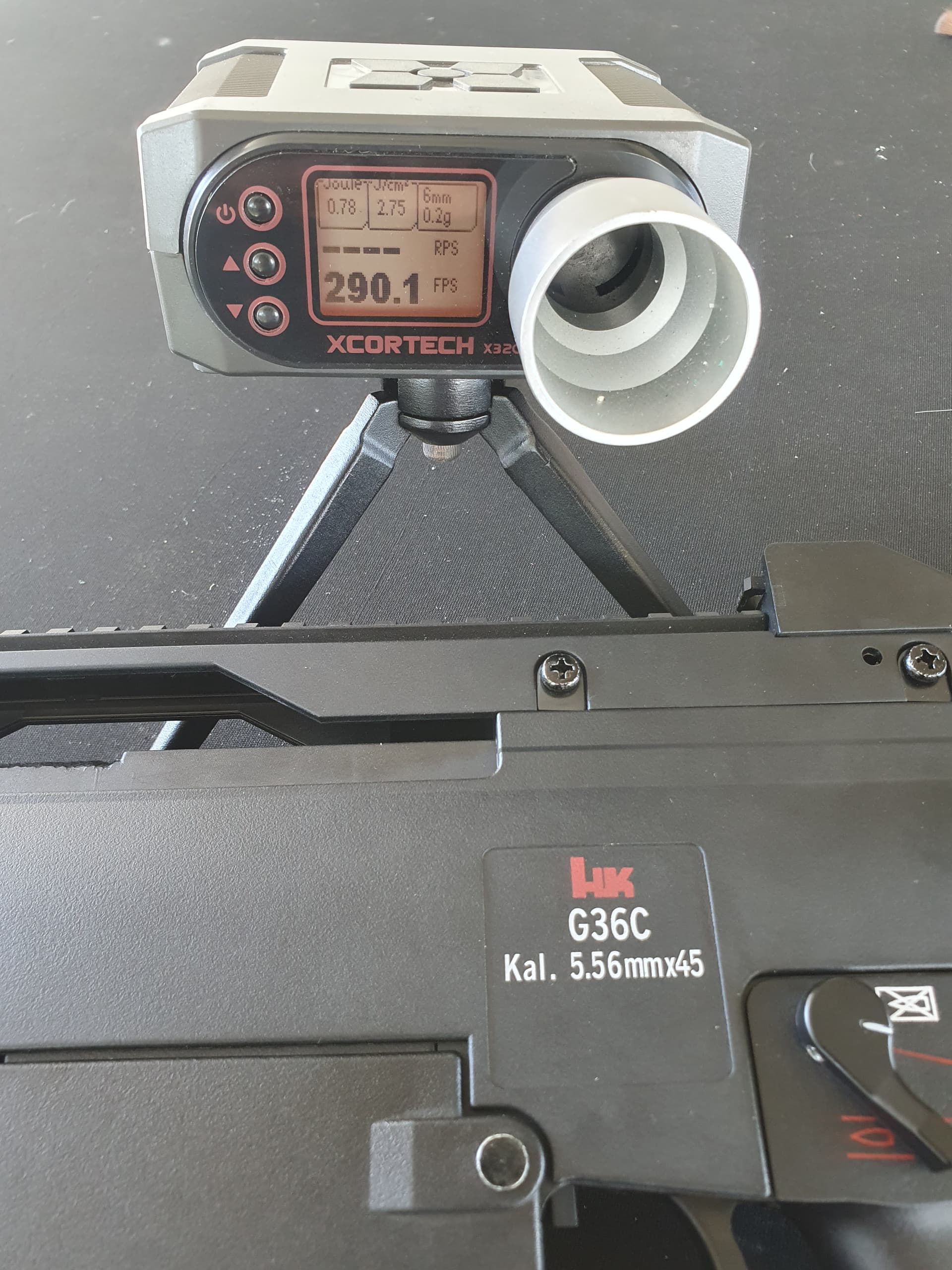

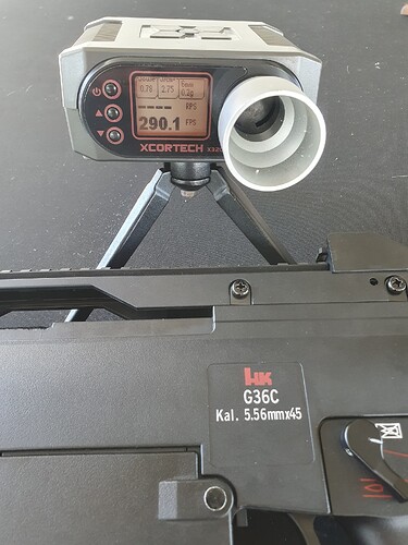

After a day of trialing different combos of piston springs and nozzles, arrived at the final result.
New M100 spring, T238 piston and piston head with spring bearing (holes opened up about a millimetre), stock nylon nozzle (gave a higher reading than the upgrade nozzle, even when it was spaced out with an o ring).
Consistent low 300s with iHobby ultra hards
Consistent 290s with Armour Tech greens
Good enough. :+1:

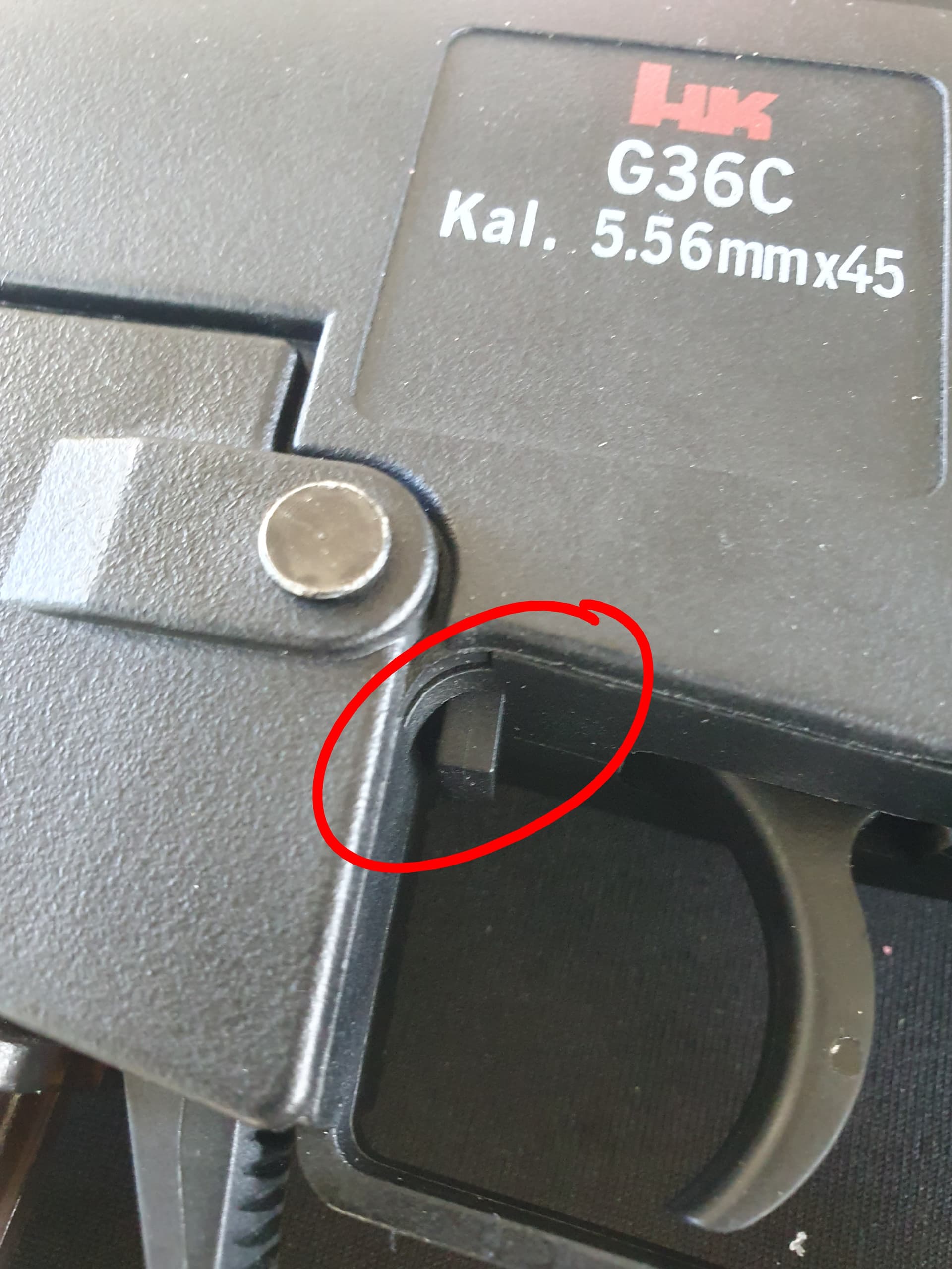

I’ve been putting this piece in and out every teardown, scratched my nut over it plenty, it doesn’t look like it does anything when you’re looking at it in pieces. :person_shrugging:
Bugger me… it’s mag prime. :rofl:
What threw me was Rok’s GBN review earlier where he mentioned CYMA dropped the ball when they left prime off… I kinda figured it didn’t have it too. :person_shrugging:
It pays to read the idiot sheet that comes with it. :joy:

@BME so I’m not the only one who missed it? I’m gonna asume @RokSolid did too. :rofl:
Have to say after a day of manually filling mag feed tubes for test firing, discovering this had mag prime was like winning lotto. :laughing:
The G36C has risen even higher in my estimations now. Damn solid blaster and a joy to work on. :+1:

What’s wrong with you guys, it has mag prime written all over it :rofl:
Not :joy: Surprise bonus is always good :+1:
To show how much of a dumbarse I’ve been today, I even saw the microswitch that block triggers and I still didn’t twig. :laughing:
Shows how strong the power of suggestion is. :rofl:
