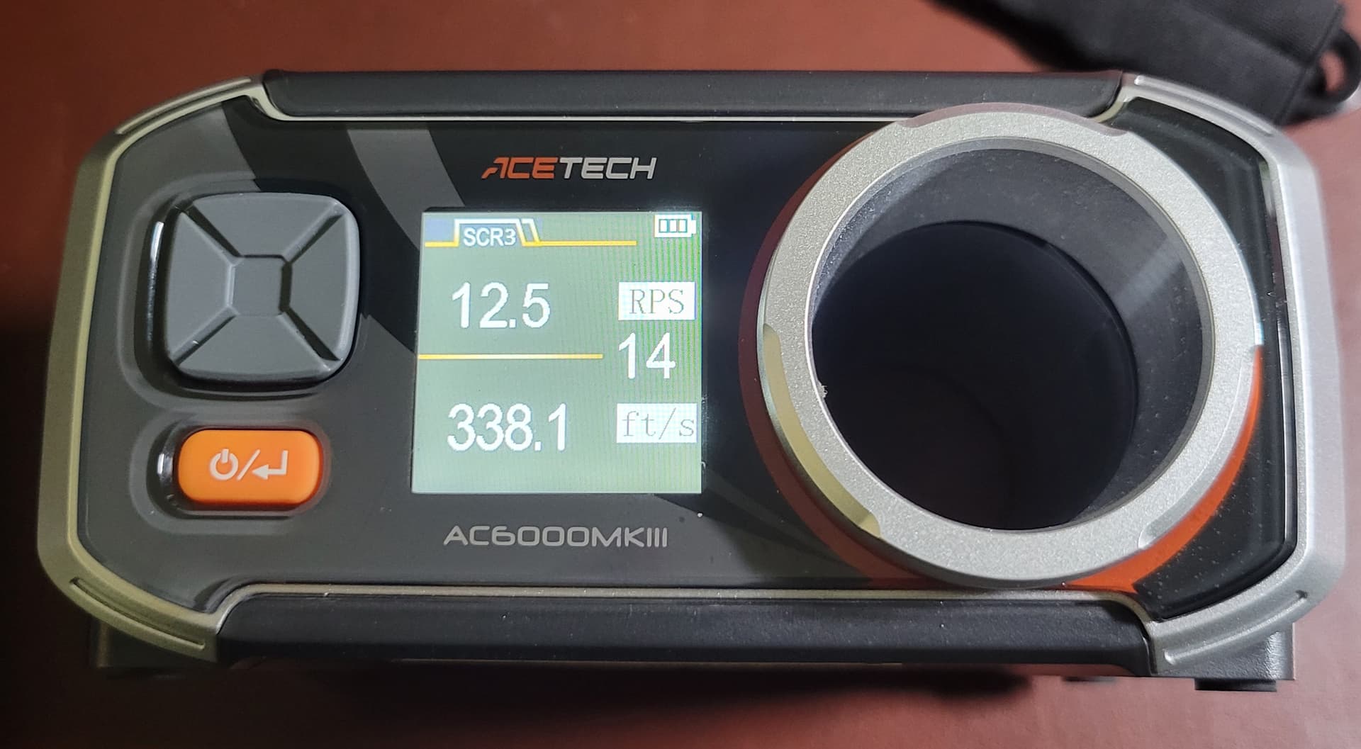

New motor arrived today. Arrived in 1 week with free express shipping thanks to that discount code.
Looking forward to seeing the difference in RPS
Arrived well packaged
Before
After
Impressive, most impressive :sunglasses:
Wow man, that’s a pretty insane instant improvement! :raised_hands:
That is awesome :+1:
Nice results! Very glad you are impressed by it, I was :slight_smile:
