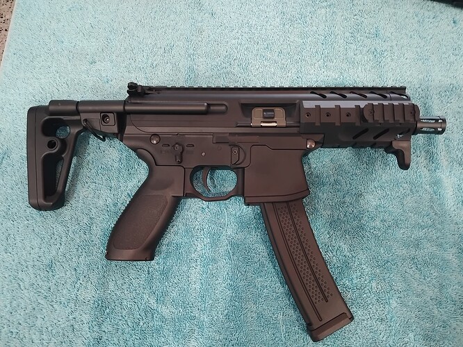

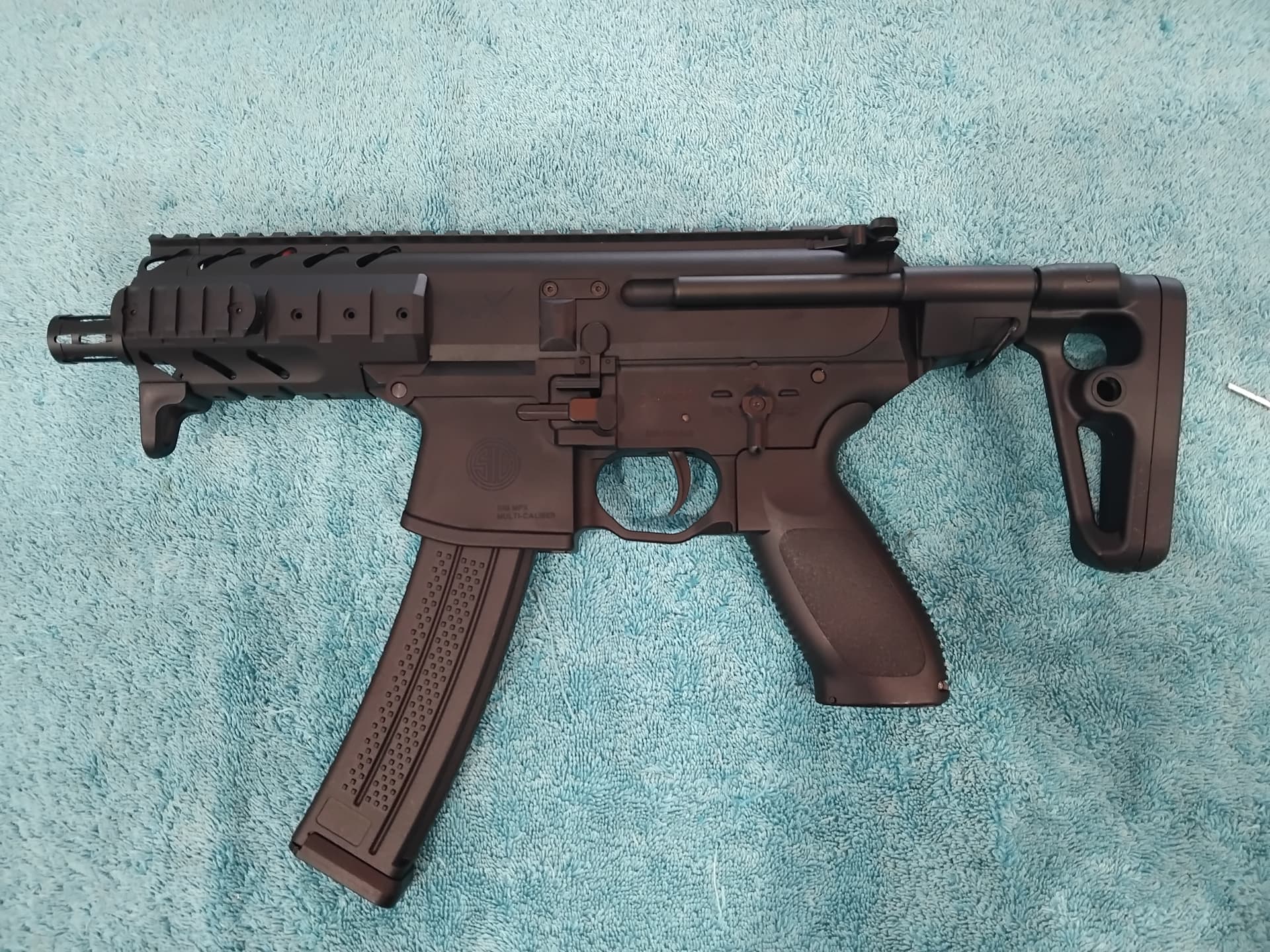

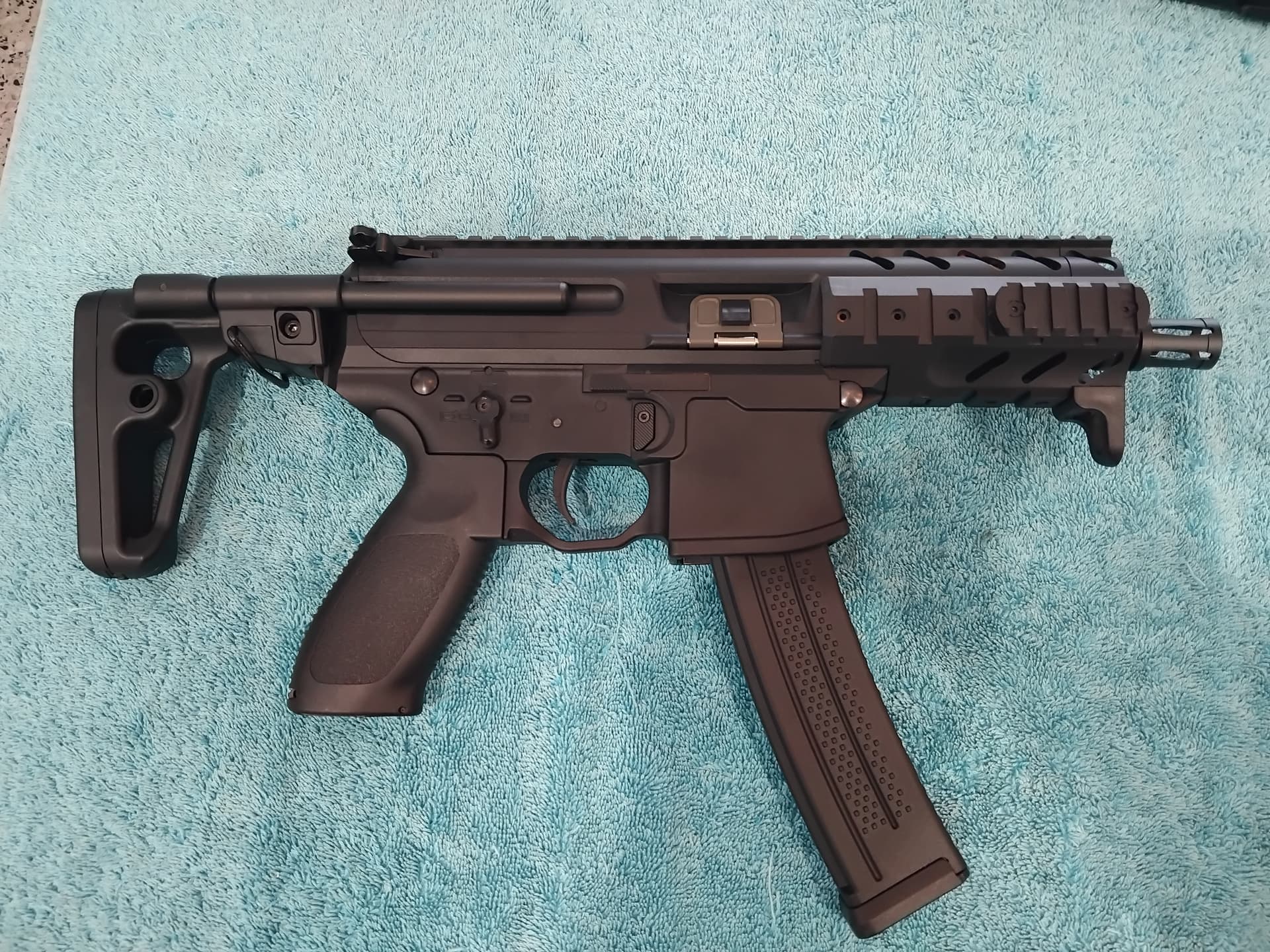

I got a compact Rattler from ihobby.
I liked the price, short form factor, extendable stock, and stippled magazine.
That’s the good part…
Now the not so good part…
Its functioning.
OOTB, it was badly misfeeding.
Like, only firing about 50% of the time.
i tried different sized gels, etc… all the same.
Also, when it worked, fps was 180-190 fps.
Awful…but not unexpected…china fps limits.
So, i pulled it down to have a look.

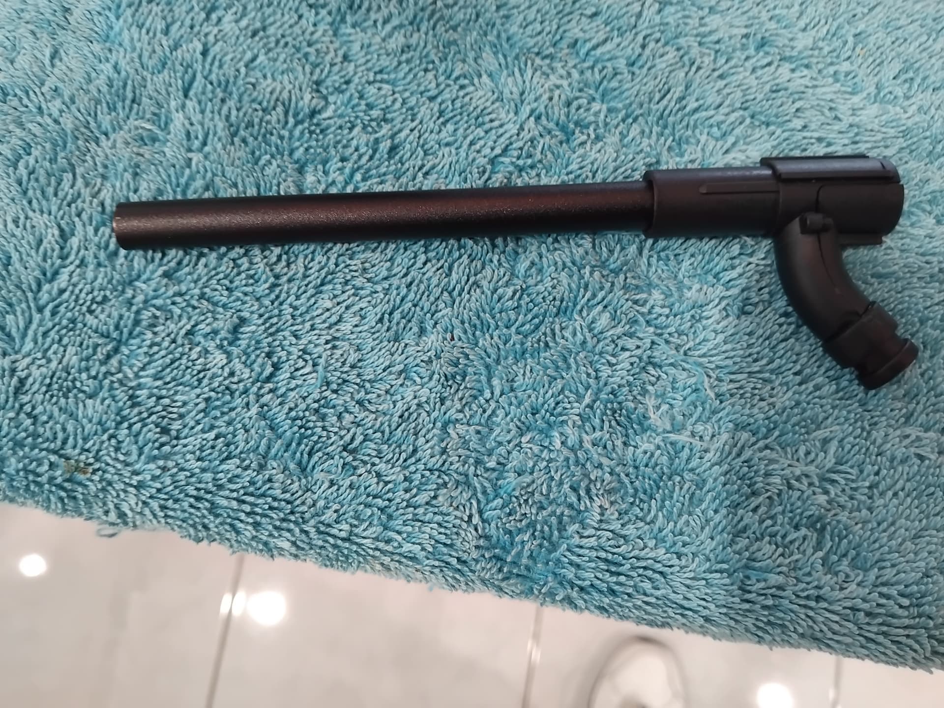

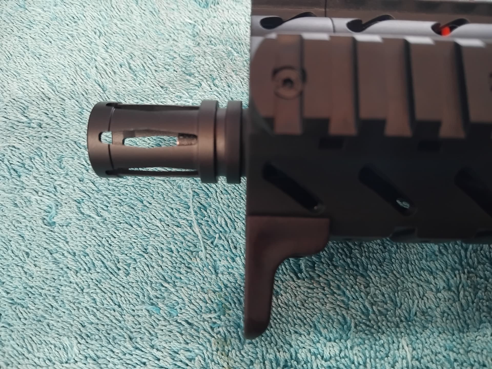

1: Extremely short inner barrel . Like, about 7cm long.
Easy to fix… and coupled with a ported cylinder, i expected good improvement.
2: “Gel Keeper”, on the bottom of the t-piece.
Basically, some holes in the sides, of the bottom of the t-piece.
This " rubber band" encircled it, with protrusions thru the tpiece holes.
This creates a light “barricade”, which retains the gels when you remove a mag.
This stops them from falling out…but could also stops gels from getting past it.
I thought it best to get rid of it.

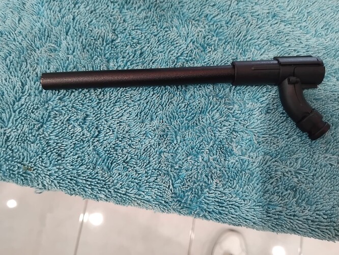

@Friendly_Fire helped remove the short barrel, and i cut a new piece to correct size.
Its about 5cm longer, and is just barely visible from the inside of the flash hider.
So, restrictor gone, barrel longer, new M95 spring put in ( original was pathetic) … should be all plain sailing, right…

  • Cut new IB using a pipecutter…filed the newly cut edge smooth, and NIKO’d the tip black. No paint to interfere.
  • New inner barrel is a very tight friction fit. No glue was used. Pushed it back hard, all the way in to the stop, and left it there.

What’s the nozzle/t-piece meshing like? Maybe the nozzle isn’t protruding far enough to seal properly? Have had that before and turned out to be a bit of debris stuck in the tappet plate track.
Another thought is the size of the hole on the barrel side of the t-piece, maybe it’s too small and squishing gels or there’s some flashing in there cutting gels.
First two things that come to my mind.
I’ll pull it down, and have another look…
Funny it wasn’t doing it initially…
:thinking::thinking:
Well…thats part of the answer…
pulled it apart… black tip of the nozzle had came off…!!

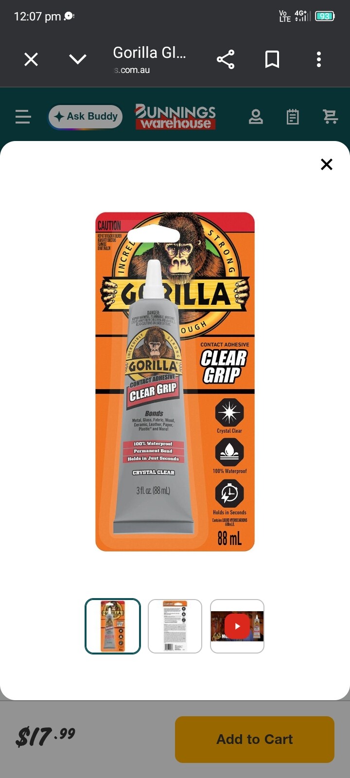

You need something semi flexible like Gorilla Grip Glue.
Get the CLEAR version though, as it doesn’t foam and swell like the standard Gorilla Glue.
i was just having a look at bunnings…
they have a “green gorilla glue”… supposed to be flexible / take impacts…

Actually just read that it’s a CA type glue, meaning that I would avoid it!
The “flexible gel” pertains to the fact that it remains flexible for a few moments to adjust before setting solid.:confused:
I would DEFINITELY recommend the Gorilla Clear instead.:ok_hand:
Ok…
tried the clear gorilla glue.
Man, its goopy.!!
positive side…it doesnt set in 5 seconds, like supaglue…
Neg side… goopy, hard to accurately get a small amount where you want it…even when applying with a tooth pick.!!
