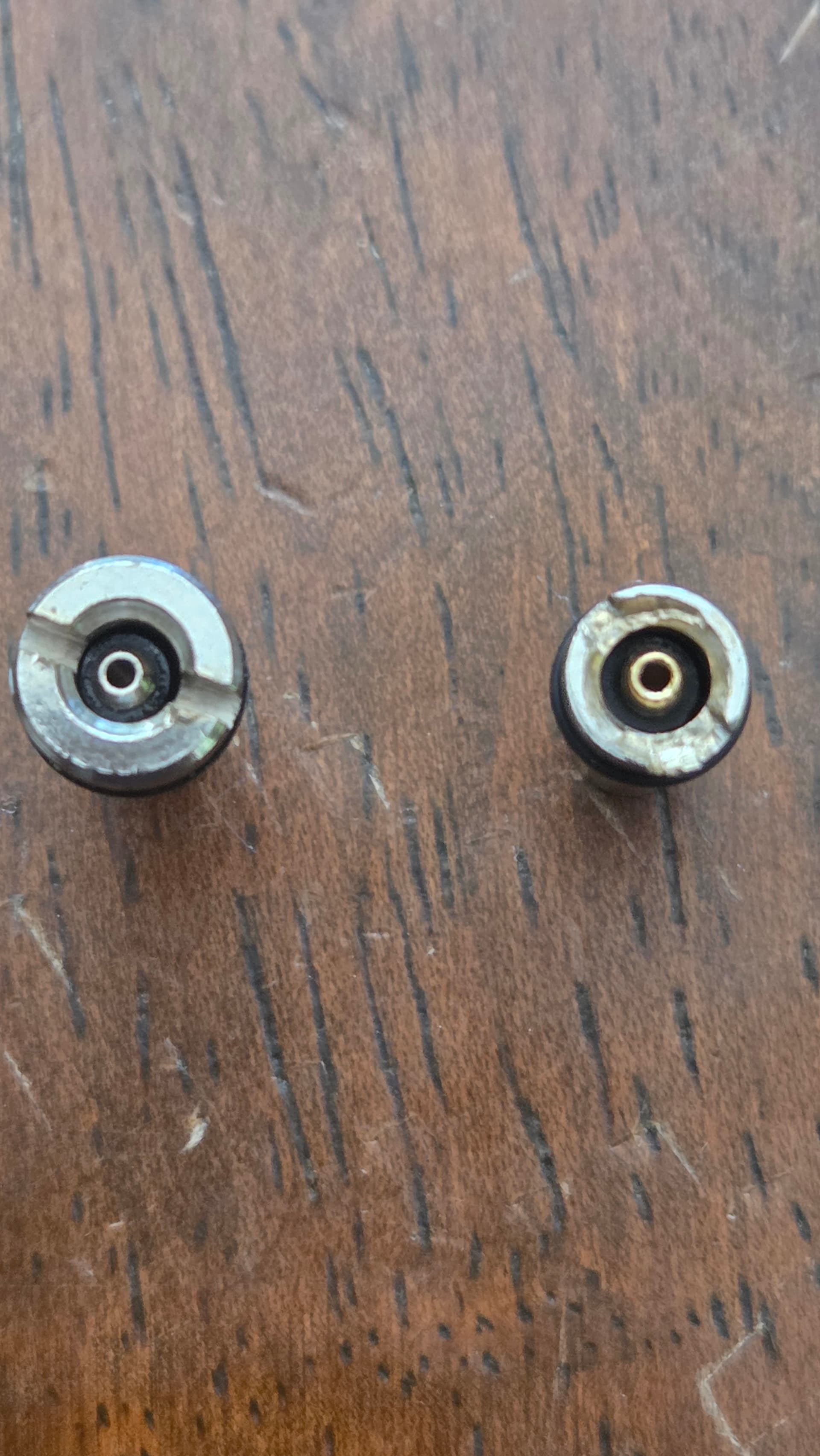

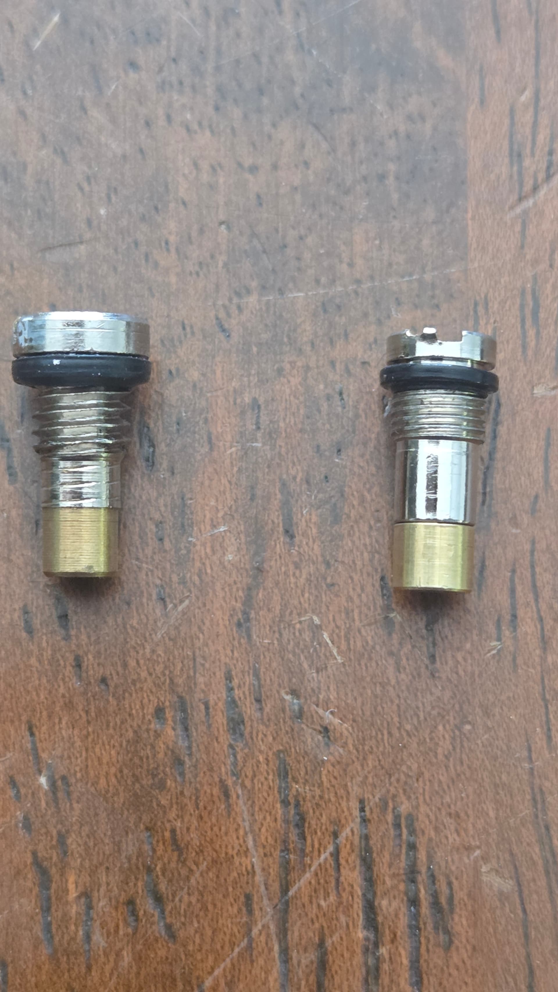

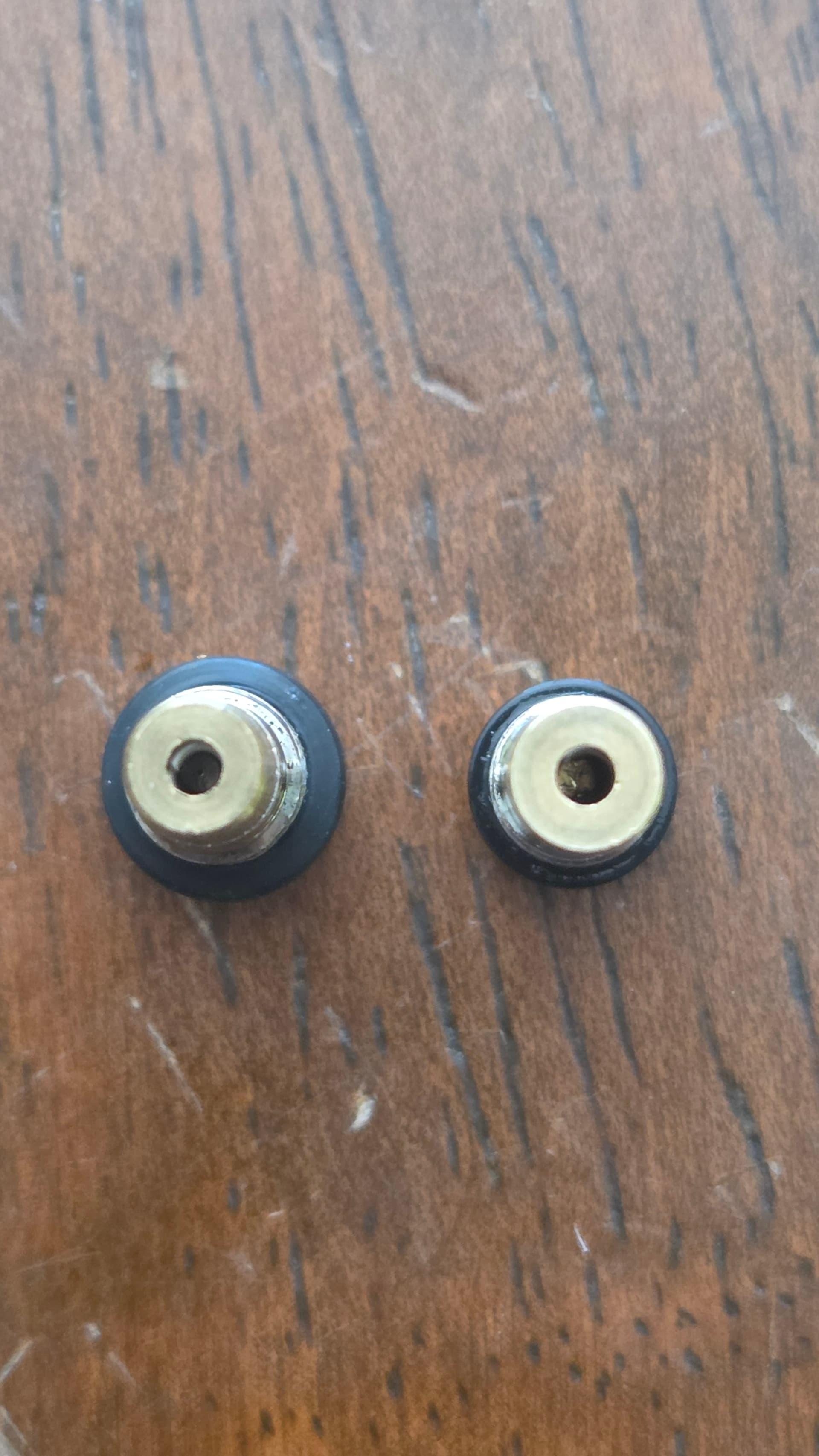

Trying to find inlet valve for a savia staccato magazine, as pictured on the right, compared to a hi-capa on the left. The savia is slightly smaller and has a tighter thread. If anyone knows where I could source it l, would be appreciated.

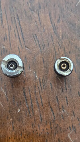

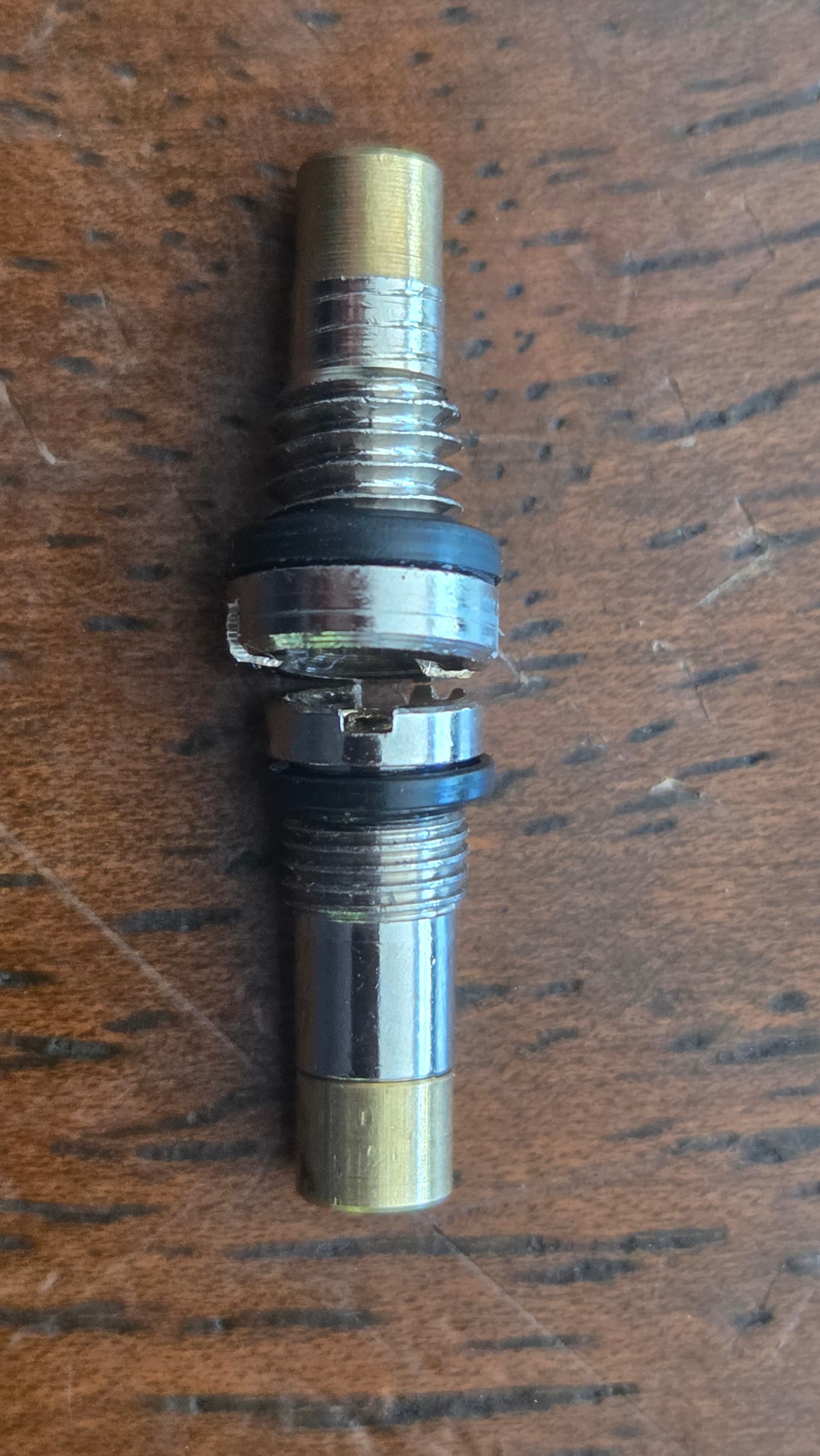

Problem is the gas is coming out from the centre and not the outside (threaded) area. Is there a way to disassemble the valve?

Yes, you can remove and service the inlet (fill) valve on a gas blowback magazine, but completely tearing down the tiny internal components of the valve itself is usually discouraged. [1, 2, 3, 4, 5]
How to Remove and Service the Inlet Valve
  • Depressurize the magazine: Press and hold the rear striker valve to empty all remaining gas before attempting any work.
  • Remove the valve: Use a specialized valve key or a small flathead screwdriver to carefully unscrew the fill valve counter-clockwise from the magazine body.
  • Clean and lubricate: Wipe away dirt and apply a few drops of silicone oil to the external O-rings to fix minor gas leaks. [1, 2, 3, 4, 5]
Why Internal Disassembly Is Not Recommended
  • Fragile parts: The internal spring, tiny center pin, and internal O-rings are extremely small and easily lost or damaged.
  • Inexpensive replacements: Because fill valves are considered cheap, fragile consumables, most techs simply replace the entire valve unit if it is severely damaged rather than rebuilding it. [1, 2]

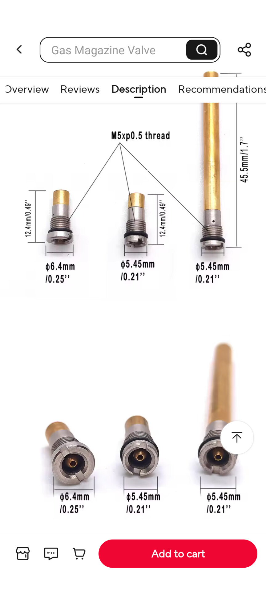

What’s the dimensions?
Outer ring, thread, length etc? Having a look on Ali there’s a few that look similar.
