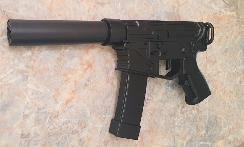

It’s literally a piece of piss to cut and shut magazines provided they’re roughly the same size, and even if they’re not it can still be done.
Years ago I grafted a stick mag lower onto an M4 stanag upper for an M4 pistol build. Looked cool, worked fine, albeit shit capacity. M4 receiver, Vector suppressor for a handguard, Scorpion EVO / M4 mag. :laughing:
Rear wired to an XT30 plug, concertina battery wire ran up to a box attached to the sling.
With any custom mag, once the shell’s sorted the terminal wires and feed tube are easy. Same principle applies when you make custom drum mags… of which I’ve made plenty. :+1:

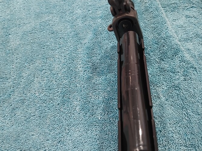

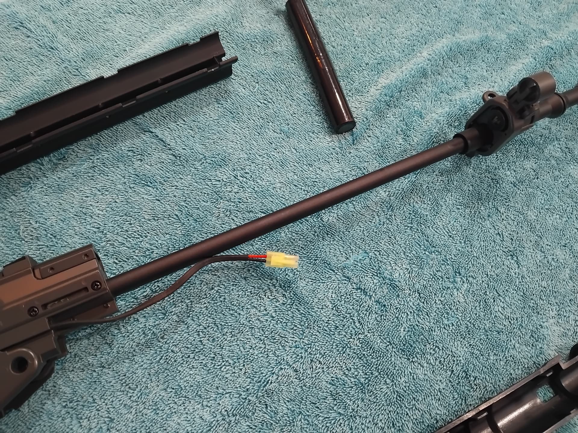

Okay… battery box sorted… a bit complicated, and i’m sure @shadow187 will be interested.
The space for the standard battery is…non- existant.

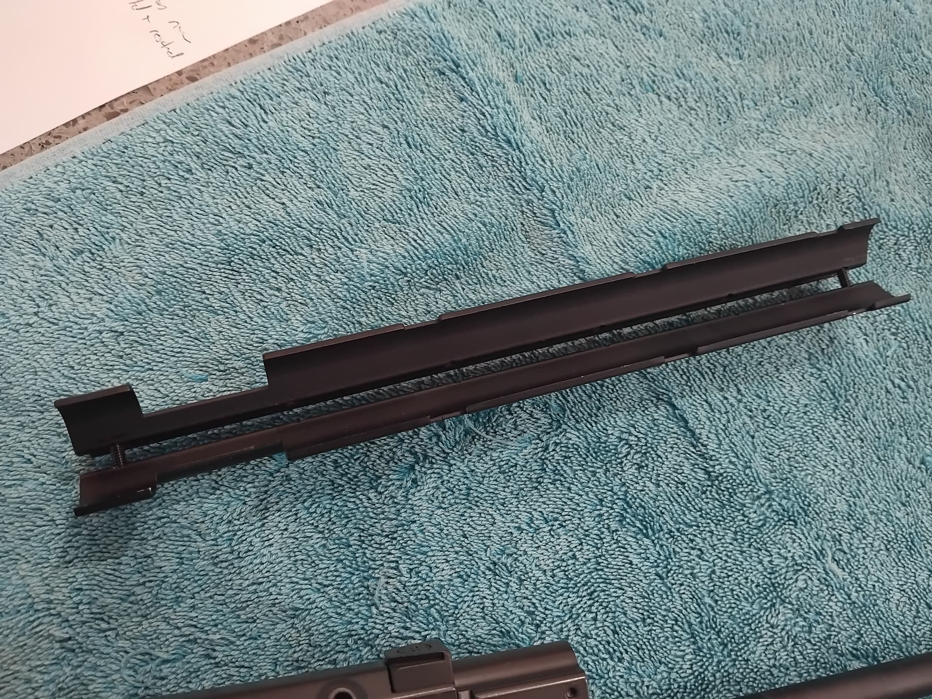

Taking the top cover off, there is a tiny space, compacted by the " rigidity rail".
This rail runs from inside the blaster, all the way to the front, into the front iron sight. It stops the front iron sight from rotating.
It comprises a “floor”, and two “sides” one on each side of the barrel screwed together. You need to remove the front sight, to get everything off.

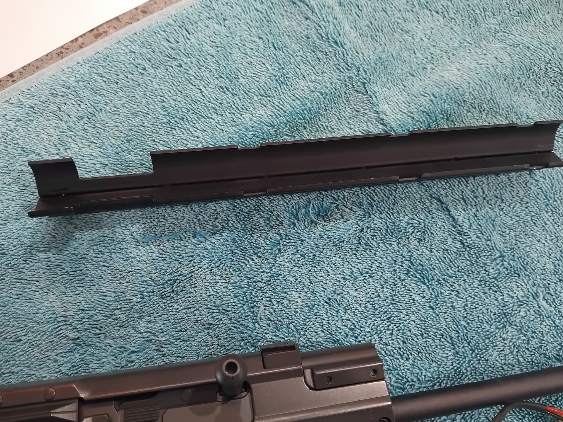

two options…
1: Remove floor, and side rails.
Nothing in there now, except the barrel. Problem is the battery bangs and floats around, making noise.

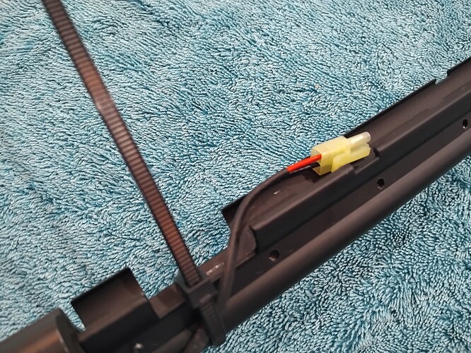

2: Remove floor… keep side rails screwed apart.
I used my own longer, 16mm M4 screws. One in the front, 1 at the rear.
Lightly screwed in, it keeps the parts together, but able to slide outwards to create more space. This helps retain the battery, stops it from moving and banging around…
This photo… the floor is gone…how it looks if the 2 sides are screwed together tightly…
Now, one screw front and rear…its able to move apart, wider…

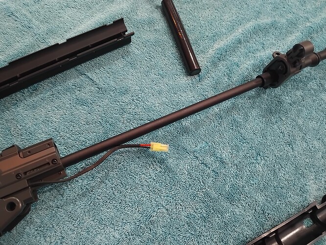

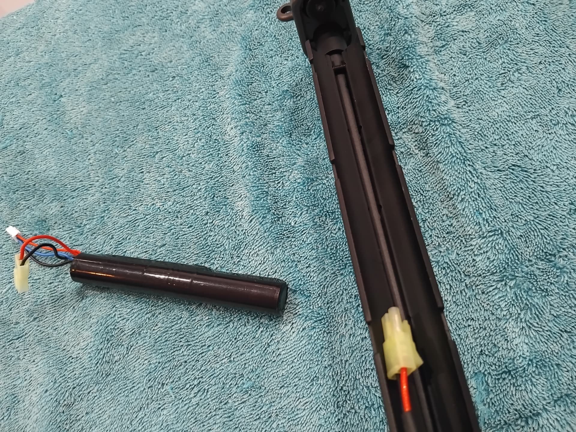

A cylinder battery fits perfectly/ tightly in the groove. Have the " raised bit" of the battery, facing down in the channel. this gets the battery as low as possible, and doesn’t put upwards pressure on the battery cover.
Barrel with everything off…

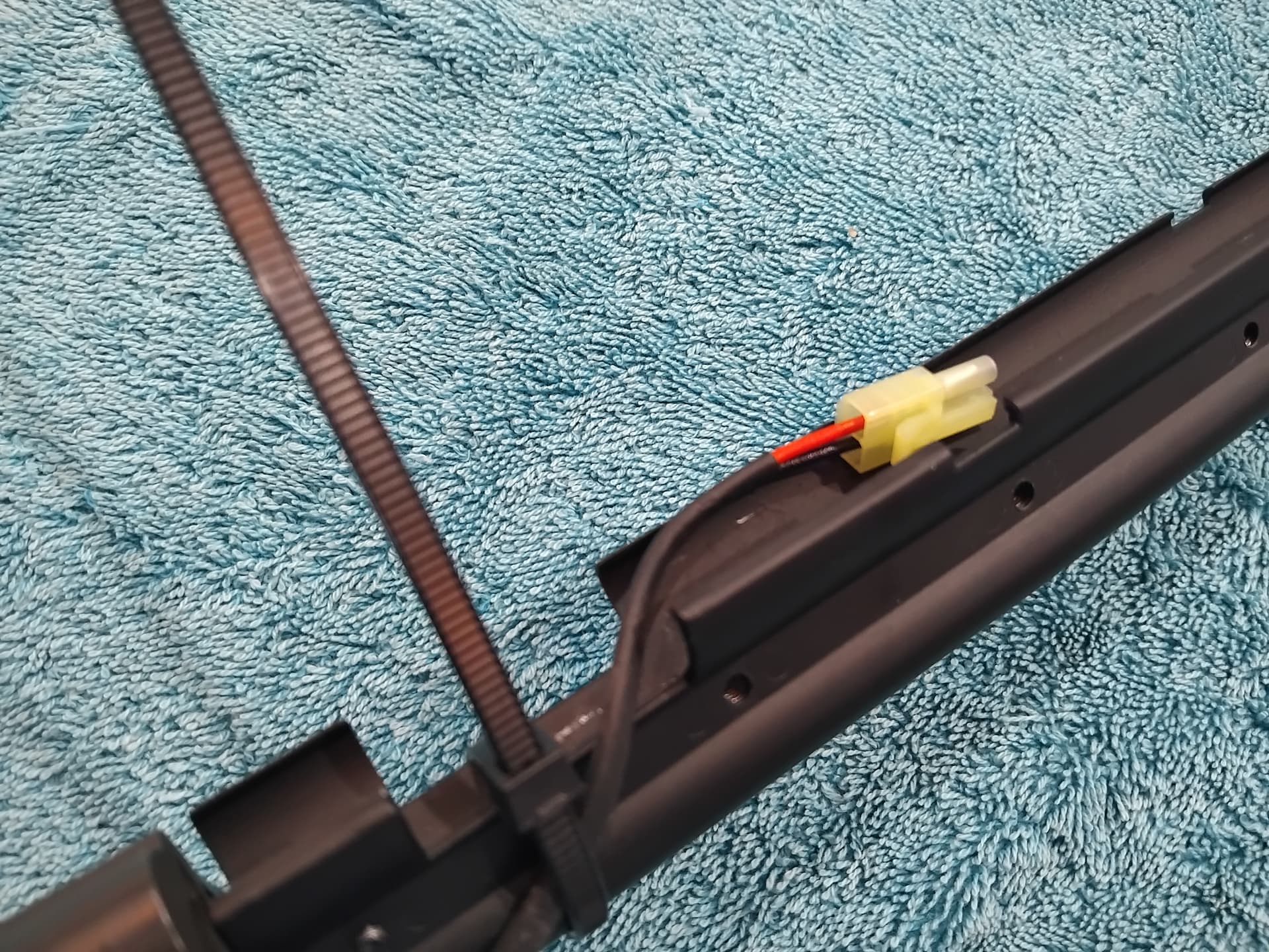

I used a loose zip tie, to retain cable / keep it all from moving too much…

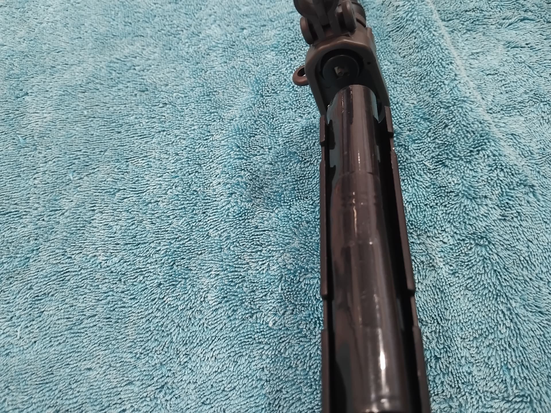

Channel can still open.
Central channel opened up…
And, battery in…no moving, no bumping no noise…

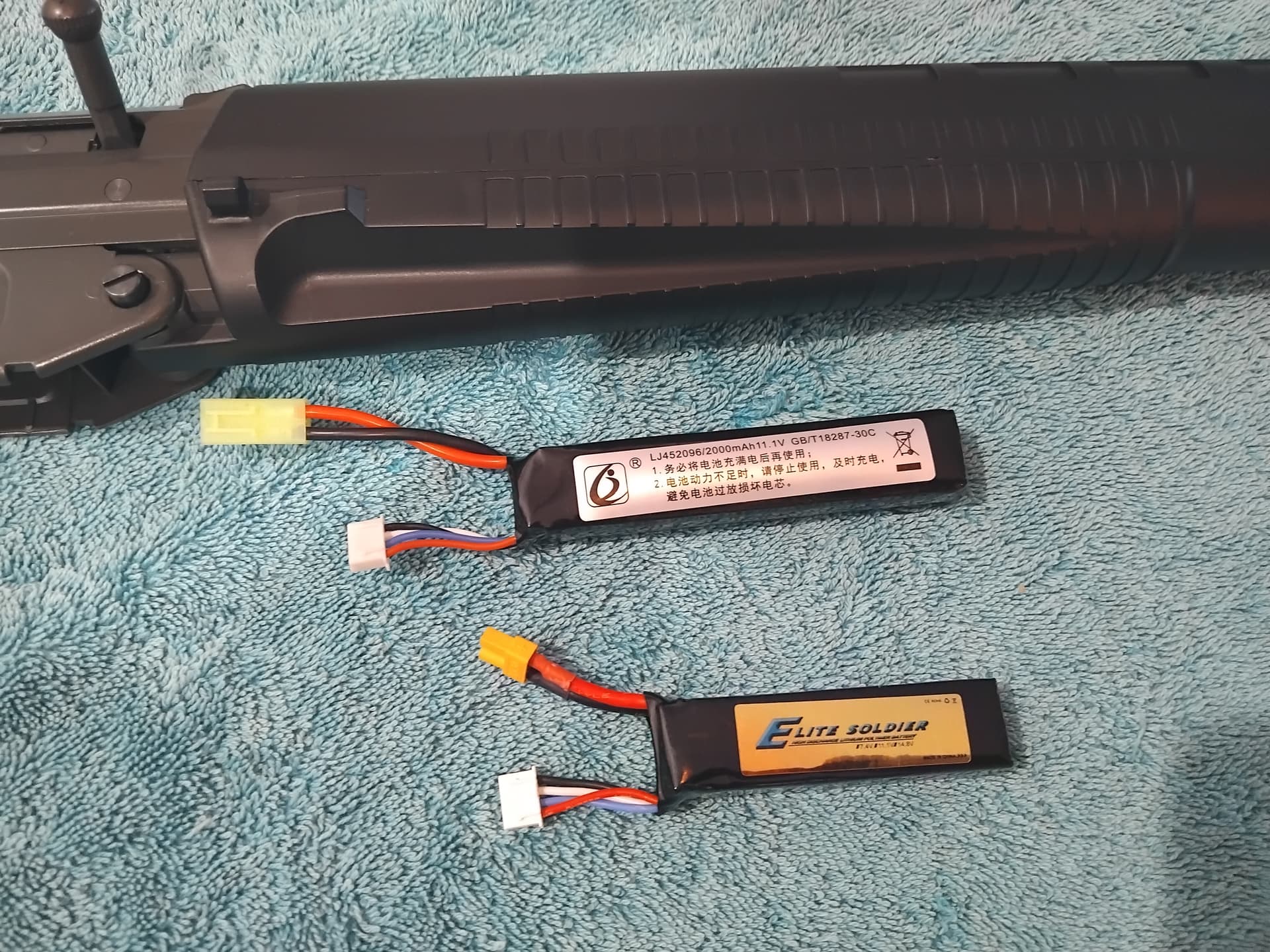

With these batteries…
the bottom one, was supplied. It fits.
The top one is larger…and does fit, but jams in tight, with pressure on the cover.
Me No Likey.
It seems the cylinder battery is the one to use…larger capacity, fits in the channel, and no pressure on the cover.

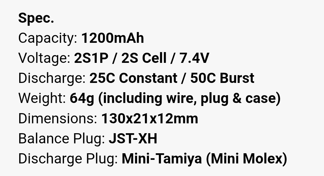

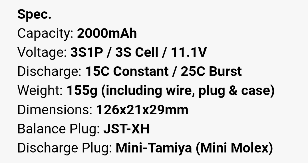

Found my Turnigy 7.4v in my cupboard fit a lot better than the supplied battery as it has thinner dimensions however was still a very tight fit and mines handguard is stiffer than a week old dead hooker that’s been discarded in a ditch to slide lock in and out of place
Was thinking of looking for an 11.1v Turnigy battery the same size but sounds like this procedure may be the way to go
It’s a pity HobbyKing are out of stock
https://hobbyking.com/turnigy-nano-tech-1200mah-3s-25-50c-lipo-airsoft-pack.html?srsltid=AfmBOoqt87e-MsBEMMVfR_AOQ9VWWaLqg7Hp_wwBfNbC6KPATwHIqo0T
Maybe check the others out available in Aus warehouse.
3s liPo for RC Gadgets - HobbyKing

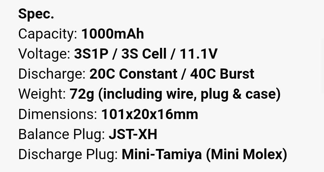

Dimensions are a touch off, but this one may do the trick…
https://hobbyking.com/en_us/turnigy-nano-tech-1000mah-3s-20-40c-lipo-airsoft-pack.html
11.1v
Hmm might not be enough mah
7.4v
Hmm this would be perfect if it fits
This one might do the trick

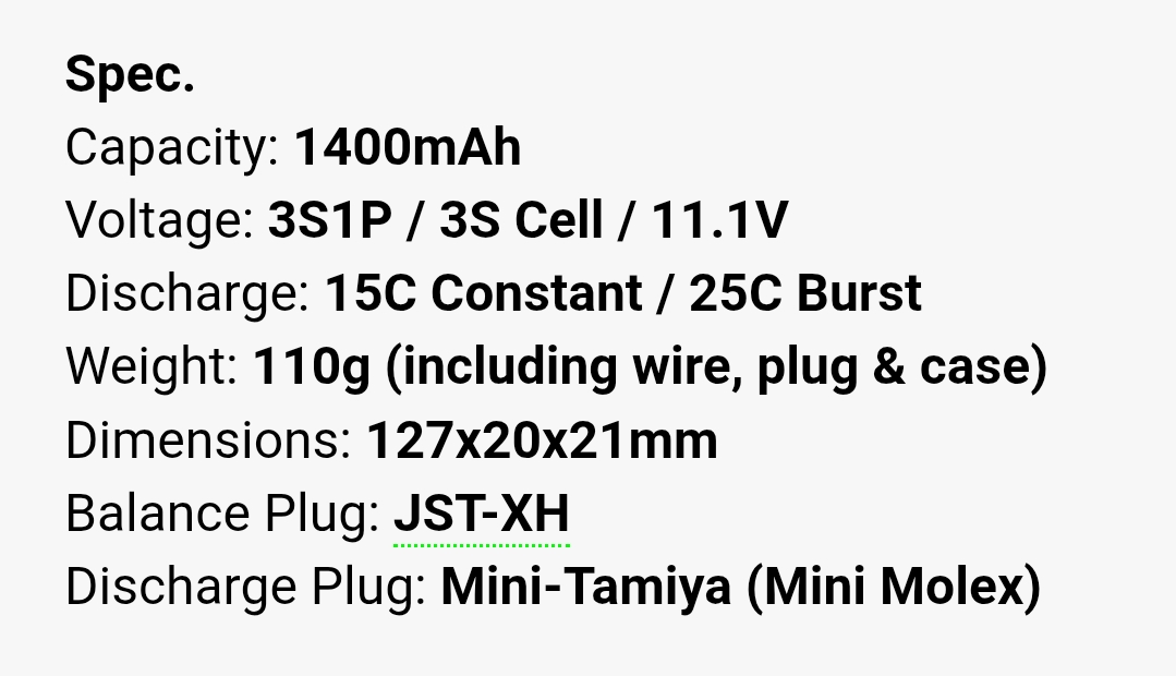

in all honesty, the channel is designed to hold a cylinder battery
One of these suckers.
https://www.ebay.com.au/itm/388738027164?chn=ps&_ul=AU&norover=1&mkevt=1&mkrid=705-173151-935305-0&mkcid=2&mkscid=101&itemid=388738027164&targetid=2274341502412&device=c&mktype=pla&googleloc=9192454&poi=&campaignid=20941864726&mkgroupid=154517671861&rlsatarget=pla-2274341502412&abcId=9367982&merchantid=7364522&gad_source=1&gad_campaignid=20941864726&gbraid=0AAAAAD97CxSrfW4rV_qI4eG-ZMmZn6oxH&gclid=EAIaIQobChMItK6I2_WwlAMVNbspAx2RNy4OEAQYASABEgIcX_D_BwE
Cheap, reasonable capacity…change the plugs and done.
I may grab one, and let you know how it goes.

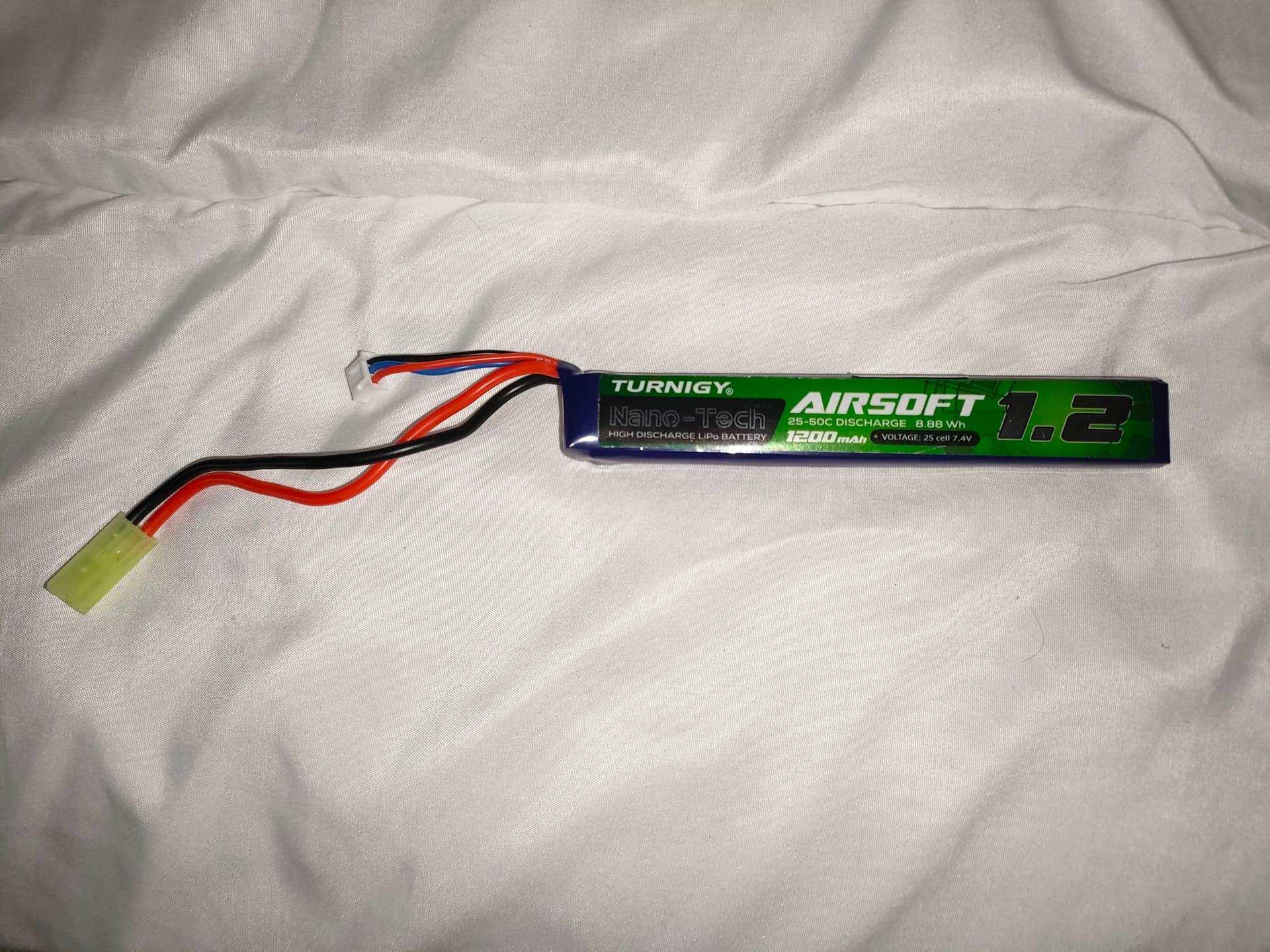

My current black one is 7.4v, and has mini tamiya plug already.
It fits fine, and goes fine.
More capacity than the smaller, supplied battery…
