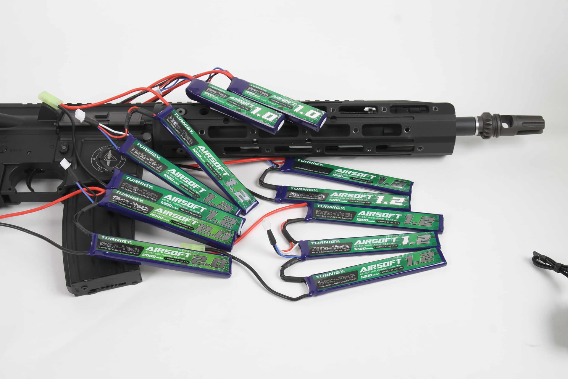

I really wouldn’t recommend any of the lipos that are covered in chequered heat shrink… garbage.
Dubious Chinese batteries, sub standard quality and absolutely spurious capacity ratings. Put them on a B6 discharge / balance charge cycle and that “2000mAh” battery usually ends up being about 500mAh in reality.
A smaller capacity Turnigy or other better quality battery will always outperform a chequer battery all day every day. There’s a reason they were the batteries that came included with Jin Ming blasters back in the day.

I dig out some turnigy batts, and see how they fit in the avail space…its pretty tight…
It’s a pity the Turnigy’s don’t come in cylinder batteries, at least not that I’ve seen

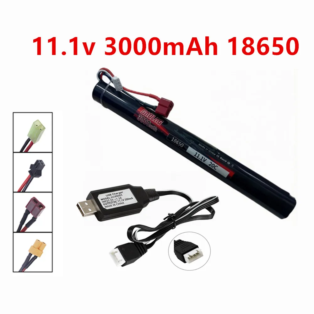

Something like this although I haven’t checked the dimensions of this one
AliExpress:
For Mini Airsoft Gun RC Model Toys Accessories 3S 11.1V 3000MAH 18650 Lipo Rechargeable Battery Small Tamiya /T/XT60 Plug

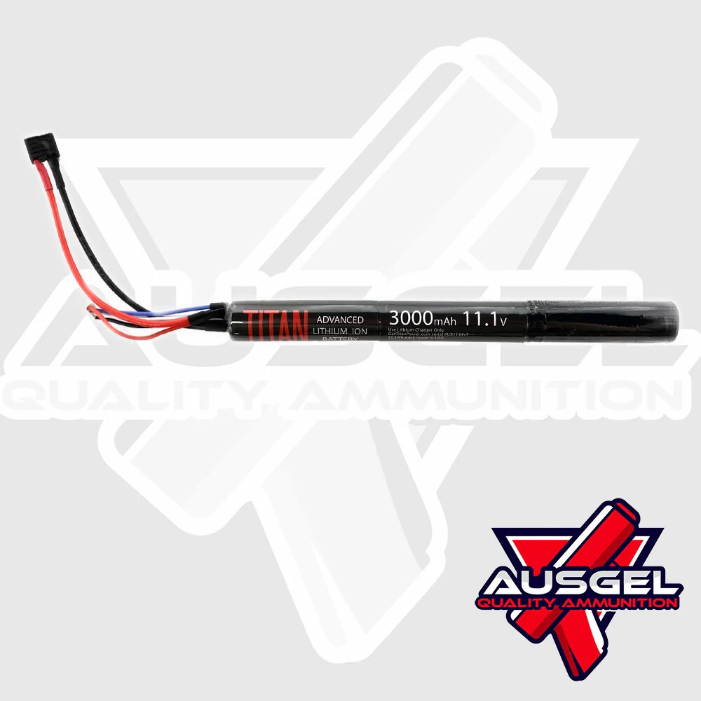

The Titan 11.1v Stick is the best option for the JG SIG 550 and 551.
Not many available anymore.
Would the one in my above post suit you think? On second thought, the titan looks way thinner

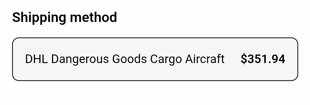

Apparently still available here, not cheap tho
Yikes, shipping through the roof, I’ll leave this battery for beemer :sweat_smile::joy:
It would. Any 3x 18650 fits like a glove… room is tight but a long round one is what they are made for.
Titan batteries are of the thinnest 18650 equipped batteries. And use good quality Samsung… or LG cells depending on the production batch. They are not cheap but with batteries you do generally get what you pay for. An actual good quality 3000mah battery cell usually runs a bit over 12 AUD a piece, so half the price is the cells themselves.

I like Titans, but they do not suit higher amp drawing stuff. The get hot with too much amp draw, and when they get hot their output drops. They also take a long time to cool down once they are hot. If you have things close to stock levels of performance, or just under 25rps they are totally fine, and will last all day. Approaching 30rps though without a brushless motor they start to show their weakness.
The other main downside is I got sick of repairing them. If you continually bend the nickel strips to fit them in various blasters the strips break. Easy fix for a handy with a soldering iron f***er like me, but still dangerous as you are soldering live DC electrical things to 18650 batteries. They also become not so thin once I have repaired them- leading to less easy fit, tighter and more bending… the positives are reduced once repaired.

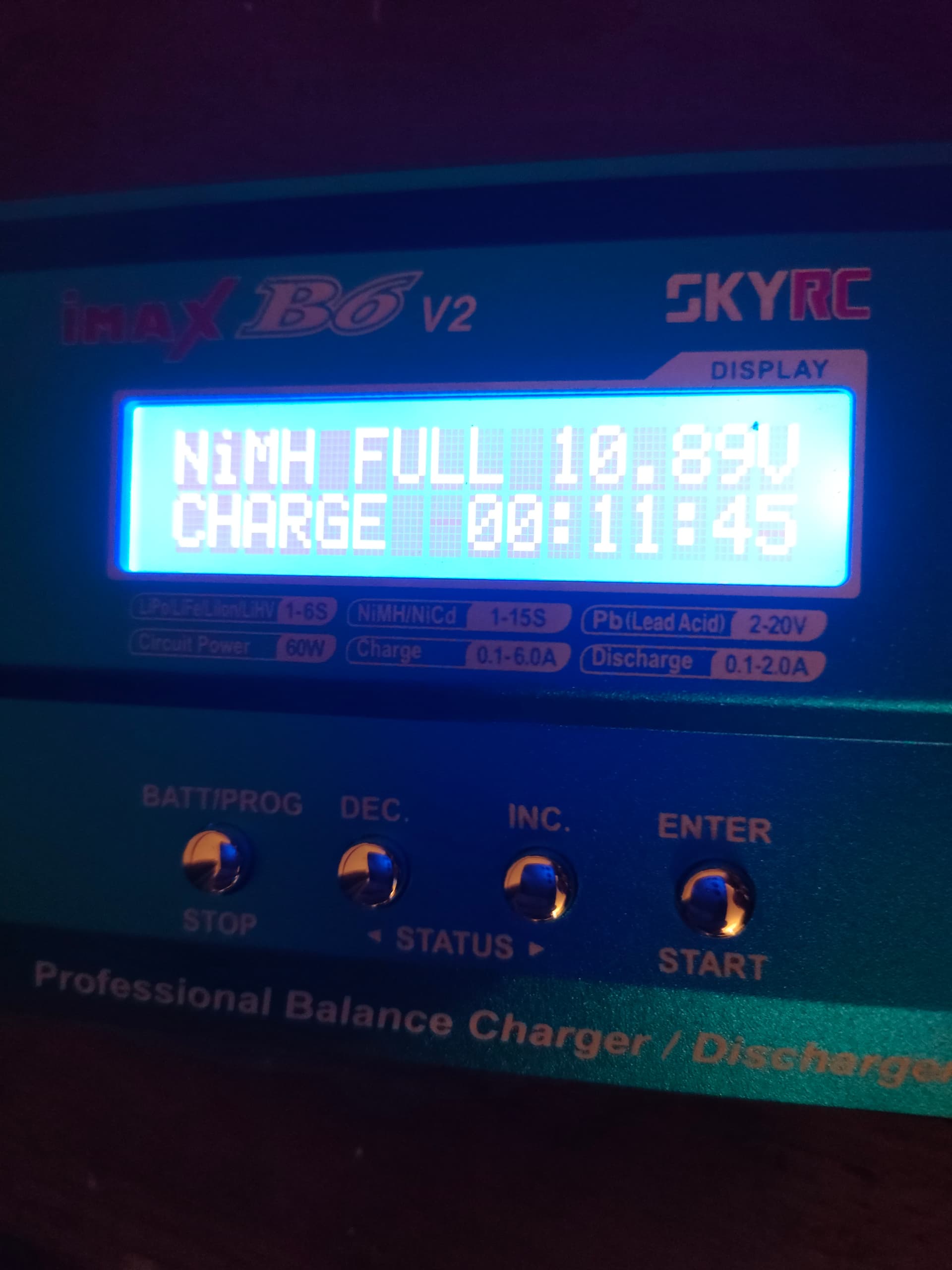

I just used my imax b6 v2 balance charger to charge my 8.4v ni-mh battery that came with my MP40 and holy :poop: it’s damn near scorching hot afterwards, it’s a bit worrying… for some reason it’s saying 10.89v when it’s an 8.4v is that something to be concerned about? I don’t remember it getting this hot last time I charged it

Nimh batteries do get very hot on a fast charge.
Should be able to lower the charge rate in the settings to take longer. Can’t remember exactly where in the B6 been a few years since I touched one.
