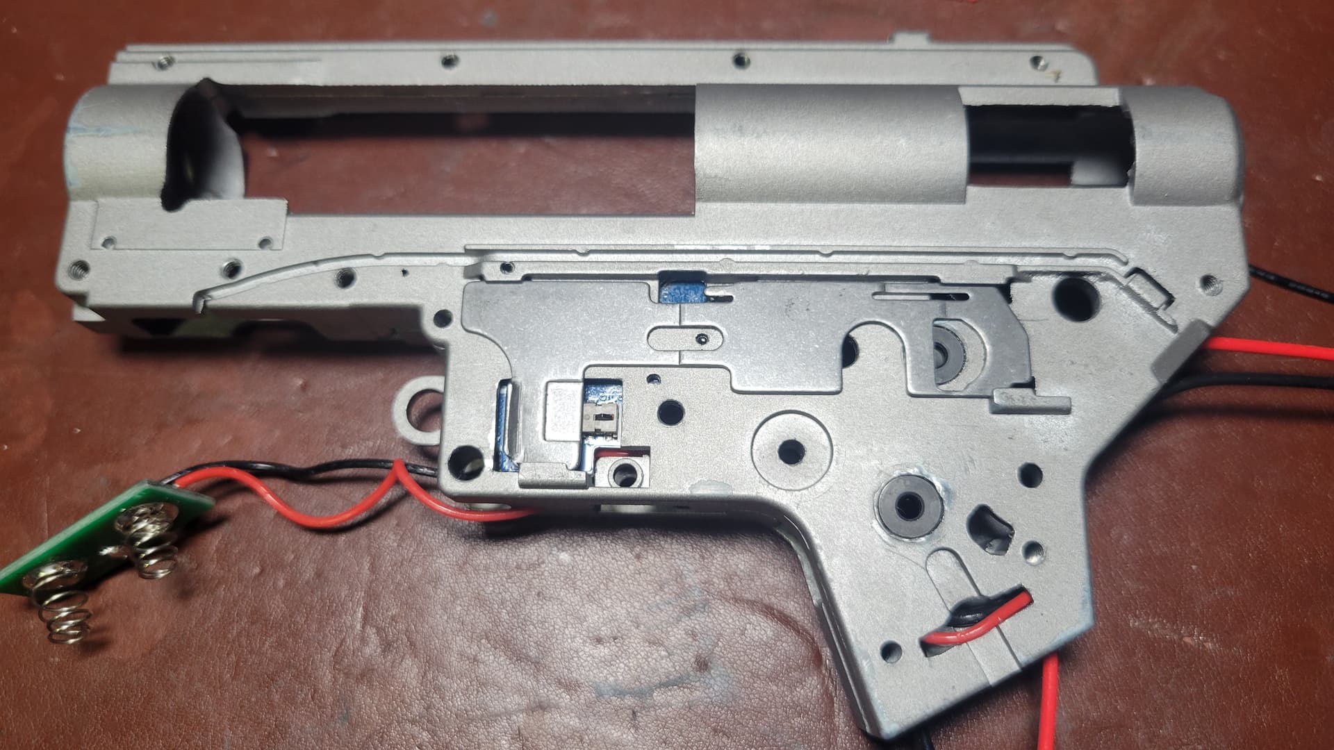

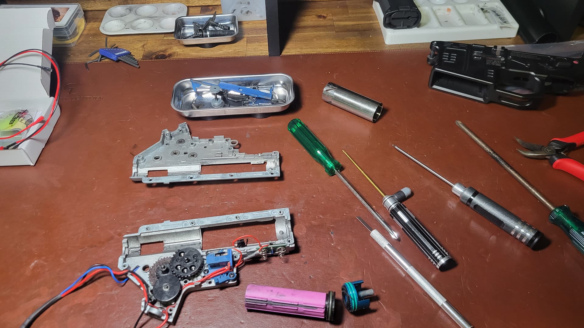

After much faithful service its time for an overhaul.
Not an expert on trigger trolley’s by any stretch of the imagination but the old one was starting to hang up for some reason and the contacts didn’t look too healthy. Also had a squashed magazine wire that needed some love and a cylinder head that was starting to get mangled, the gearbox was in much need of some lube, when it doubt, add lube
Ordered a T238 basic DTU, 40cm hopup barrel, stronger return spring, full cylinder, new cylinder head and some 13:1 gears. Will stick with the 29k brushed motor for now.
Haven’t started a build from a bare gearbox with new gears and an ETU before, so this should be fun
OG trigger trolley setup

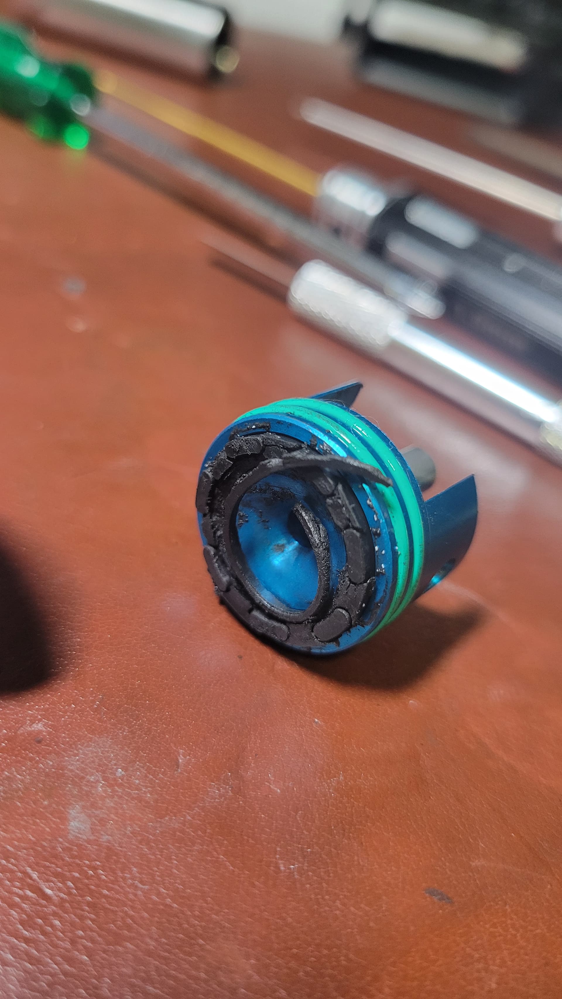

Mangled cylinder head, I didn’t choose wisely. An LDT style will be going in next

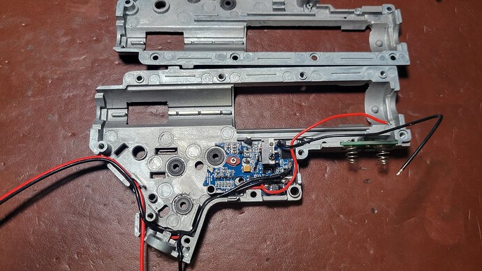

ETU in, yeah the washer looks weird - I’ve since located the proper screw and washer

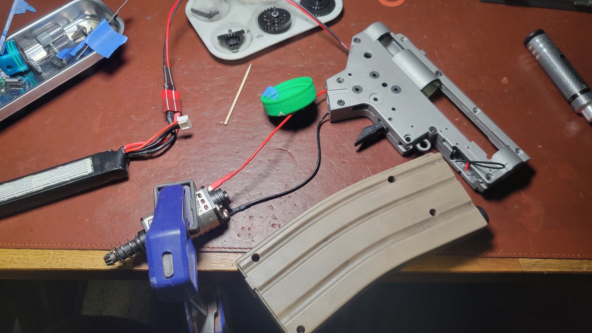

Some redneck “did I put the magazine terminal wires in the right place” testing

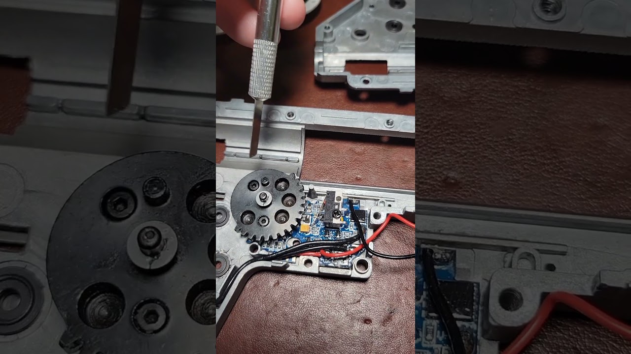

You can put the trigger, sector gear, and selector plate on, close the gearbox up and bang it in the lower.
Connect a motor (preferably a stock shitty one and clamp it down).
Plug in battery. After hearing the beeps, roll the secotr gear and you should see a light flash everytime it is detected. If not, adjust shimming to suit or ETU position.
Move the selector plate and you should hear it beep when it goes between auto and semi. Ideally about half way between semi and auto works best but some boxes/lowers/selectors are finicky.

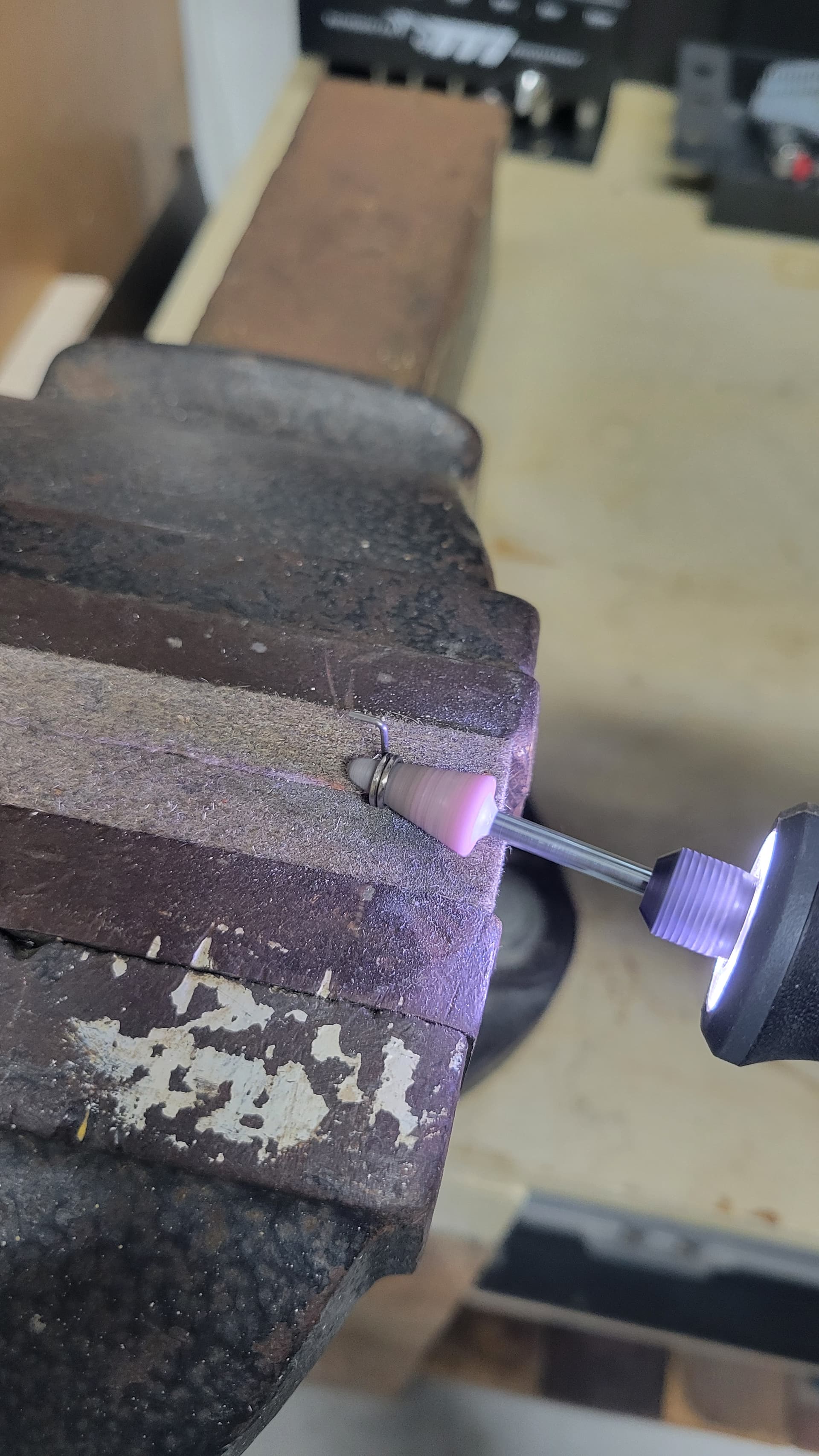

If it doesn’t beep, trim the rear of the selector plate where the button is. Also be sure to give the selector plate a nice smooth rounded edge so you don’t risk grabbing the wee switch.
And if course, if the selector has the metal sleeve, bin it.
Finally pull the trigger and the motor should go, then stop and whinge when it doesn’t detect the sector gear moving.
Nice to test the function before fully assembled!

Thanks I’ll start working my way through that check list. One thing though, the entire selector plate is metal, will that give me grief?
That makes removing the metal bit hard!
I normally put a wrap of electrical tape around the arm to insulate it. You shouldn’t need to but safe not sorry theory.
The beauty is rather than trimming the edge you can just put a slight bend in it over the switch to adjust the timing between semi and auto change if needed.
Haven’t closed the box up yet but performed this test first.
The ETU is beeping when manually moving the selector plate :+1:

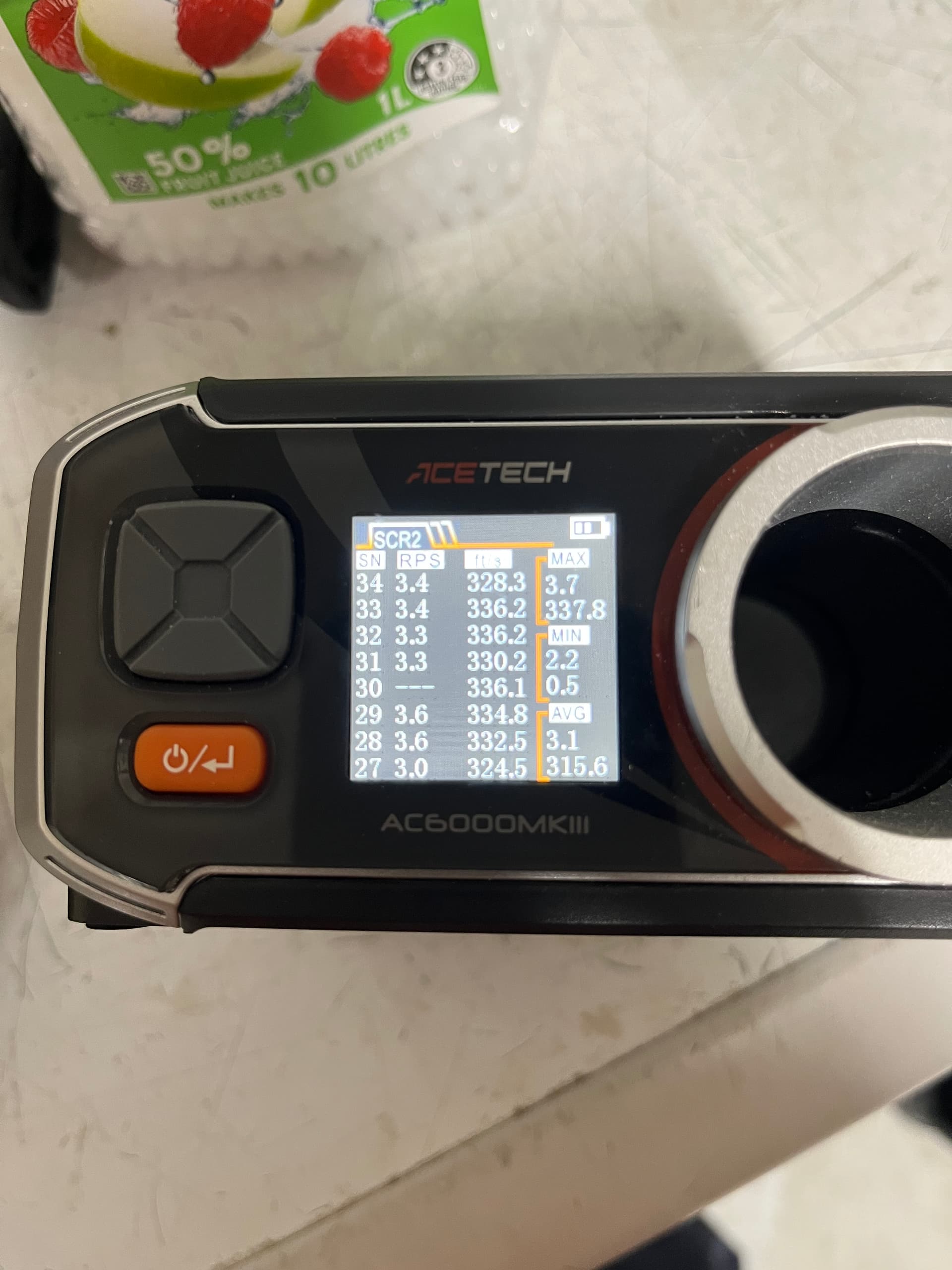

Nice to put a box together and have it work first time! Well second, I had the magazine terminals screwed up.
Accuracy is a bit sloppy but I’m using old gels so hopefully thats it
Auto
Semi
I see the problem. Only 50% fruit juice. Try 100% and you’ll be on fire :fire:

Nicely done Jug! Some pretty tight consistency on that one!
Gotta love a CYMA metal box once you know the tricks on them!
Maybe the 3 star health rating is also holding me back? :sweat_smile:
