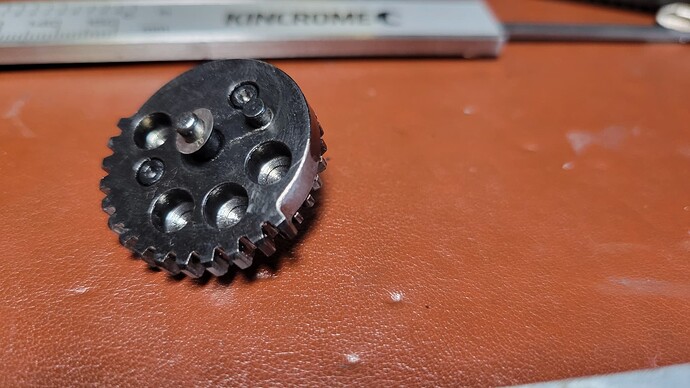

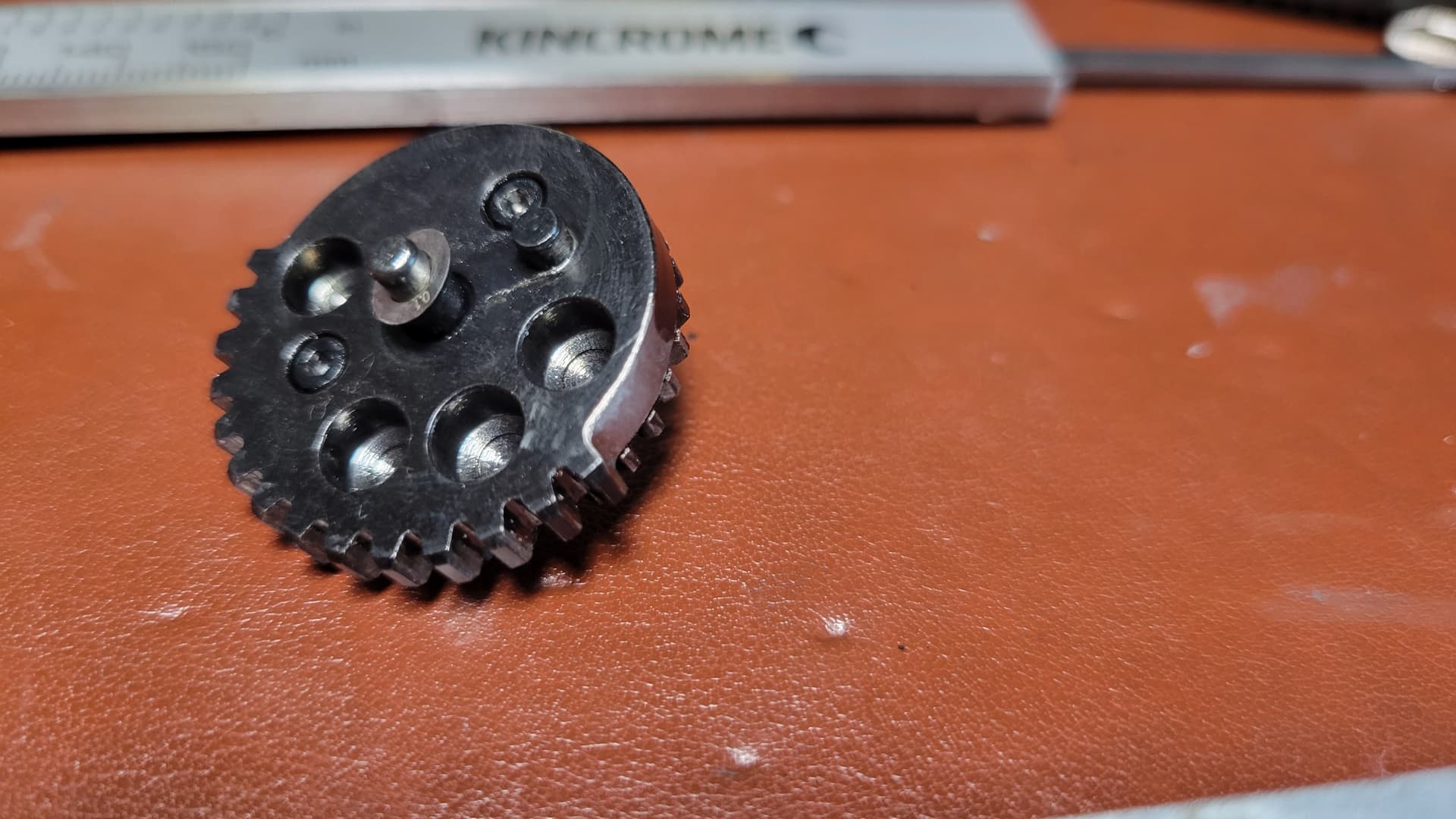

The 16:1 gears being used came out of a blaster that a shop repaired a while back, seems like two teeth have already been removed. Now 14 teeth total.
Anyway its shimmed ready for some new bits.

Neat job of the short stroking too.

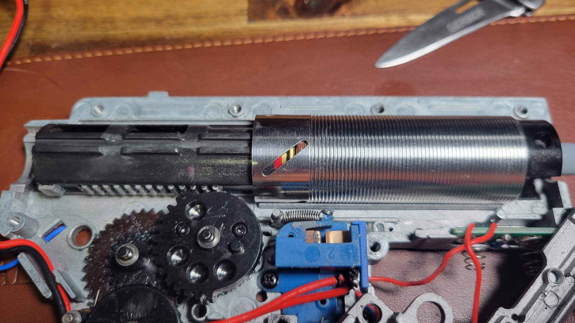

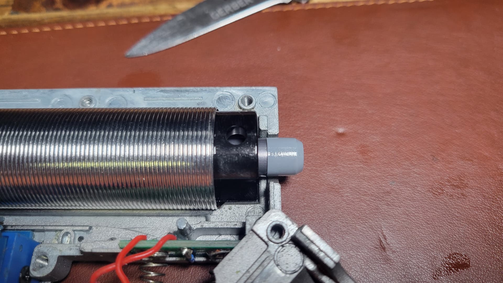

Put an %80 cylinder in with a couple of bits received from AkGelblasterau
Nozzle
Cylinder head

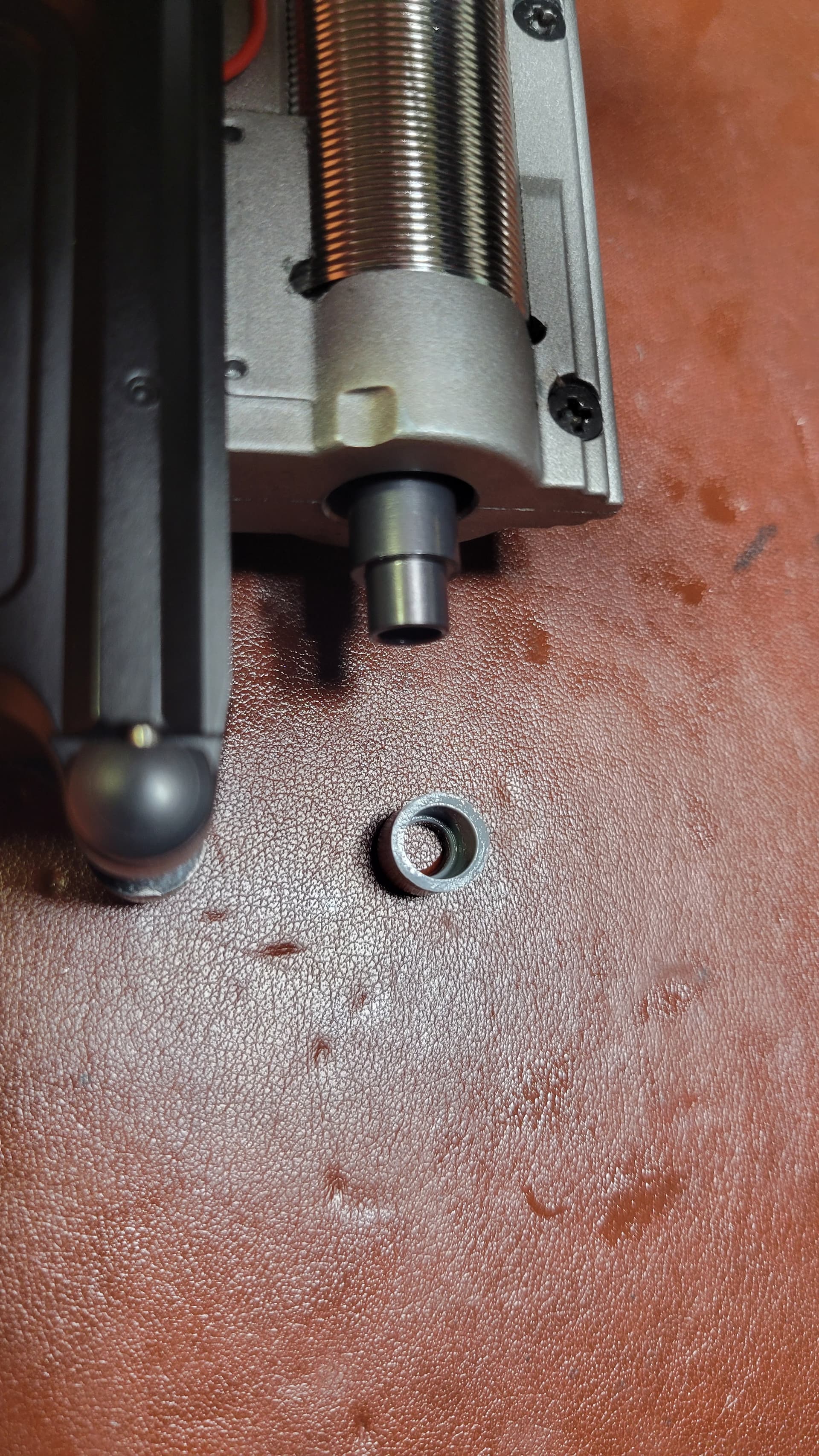

Initial airseal tests were very good. Need to glue the nozzle on, should’ve done that beforehand

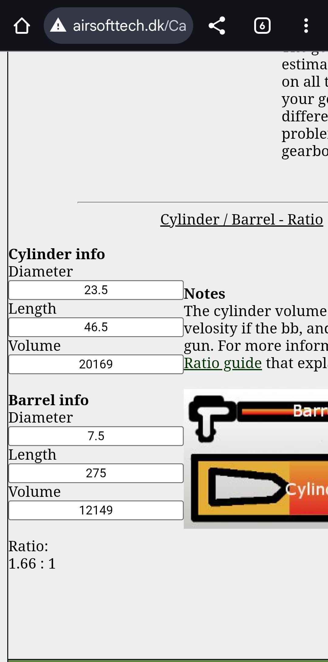

Checked the swept distance of the piston to the best of my knowledge and came out with a good VE ratio
Bit of a weird result, FPS dropped from 320 down to 270 with the odd gel dribbling out of the barrel. Might go back and just replace one part at a time and see if I can narrow down the culprit.
What did you use to glue the Nozzle rubber on with? Just a thought :man_shrugging:
Roughed up the surfaces then used this stuff
The nozzle fell off without any resistance whatsoever :sweat_smile: So that glue is not fit for purpose, CA glue next.

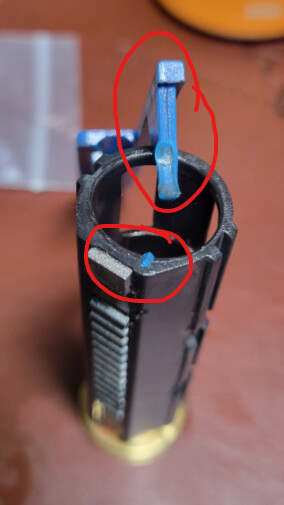

On another note while taking it down I did notice some damage to the tappet plate, a very small piece had also some off.
That is where at some point the sector gear has gone backwards into the tappet.
You can press and or shave it flat, it should be fine. But does mean it is worth checking the anti reverse latch (if the anti reverse latch spring broke at some point this can happen)
Yep super glue or Gorilla glue polyurethane is a good one don’t need much.

Sure enough the ARL spring had become dislodged and wasn’t, er, springing

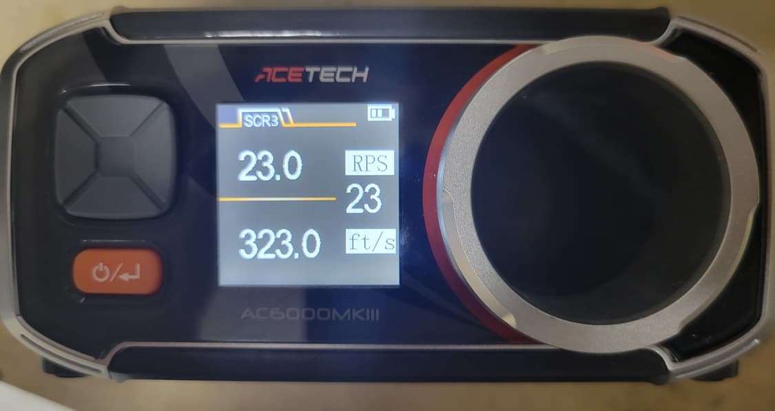

Landed with 23 RPS and 300 FPS, certainly getting in plenty of practice pulling down gearboxes :+1:

I was about to say if you put the original nozzle back in or spaced out the new one with a small o ring your FPS would be back up there again. But you beat me to it. :smile:
Like Rok has said in his videos, trial and error until you find the best fit. :person_shrugging:
But it definitely sounded like a loss of airseal at the t piece. :thinking:
