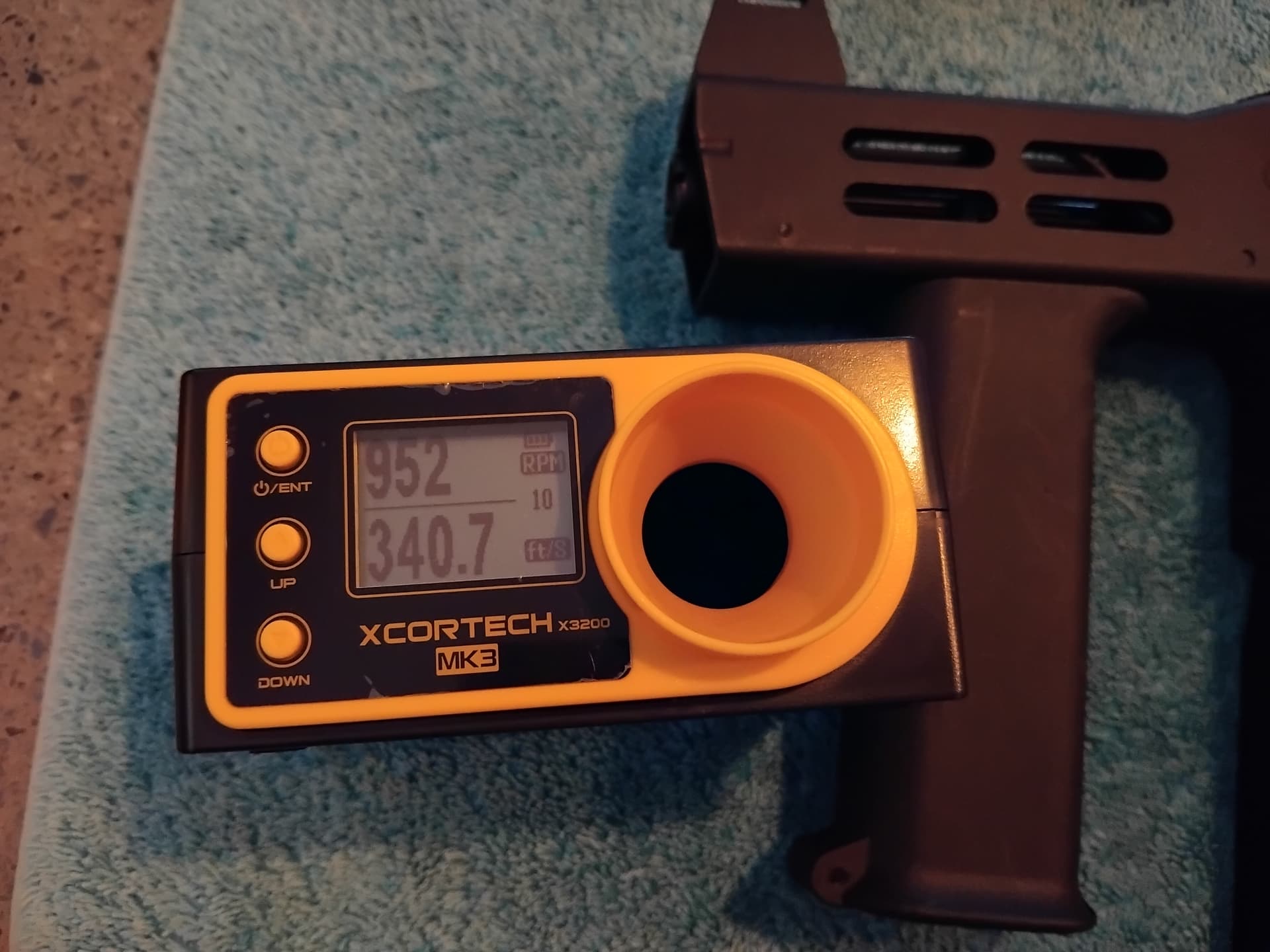

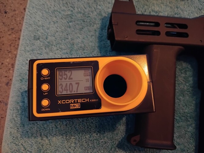

Well, what can i say…??
Another day, another 340 fps Roksolid build…!!
Honestly, this is getting too predictable now…!!

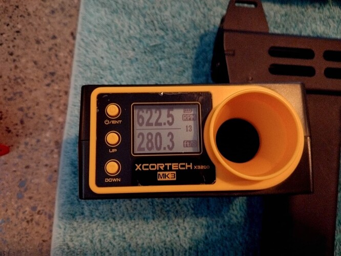

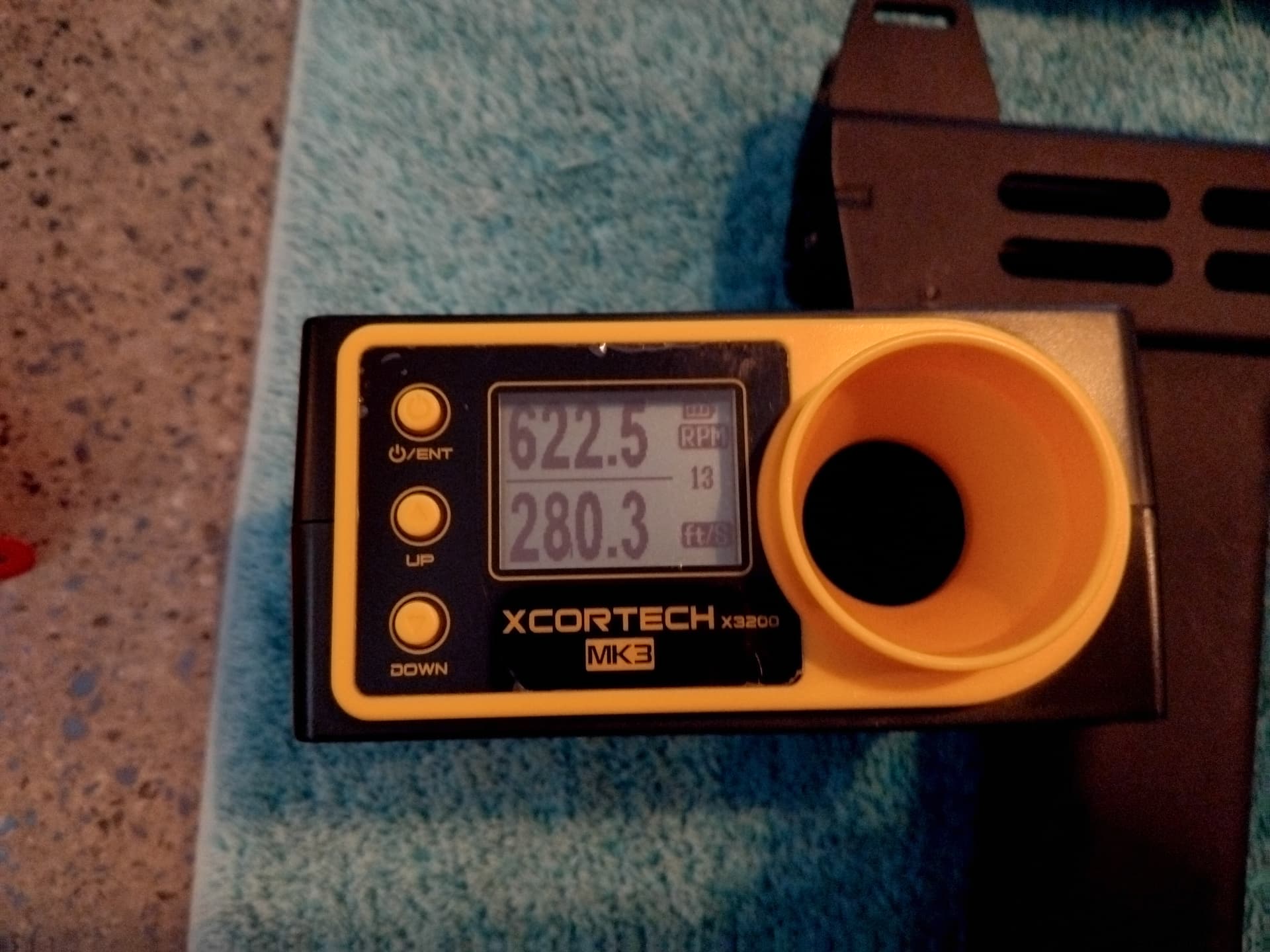

All jokes aside, got this back yesterday, from Rok.
Huge thanks, i know it took a lot of time and effort, for such a small little blaster…
i can understand you’re in no hurry to repeat the experience …!!
The 340 fps was a freak short burst…but captured on camera.
It mostly sit on 280- ish fps… which is a great result for a small unit.
Its running on a 11v battery, which has no double feeding issues on semi, and is a snappy trigger response.
The blowback has been disabled, … and ROK, the mag prime still does work.!
It is a bit loud, but thats to be expected from running a M100, to try to get the fps up from a short barrel.

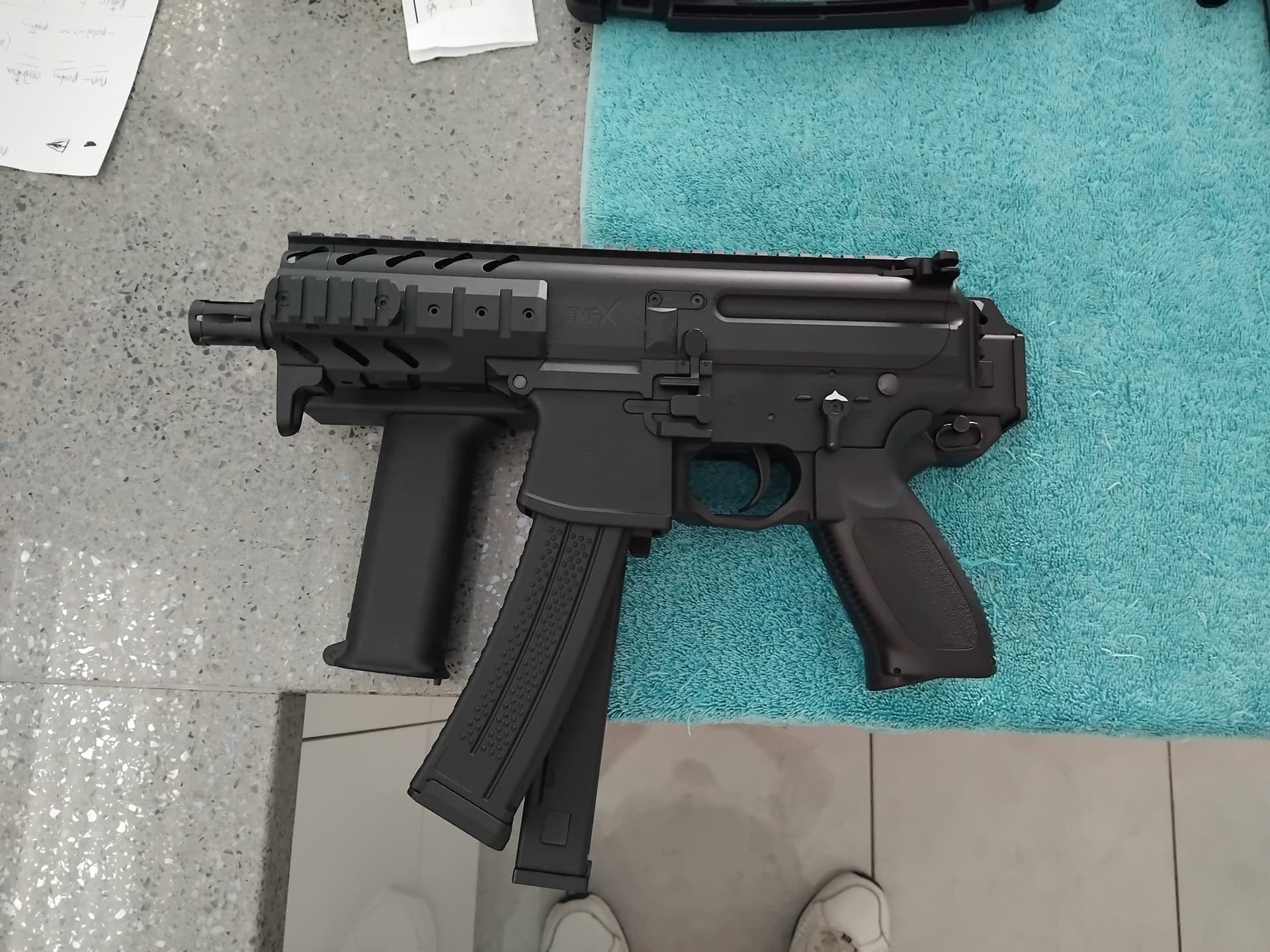

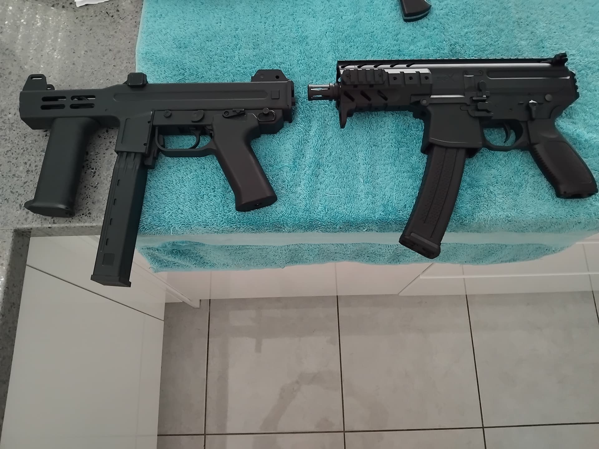

Comparo time, with the MPX rattler… similar style builds…
Very similar size and form factor.
Here’s a photo, one on top of the other…
very similar size… different performance route.
The MPX has the easiest path to better gains…
Just add a slightly longer barrel, a custom “M98 spring”… and you’ve got 310 fps.
The only annoying thing, is the spring TWANG…after firing…spring resonance.
You can stop it by having the spring under a bit of tension, by pulling the charging lever out a cm or so…
Any ideas how to fix it.?
Maybe some hot glue, where the spring is attached.?
Anyway, couple of easy tweaks and you have 310 fps from a shorty.
The MPX will double feed on semi on 11v, so running it on 7v fixes that problem.
It also has a slower ROF,. which makes the smaller mag last longer.
It benefits from a 7v batt.
The SPECTRE…
Lotsa mods and ROK swearing to optimise, and get it back together.
Even then, its still a bit louder than the MPX, for less slightly performance.
I doubt it would be possible to wring another drop of performance out of it.
The Spectre also benefits from a 11v battery.
No double feeding on semi, and it runs a whole lot better on semi on 11v.
Downside is , it empties your mag quicker.
Speaking of mags…
MPX mags are available locally…Spectre mags…Nope…
Just check the MPX mags aren’t backward wired, before leaving ihobby.
I do like the spectre… it fits into the " different and unusual" build…
And i appreciate ROKS efforts to get it singing.
However…
If you want a compact , cheaper nylon jobby ( MPX about $80 cheaper), with mags available…and a removable stock…and higher perfomance
check out the MPX.
