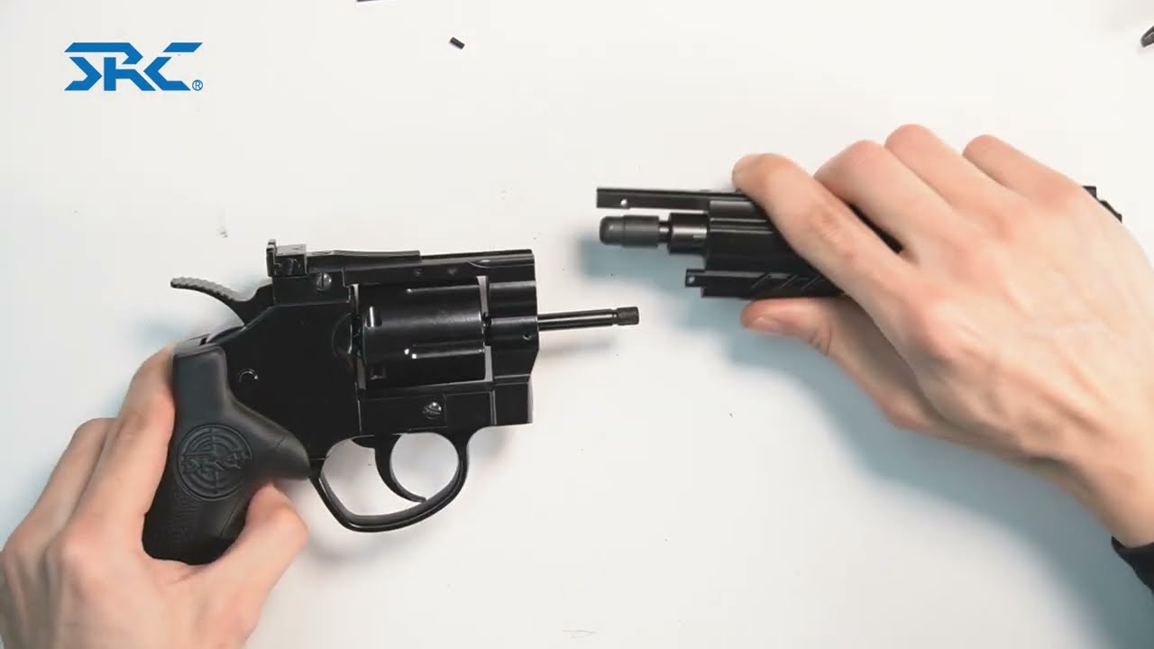

I bought one of the SRC revolvers some time ago. Was super powerful and heaps of fun. I got it out to use after a few months idle though and the interior gas seal(s) gave up as soon as i screwed in a CO2 cart. Seal is buried deep inside and no idea how to replace. That doesnt matter though as there were never any spare parts available. Another $400ish down the drain.
Put liberal amounts of g-n oil or anything suitable for seal and leave for a few days.
Like all seals if not in use regularly they tend to dry out and shrink
Thanks, but have tried that a few times. Dang thing
Would a generic seal fit…?
Ask xforce, if they can do any repairs…
Better than another clicker…
I did just fix that exact issue recently, it’s just a small o ring that’s gotten pinched after loss of lubrication. I’ll see about digging out the video i referenced for disassembly, but it was relatively easy to do and properly maintain going forward.
Edit: here’s a pic of the seal that died and equivalent replacement.
And the video i referenced for disassembly, the seal in question gets removed at the 8:10 mark. As soon as you can get at the valve you can forget everything else the video shows.
