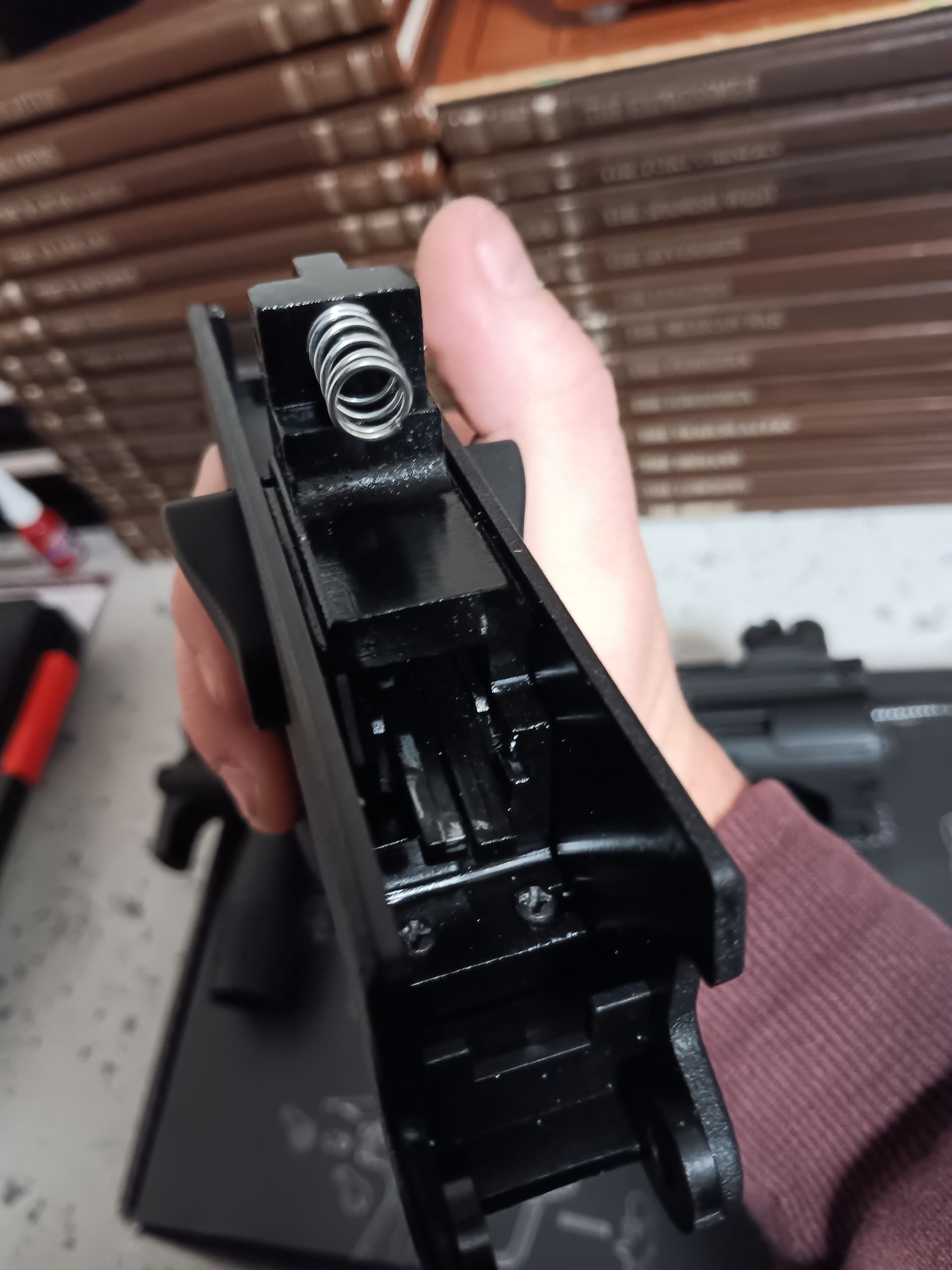

Alright, I didn’t get any pictures (sorry! still going to have a proper go on the weekend), but I had a quick look last night and it seems that the fire selector operates two small paddles (metal, thankfully) that are both lowered when in “safe”, one is raised for “single” and then the 1st is lowered and the 2nd raised for “auto”. The second one seems to lift a small plunger that I assume is the only thing enabling the full auto fire*. Again, I’ll put pictures up when I actually go for it, but I think removing that plunger should render the blaster as single fire no matter where the fire selector is sitting, solving my problem.

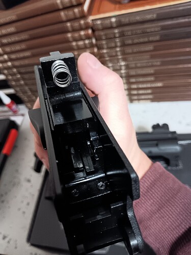

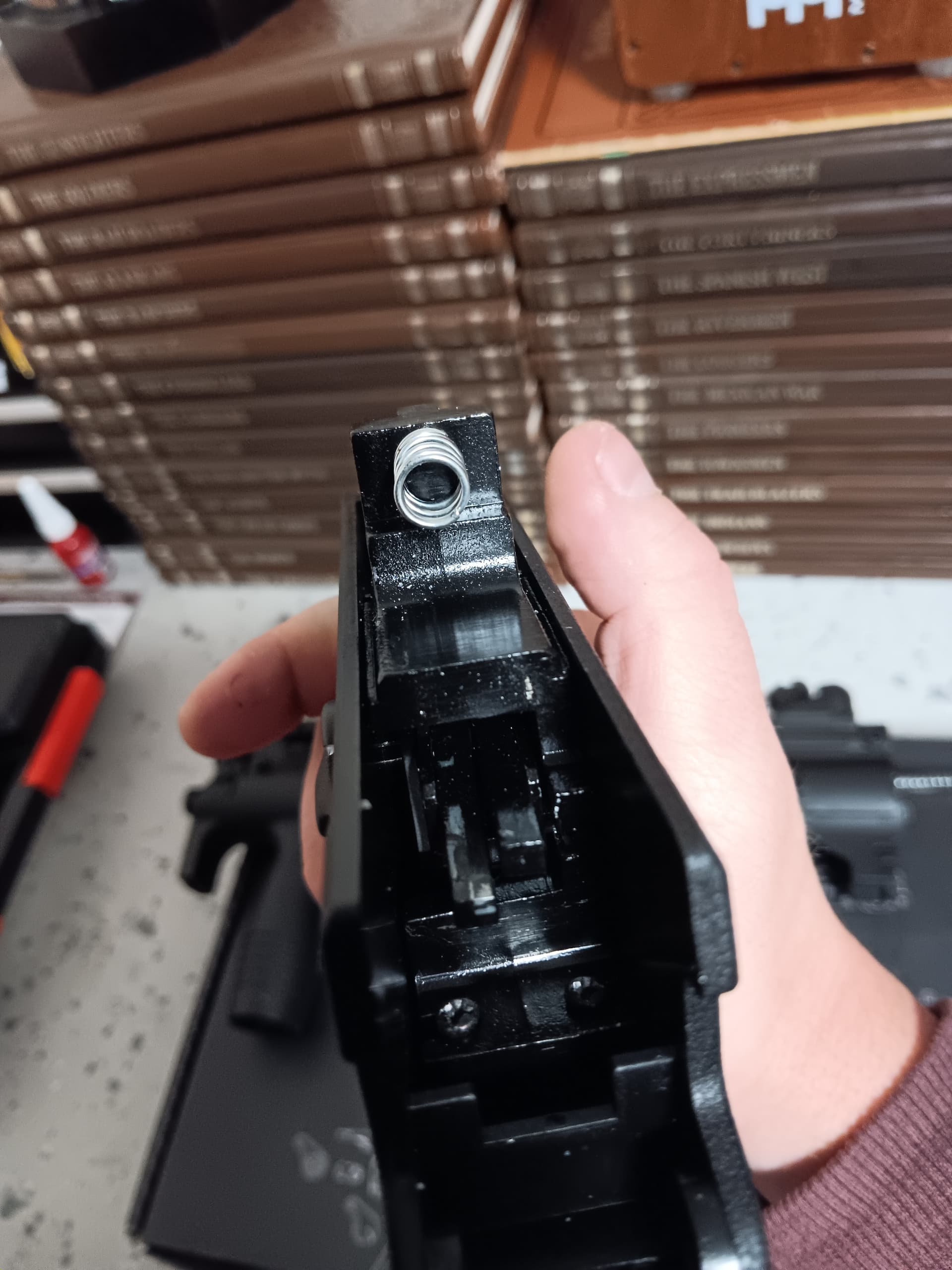

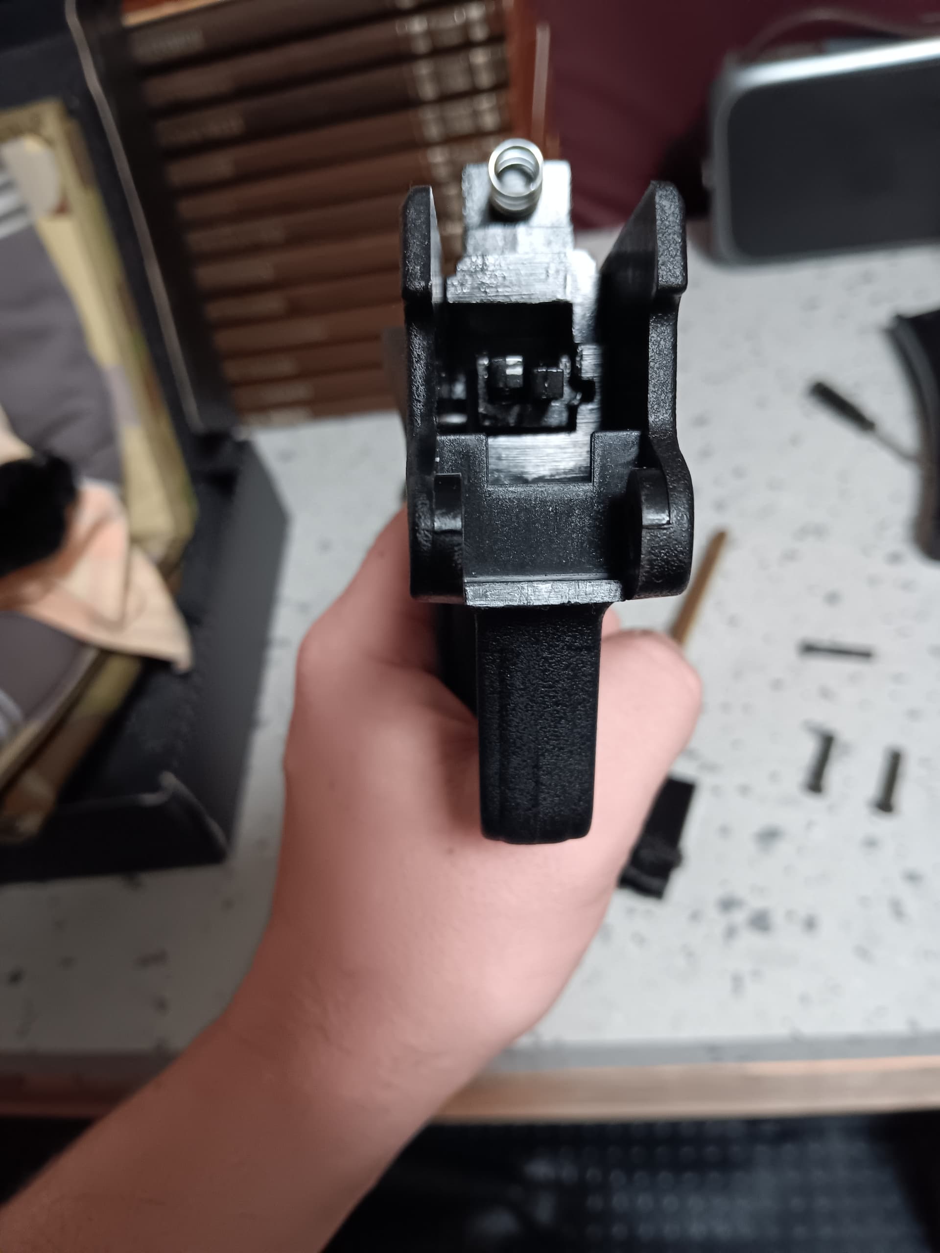

Ok, so the pictures of the paddle things are safe, semi auto, full auto in order. The paddle on the right side of the blaster engages when in semi auto and lifts that little lever thing

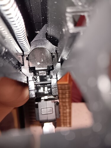

Same photos of paddles from a different angle.

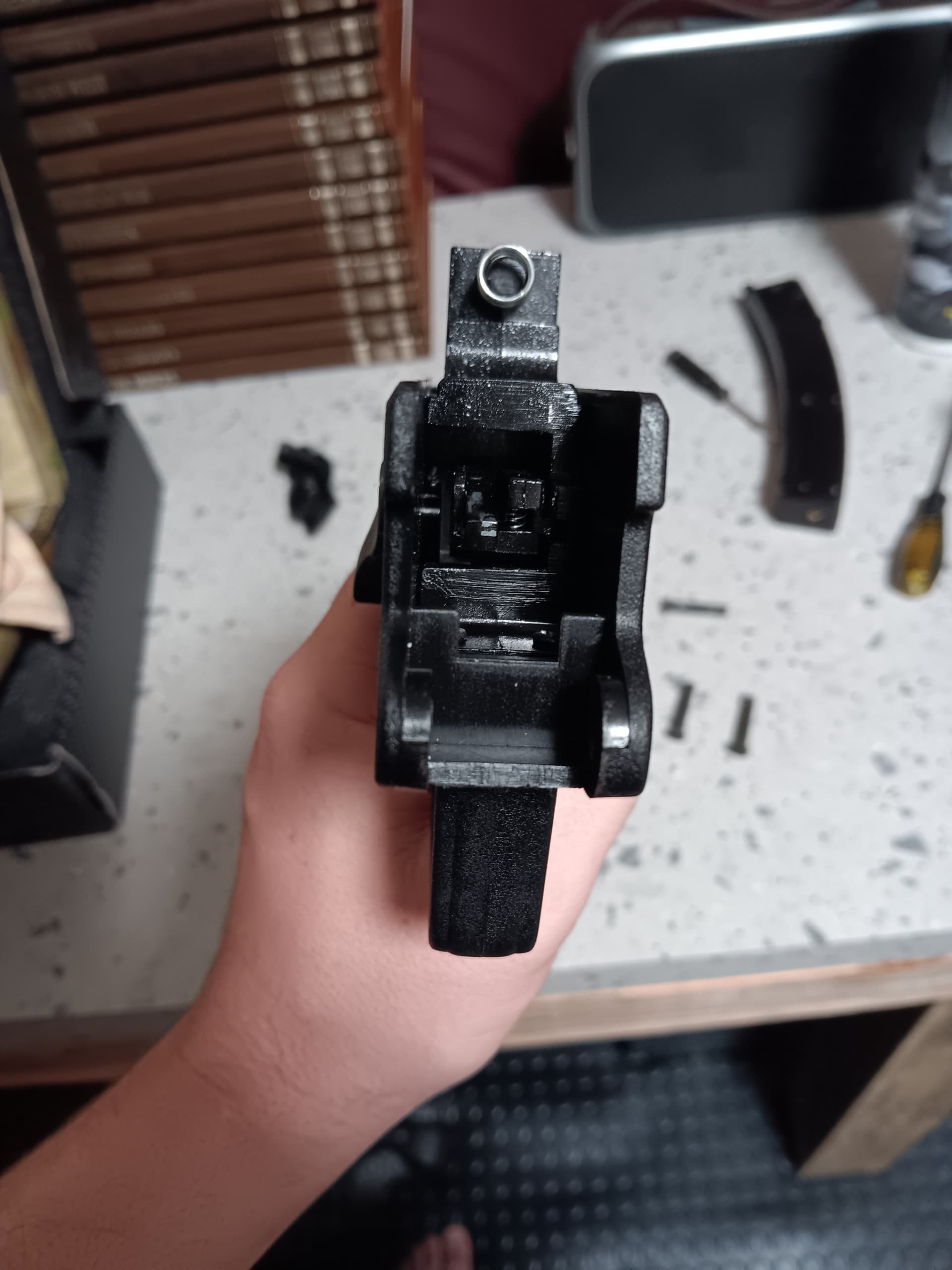

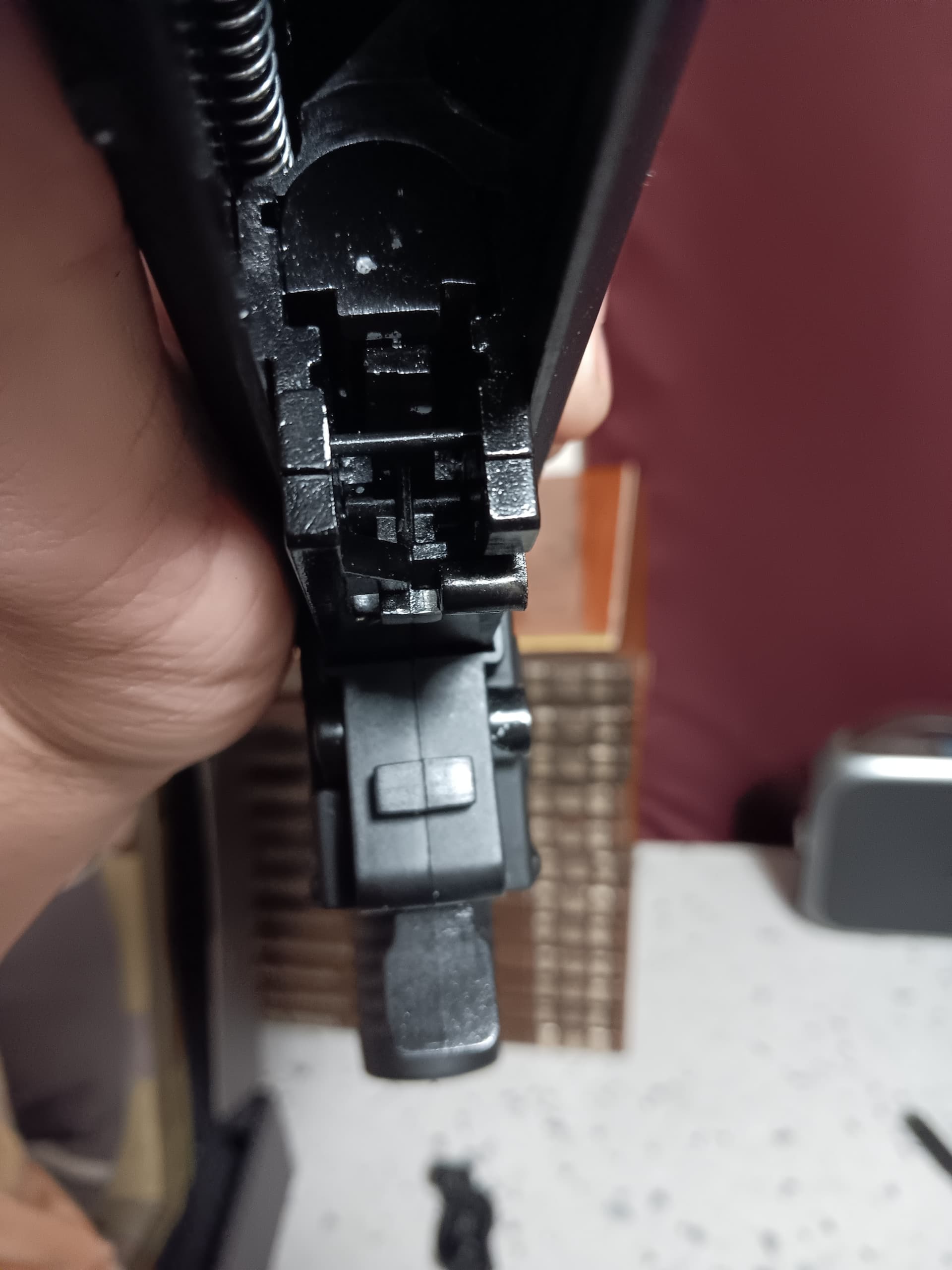

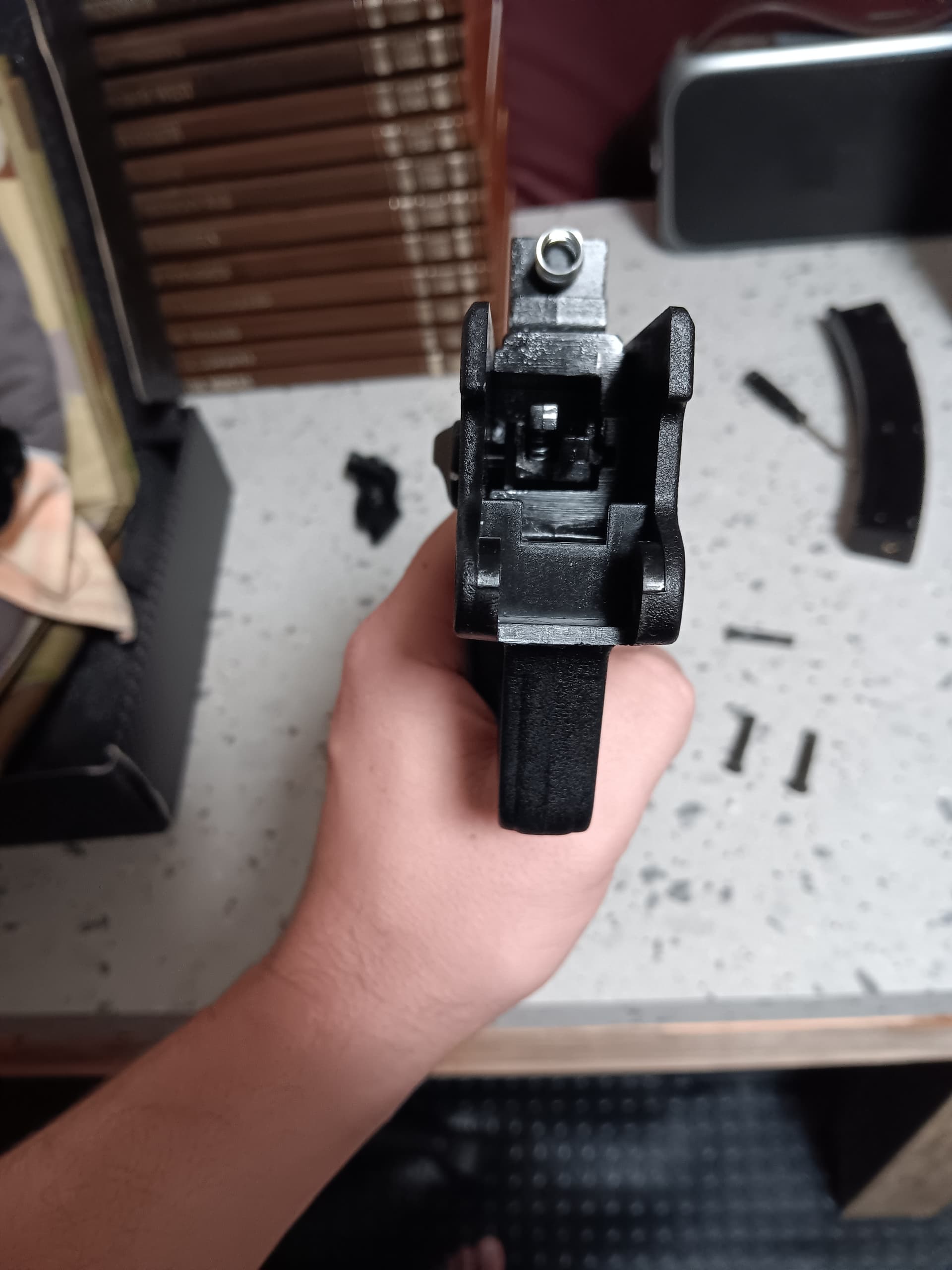

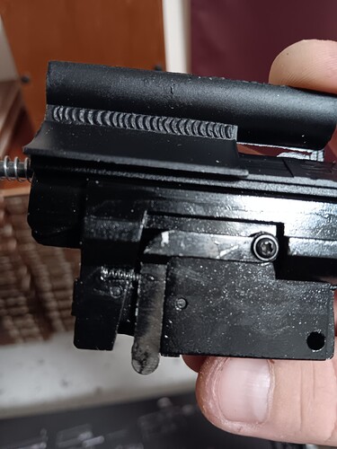

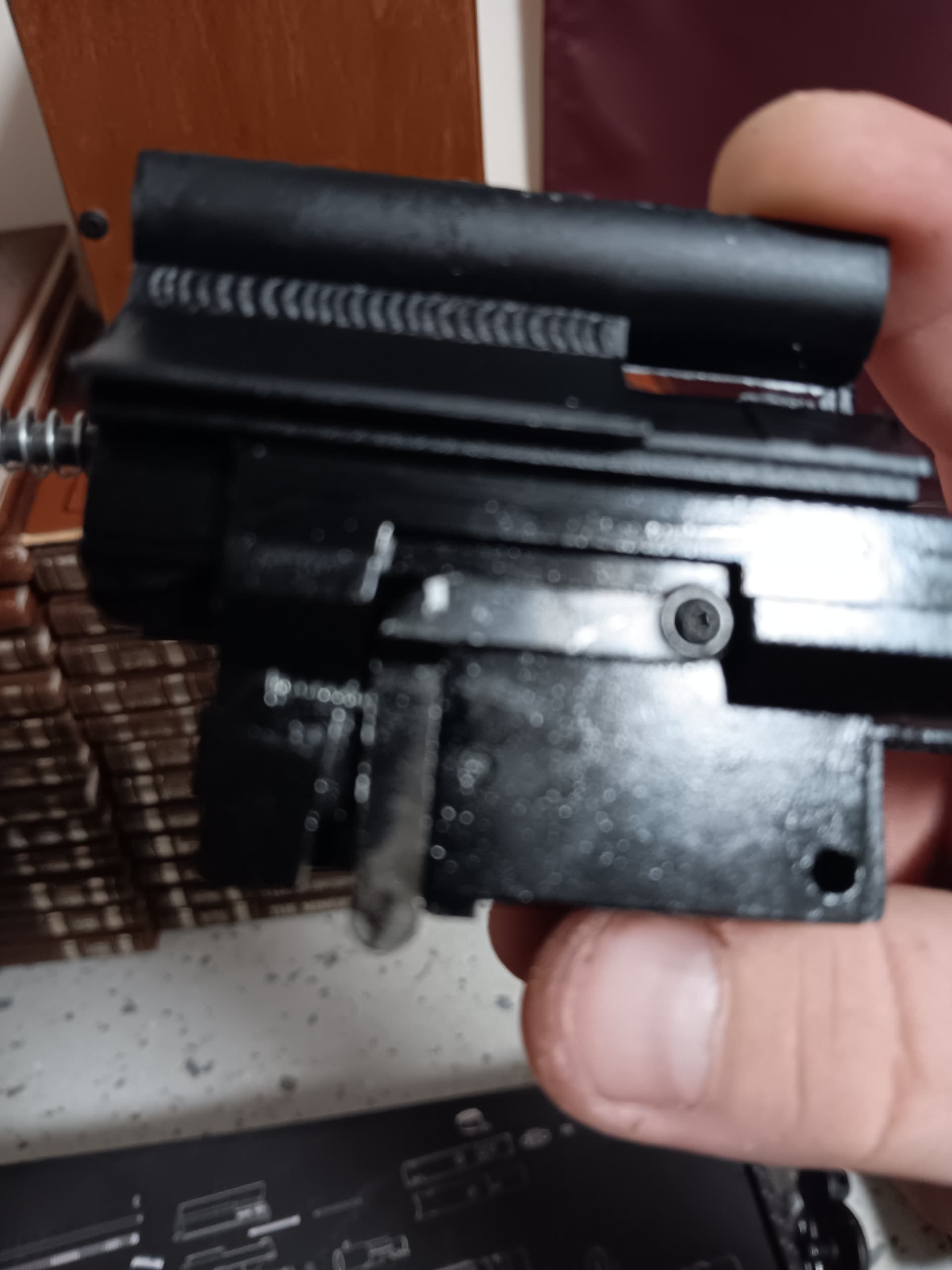

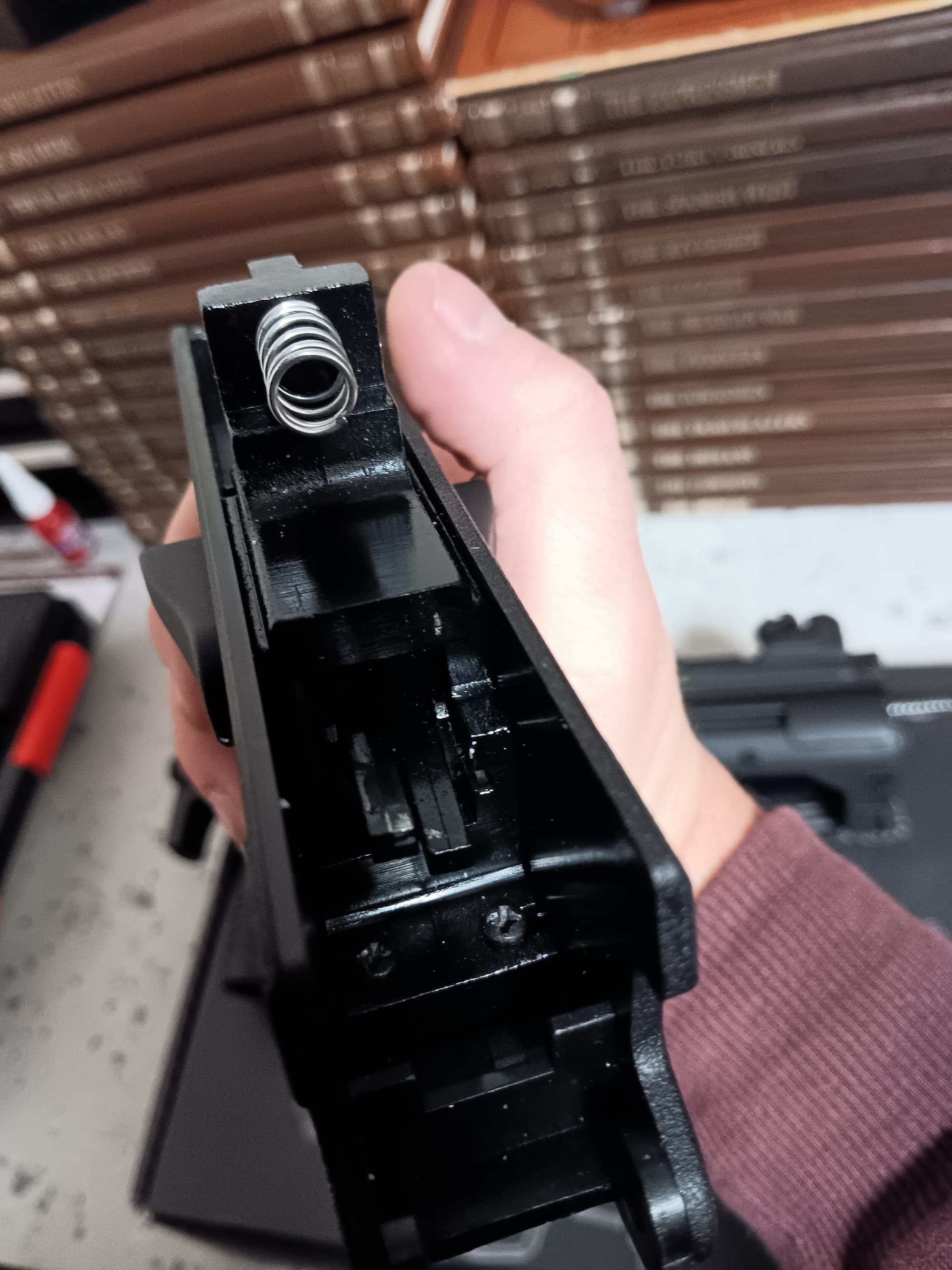

The last two photos are what those paddles come in contact with.

Hmm, looks more like a gbb pistol setup than what I thought it might be.
Those paddle things do play a part, I think the one that’s for semi locks the seer when engaged but the other does the opposite and holds the seer down for auto.
It’s a weird setup, are those paddle things on the bolt carrier/nozzle assembly?
In that first image there looks to be quite a. It of wear on the back left side there, like the metal has been hammered a bit.
It’s could also be something has loosened like that screw 4th/5th images.
The paddle thingies are on the fire selector just above/behind the trigger, not part of the bolt carrier. But they are what hits the mechanism that releases the gas, it seems. That’s why I suspect jamming that lever up might be the go, it’s the only thing semi auto paddle touches that full auto doesn’t.
That wear is on the semi auto paddle, it is just a bit of surface paint wear, not deep at all. I suspect it’s because I’ve tried very hard to only fire it in semi auto.
As for that screw, it was tight as hell when I gave it a go, seems to be locked in good.
I realy think the recoil is just knocking it into full auto somehow, I just can’t figure out how it’s happening. Will try jamming something in that lever when I have time, see how it goes :sweat_smile:
