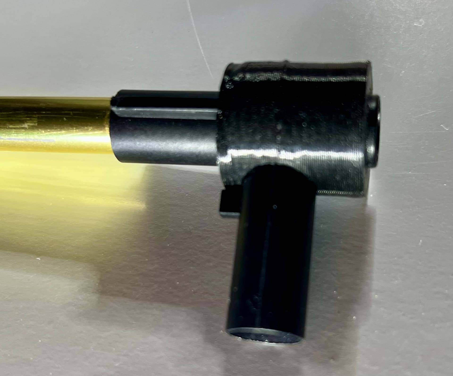

Sure, send me a pm, I’ll print a stack up this weekend.
Basically I’ll do it for postage costs rounded up…
If anyone else wants them let me know.
They come as a two piece kit. One piece pushes on the rear of the tpiece… the other on the front.
Some filing may be needed to squeeze them on, I print them a bit too large, then just file the inside of them to be a snug fit. Originally it went on easy, but mass production and a few versions of the tpiece are all a little different.
Worth noting the front section is either for the metal or nylon barrel adaptor/receiver. Both are slightly different… with metal being a touch shorter.
I will send a few of each, as you basically destroy them to remove them, which may happen if they are a bit to long… If filed to be snug they can be removed much easier. Also helps to use a vice to squeeze them together.
And finally… getting the upper on is tight, by design to do its thing!, you want that but you don’t want to really force it.
Anyone wanting them I would send four rear pieces and two of each front pieces. They cost very little plastic, and don’t take too long to print ![]()

Fellas, a big shout out to RokSolid for his kindness to create me a ‘well care package’ with some decent upgrades enclosed with the printed t-piece spacers.

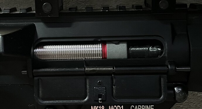

I have to show you all how his cleverly designed t-piece spacers fit on, with the upper receiver in place everything is snug and the end of the gearbox is going NOWHERE!

Cheers mate. Still cant believe with all the broken wells gearboxes, nobody else came up with it.
For those wondering if it works… my wells cqb has been short stroked 4 teeth, had an m100 getting 305fps, an m110 getting 335fps, and run up close to 30rps with both, and is not cracked yet after well over 6 months! with double drum mags at outdoor games and a missus that has no mechanical sympathy going through 1-2 bags of gels each time it goes out!
Also an MRT with an m100 not short stroked getting 370fps and 25rps still lives.
Disclaimer, your mileage may vary!
But I have used these on a completely broken gearbox, and it worked! Makes it very difficult to work with, but works!
Even more proof that RokSolid’s t-piece spacers are indeed the cure for the well v2 gearbox breakage issue.
