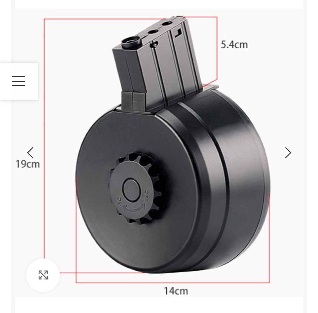

I’m pretty sure it’s this one
Drum Magazine for JM Gen.8 M4 – Black
Says “brands: Jin Ming” on x-force website
I was thinking maybe the magazine motor couldn’t keep up with the Jinji SLR you upgraded for me but after reading your post is sounds like drum mags just aren’t overly reliable, which is a shame
On this one it seems to be an issue of the gels not falling into place at the bottom of the magazine to allow it to feed properly but even after giving the the blaster and drum mag a gentle shake to let them fall into place it still wasn’t firing every shot and quite often missing several shots
Might try my luck with a different drum mag for shits an giggles down the track and just see how this one goes with my cheaper blasters like my JM m4a1 etc.
What about this Jingji cqb SLR drum mag? Do you think it might go better on the SLR than the one I scored for free?
Cheers for the perspective :call_me_hand:
The magazine motor in those, and many drums is often slower than most. And coupled with many drums have an extra gear to make them slower doesn’t help.
A faster magazine motor can help them, but they are still limited to around 25 rps, which if you run a drum this size is plenty wild enough.
The “JingJi” drum, i found similar to all drums… fussy fit, same sort of feeding.
I’ve had one for some time that I have been meaning to through a better mag motor in but being my stuff, just haven’t had time to do it!
A long time ago in a galaxy far away……….
There was a few who had figured out the feed issues with the Drum Mags was in the design of the “junction box” where the gels fed into the motor.
A bit of filling and reshaping was required to get the gels flowing and feeding properly/reliably.
It just depends on whether you think the juice is worth the squeeze, but if you have a couple laying around and have the time to tinker, they can be made to work well and have nothing to lose having a crack at it!:+1:
