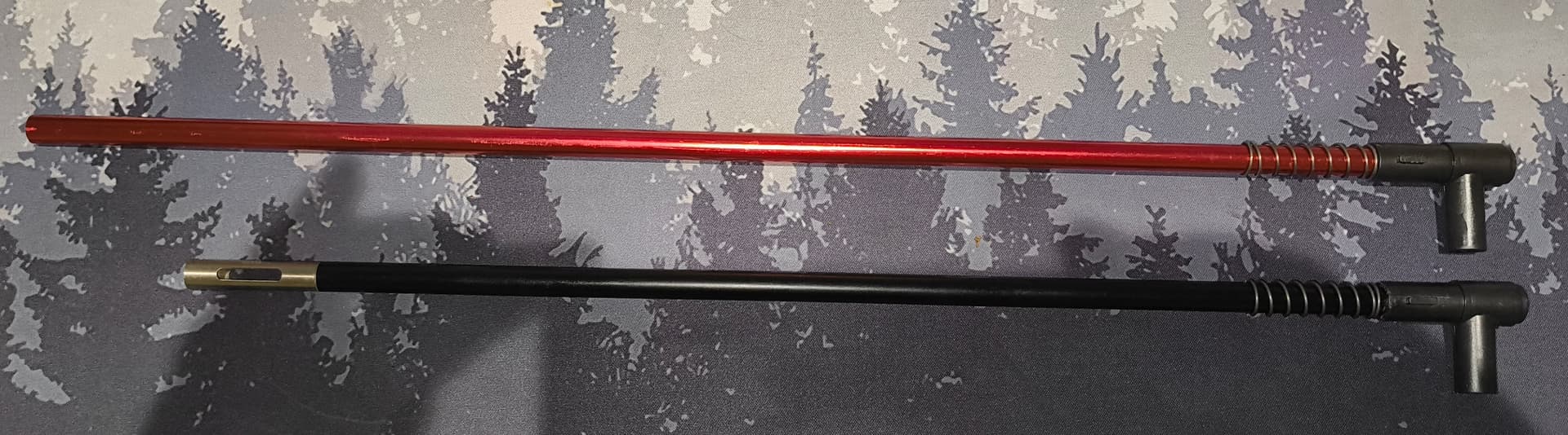

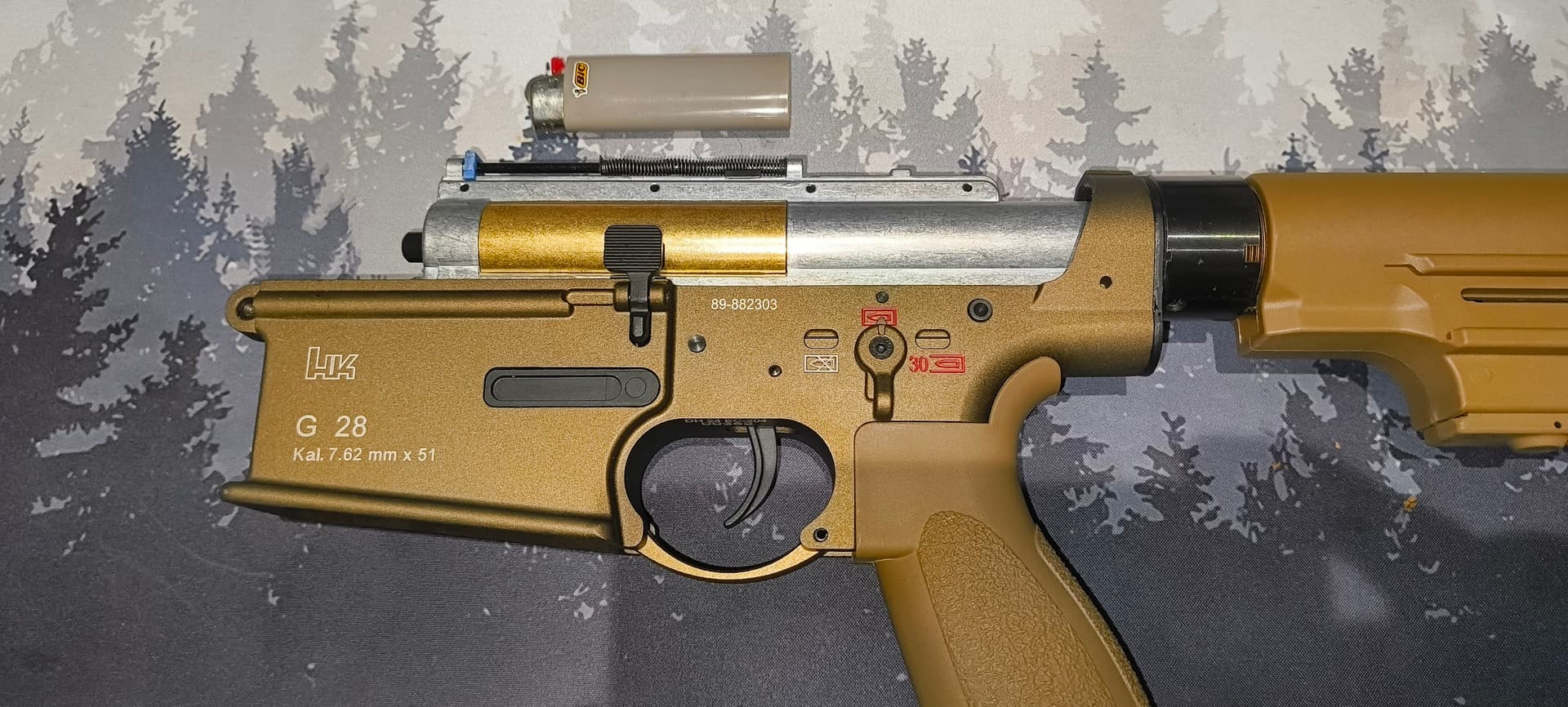

So I have this Optac 400mm barrel that I bought for an M4 build. I’m wondering if it would work for my new G28 which originally came with a 440mm barrel?
Gelball go zip
Rok currently has a build underway, for my HK117.
All a bit of an experiment…playing with the V2.5 gearboxes…

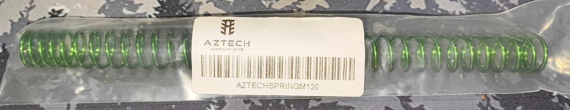

The extra travel of the piston, length of stroke also means (at least from what read in some airsoft forums) you generally lose a couple spring ratings.
ie you’ll need an m120 to get m100 power (airsoft frequently used an M140 to get M120 power for their DMRs)

But anything beyond 400mm 7.5mm barrel really stretches the capacity of a 100% cylinder to be able to power anything until using smaller “tight bore barrels” to reduce the volume required.

I’ll try both and run it through the chrono. If I use this Optac barrel I’ll have to find a grub screw that sets the height while flush. Otherwise no pokey pokey. I’m kinda inclined to order a 500mm and cut it so the hopup sits in the flash hider instead of the outer barrel. That would give me another 2cm or so.

So in preview to a future video… M120 in the M110A1… is just over 400fps… I suspect it will settle a little as my BJX springs do start a touch hot, then “bed in” slightly. It will very likely be around the 400fps mark still though.
I have two integrated hopup barrels to try… the first seems to be like any “DMR” powered blaster… 1 of 5 is pretty good, the rest are a little erratic. I haven’t tested with the harder summer cat green and orange yet though as I had none ready. Also no sorting was done.
