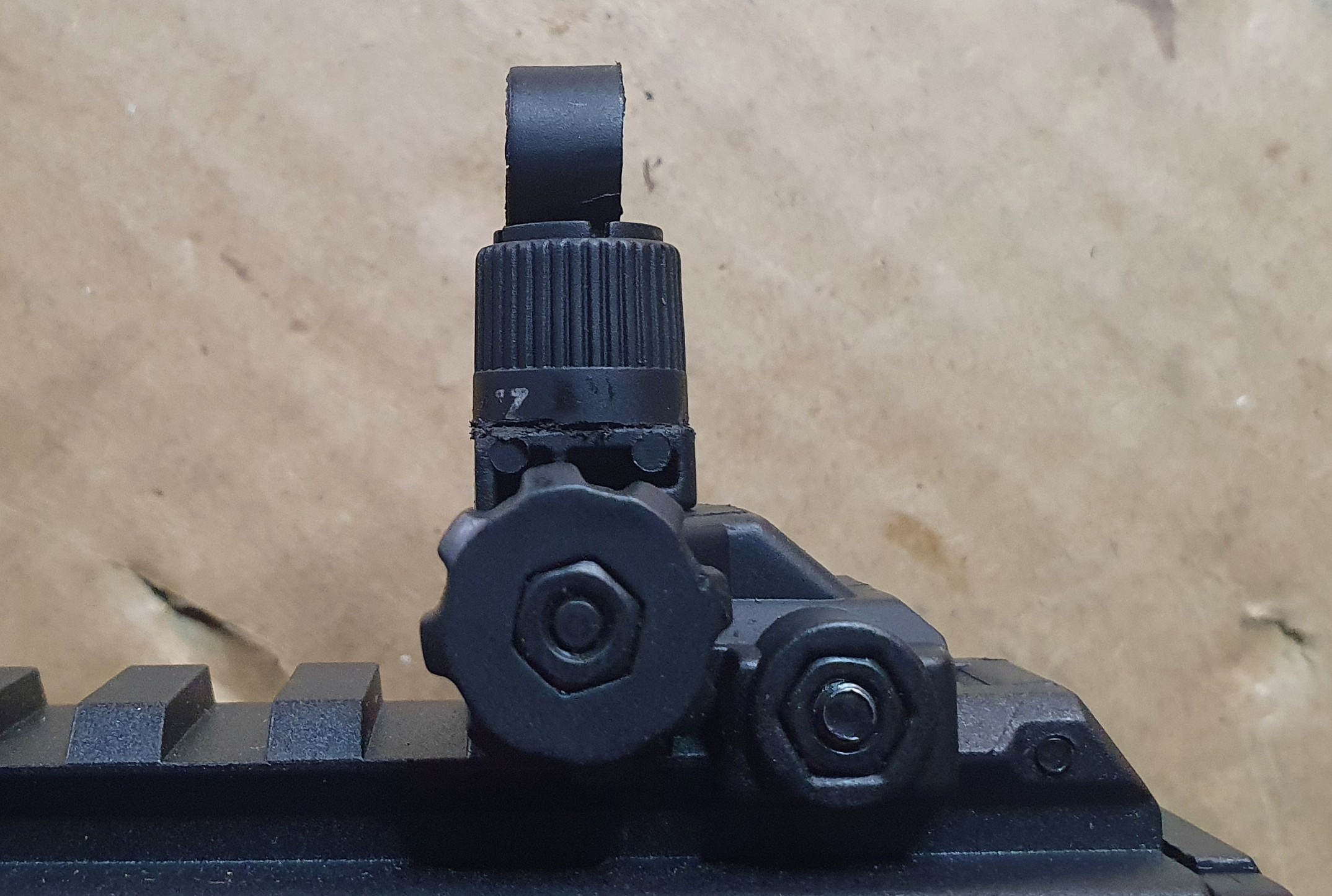

The only criticism I could make is that the rear iron sight is about 5mm too high at it’s lowest adjustment to cowitness with the front… but that’s being picky… and certainly no biggie, I shortened mine to prevent OCD overload.

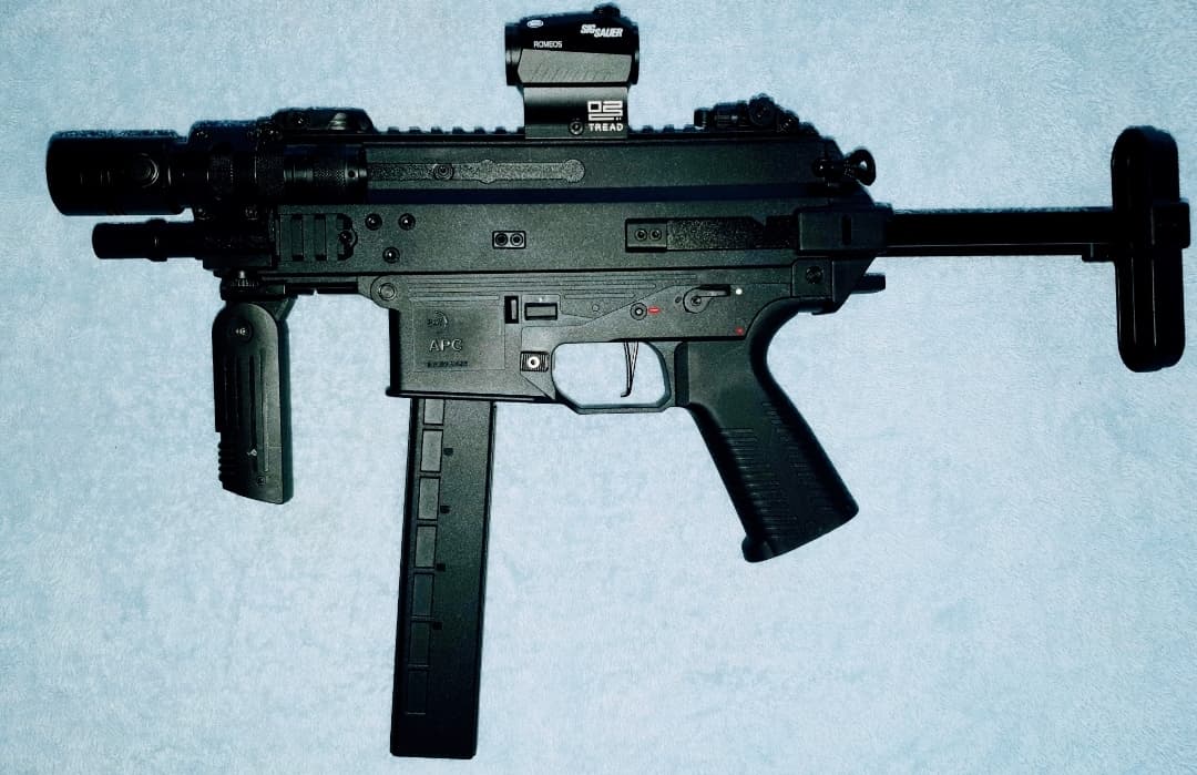

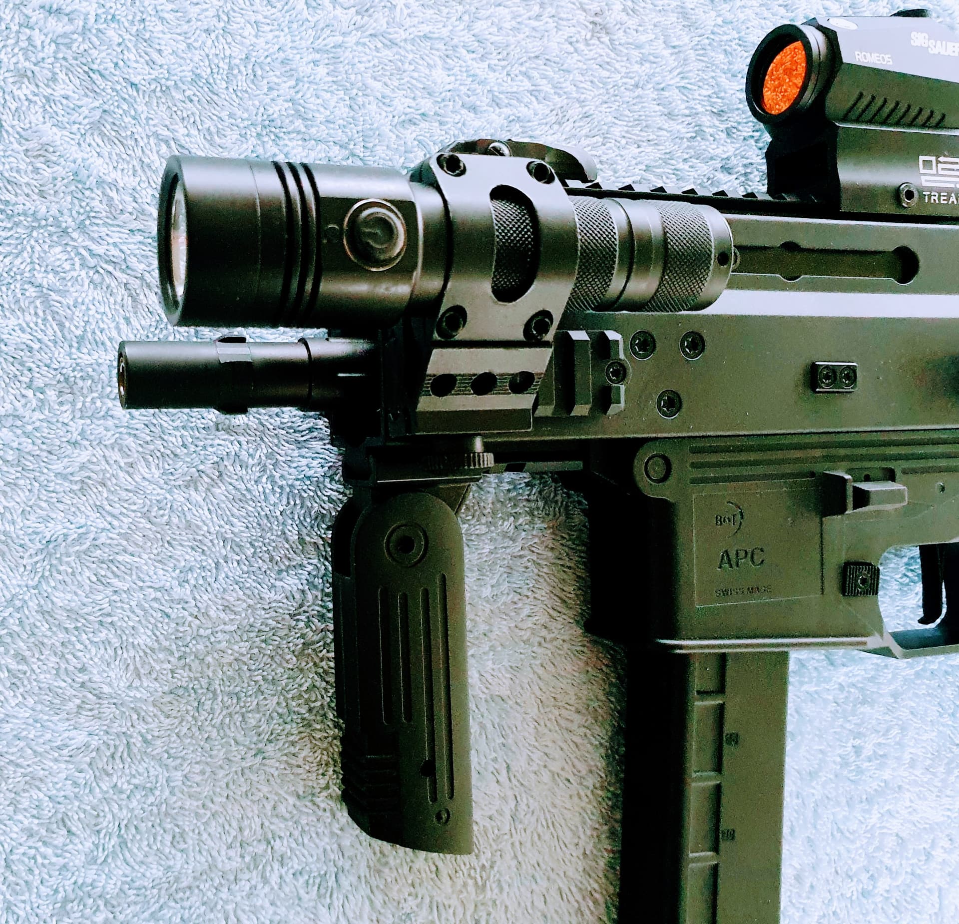

Final iteration of the APC9K…

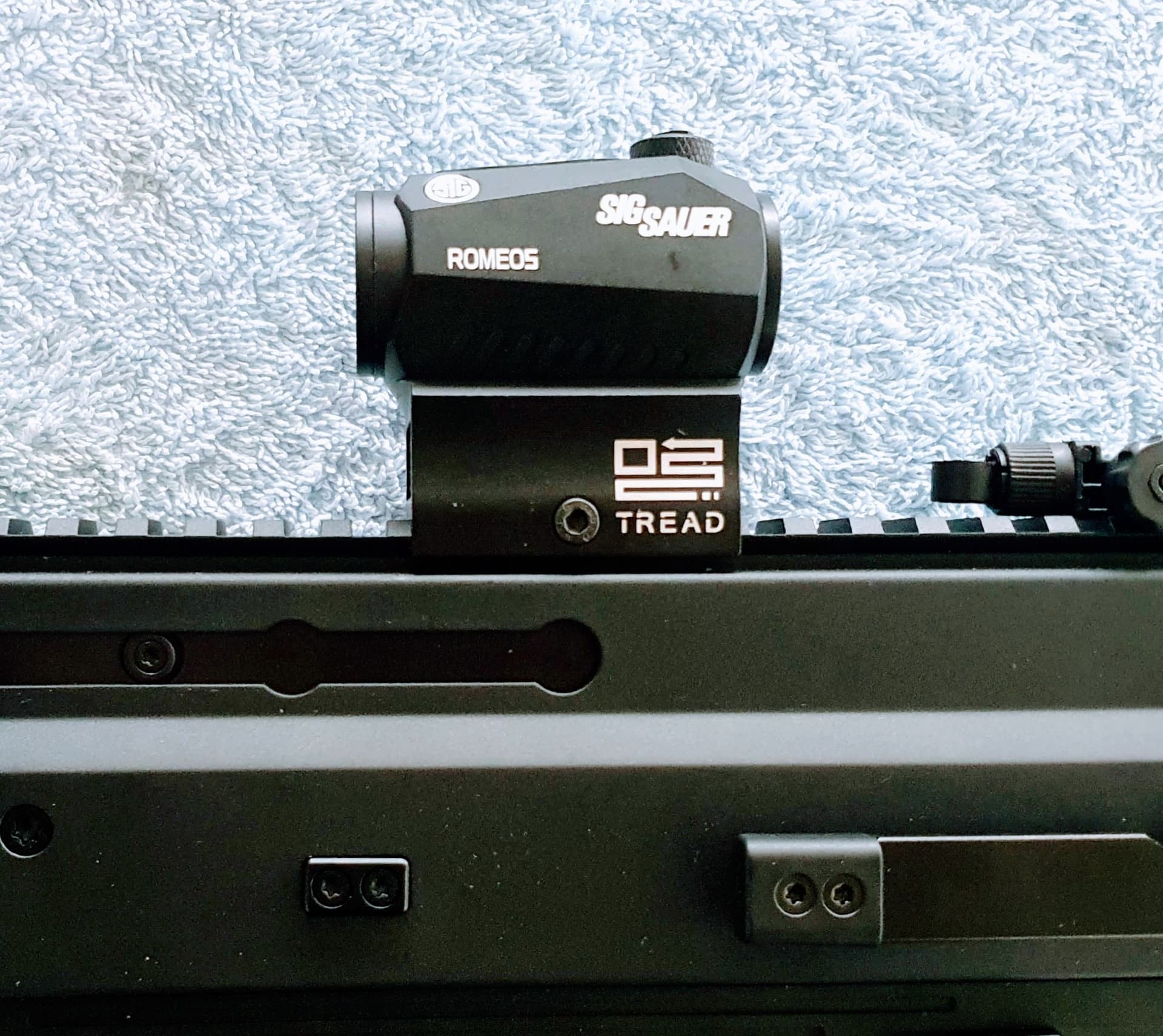

Sig Sauer Romeo 5 red dot sight

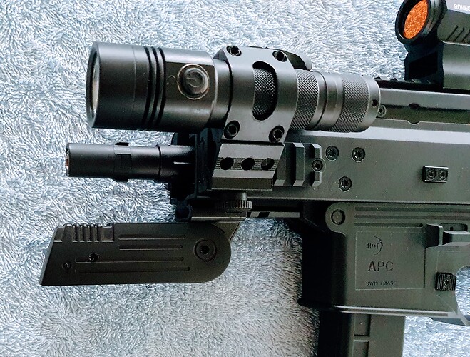

Tactical torch & MP7 folding vert grip

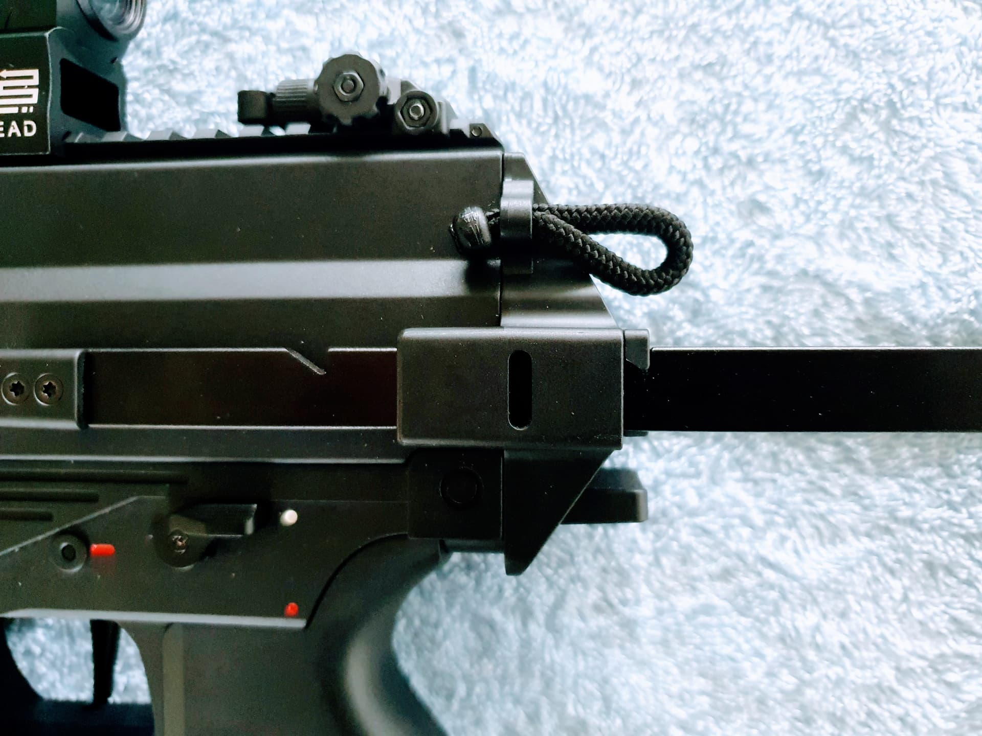

In the folded position
Rear sling loop

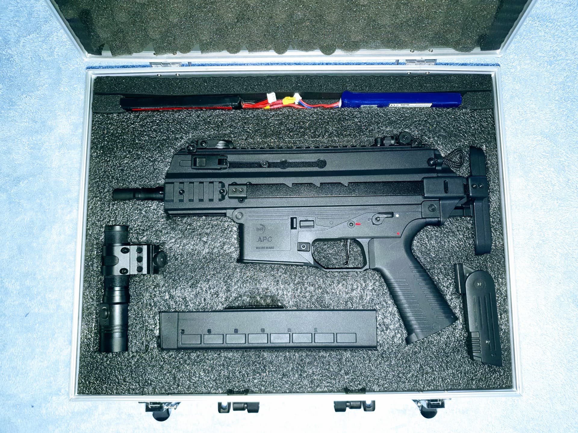

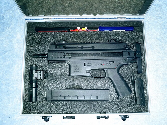

In it’s case
What a great little CQB unit. :+1:
Final aye… :joy: :rofl: :+1:
