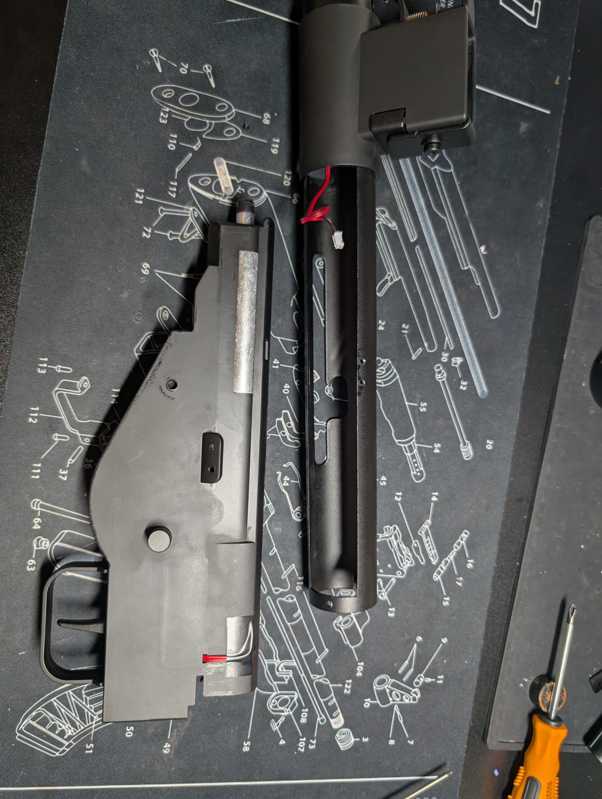

For those wondering… the lower receiver is the gearbox too!

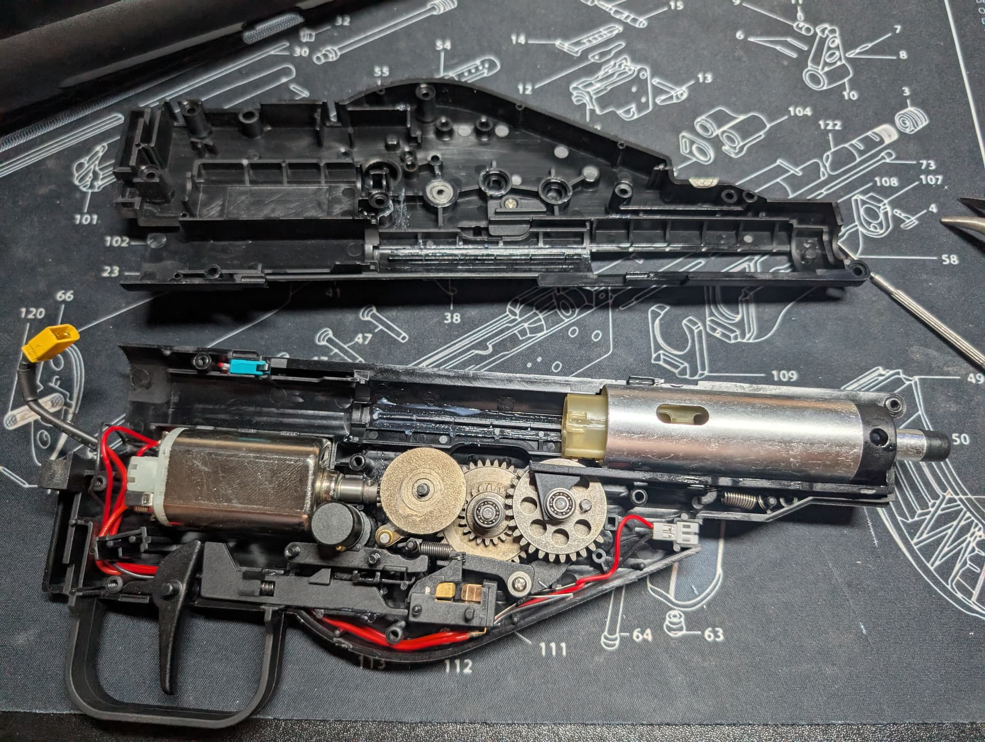

That actually looks pretty clean. Nozzle looks like it might work with something else, maybe a CYMA nozzle. Only troubled part would be that tappet looking at it there.
Nope… just checked. Externally same as an ldt style nozzle… slightly different tip but the alloy externally dimensions are the same.
Internally… same as xyl or wells… so proprietary.
No o-rings either. Thicker oil is all you can do.
You could change the cylinder head to ldt style, the be able to change the nozzle to ldt, run the standard tip.
However the head posts are thicker and don’t fit, so drill the head post holes out… then the aoe is off… I think just a thicker oil will be adequate.
Does have a good green oring on the piston head.
Cylinder head oring got the teflon gas tape treatment, it’s oddly larger than normal cylinder head o-rings, and between two generic oring sizes.
Classic gel stuff.
You could stuff around with the head and nozzle, but everything else looks decent.
Also not the proprietary length of motor shaft.
Bit of seal fix, clean and grease. Can always quick change the spring, however I wouldn’t recommend too much as the tiny battery won’t enjoy it!
What percentage volume do you reckon that cylinder is? 80%?
I reckon it’s more like 70% :person_shrugging:
But then again, whaddaeyeno? :rofl:
Cool I learnt a new word today :rofl: :rofl: add that to my Aussie dictionary :joy: :+1:
I reckon it is closer to a 60% than a 70%, but I didn’t reference it to a new 60%, just measured the swept volume and calculated it to be pretty much right where it needed to be.
