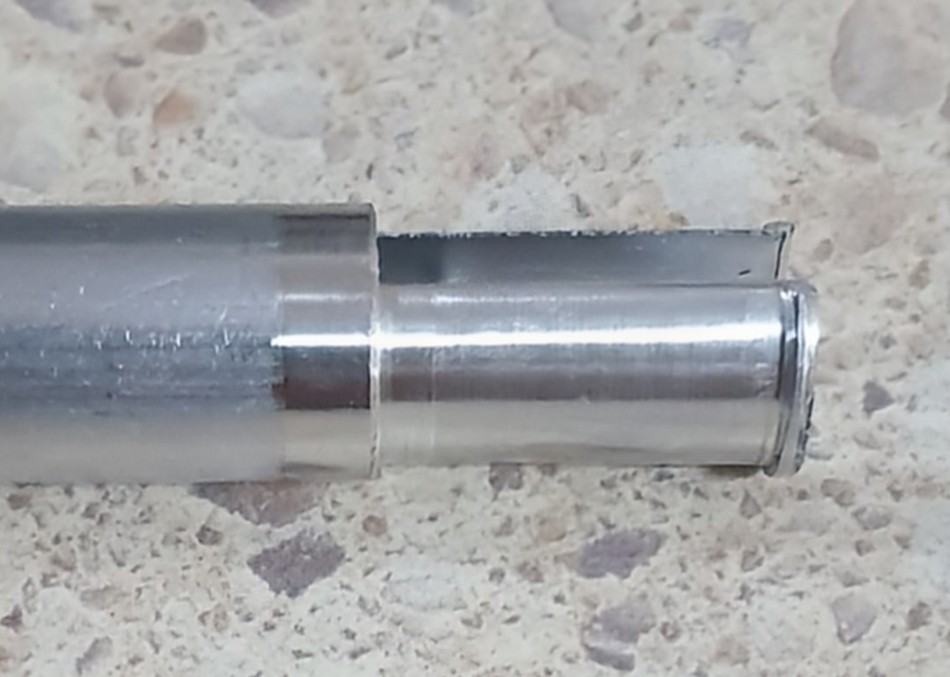

If I got my hands on one it wouldn’t be difficult to model up one of those to be printed.
That barrel does look like it’s been machined down, like from 9.5 to 8.5 outer, not dissimilar to some GBB pistol barrels.
It’s turned down at the hop up end to give a 10mm OD with the rubber sleeve on. Easy to replicate with a bit of lathe work and a file.
I still reckon an adjustable slim hop up will be a better option. :+1:
Quick update…
Just found out the inner barrel can be shortened at the t piece end. The collar is removable after all. :rofl:
Understand though that popping off the collar and shortening the IB at the t piece means filing a flat on one side of it to allow for a detent strip in the collar, there to revent rotation and keep the hop up aligned.
The receiver also needs modification if you shorten this way. The factory diameter of the barrel hole at the t piece is 9.0mm, it will need to be opened up to 9.5mm to allow for the lack of machined groove or the shell halves won’t close up properly.
The posts above have been ammended to reflect this.
Still think it’s easier to shorten at the business end.
