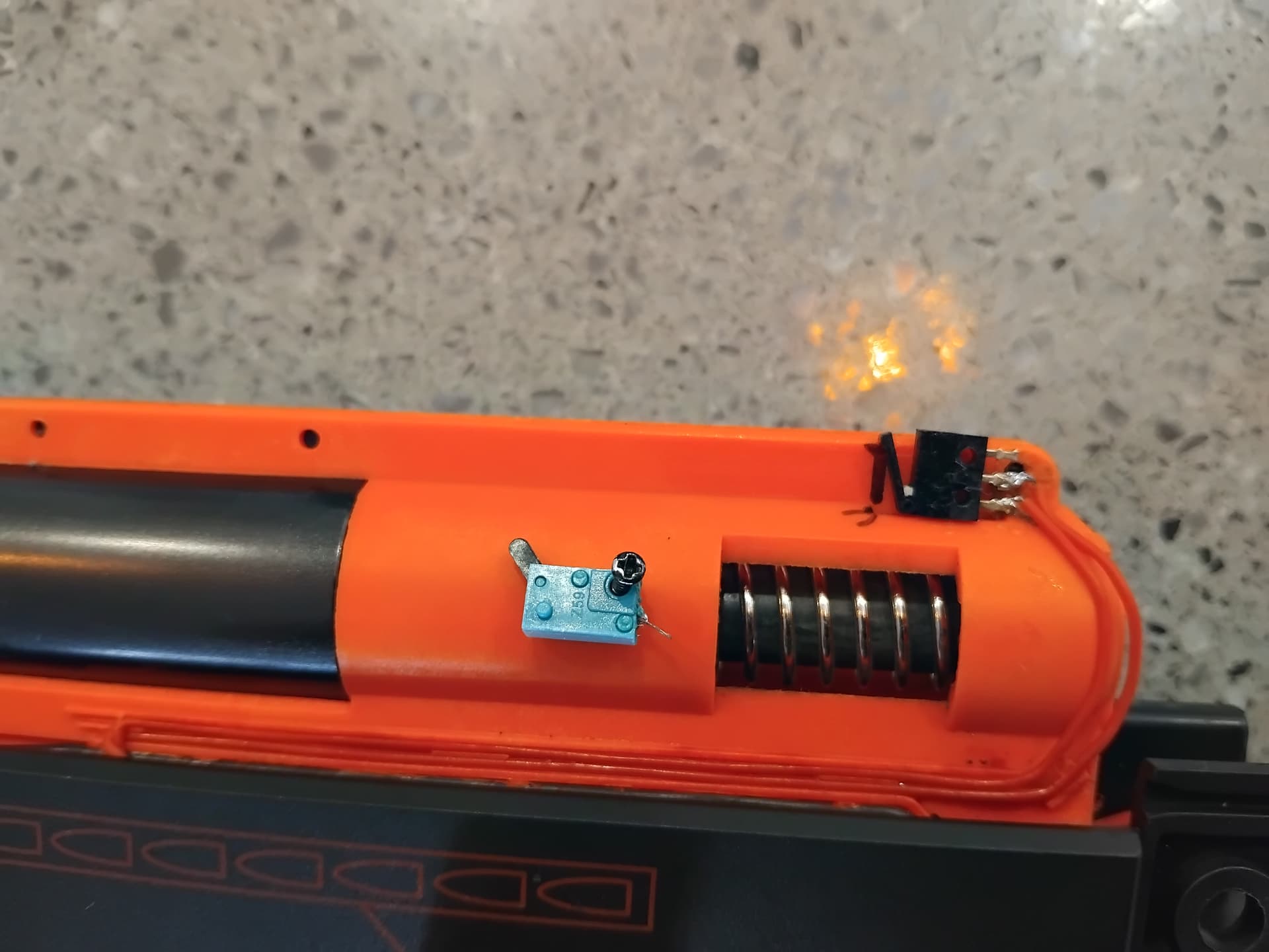

Got the new micro switch from xforce, from their parts bin ( freebie, thanks Vas.!)
It is rectangular, but taller ( 3 prongs rear) its the black switch.
Genuine one, is rectangular, but longer lengthways.
It has a retention knob, and screwhole in the right place. (Blue switch)
I removed the old switch, exposed the single tab via solder-removal.
Soldered up the new switch ( thanks, loupes!!) and gave it a test run.
It worked properly…Yaay … however…
Different shape switch, no tabs or screwholes aligned.
My only solution was to use 5 min epoxy, for retention.
Mounted right next to the m100 spring…its gonna have a hard life.
I dont think it’ll stay on too long…
Any suggestions.??

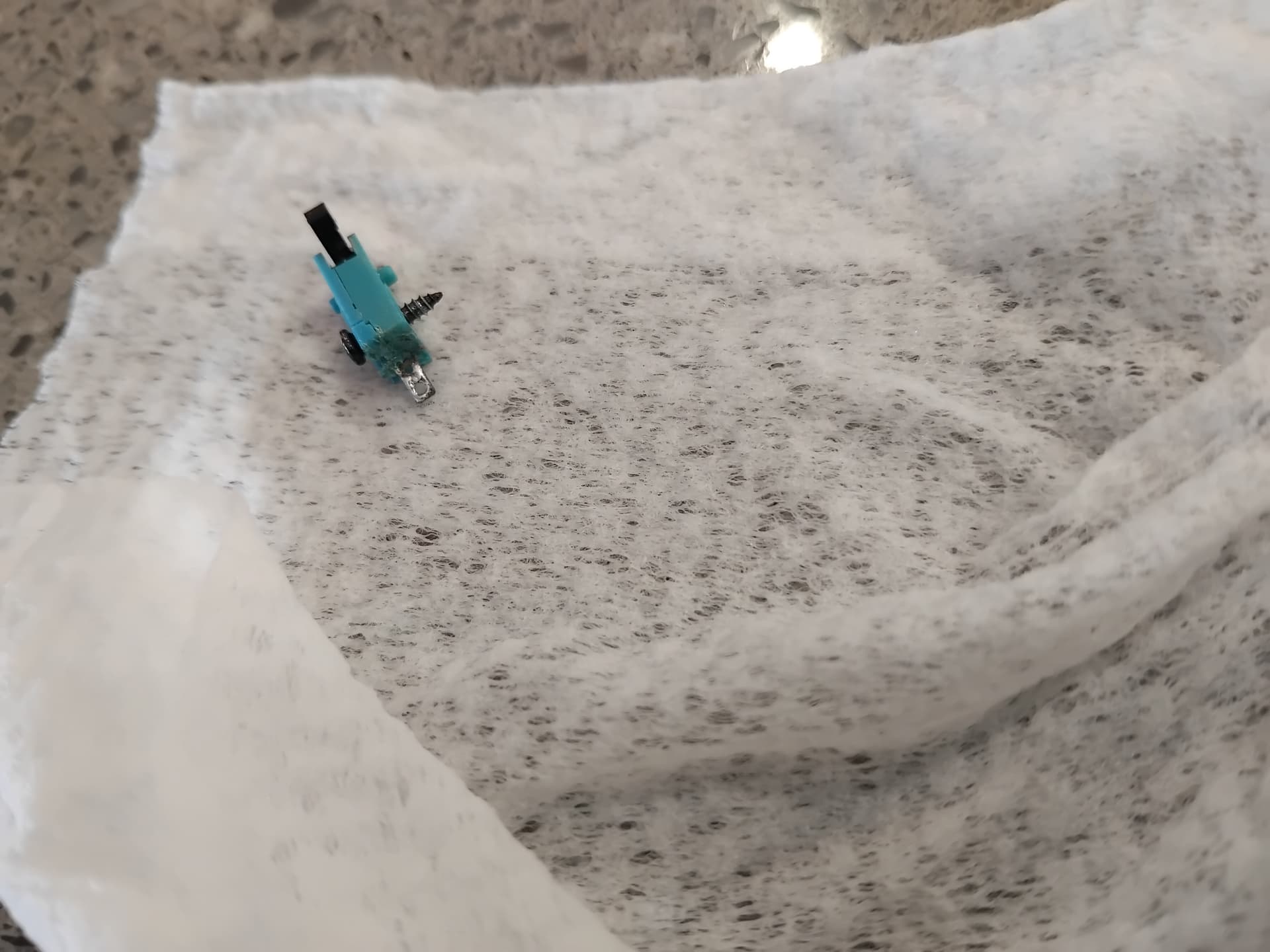

it has a weird single tab at the rear, as shown…
Ok…

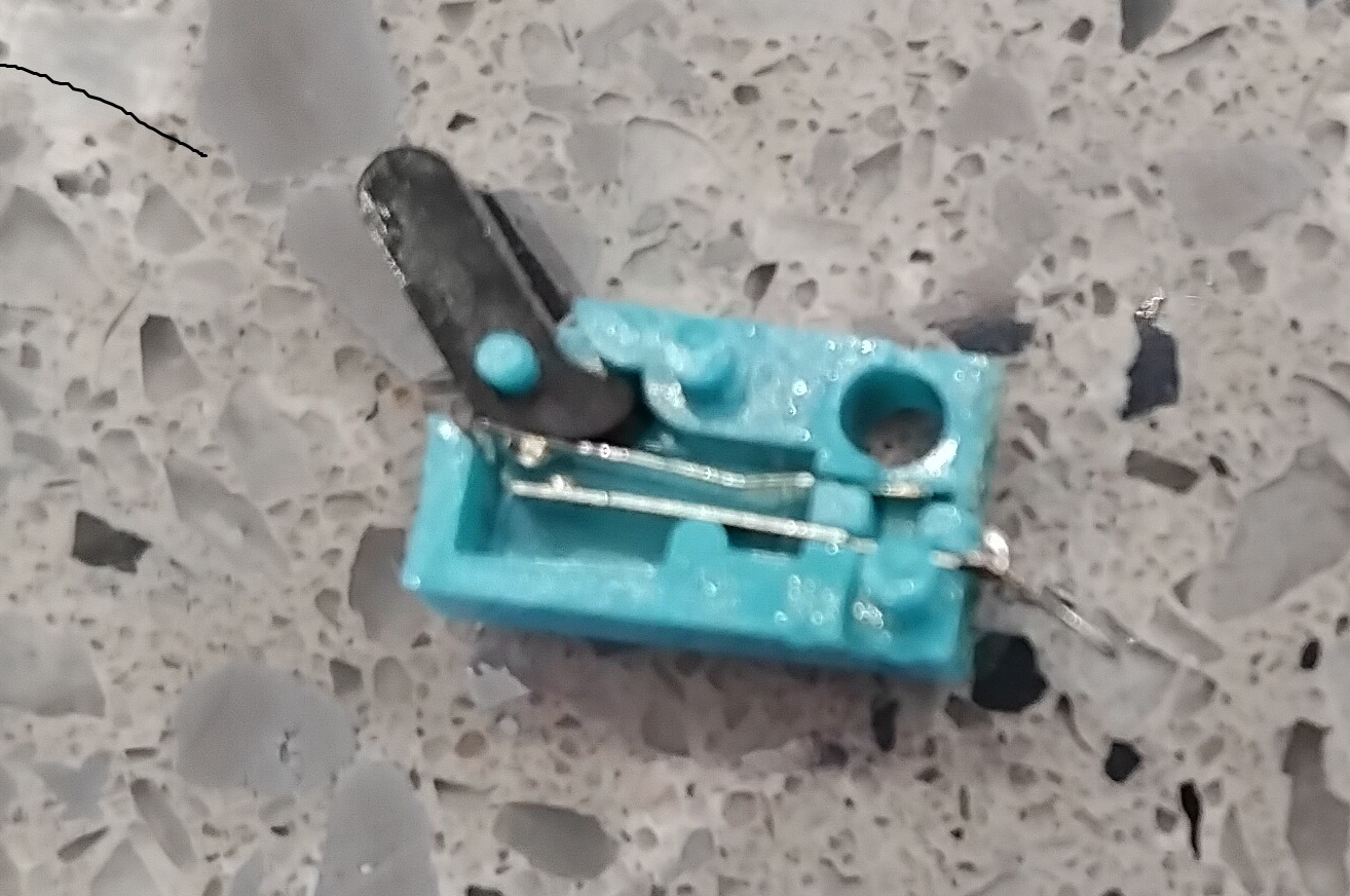

Finally, figured it all out…
Opened up the switch, and all was revealed…
A bit hard to see, but basically…Upper protruding tab, snapped off…

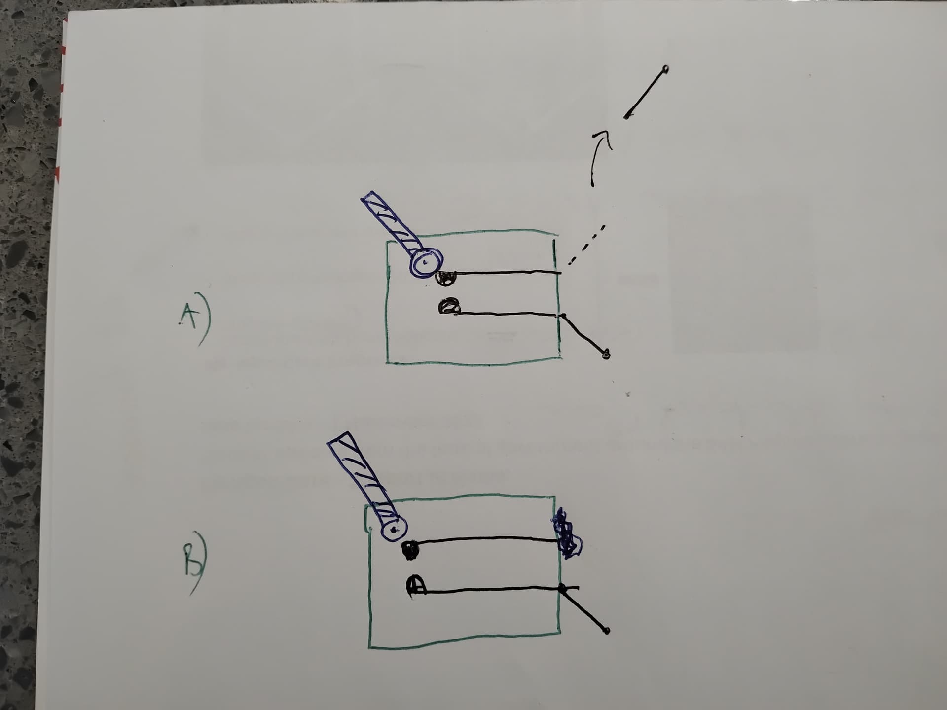

Clearer drawing.
the 2 metal tabs, are brought into contact by the switch.
they run through the insulated block, emerge from the rear…
one angles up ( gone)
one angles down (remains)
Attach a wire to each.
Which, is why i couldn’t find anything to attach the wire to…nothing was there…
And why, with loupes, trying to expose more with the hot soldering tip…you would get teasing glimpses of just the thinnest amount of metal…
i reassembled, and applied a blob of solder at the rear…hoping it would connect with the tiny bit of metal showing…
probably a fools errand…
So, there the problem… wafer thin bit of protruding metal, lightly bumped, and snapped off…
Medinchina quality…
Lets hope the other switch’s glue holds…!!

Okay…epoxy set morning after test time…!!
Good news is…it all still works!
The new switch is a little further back, than the old one.
It J u s t connects with the cocking lever…and thats a good thing.
It means, the lever isn’t smacking the switch hard…less force on the switch.
Sometimes, you need to use a little rearwards pressure on the lever to make contact…thats ok.
So, its just about the epoxy holding the switch on, longterm.
It has 3 points of epoxy contact…side, top, and bottom… so hopefully should be long lasting.

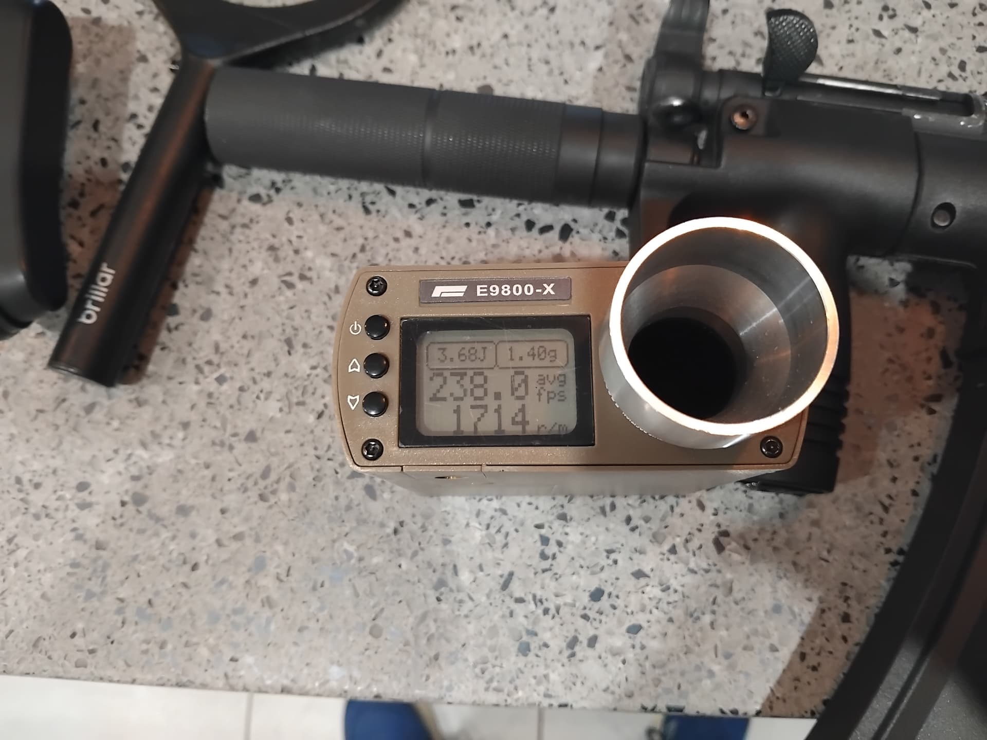

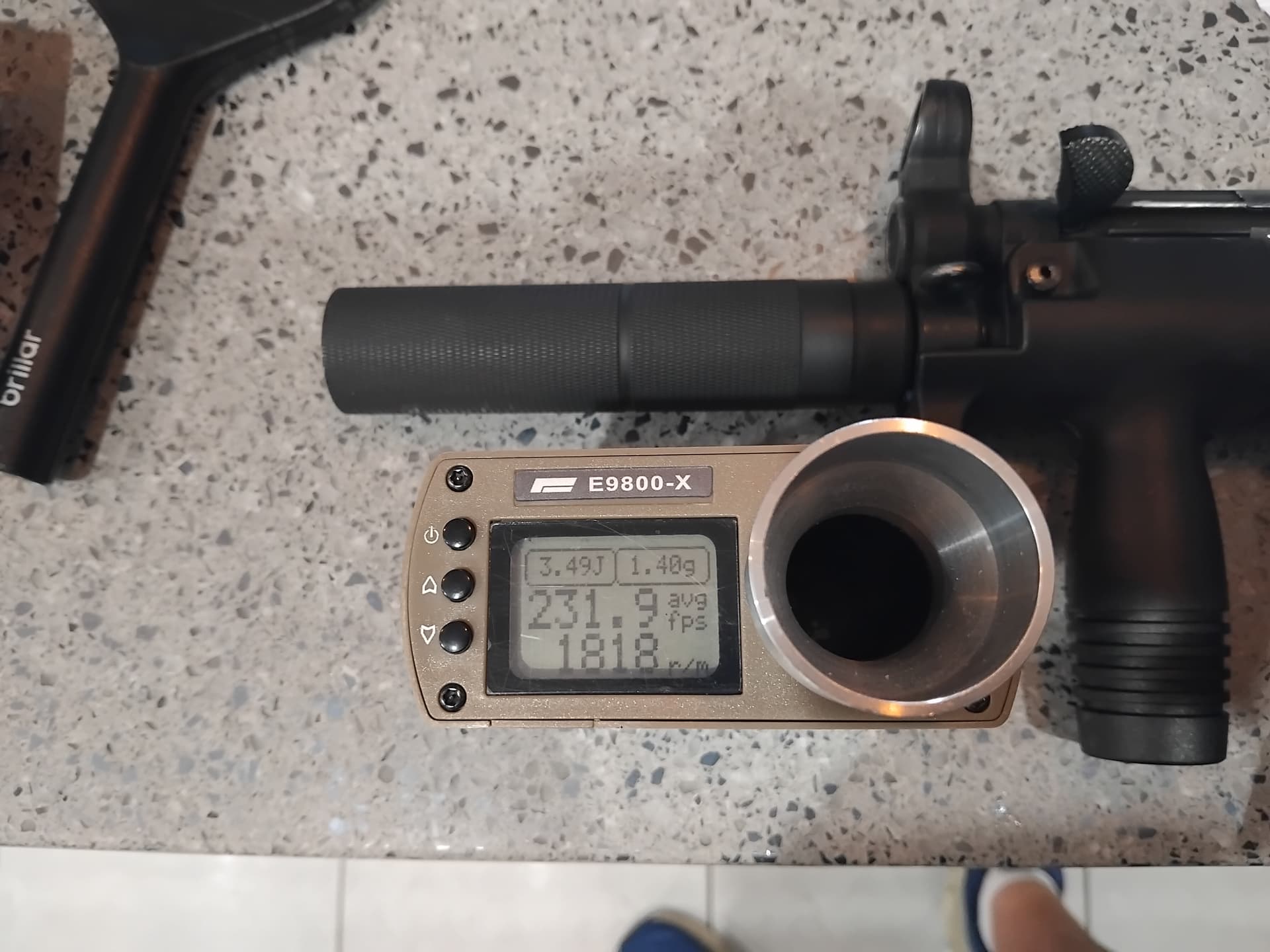

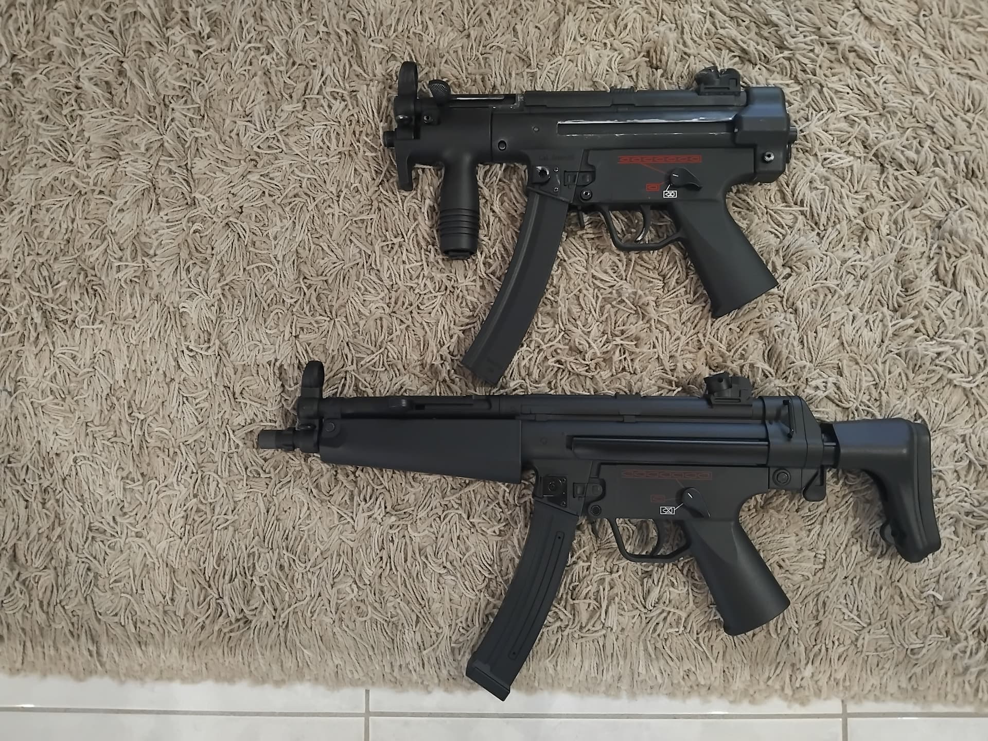

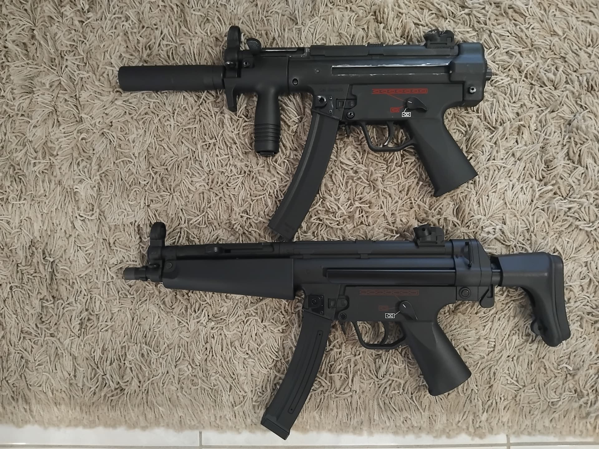

Time for a mini comparo, between JM and Cyma.
My JM has had a oring upgrade, and maybe a slight spring upgrade…i cant remember…have to check earlier review…
@Friendly_Fire kindly did the Supp modification…the screw on Supp has a barrel extension, which adds to the barrel length.

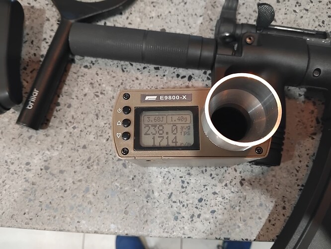

Also, use of the supp really quietens the blaster down…very backyard friendly.

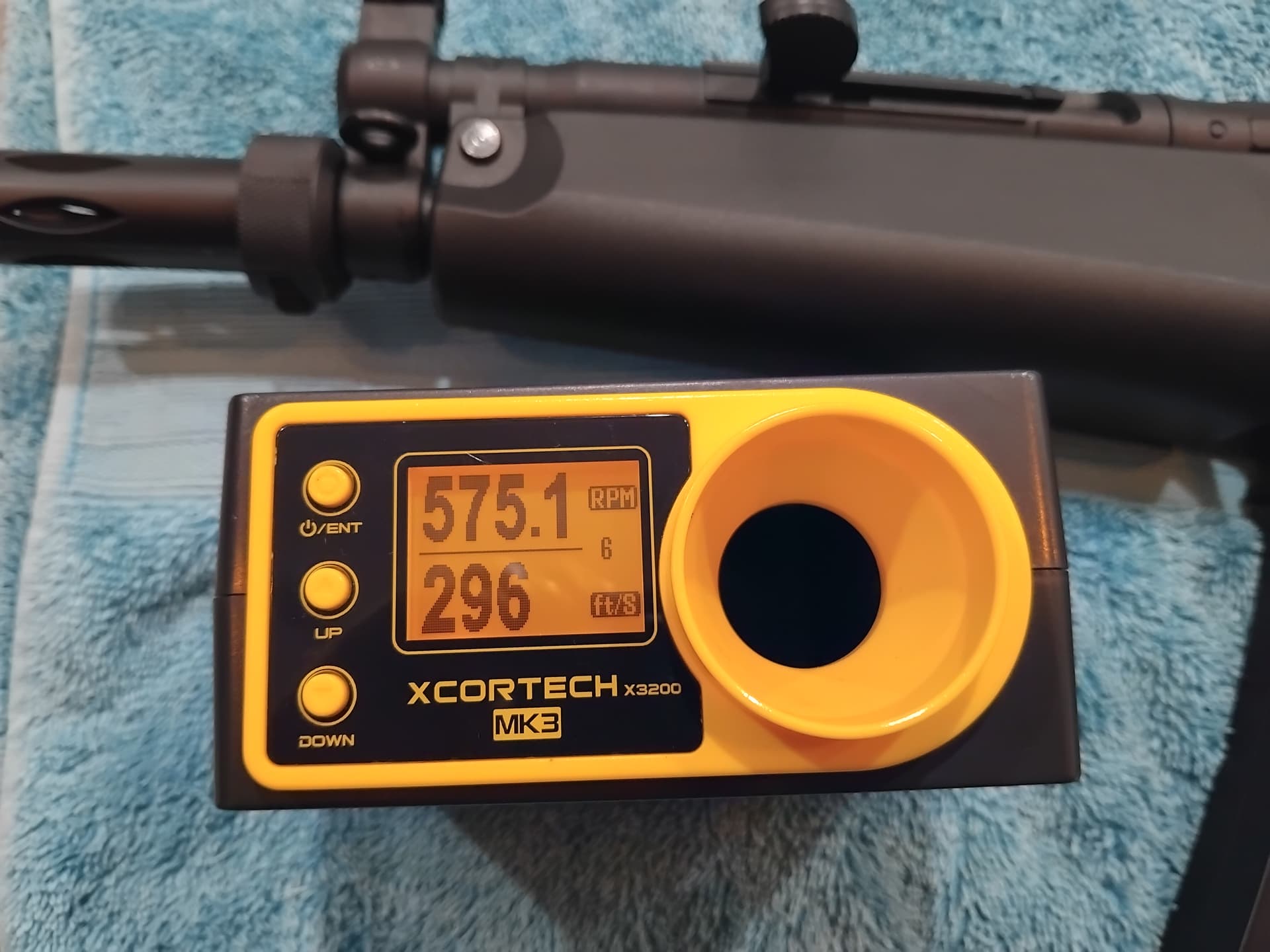

Without the Supp…it does about 180-190 fps.
With Supp around 230-240 fps.
ROF is insane, at around 1700 R/min …!!
Short, controlled bursts…!! :rofl: :rofl:
No Supp…
Supp on…
With Supp on, effective barrel length should be about the same…

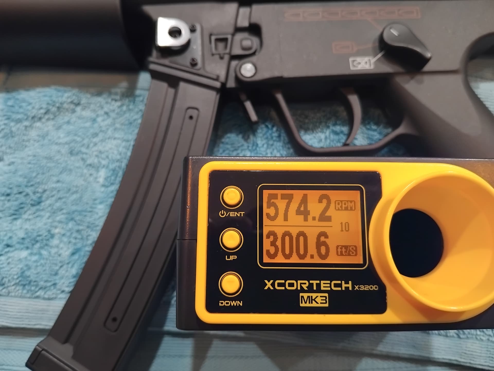

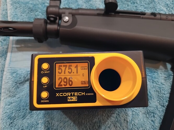

Cyma pulls ahead at circa 300 fps.
JM might benefit from one longer, continuous barrel…
@Wombat … what did you do to your JM.?
I seem to remember a long barrel inside your Supp…
Which spring did you end up going with.?
If you were to choose…both are good ( when sorted)
I know @gti2022 had 2 cursed ones, but they should be able to be ressurected, i imagine…
The Cyma has better OOTB performance, readily available spares / gearboxes… and the 2 stocks / 2 mags if you go xforce.
I would think AKgelblasters Cyma would be cheaper, being the single unit.
JM is cheaper, more compact…but requires a bit of fine tuning to get sorted…
The choice is yours.!
