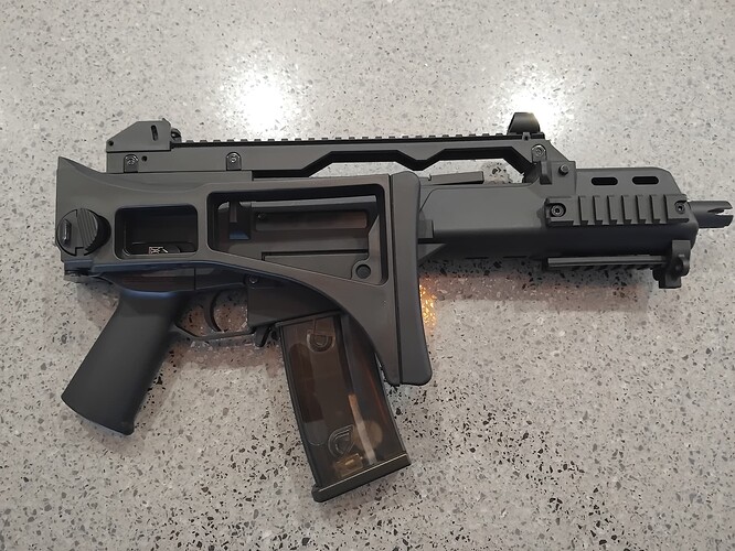

This should get @AKgelblaster 's attention…

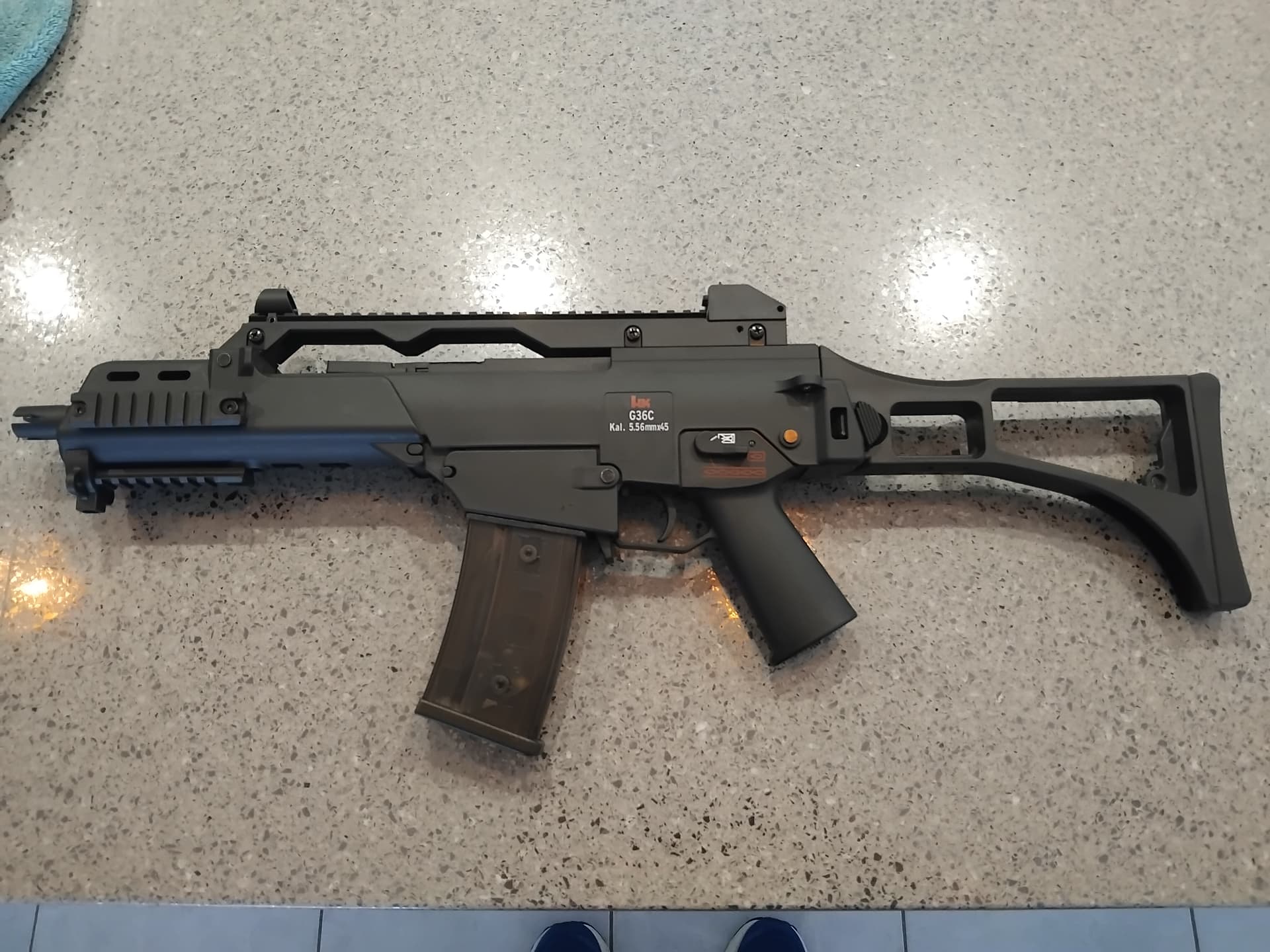

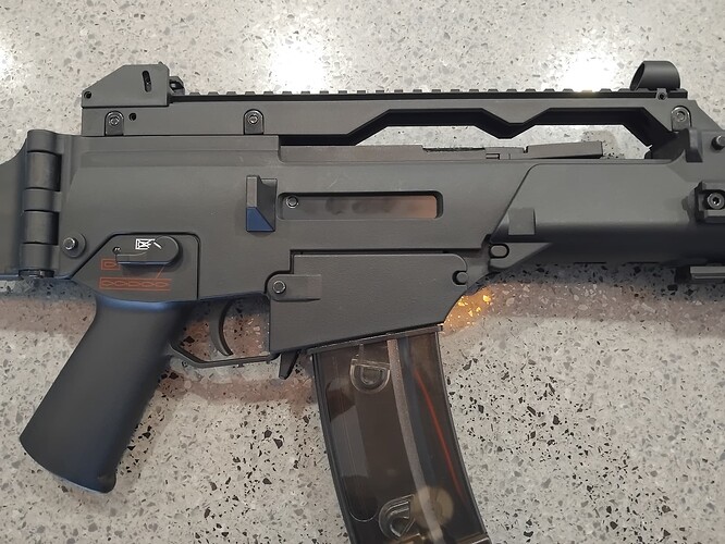

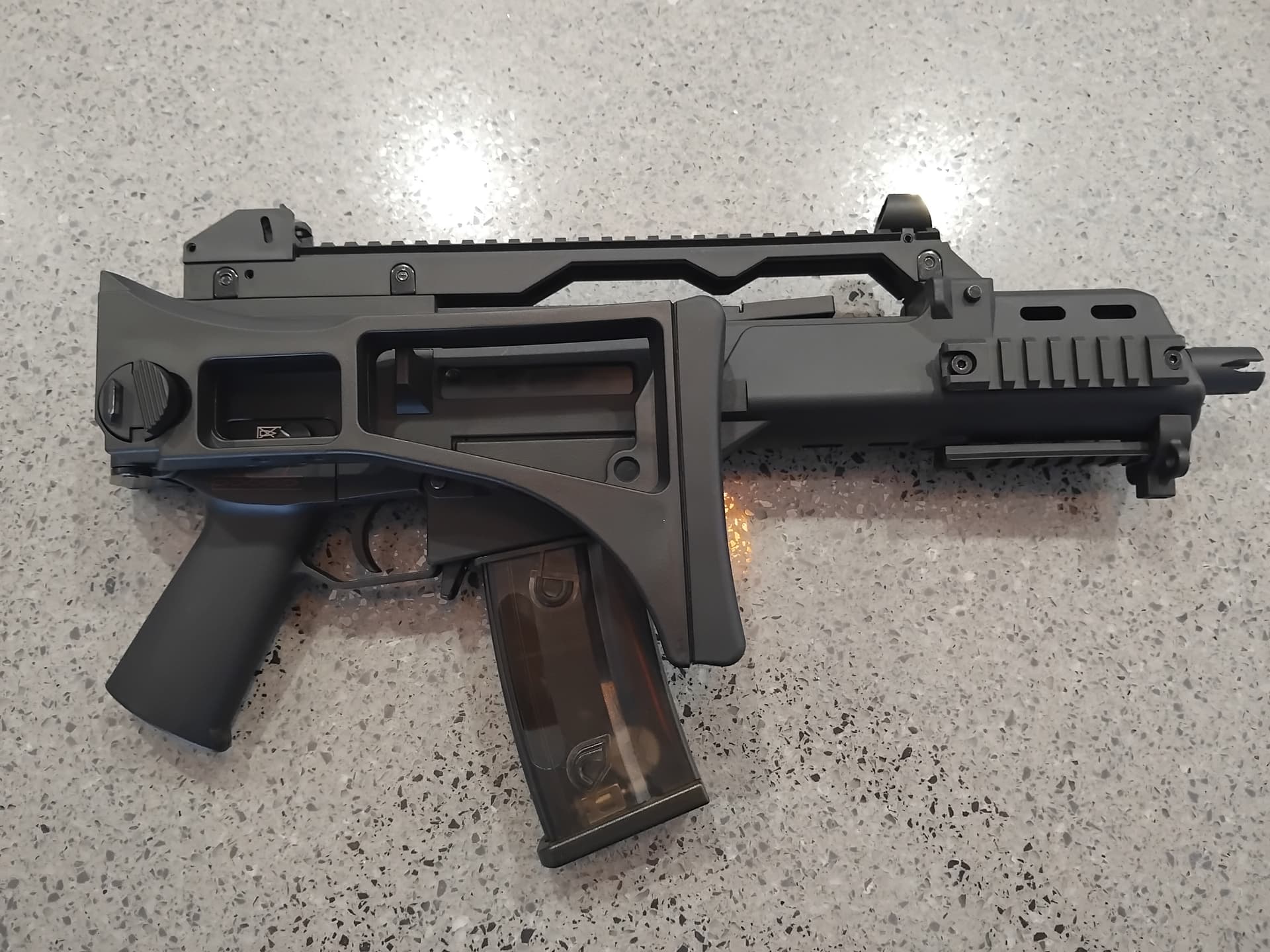

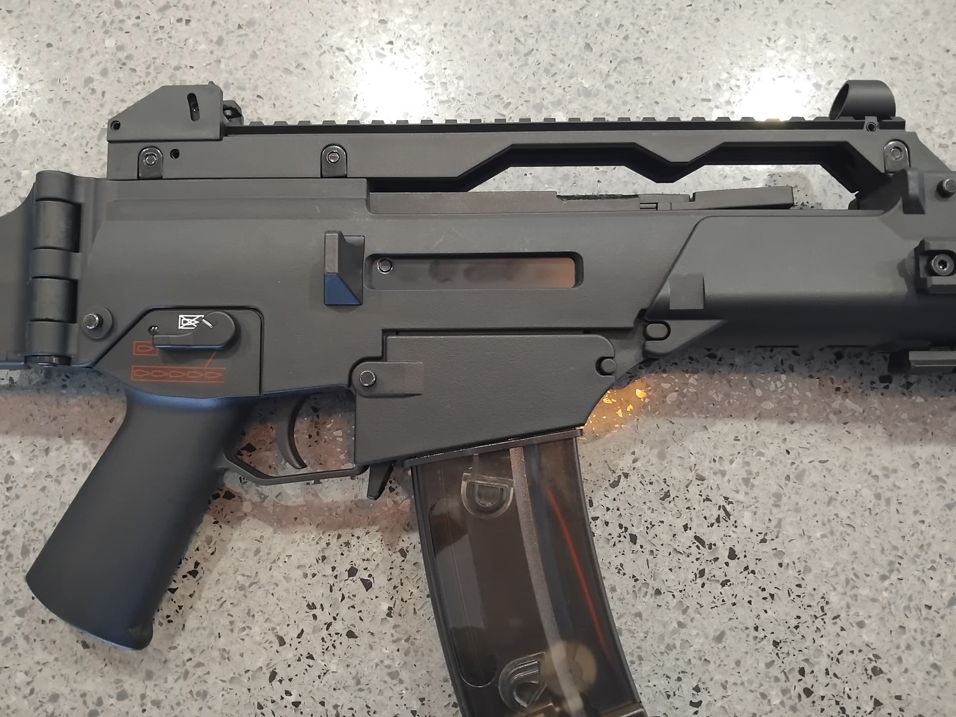

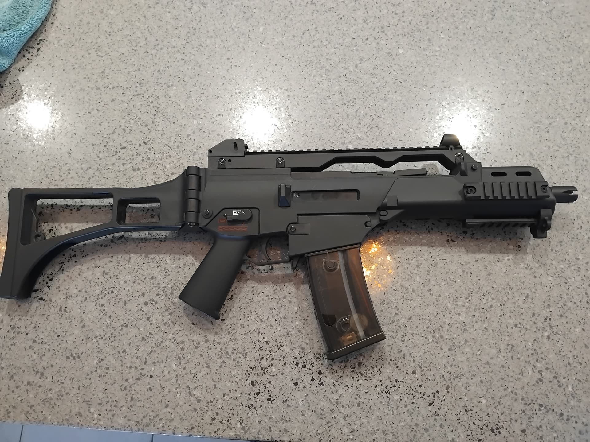

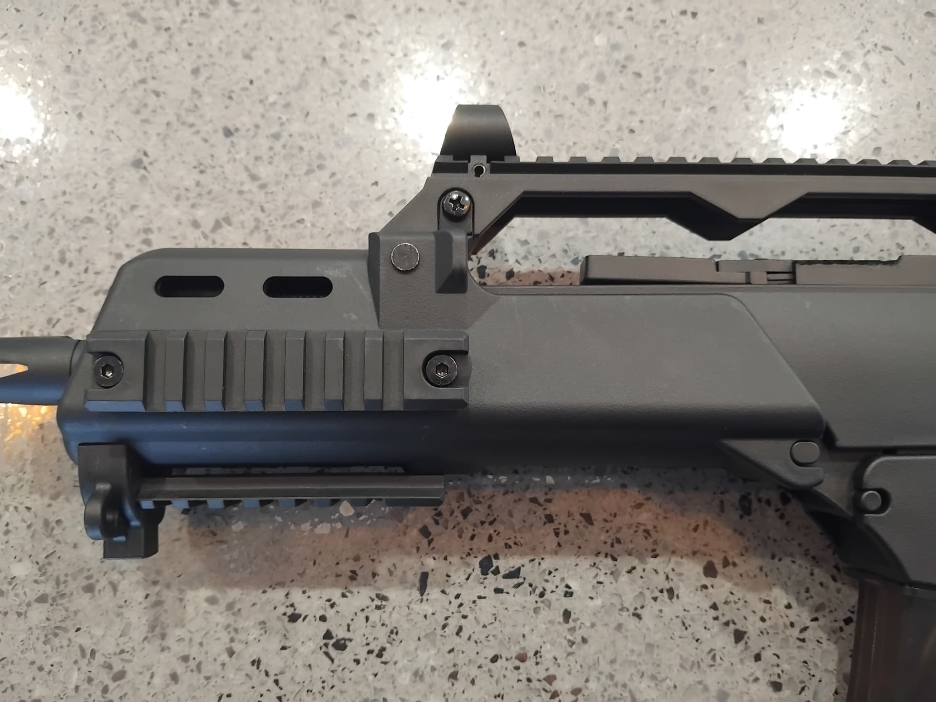

Review of the G36.!!
Initial impressions… Wa Wa Wee Wah.!!
Very Nice.!!
Very solid in the hand, hefty, sturdy are words that spring to mind.
I’ll do a comparo to the LDt at the end.
The LDT is slightly ahead on build quality…but not by much.
This is a solid build, that you won’t be dissapointed with.

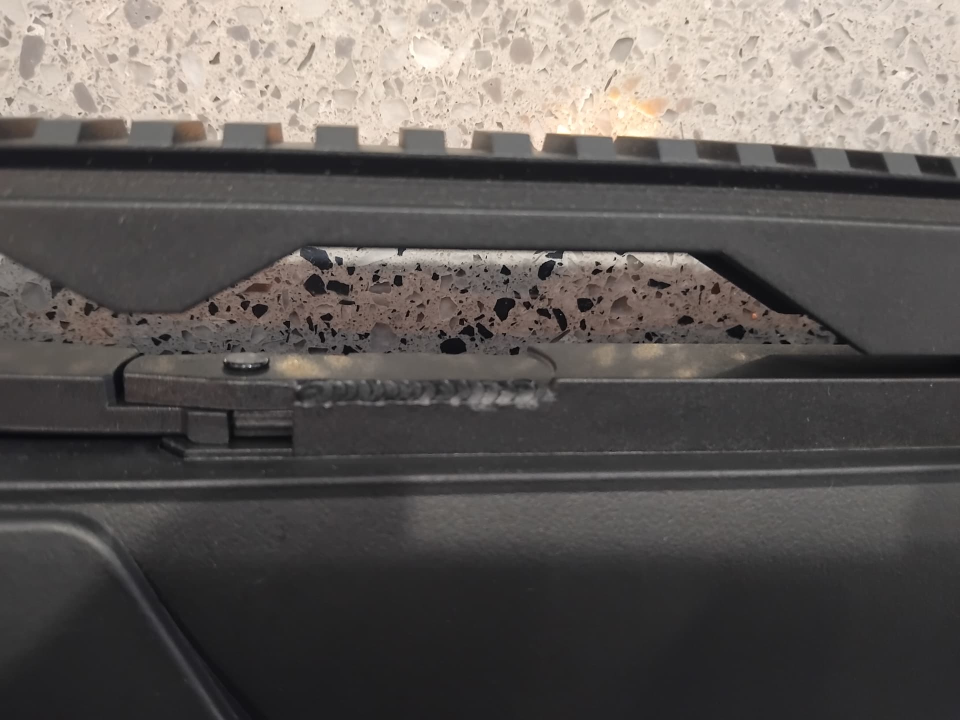

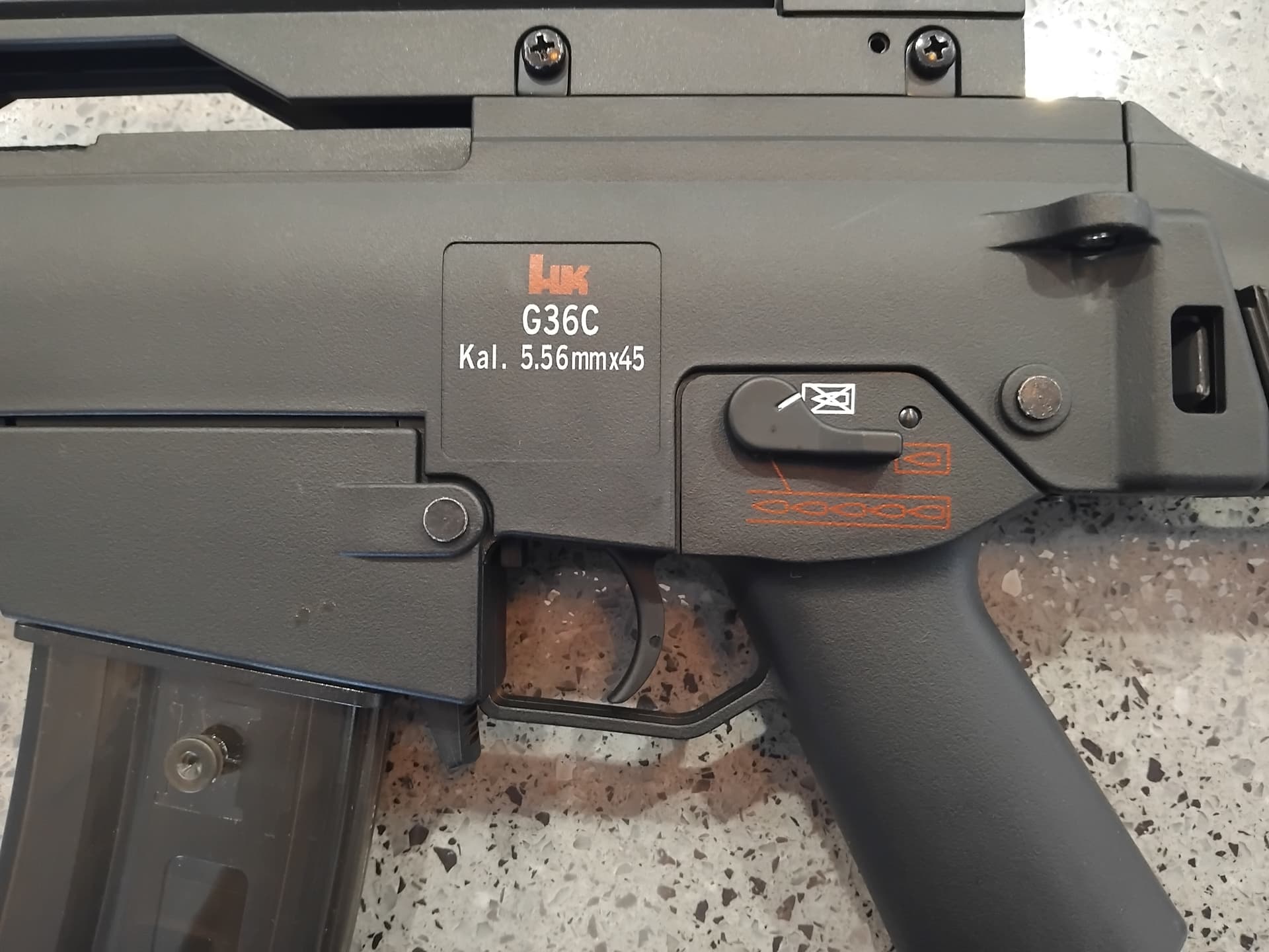

Markings are stenciled on, not engraved.
Fake weld marks…

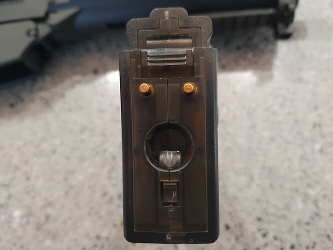

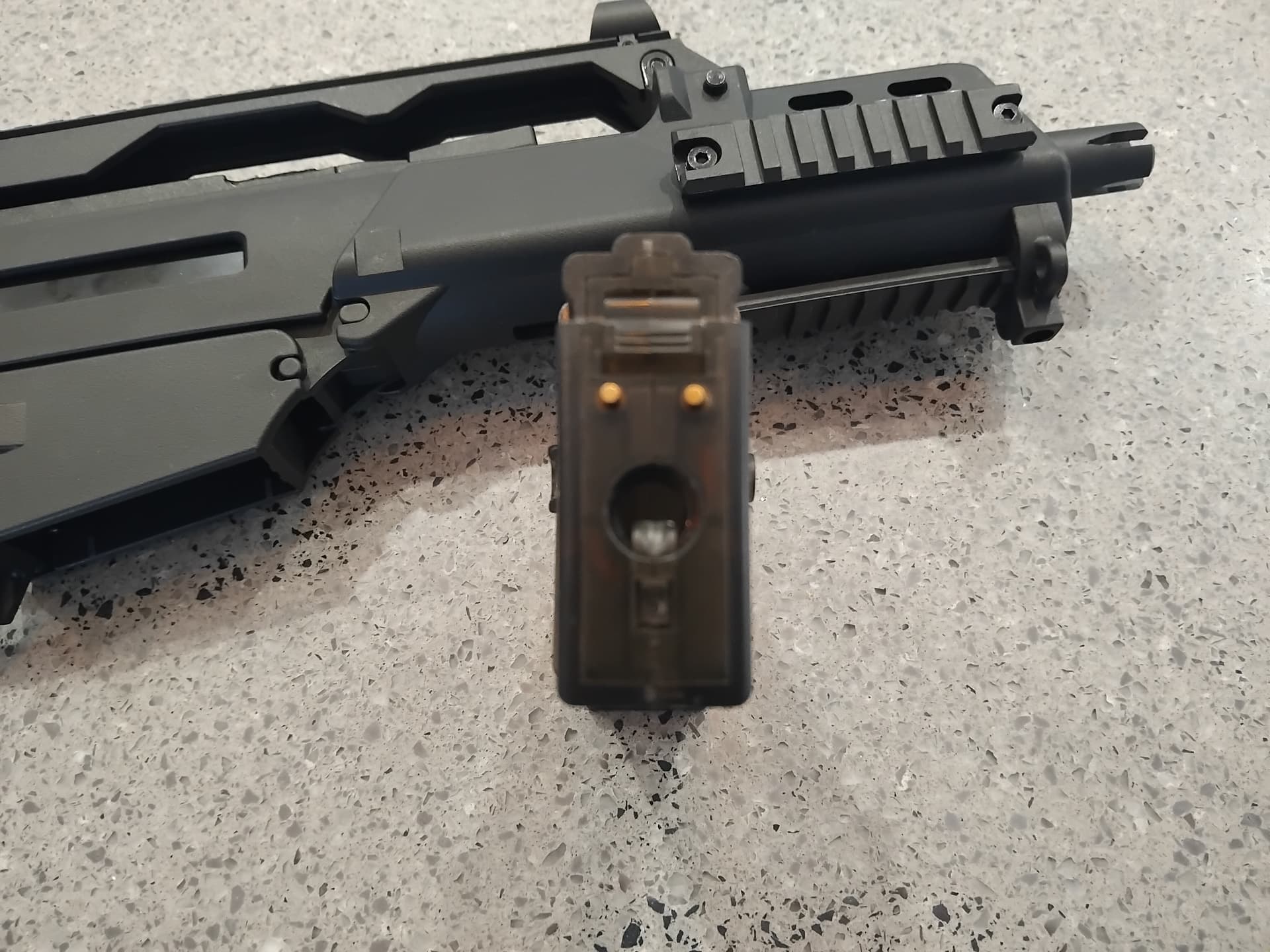

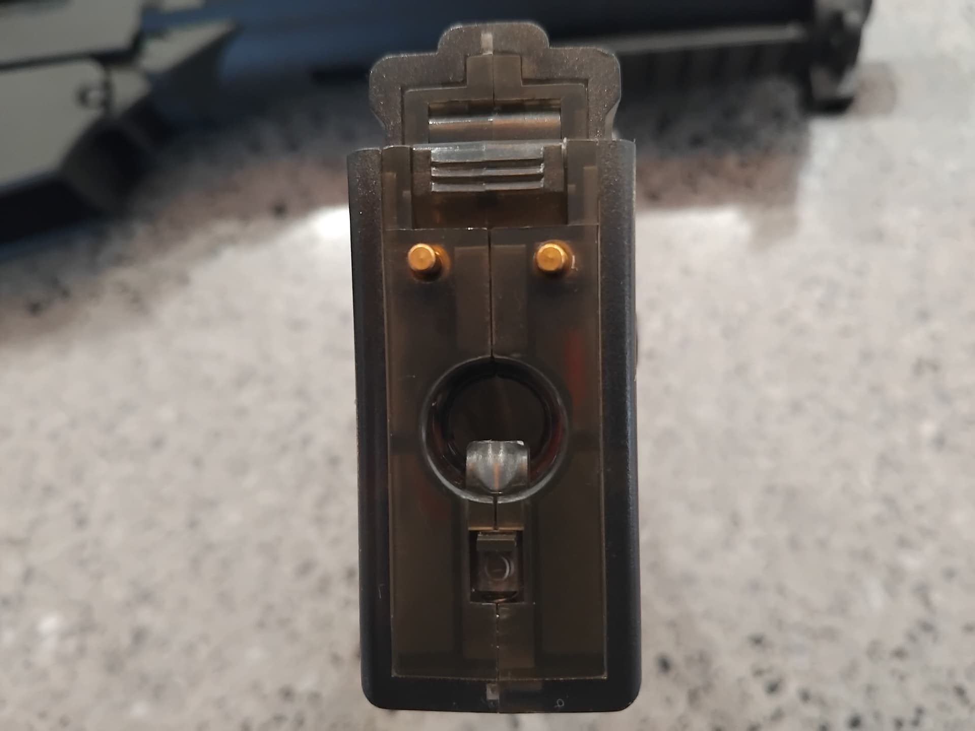

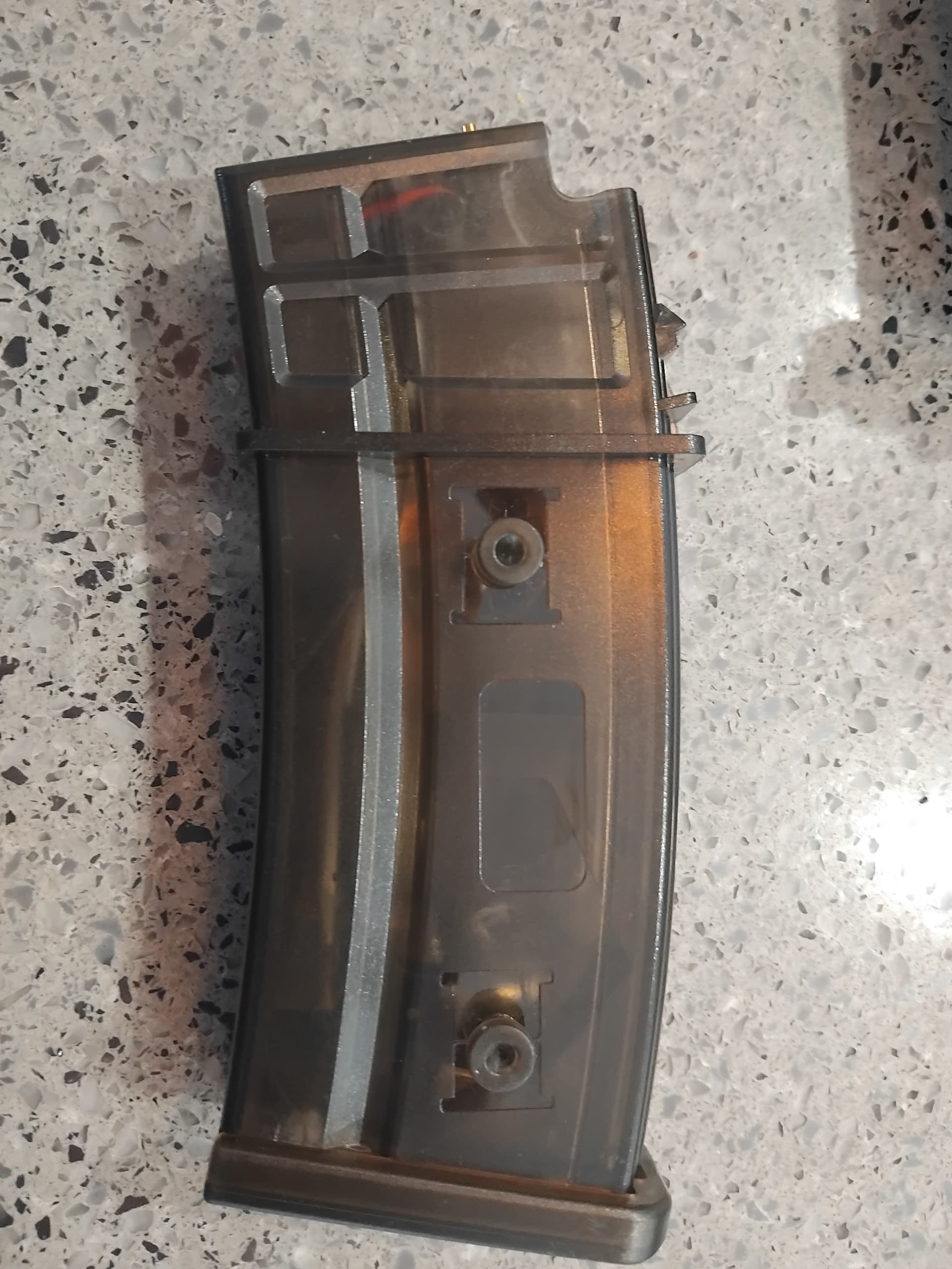

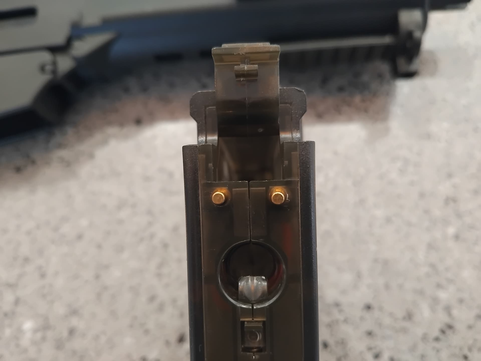

Semi transparent mags…
Why are you looking so shocked.??
No Luke… I am your father…Mind Blown…!!
I need to lie down, now…
Wrap me up in a blankie…its nap time…!!

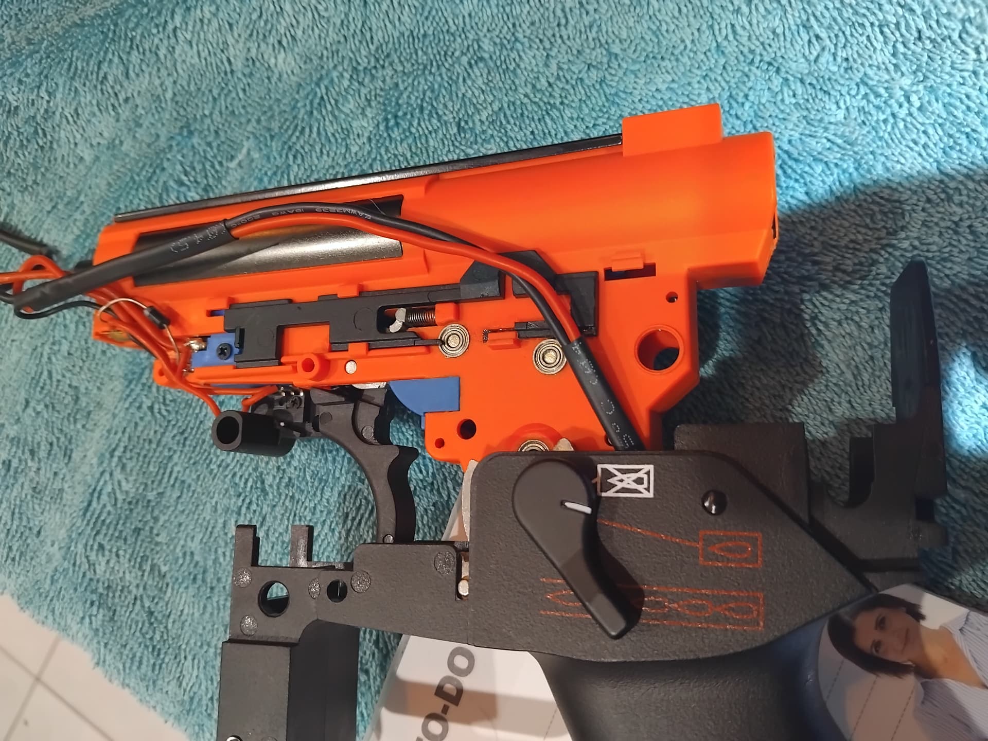

When i first got it, a few things were apparent…
*Blowback was very loud and annoying.
*Fps was quite low. Like, something was wrong low. Around 180-190, with the max of 210 fps. I figured there was some sort of fault…
Time for a pull apart, to investigate…

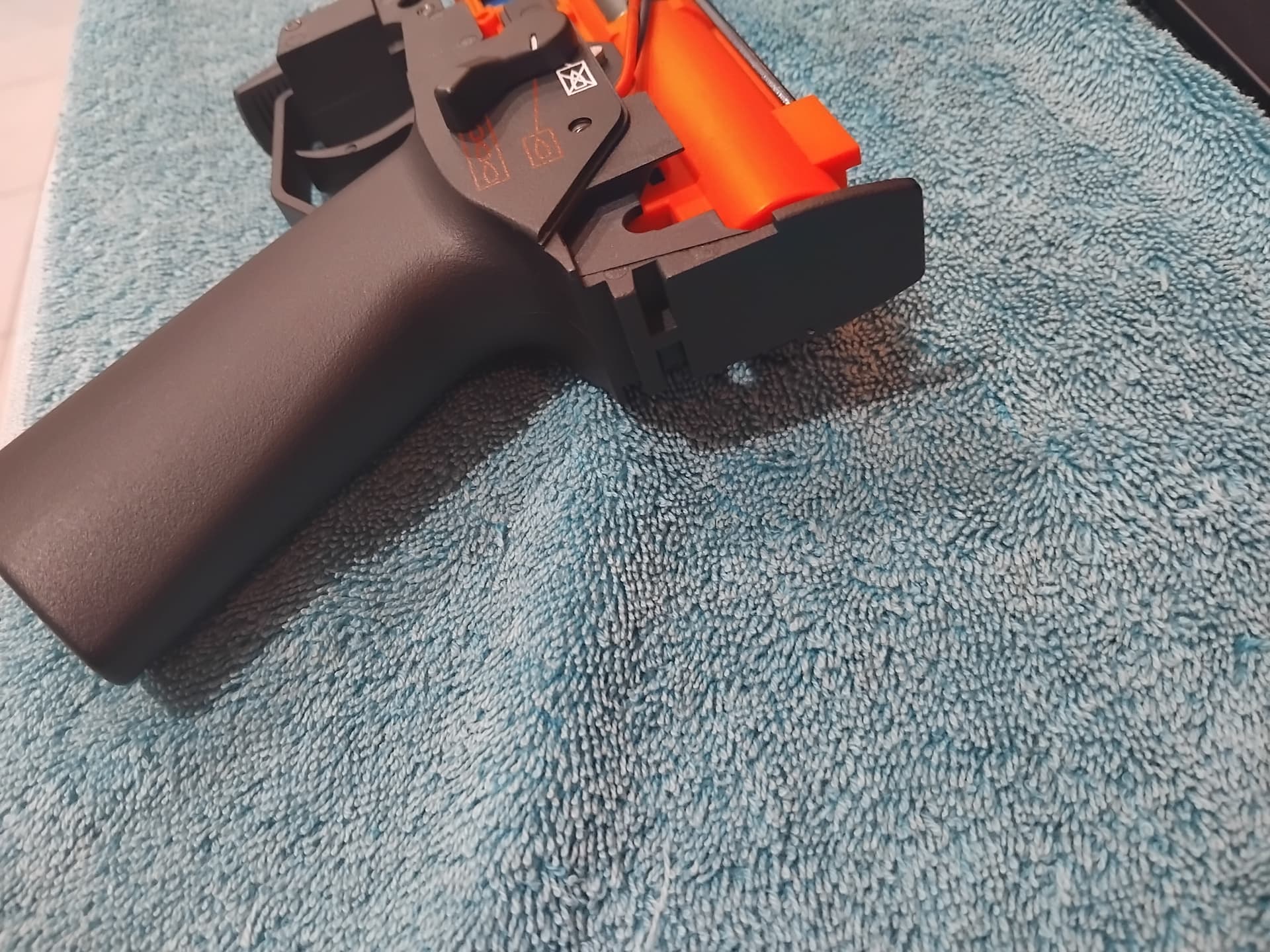

BME
August 24, 2025, 1:46am
8

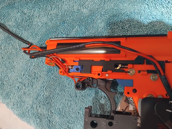

Teardown video above helped.

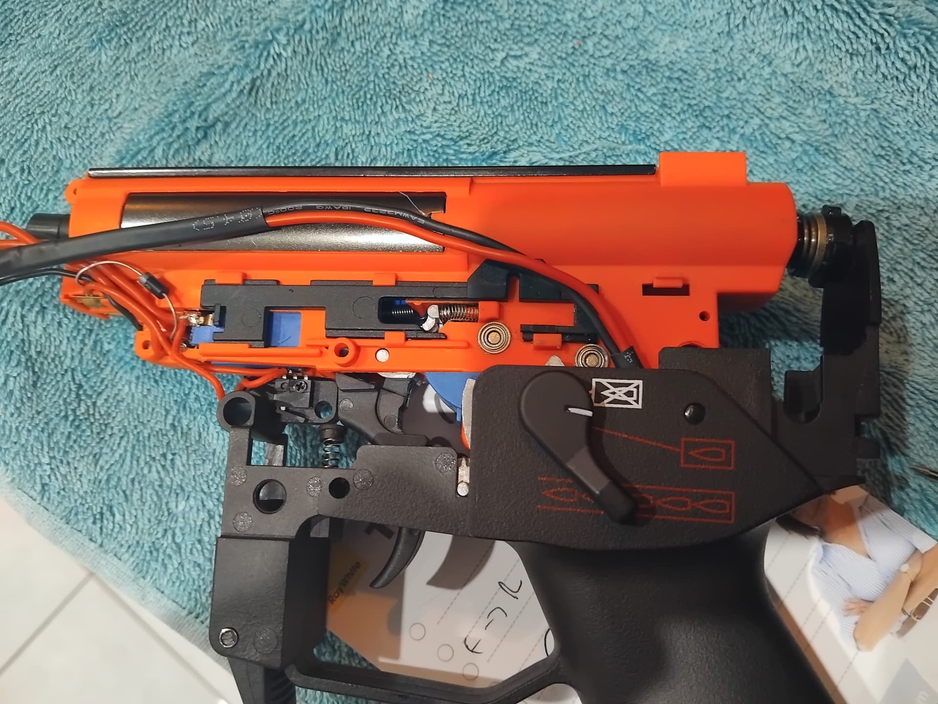

LDT is easy, 2 pins out , and its apart.
This is a bit more involved, but not hard.

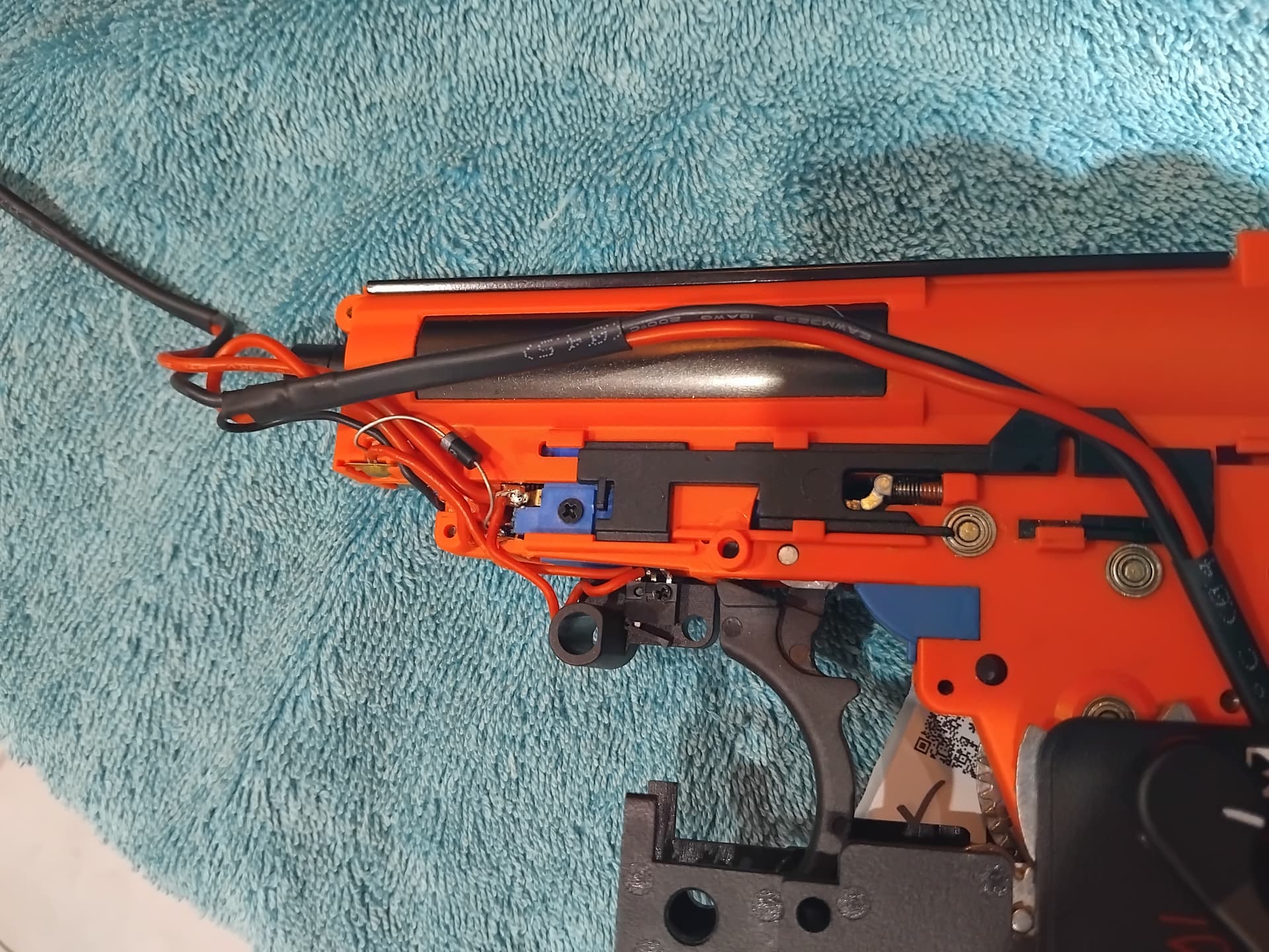

Got down to the grip and gearbox…v3 style…

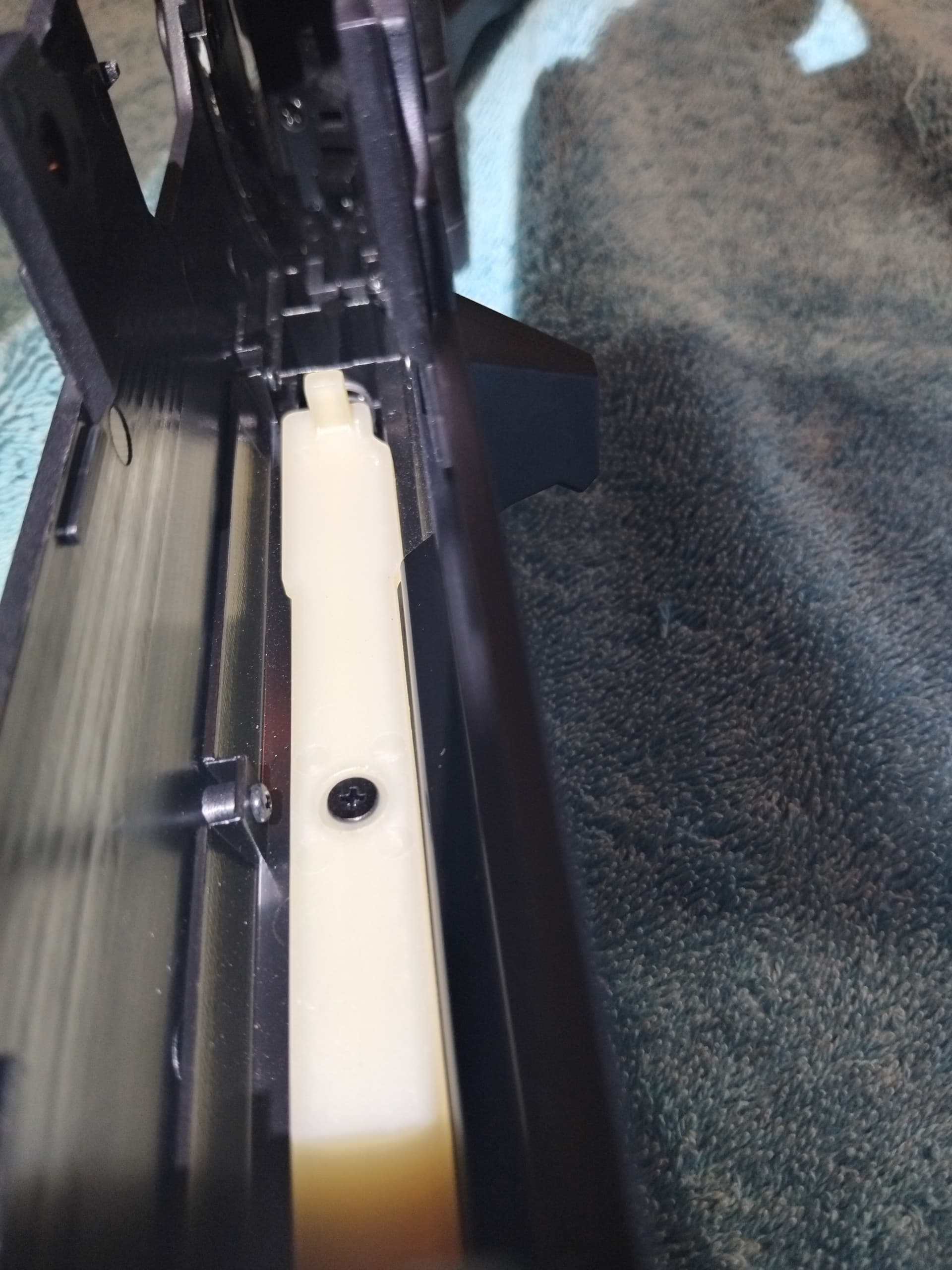

It has a plate at the rear, behind the Spring retainer.
Just as well…
Can you see the bomb, waiting for me.?.?
Spring retainer had come loose, and was protruding out.
That was why fps was low…spring was out, further back, and not compressing properly.
Funny, as it has a 4 point retention system…
BME
August 24, 2025, 1:55am
9

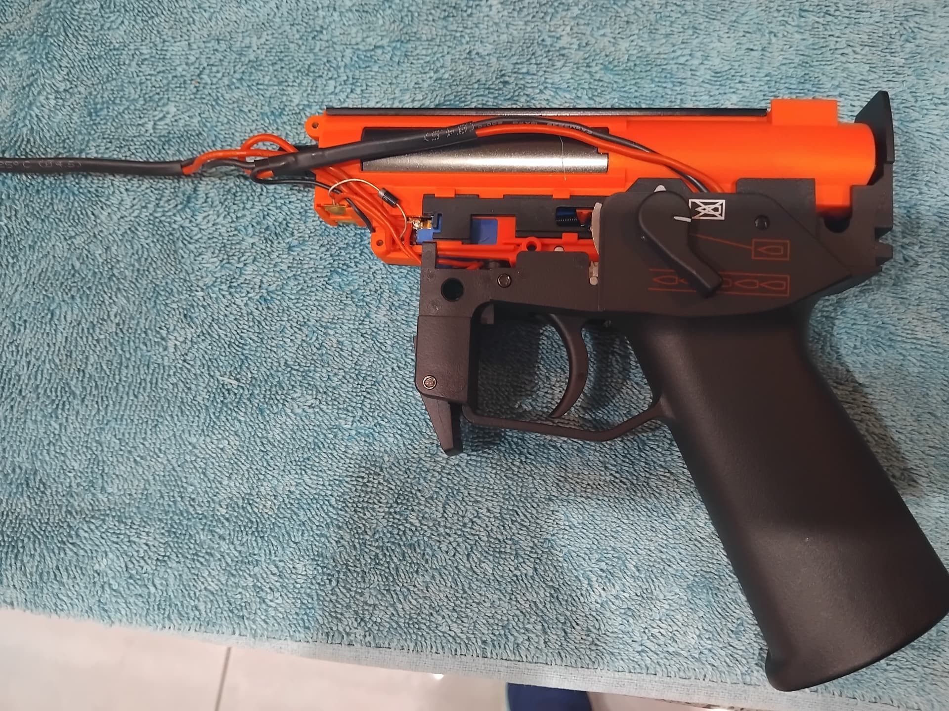

So, it looks like an assembly error that slipped through.
Easy enough to fix though…new M100 spring inserted.
Whole lotta wires, on the LHS…

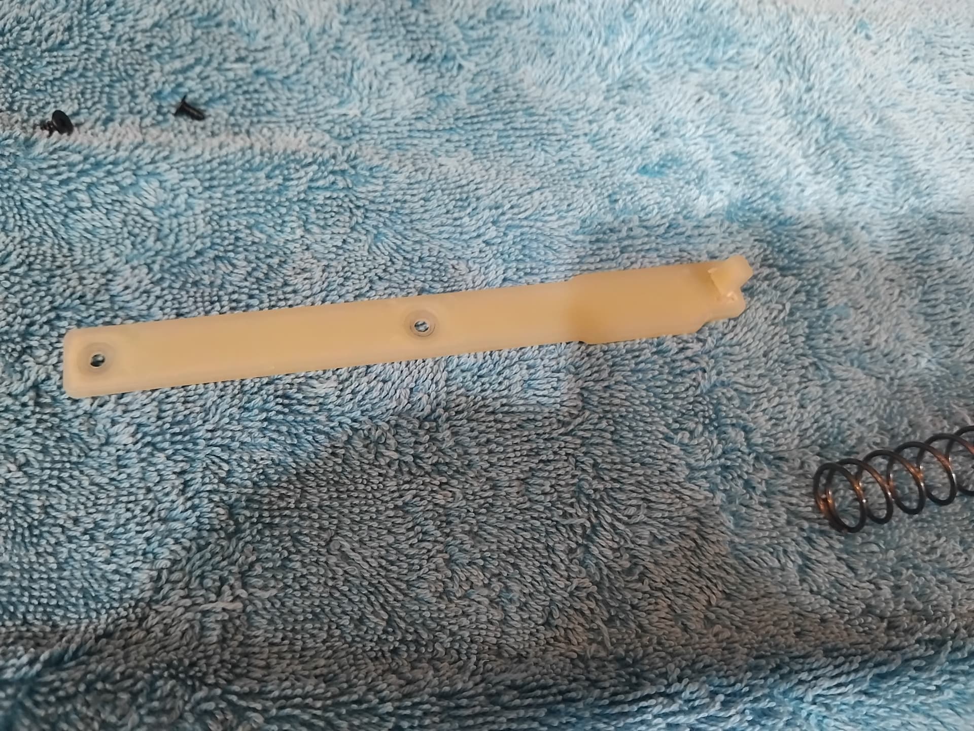

Blowback is easy to disable.

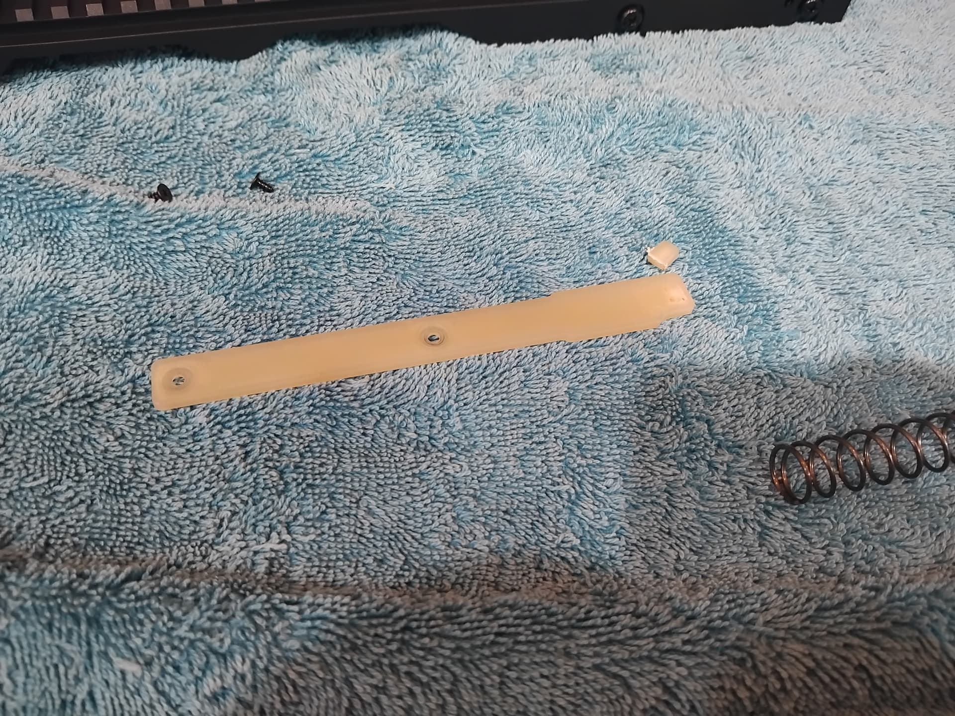

The tab unscews from the top of the unit.
Its made of really weak nylon, and hacksaw took like 3 strokes to kill it…
It would probably self destruct before long…
Hello Mr Blowback plate…
BYE BYE, Mr Blowback plate…wont be missed…sorry, not sorry…!!
When undoing the motor base, you need to undo all 3 screws.
The big middle one is NOT a motor ht adjustment…

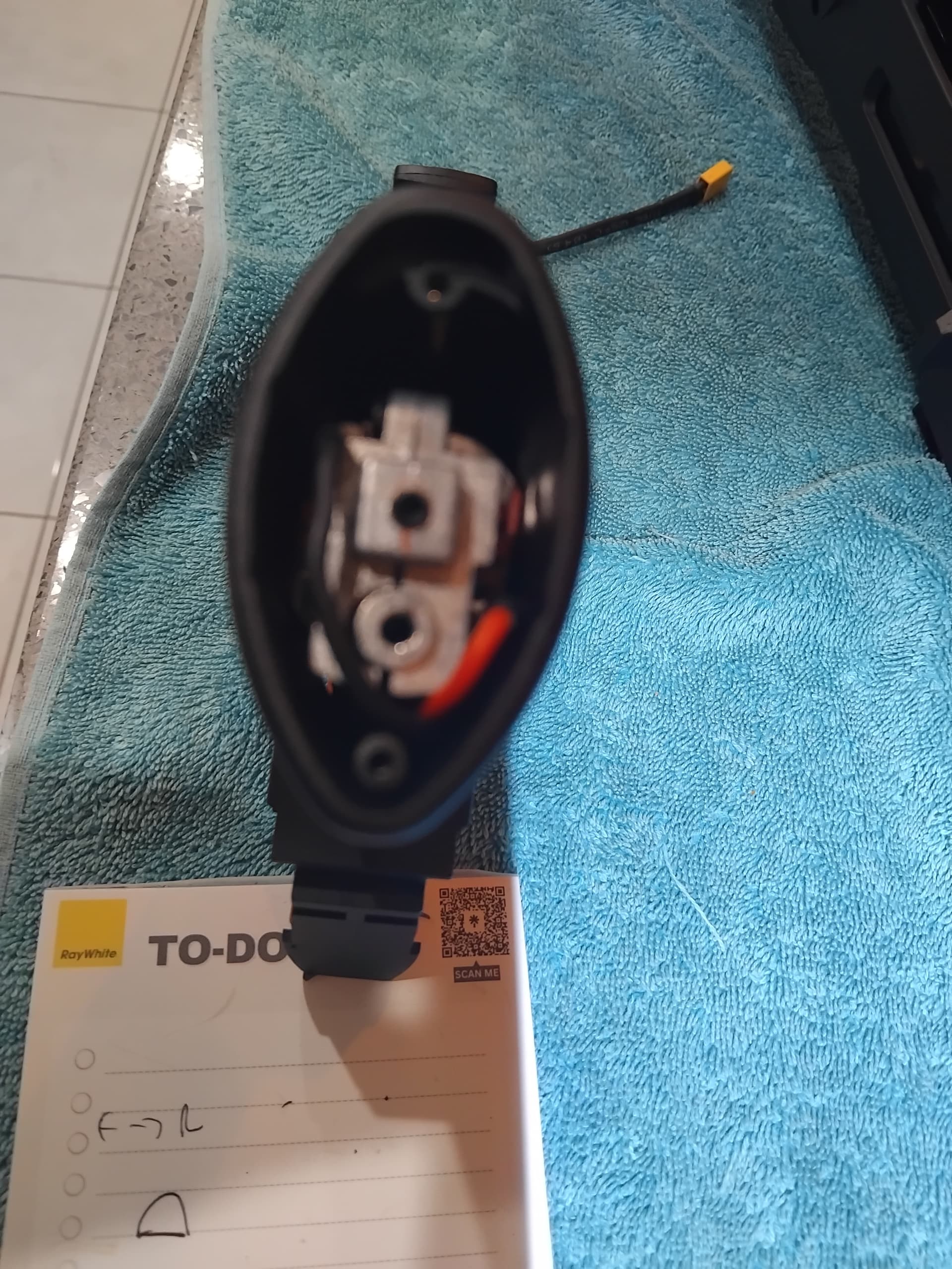

Battery Compartment is easy.
Forward wired, and one pin removes the front compartment.
Its easiest to hold the blaster upside down, to support the battery, when reinstalling…

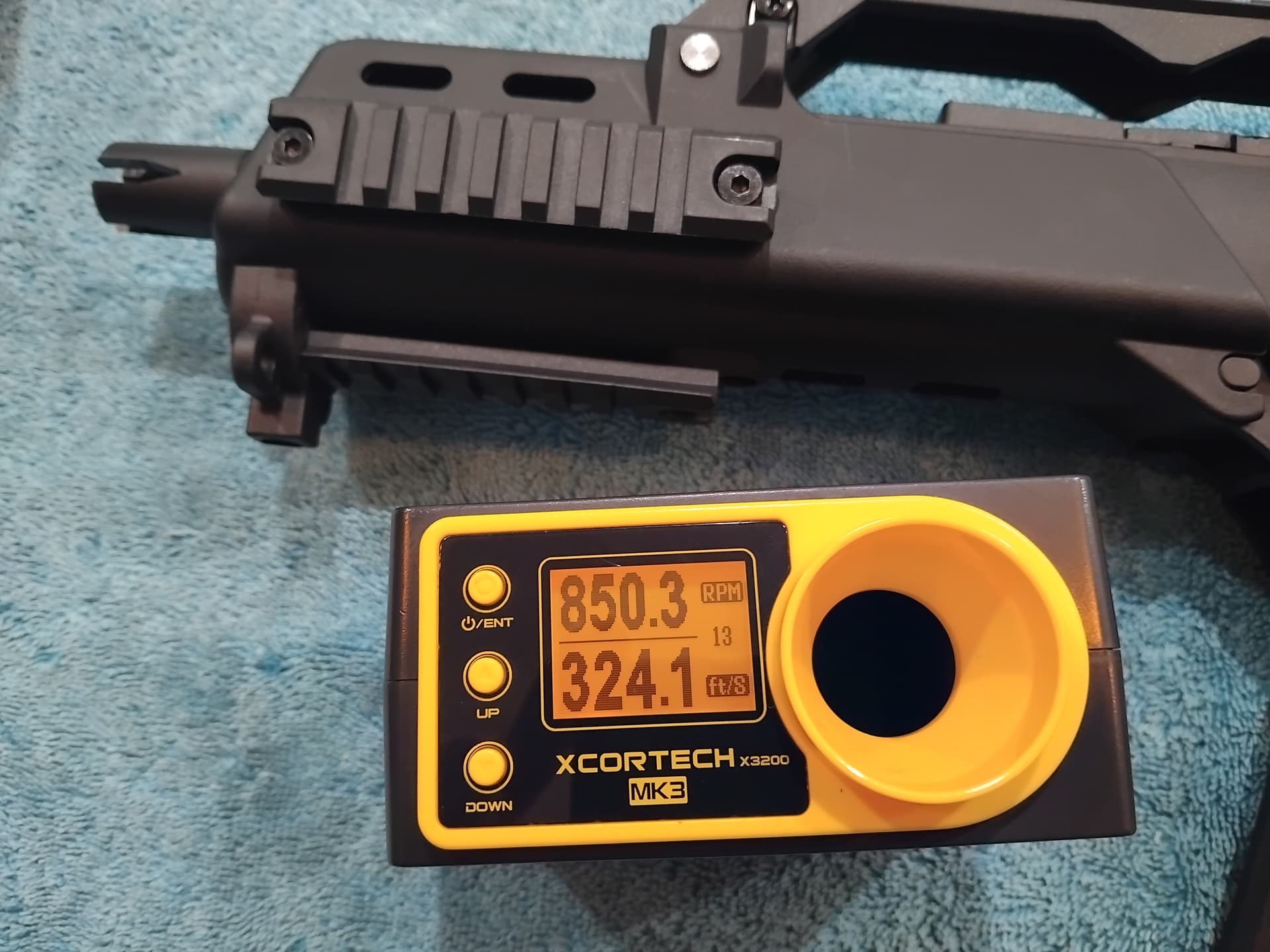

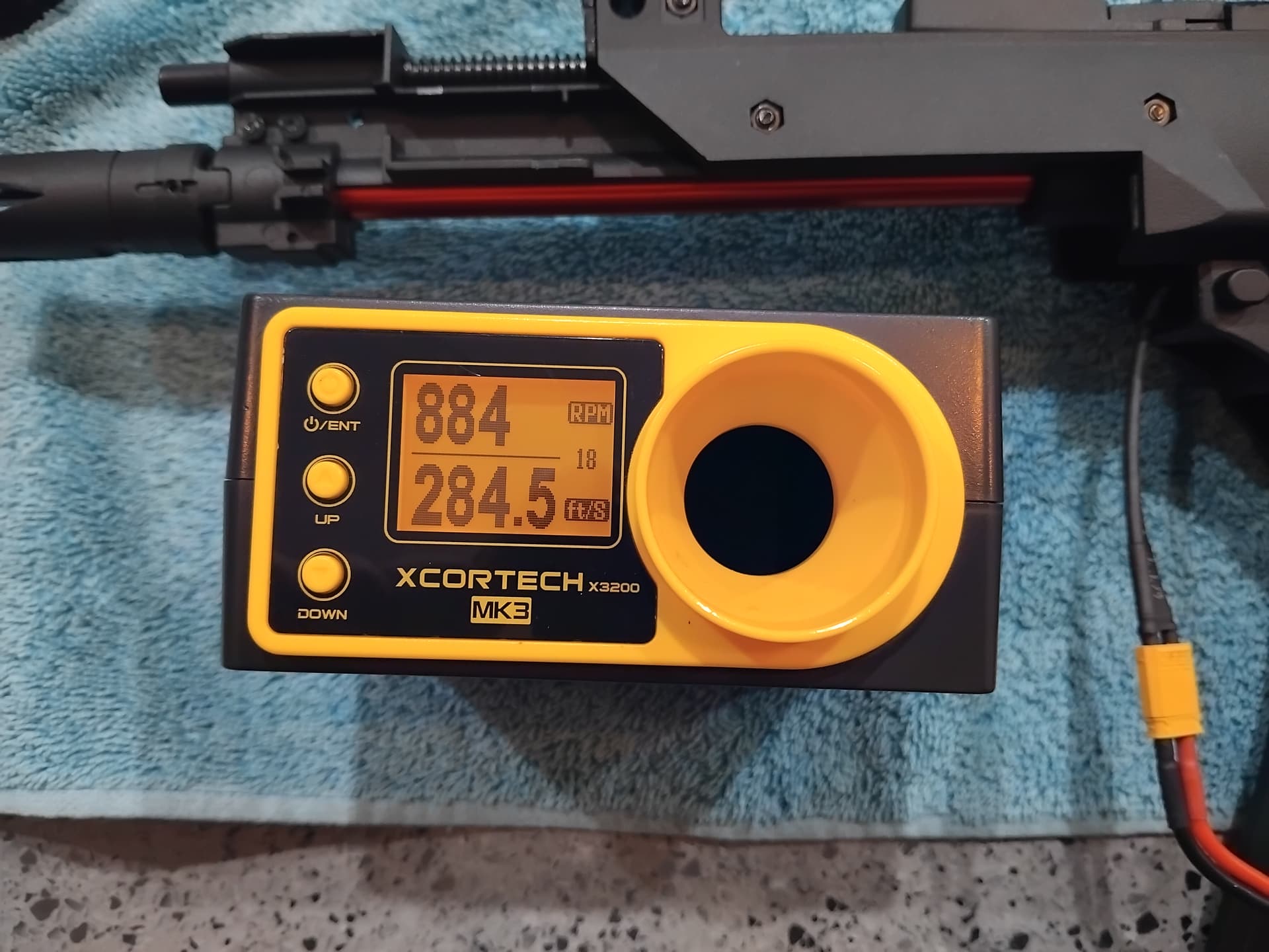

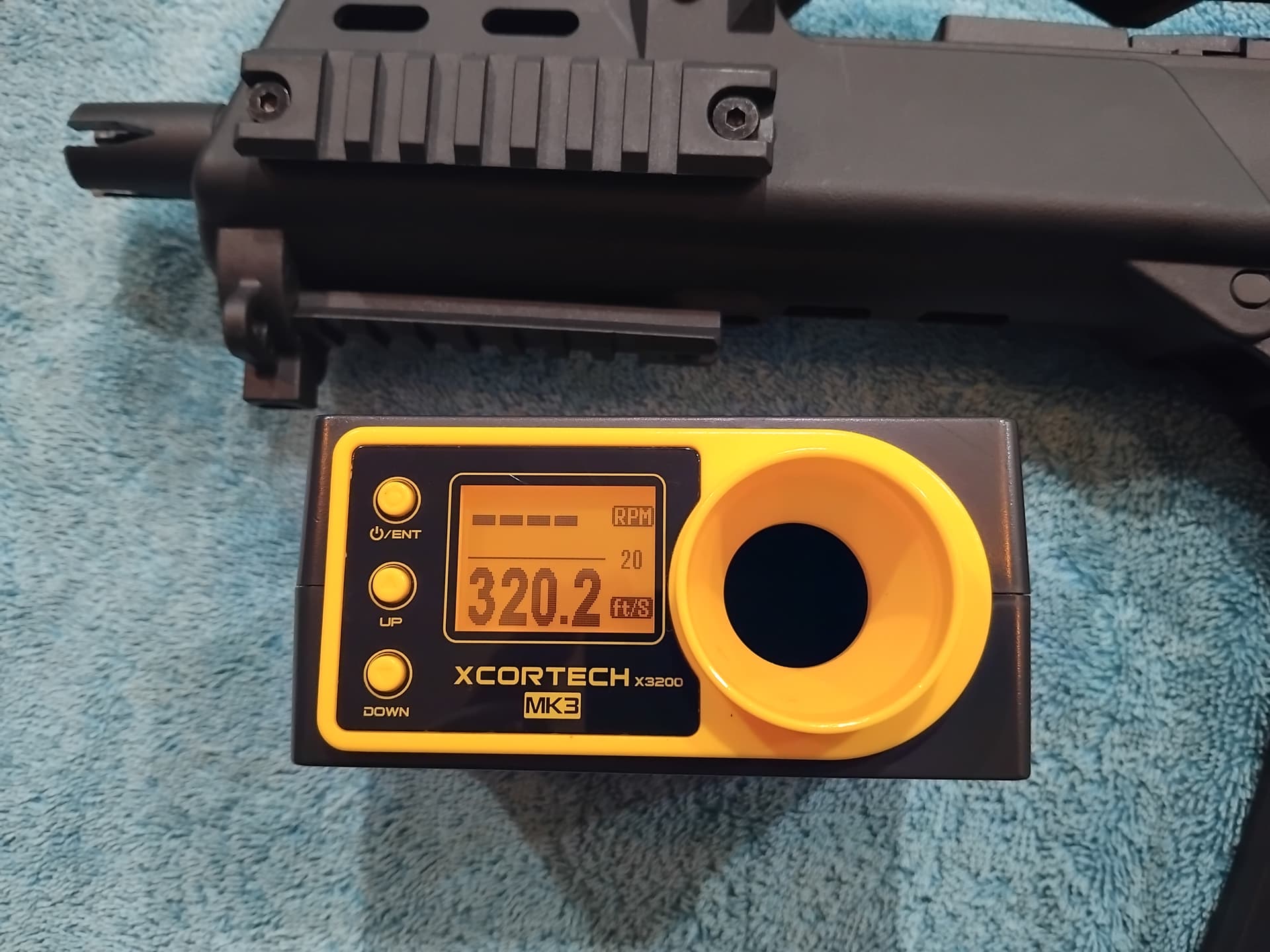

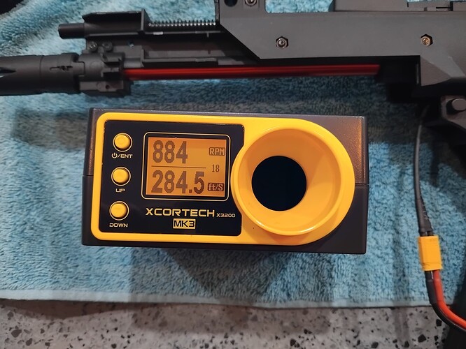

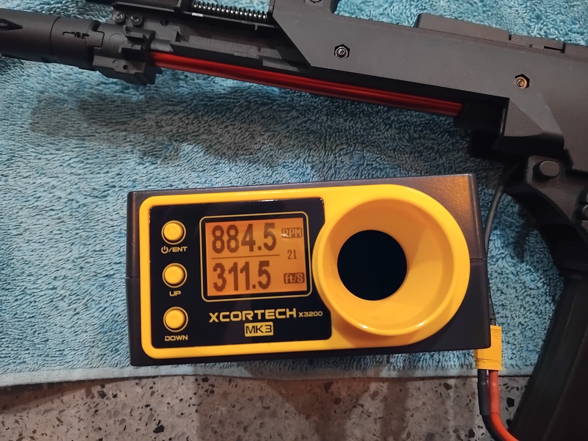

Anyway…all back together, and time for a test fire.
Using pink xforce/ blue ihobbies got the following…
SEMI… 310-320 fps
AUTO …Varying 285 Low, 325 High.
I’d call that a solid 315 fps auto blaster.!!
Very healthy numbers!!
I didn’t crack the gearbox last night, and i dont think i need to…very good results.
All this, from just a M100 spring upgrade, with not a long barrel.
So far i have done nothing, to the Scar…275 fps from the standard spring.
Later on, i’ll crack it open, new oring, new spring… i reckon a solid 330 fps, from a M100 should be close to the money.
These results are good…on par with what a new SW Pulse rifle does.
All from a nylon gearbox.

No battery box jitters here.
No mag prime.
