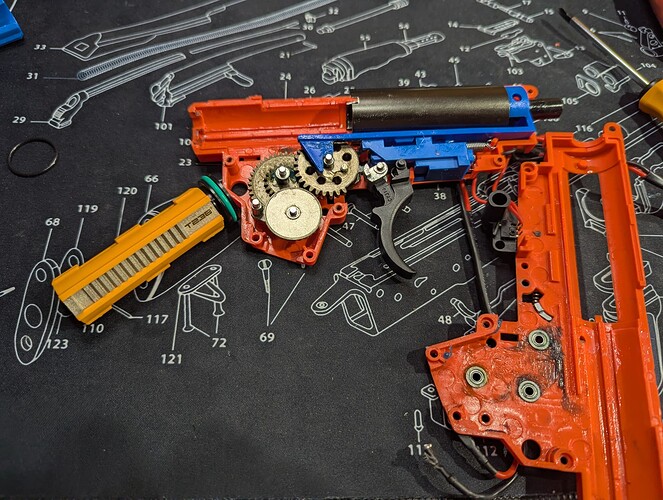

Had a play with @BME 's G36c.
Seems the cylinder head and piston head o-rings had shrunk. I’m not thrilled to see it but while replacing them, I also replaced the piston and piston head.
Now this is the first time I have used the new T238 Pro piston, I have heard they are tough, and they do look meaty, the rack is near impossible to remove, and the piston head I have used a few of.
Only replaced the piston as the stock one has only a single metal tooth… fine for bb slingers but for gel full auto use, piece of mind is to have a full metal rack!
And the piston head was replaced as the stock one is not compatible with other pistons without work.
In all. Two o-rings, piston. Piston head, BME 's m100… that’s it. Little clean and grease and oil.

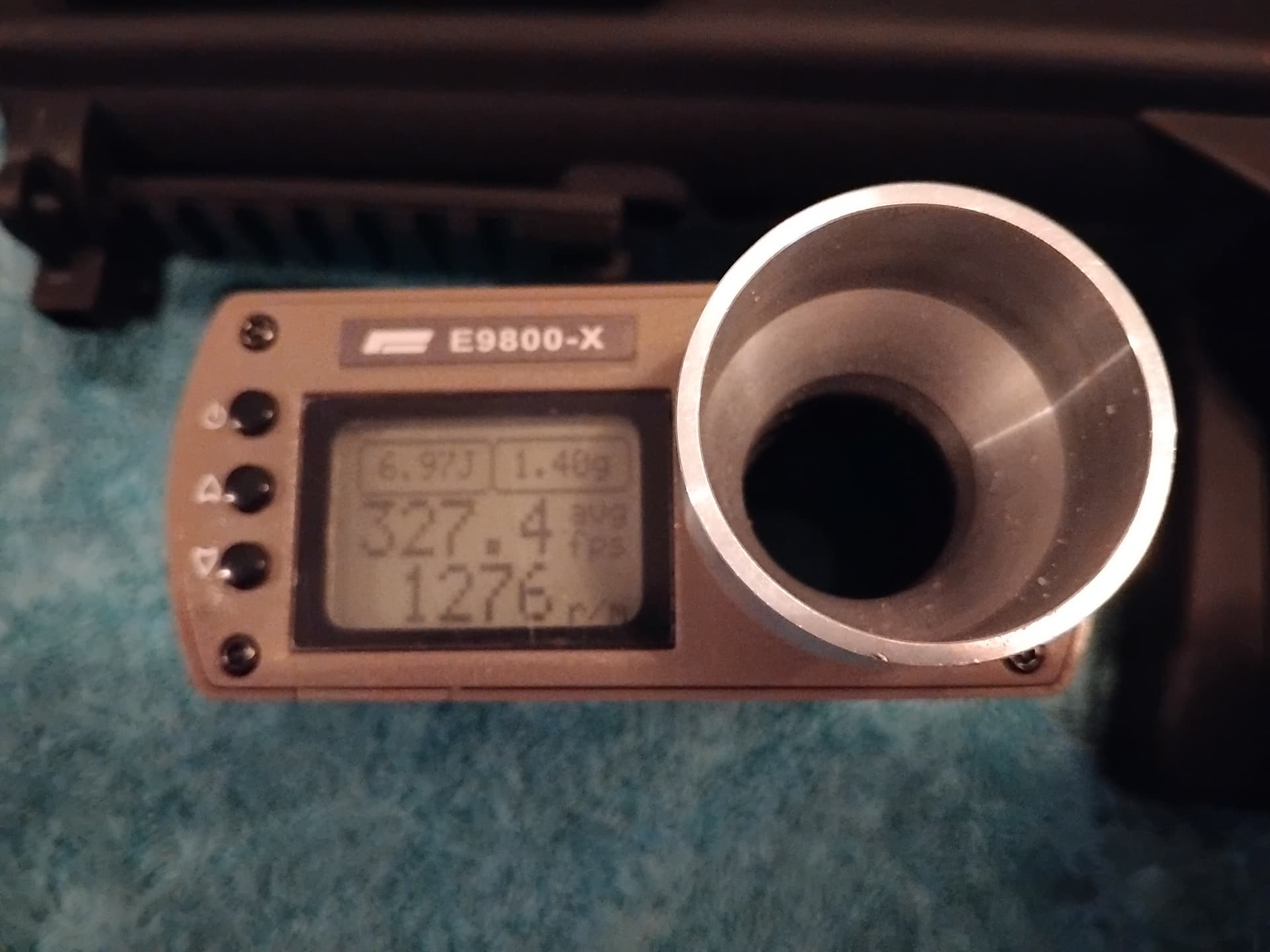

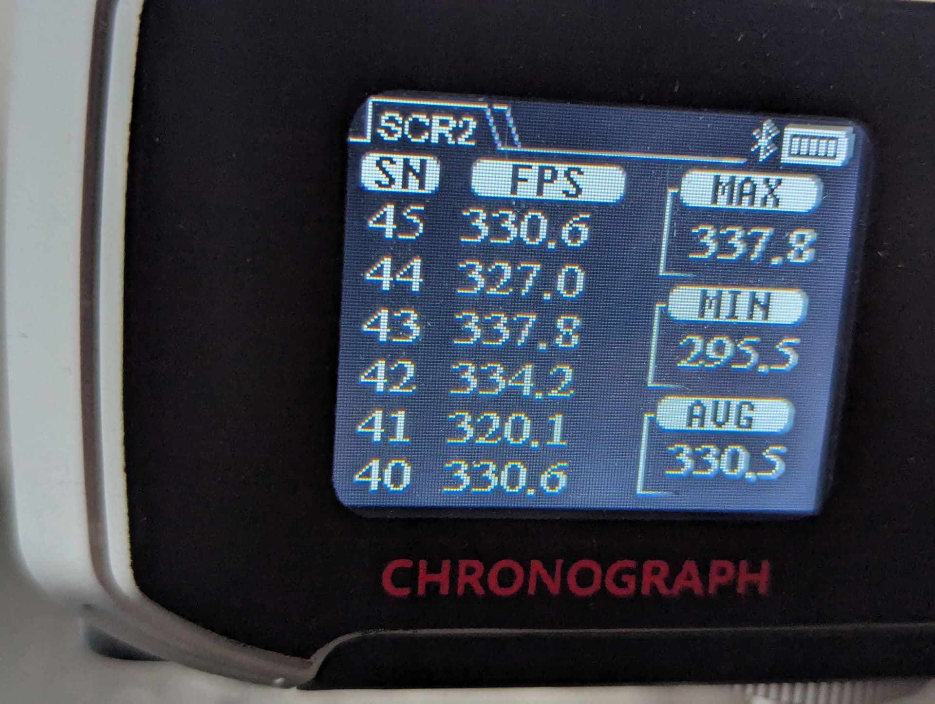

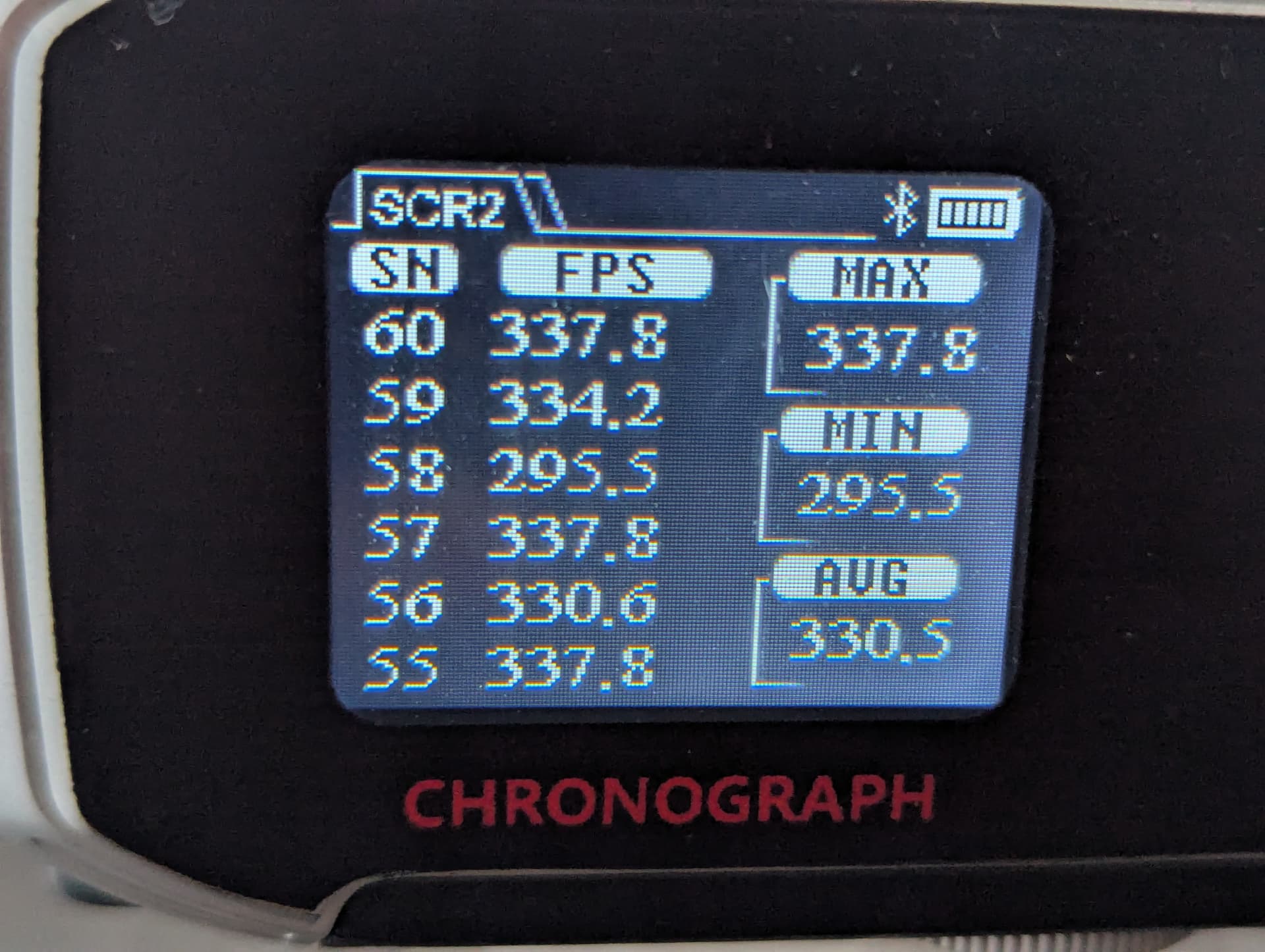

And the results?
Decent numbers I reckon!
Not much point trying to reshim unless swap to slim bushes… stuff all room!
As for a V3 box. Pretty good to work on. The trigger and trigger rocker stayed put for the whole operation, anti reverse behaved, and apart from trying 3 other pistons and heads first was pretty quick.
Let’s just say… I’m ordering more of these t238 pistons for any future cyma as they fit and worked well, the rell test is how long they last, but I am prepared to swap it out if it gives trouble because I don’t like using parts I have tested myself prior!

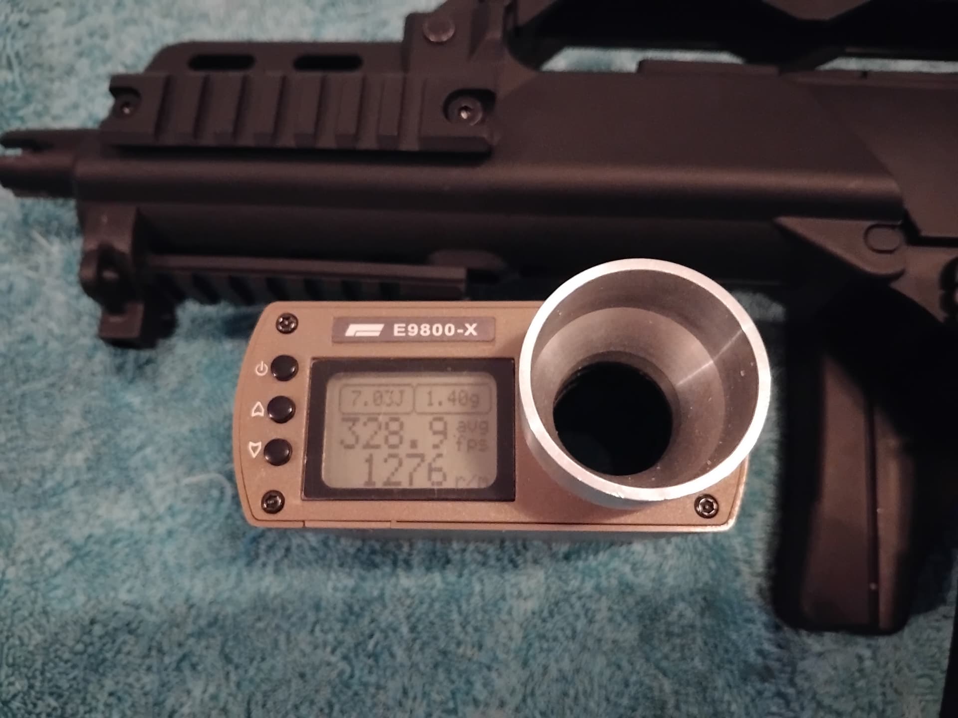

The good news is, its back to being a absolute pearler…
How’s that for consistency…!!!
ROF Exactly the same… ( out of a 7.4v battery)
And FPS within a single digit of each other… ( ihobby blues)
