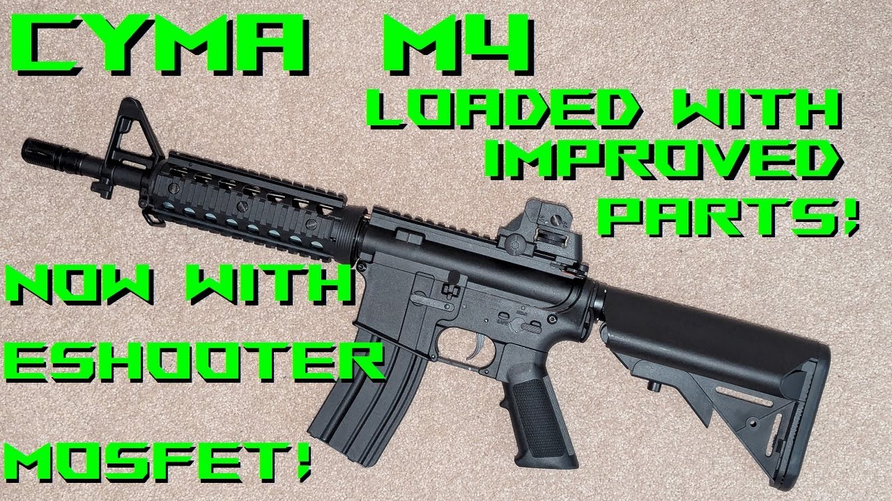

Here is my video on it, good blaster with plenty of potential. I WILL be finding out how much at some point :slight_smile:
