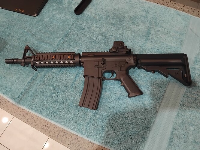

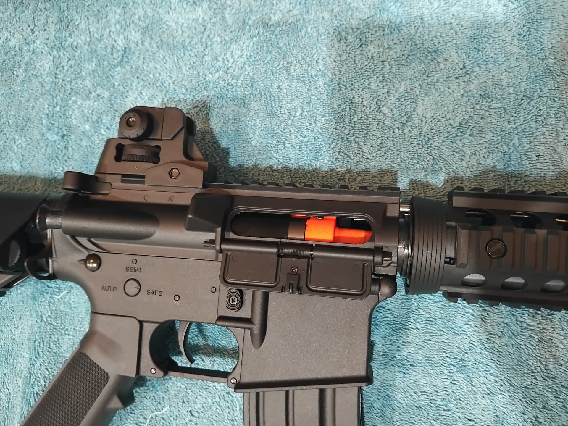

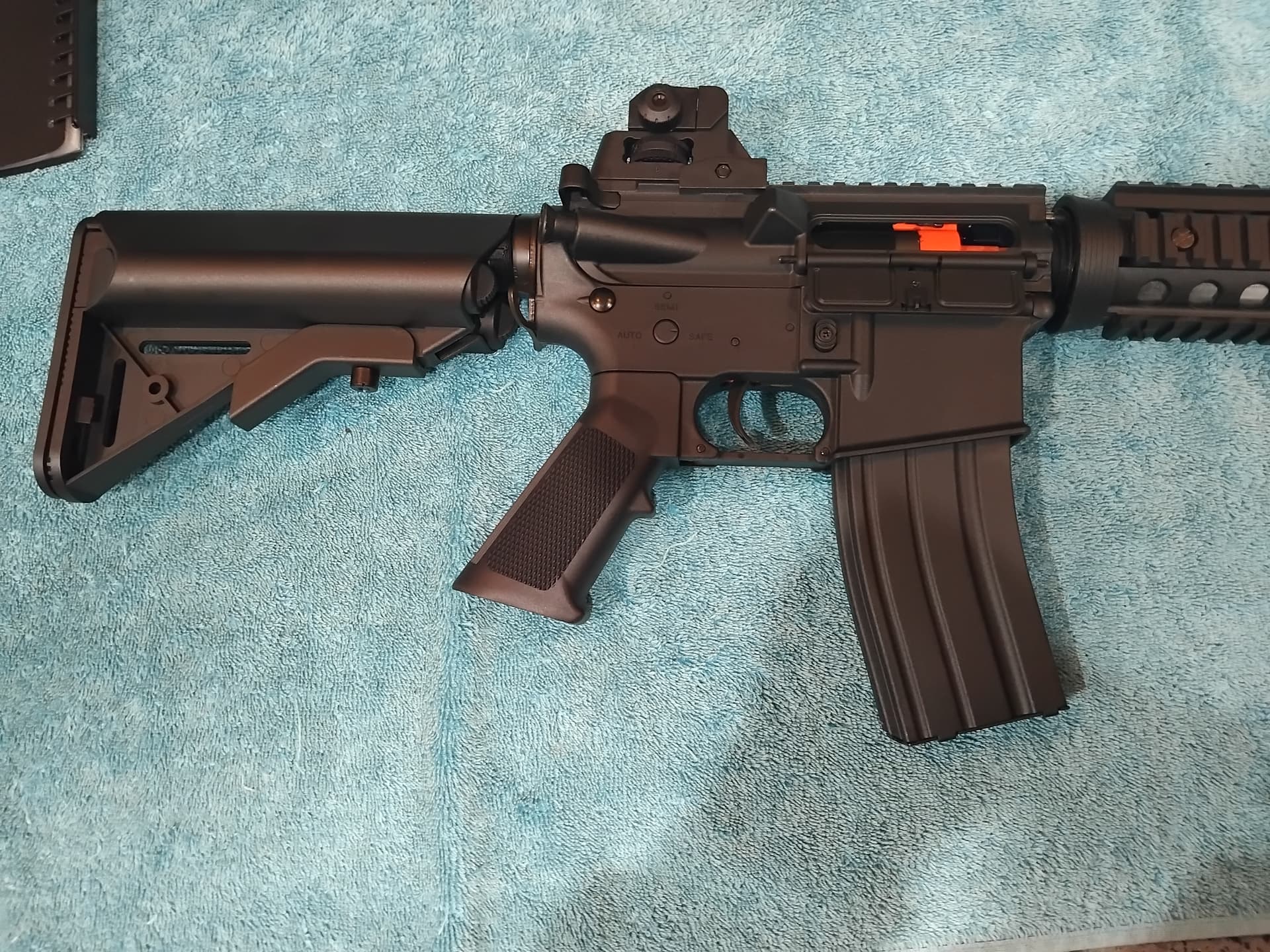

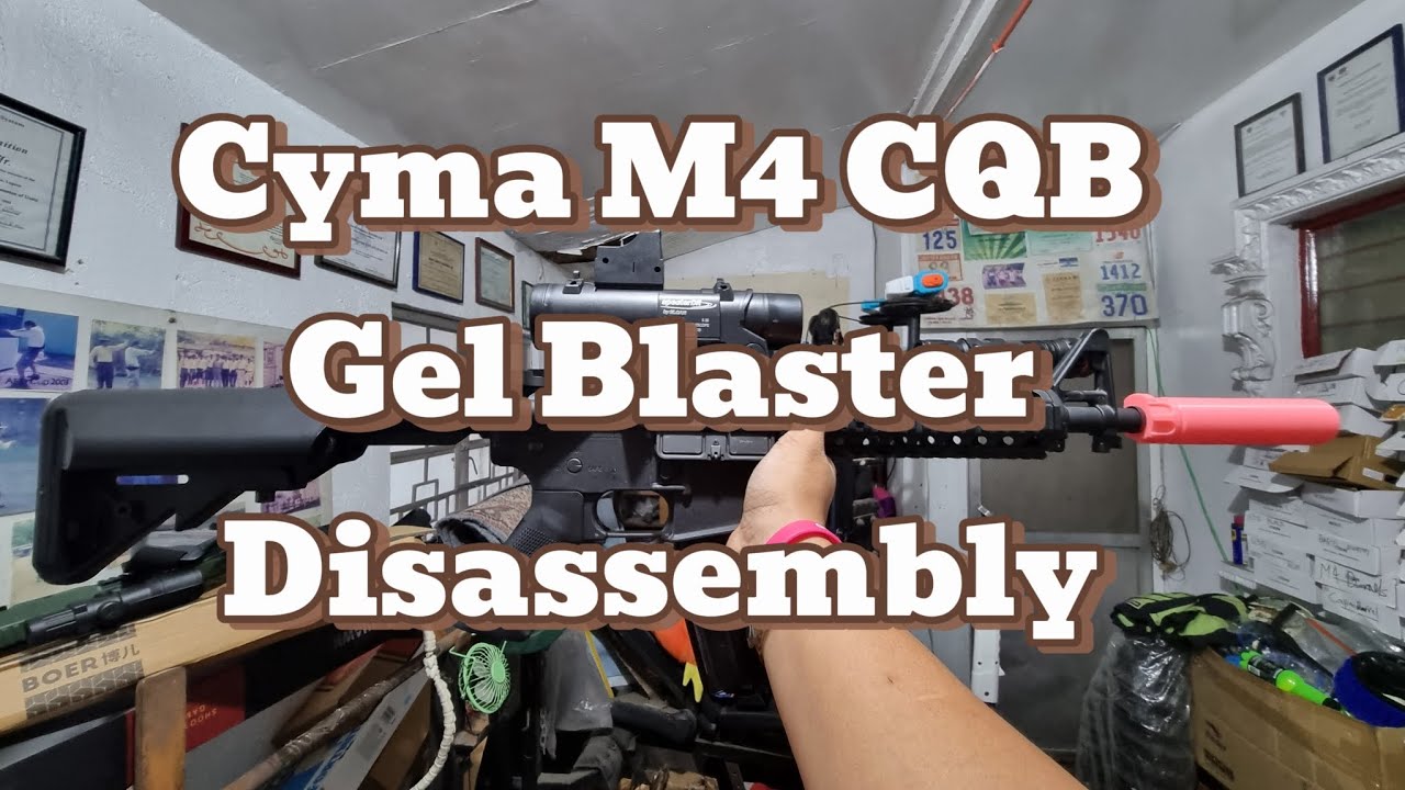

Anyway its a pretty standard Cyma M4…fps a little low OOTB.
Here is a standard pull down video, i’ll leave here for reference…
So, overview and a few piccies…

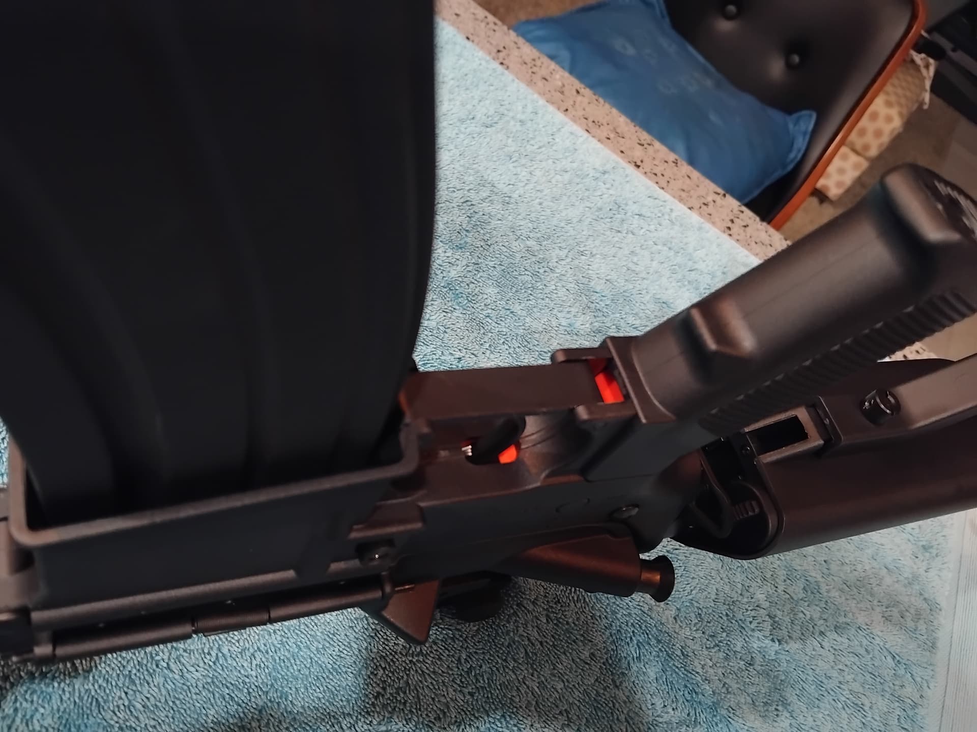

Its nice and light, shiny new black ( what shade??) and a standard cyma mag.
It has a mag prime on mag insertion, and this is programmable.
Being a CYMA, it has the obligatory orange gearbox.
It has a few bits poking out, which ruins it a little.
Easy fix though, a quick flash of rattlecan, when its pulled apart.

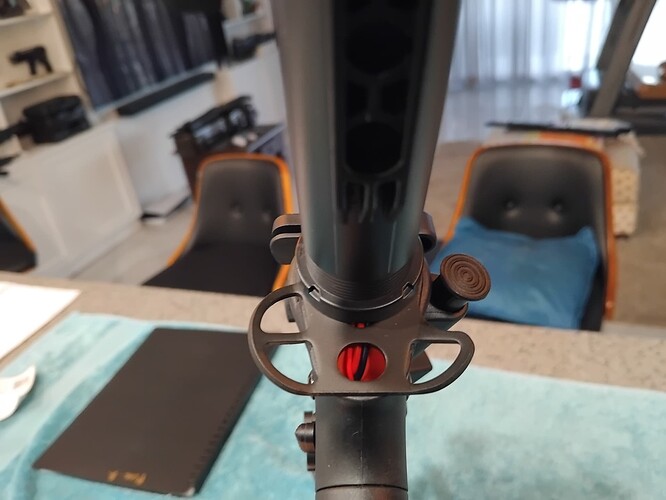

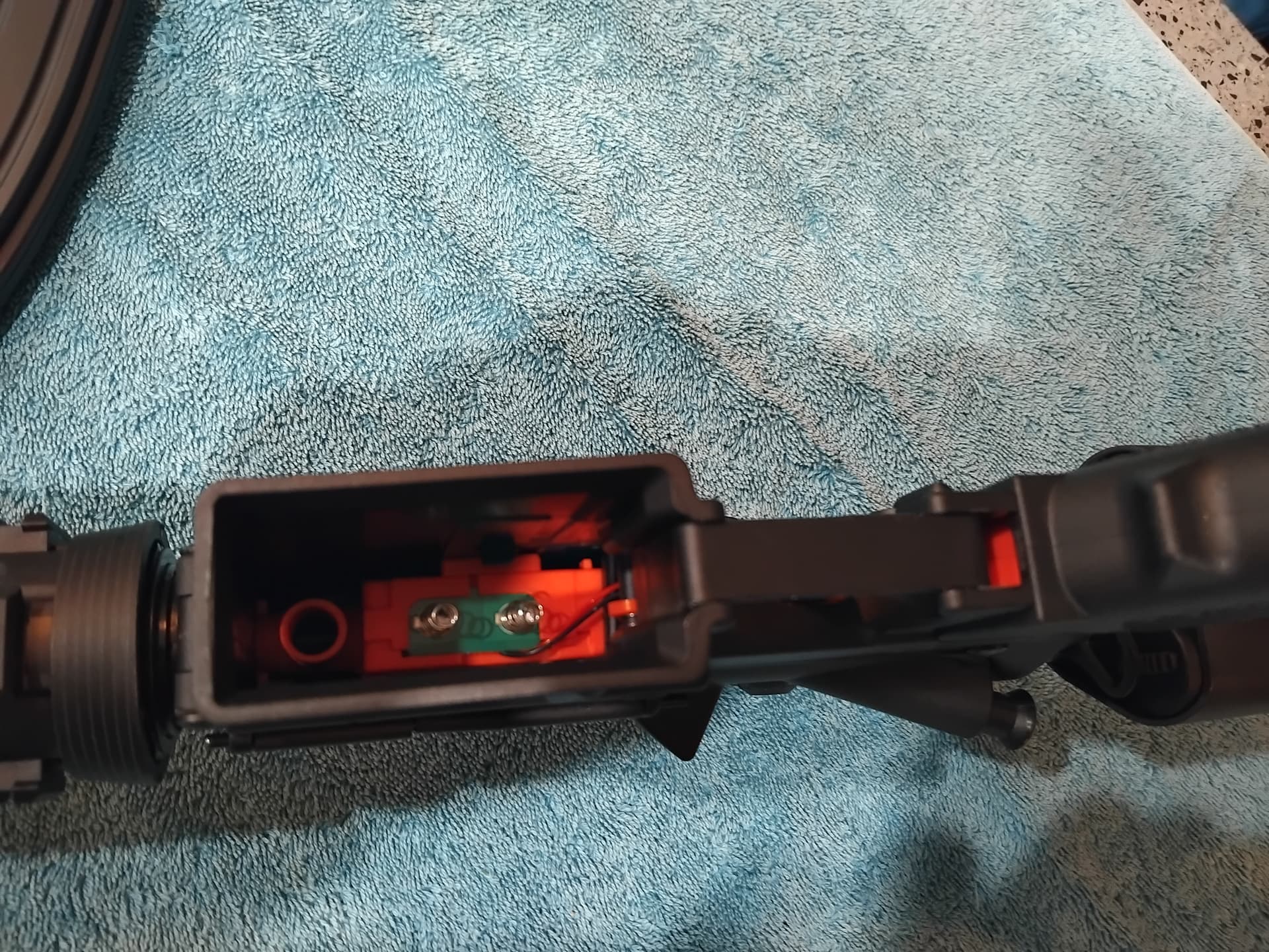

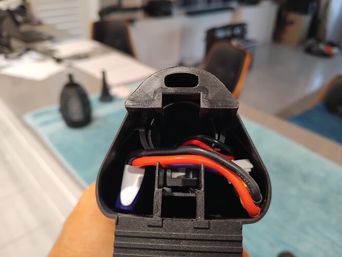

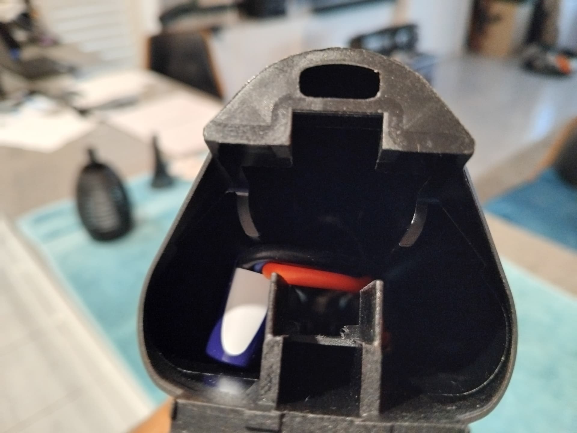

Ok…view from the rear…into the batt compartment.

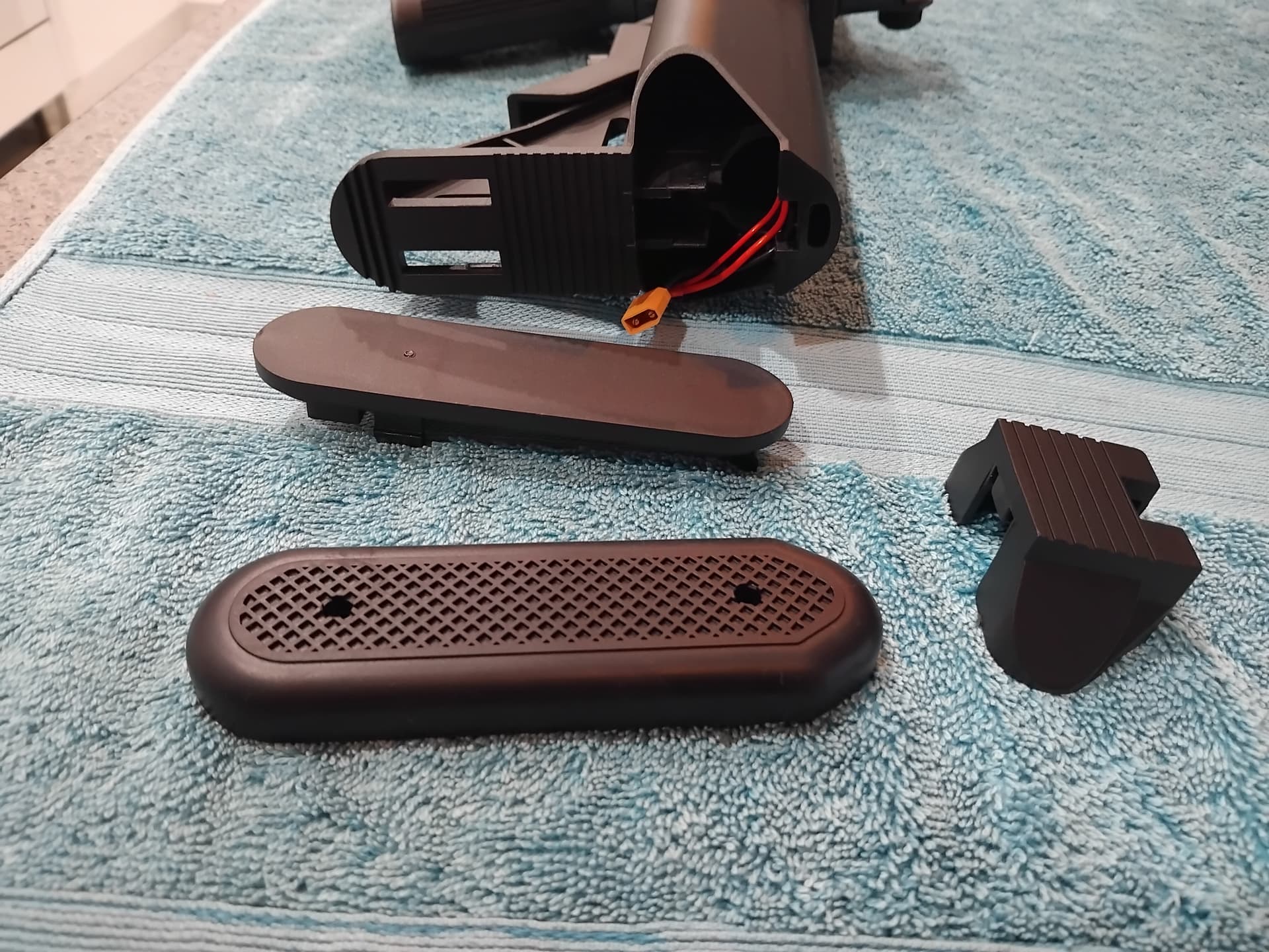

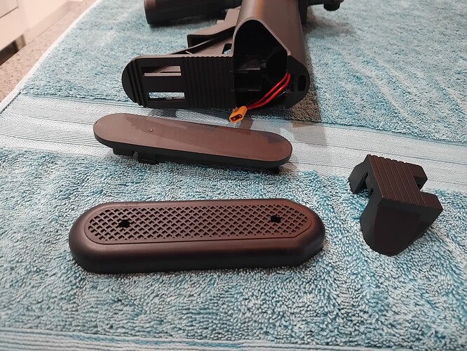

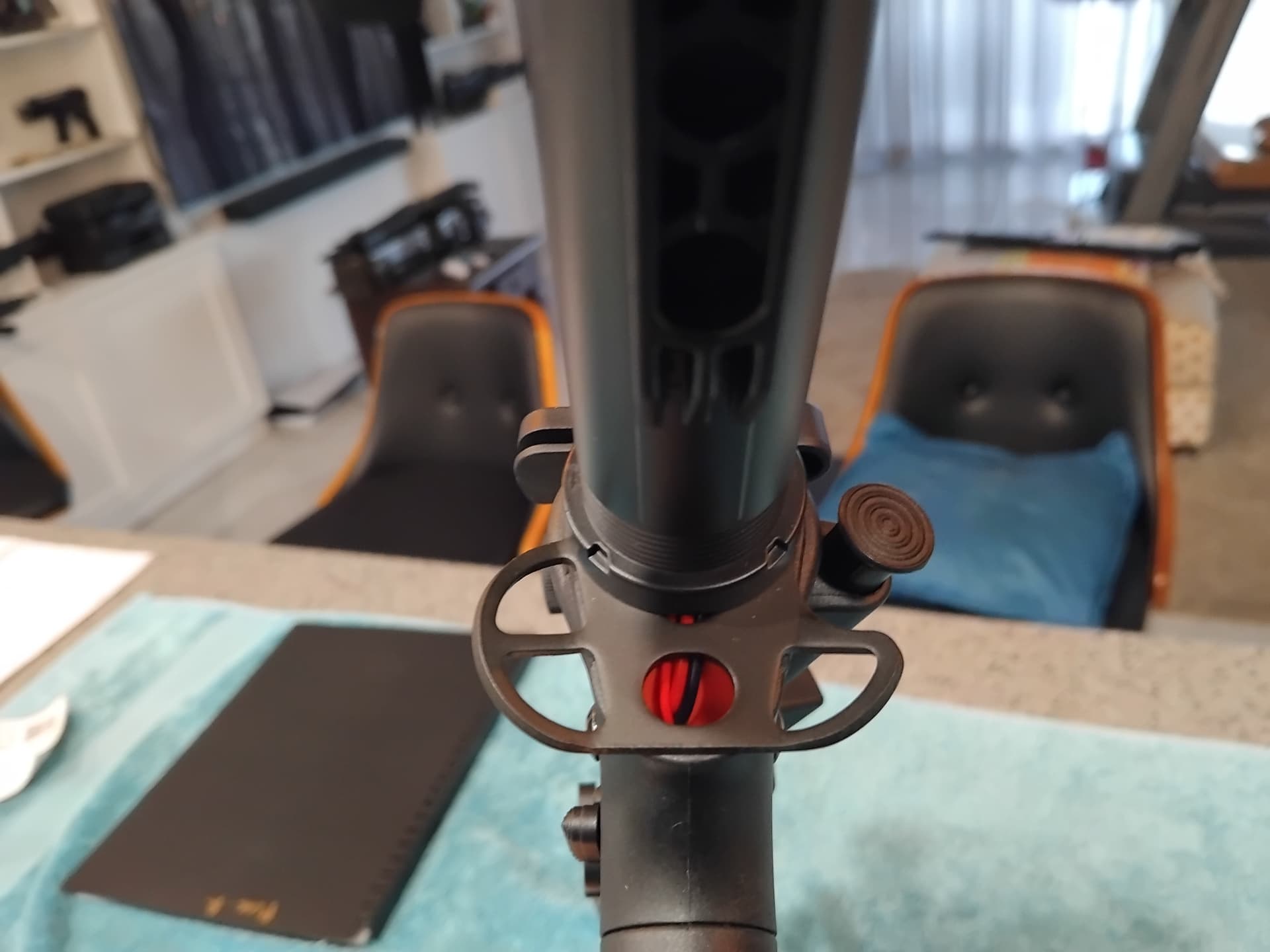

Being a extendy stock, there is a bit of a trick to get full range of motion, with no cable binding. Here’s the technique…
Start with the stock completely collapsed(below).
Insert the battery on the LEFT.
The connector cables meet, and sit on the RIGHT…as does the charging cable.

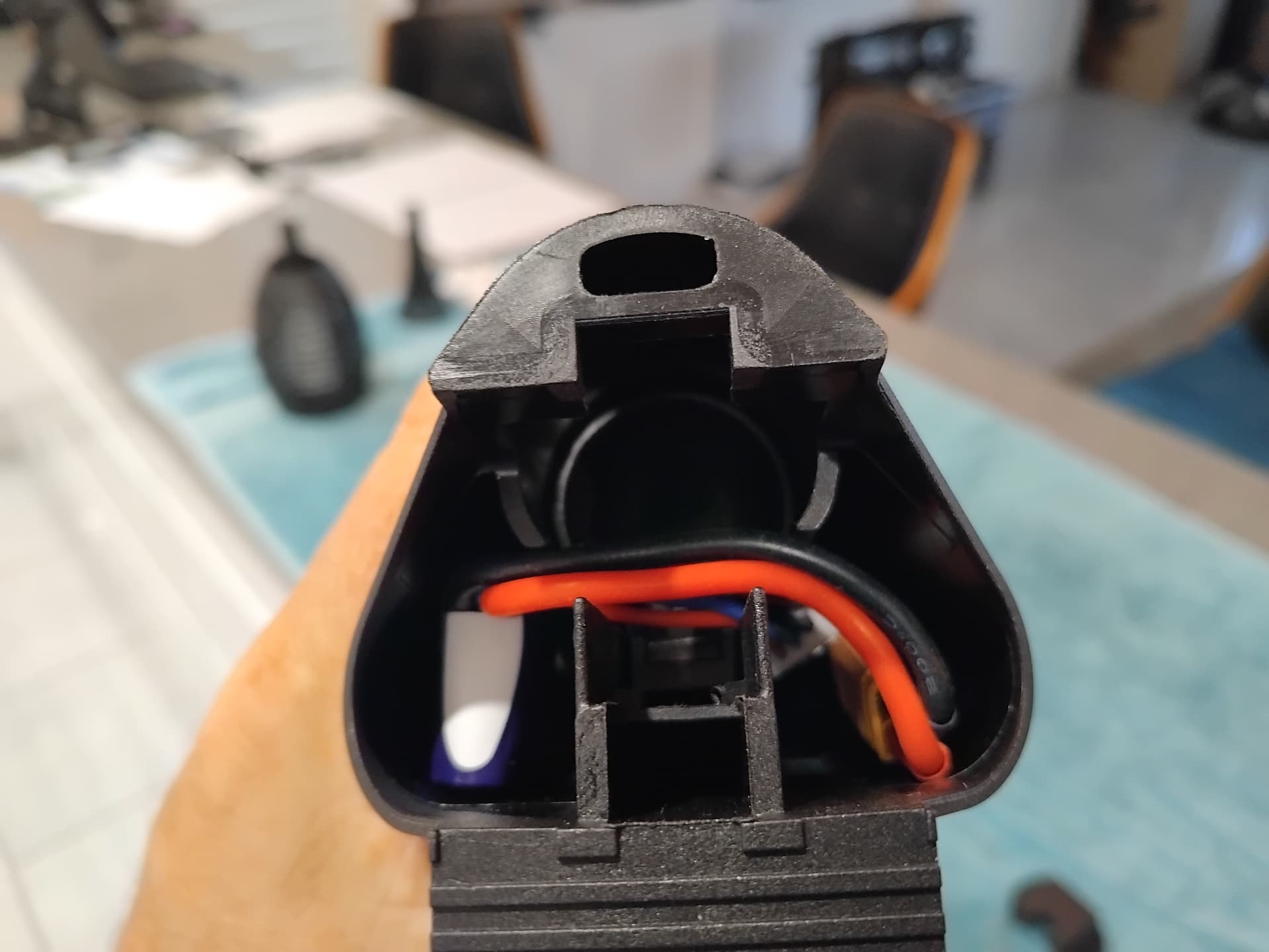

Pull the stock back one stop (below).
Ensure ALL the cables are running down the RHS cut out groove, and staying in the RHS gap. If a cable binds , it will pull, stopping full range of movement in and out.
As you can see, all cables are clear, running down groove, and connectors remaining in place. Lets go fully extended (below)…
Yep…all good. connectors staying behind, and all cables running down cut out groove. Put the cover back on. As you retract the stock, the cover prevents the cables from rising out of the cut out groove, and binding again.
Check for full length travel, up and down several times ( giggity!!).

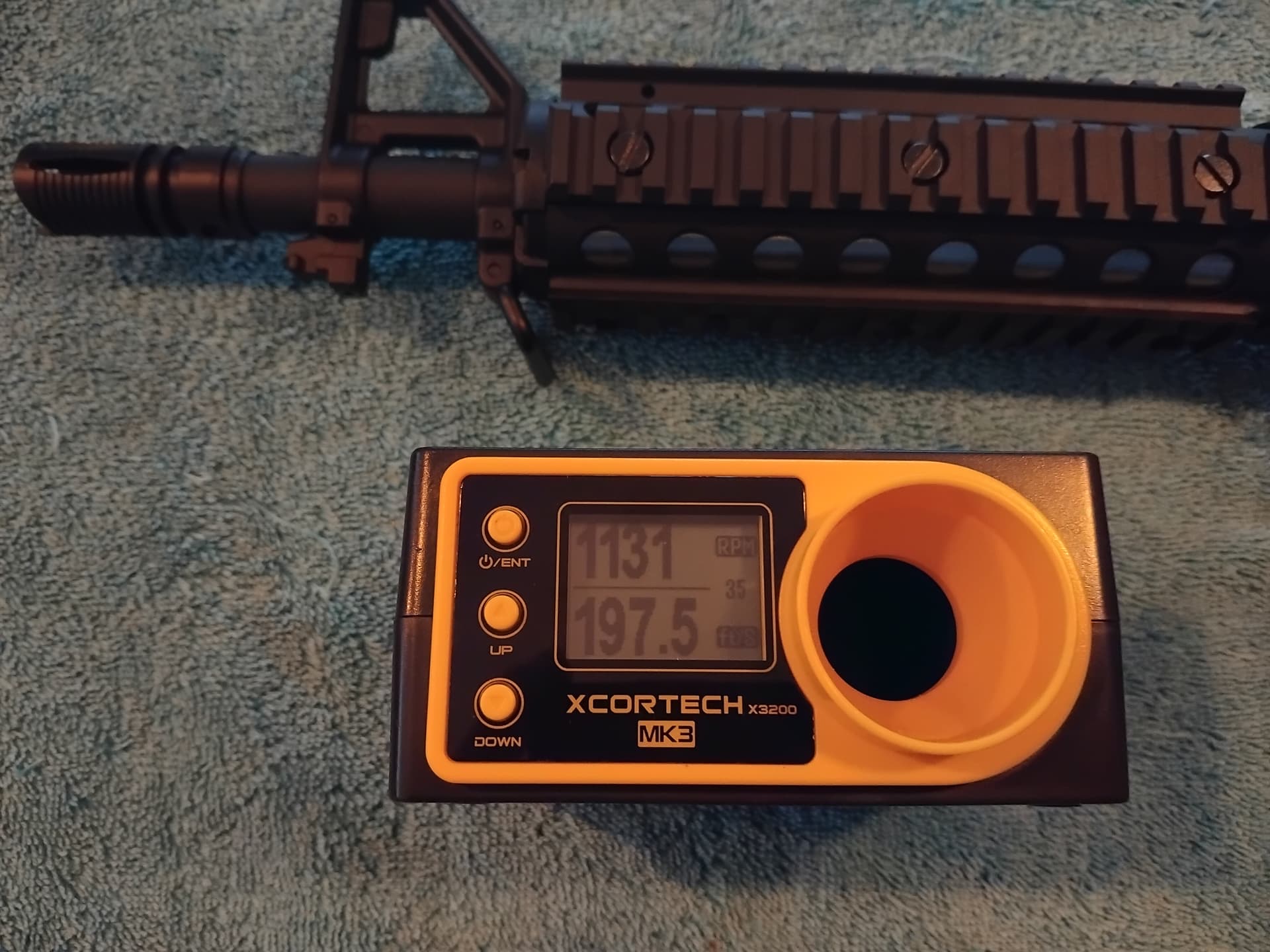

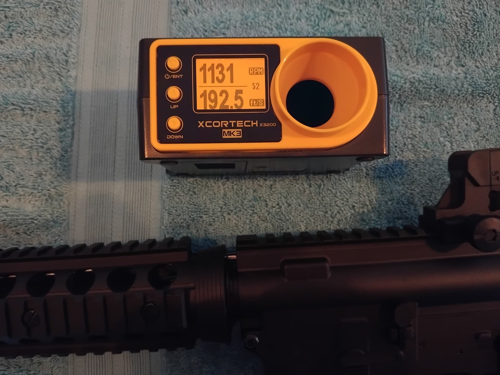

so, performance…

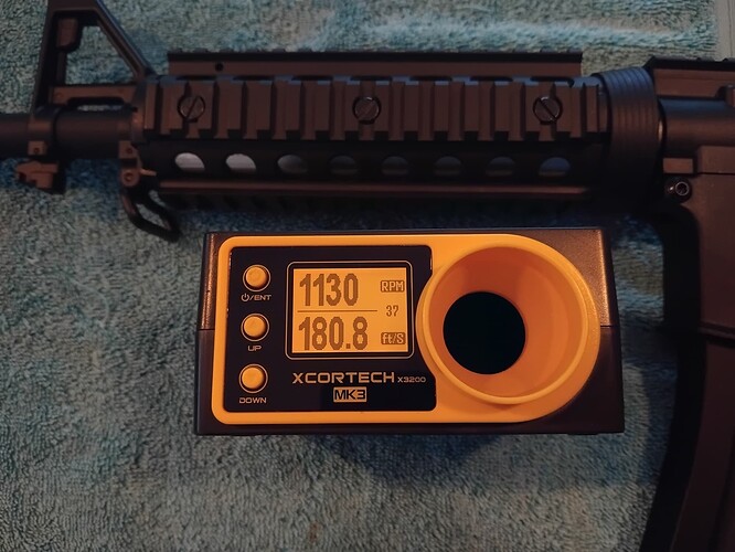

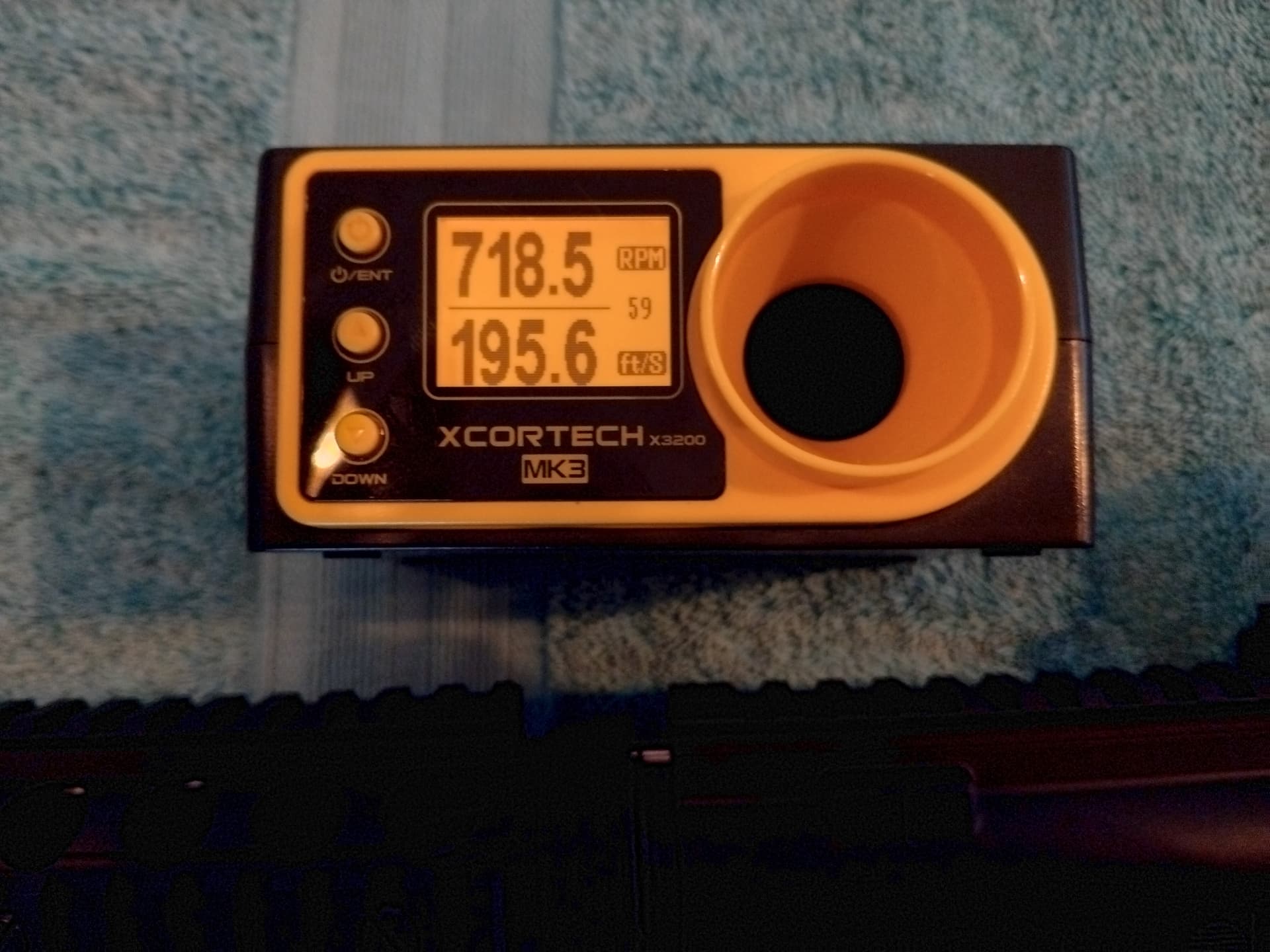

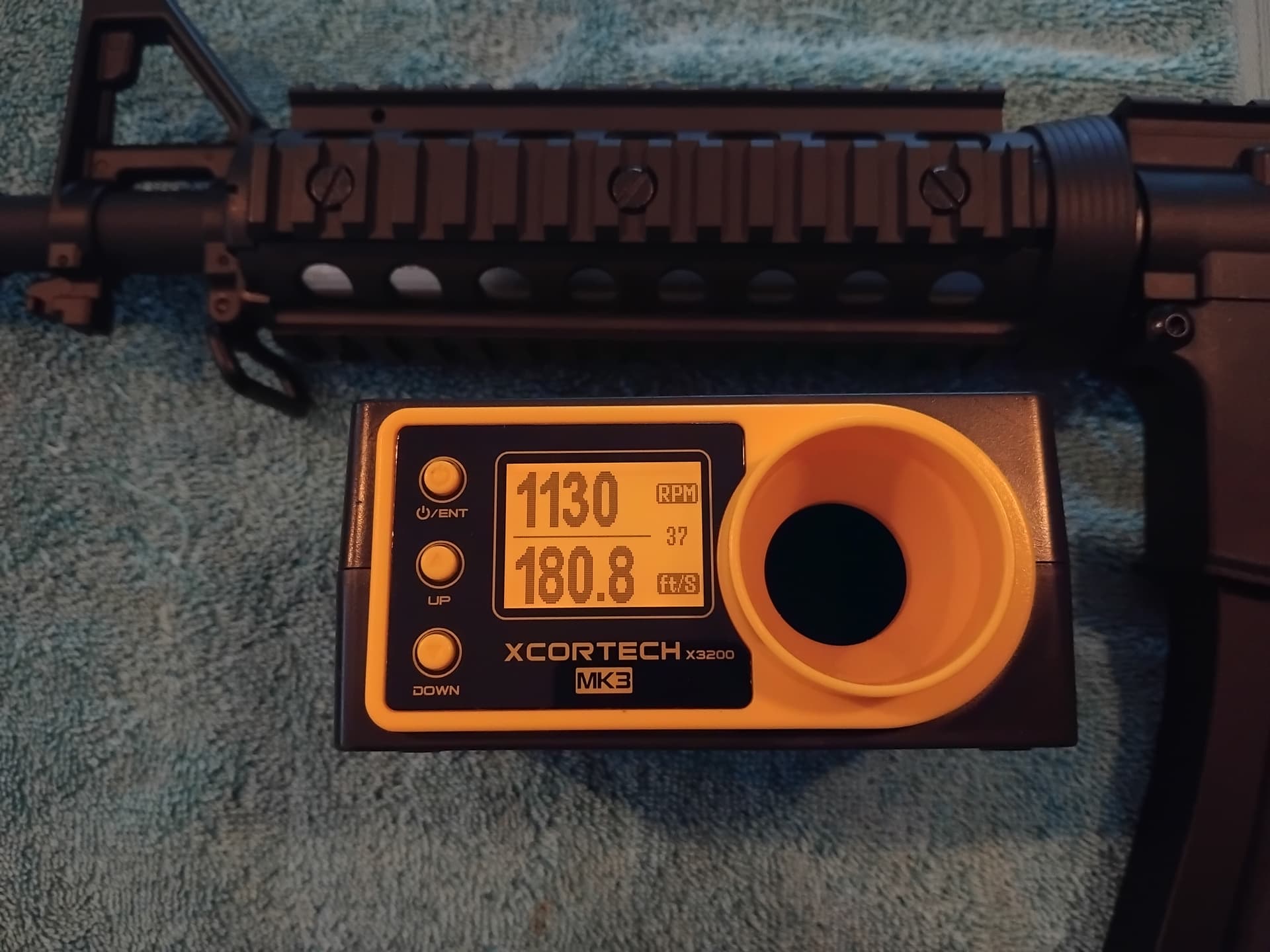

As per china nowadays, its a bit aenemic OOTB.
Using my I-hobby blues, and xforce pinkiesi got a range of 190-210. 220 max.
Not stellar numbers, but not unexpected out of china nowadays.
Should be a good candidate, for improvement.
I’m thinking full teardown, epoxy t-piece, green oring, M100 spring and see how we go.
Its got a normal M4 sized barrel, stopping 1cm short inside the flash hider.
I dont wanna extend it for a hop up, and i dont think an extra 1-2 cm of barrel length will make much difference…so i’ll stick with the original barrel.
Hopefully, should be circa 300 fps after stage one upgrade…
Soon TM …

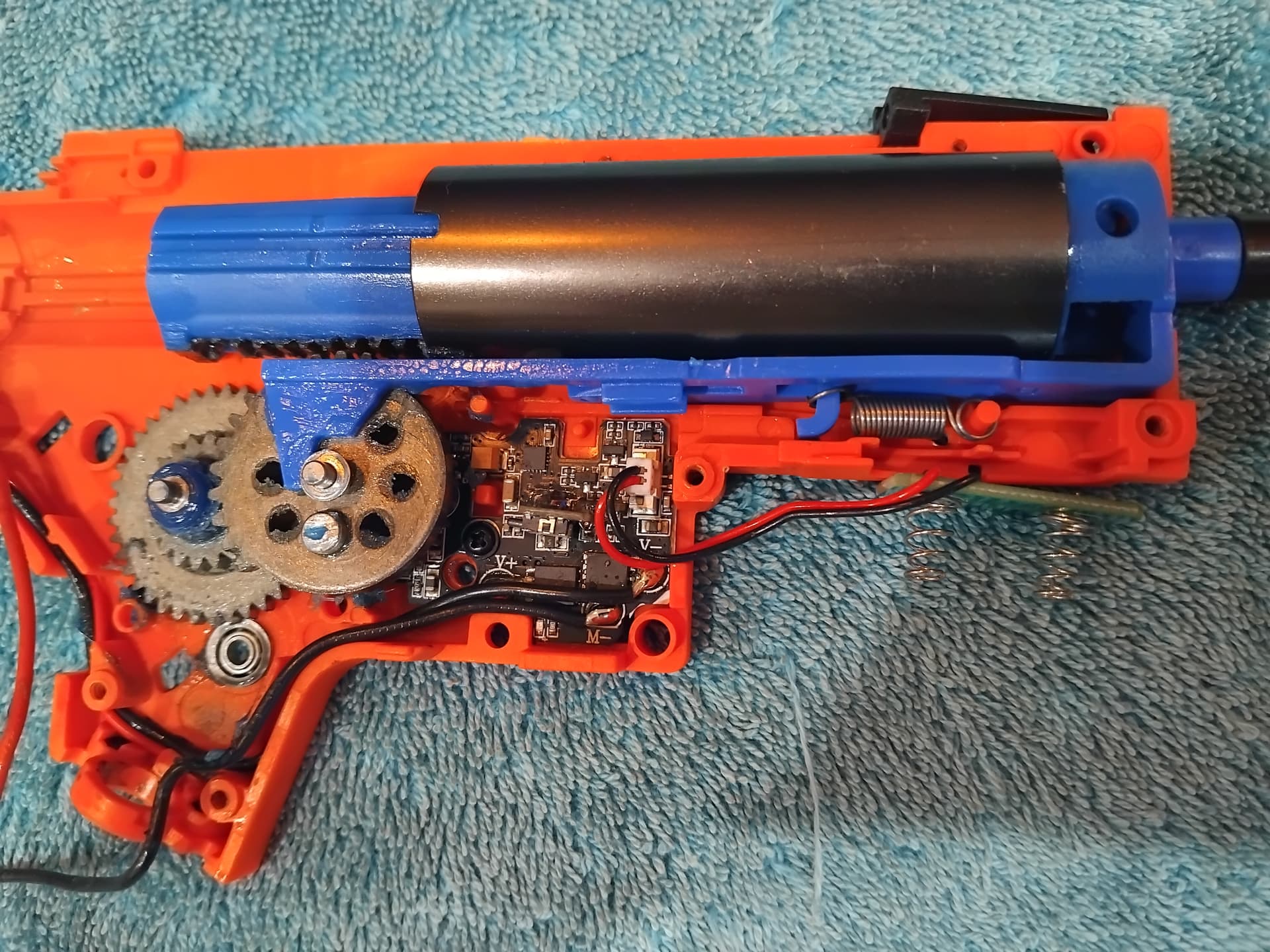

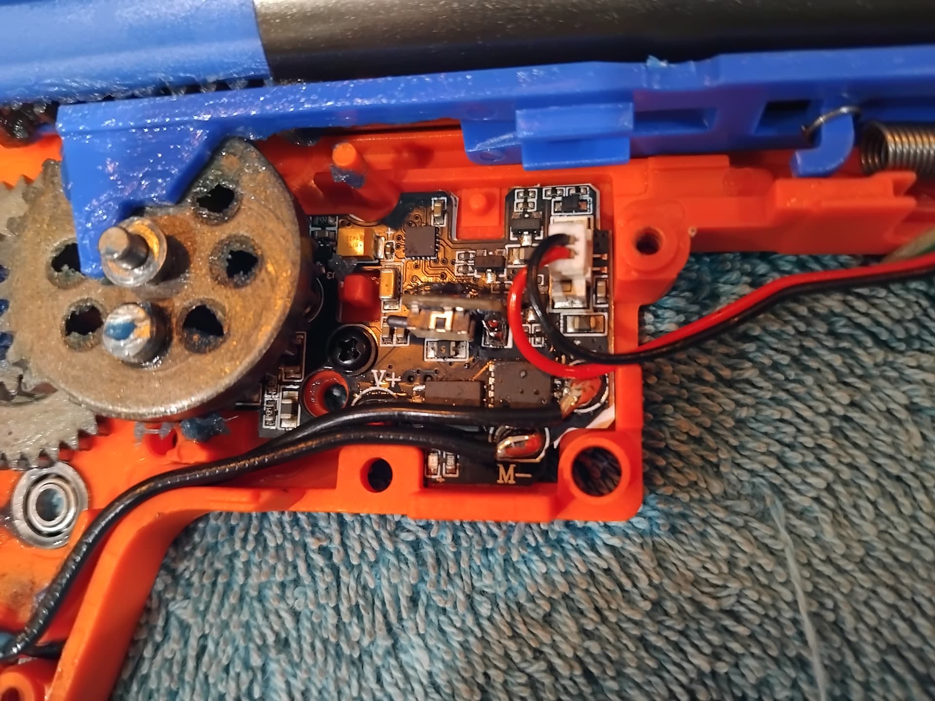

Quick word about the mosfet ( Mooossfeeettt!!)
  • It has auto mag prime on mag insertion.
  • program via safety position, and hold trigger for 3 seconds…light and beeps.
  • SEMI: single fire or binary. Go nuts on binary, and get around 500-600 r/min. I don’t like going fast on binary, gearbox makes some unsettling noises…
  • Auto: Full auto or 3 rnd burst. 3 rnd burst is fine.
It may have other features, but i haven’t sat down and seriously played around with it yet.
Any more features , i’ll let you know.
So far, its a pretty decent budget Mooossfeeettt!!!
Edit: bit more of a look.
It appears the main choices are Semi: single or binary… Auto: Auto or 3rnd burst.
The LDT mosfet ( Mooossfetttt) is programmable to 2/3/4/5 rnd burst, but this is a bit more basic.
The other parameters which are alterable, are how long the mag prime runs for.
Standard setup, When you first insert a battery, the mosfet ( Moooossfettt) beeps, and magprime runs for 1 second.
Also mag prime runs 1 sec when you change mags.
Both of these times are programmable.

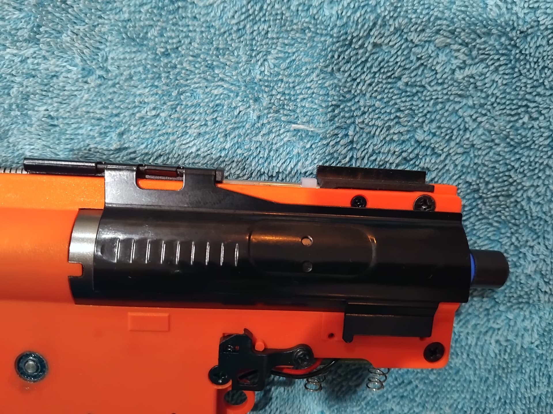

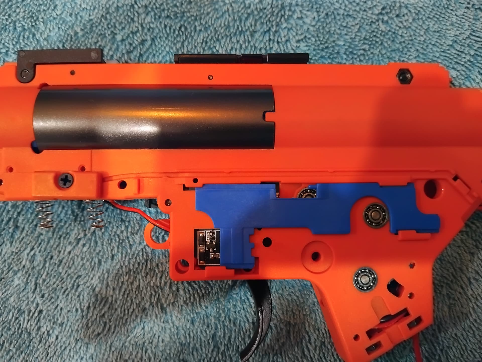

okay… got it pulled apart.
Getting it back together is a bit of a mongrel…as well as managing trigger / gears etc, have to deal with the top blowback plate.
Spring sprung, out the back on opening.
i know how it goes together…but managing all the parts, all at once, is a bit of a mongrel…
ive retired for the night…2morrow is a new day.
What is that i see…??
Is it a …
Mosssfettttt…!!!
Mossfetttt… you dont have to be put together tonight…!!!
Gears are shimmed, and a reasonable amount of grease, for a Mossfettttt!
Tpiece doesn’t need doing…its already airtight, via blow test…
Also…i’ll hack off the blowback tab…all metal…
