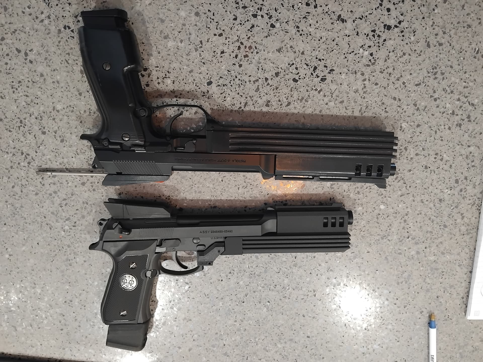

It took a LONG time, even with the dremel…
The hard part was accuracy.
When you get too the honeycomb section… your drilling empty space, and some material.
Sounds easy, but lack of material, lack of constant pressure, lack of control, while its super thin…
Not fun.
Maybe swap over to a hand file when you get to the finer part of ratting out the new grip. :man_shrugging:
More control over how much you’re removing.
I did that as well… still less control, and slow going…
Perfection takes time. Patience young padawan :grin:

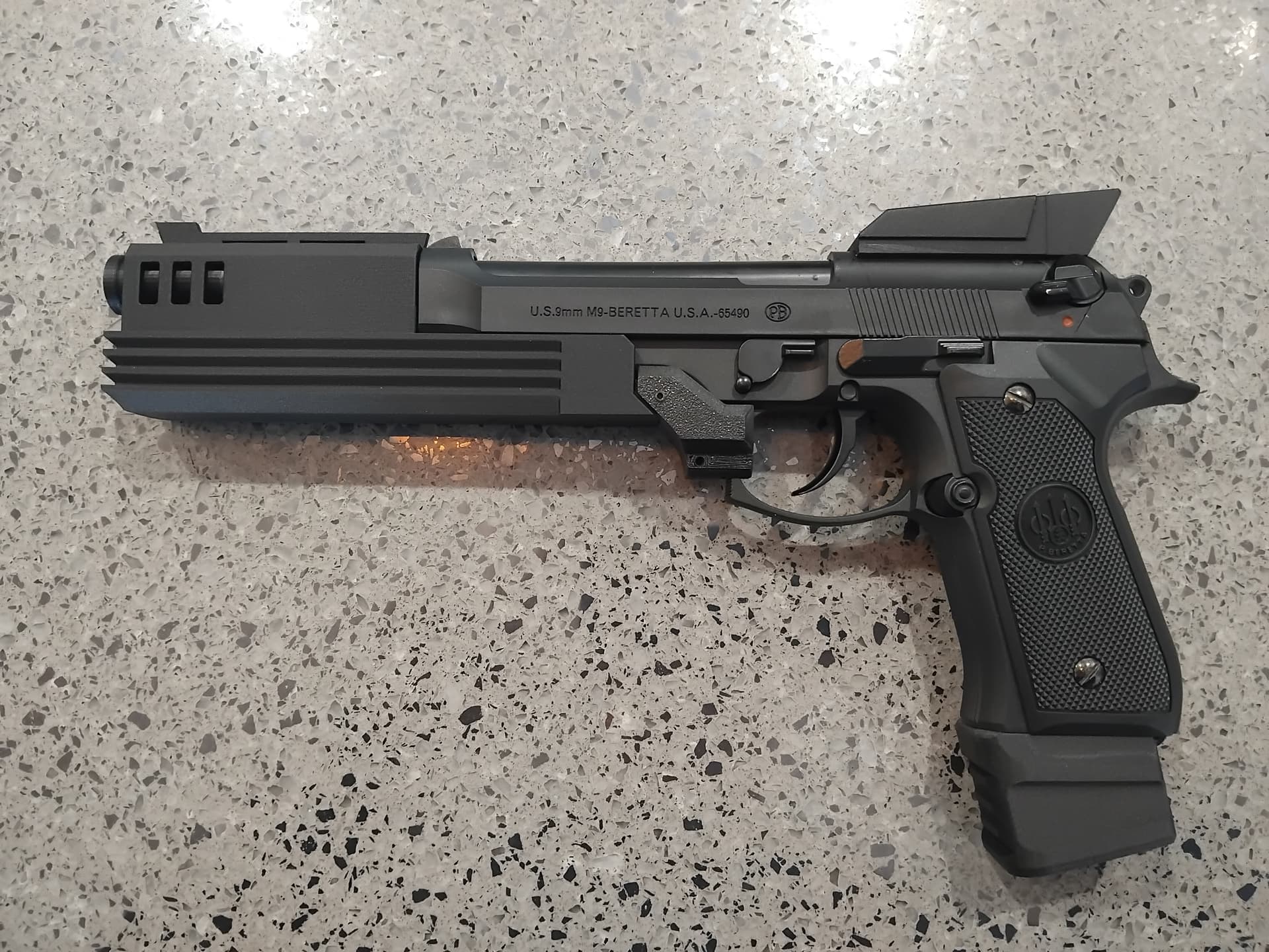

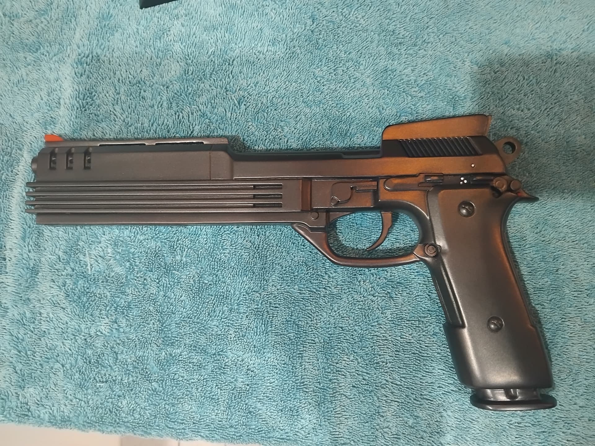

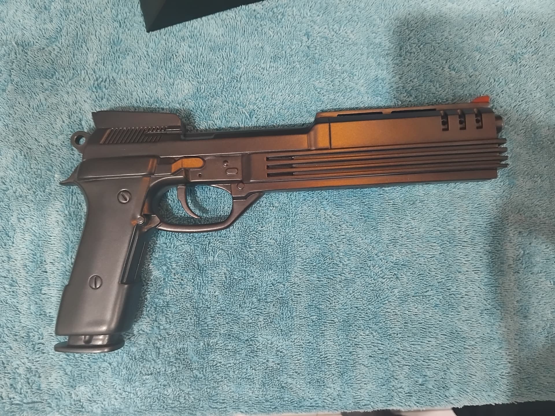

Okay… M92 EBB Robo is now finalised…
I have had the kit for awhile, but it needed a few mods to finish it…
The base blaster was one of Rok’s EBB m92’s.
You know… the one Syd ABF confiscated, and said was airsoft?!
I have left the spring as standard for reliability and longevity.
The triangular rear sight needed some attention.
removed the original iron sight, and this was held in place by a single small screw, into 3d print material.
it was never going to hold longterm, under cycling loads.
So, a copious amount of 5 mins araldite to hold it. It also supports it, as it was resting on one point of contact. Its now supported over a larger area, with more surface area covered with resin.
I did have some extrude… so had to wipe it away, clean residue with chemicals / repaint to cover bleaching. Got there in the end.
The front protruding barrel tip needed glueing in.
A bit hard, a small piece with limited access.
I put the tip in, had it protruding. As it went backwards, it got some epoxy as it passed the very last vent window. There was enough to grab and seal onto the muzzle, and it was all pushed inside.
Not much, but hopefully enough to hold it.
It is static and not cycling, so hopefully it’ll last.
If it does fall out, i’l build up with tape, and go for a friction fit next time.

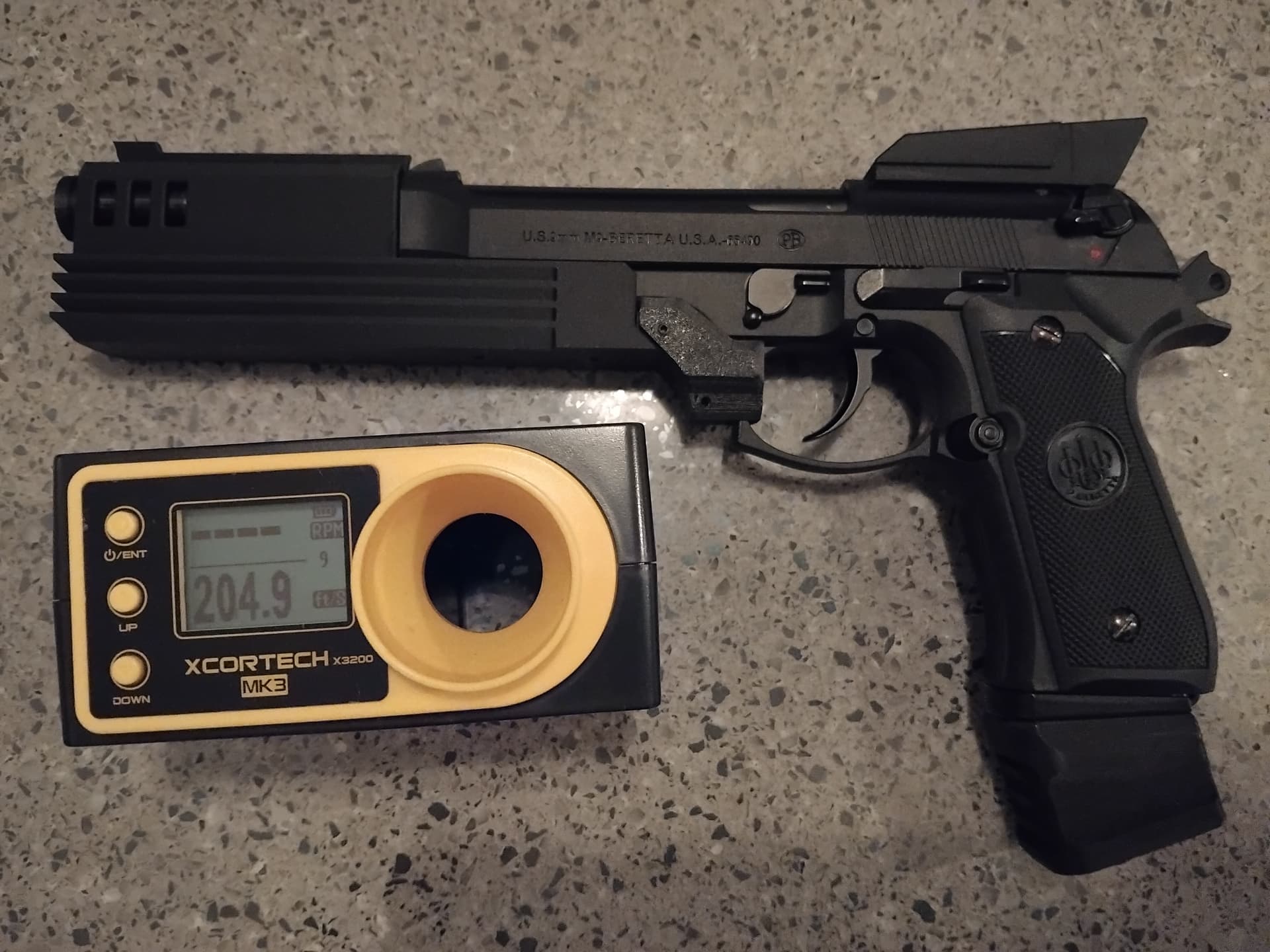

it cycles fine, does 190-200 fps consistently, and the gels clear the barrel no probs. So, happy with the performance.
Its about 80% scale of the “real thing”, but still recognizable for what it is…
All in all, a good cheap kit, to dress up a affordable EBB M92 , with decent performance…

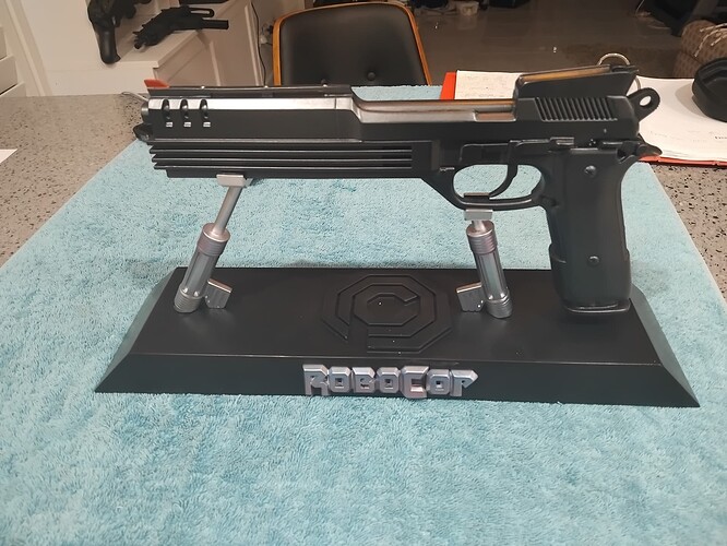

Robocop Auto 9 Resin prop has landed… in syd…!!
Lets see how syd ABF treat this… B709 in place…one piece resin…non firing…
hmmm…
Good luck! Surely they’ll let a blob of resin in :thinking: :rofl:
Hooray…!!!
11:59 pm last night…“departed from facility”…so its on the move…!!
STAY OUT OF TROUBLE…!!!
phew…!
RE requiem revolver, on its way as well…!
DROP IT…!!!
Ok, if you insist…
Made it through…!!

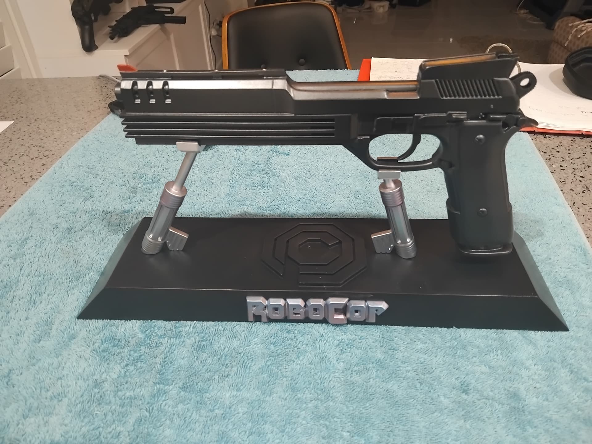

Didn’t like that the delivery guy dropped it 1m over my fence…but it survived.
Very Nice unit…hefty and solid.
Very good gun metal grey paint finish.
Stand is very hefty and secure, too…
I’ll paint the res tip out, with some tamiya gun metal 2morrow.

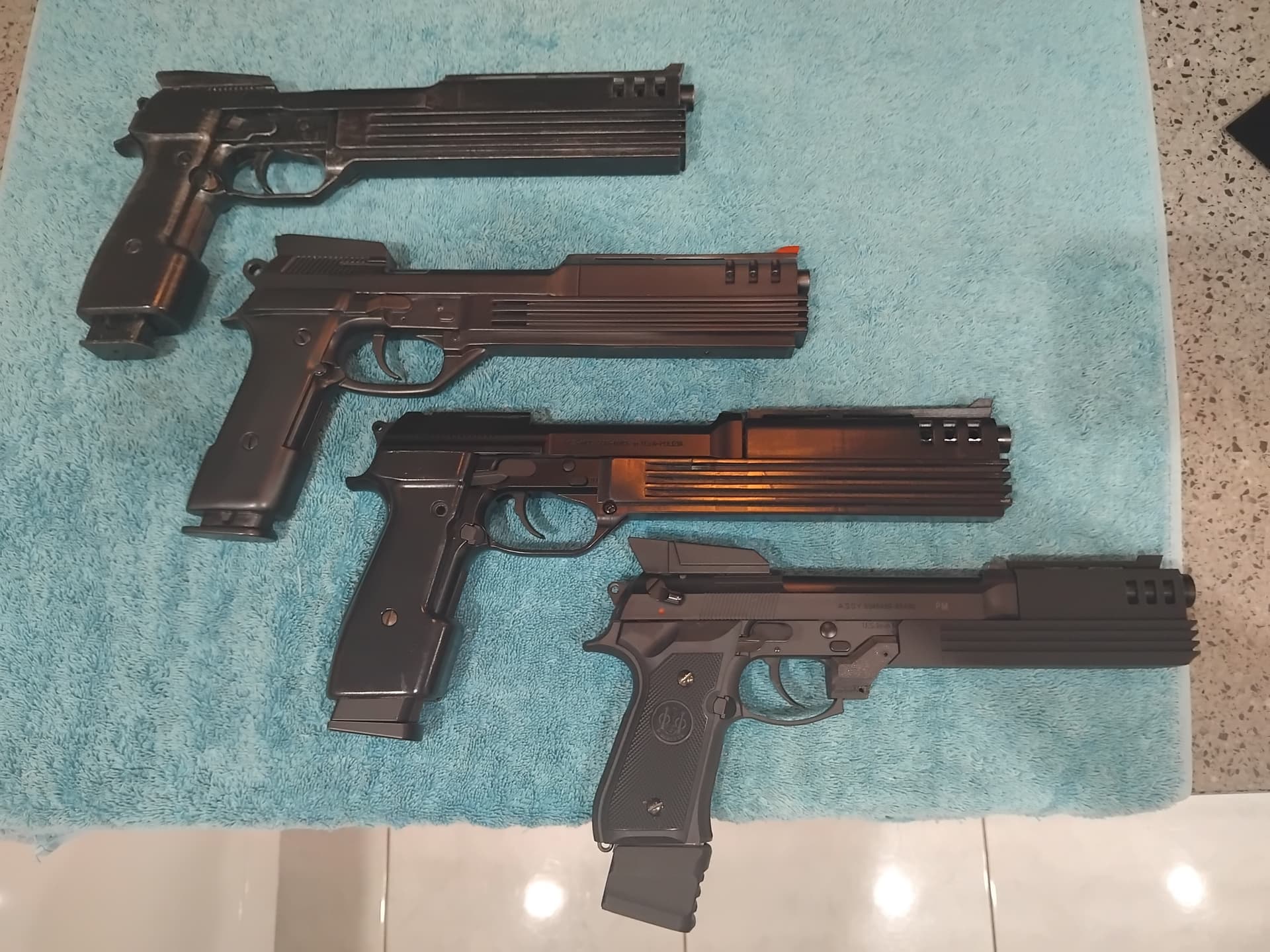

Also…how did this happen.??
Same as the pulse rifles…one model at a time…each different…
HCG resin prop… 3D printed weathered kit…3d printed KELE M93r…Rok’s EBB M92 kit…
Each is different, in its own way…
