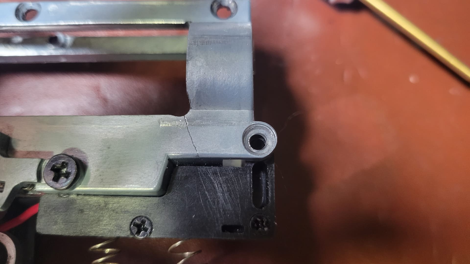

Discovered a crack in my stock APS Noveske blaster last night, from what I understand it has a Silveredge gearbox which is prone to cracking
Having not replaced a shell or gearbox before, wondered if anyone had a recommendation for a replacement?

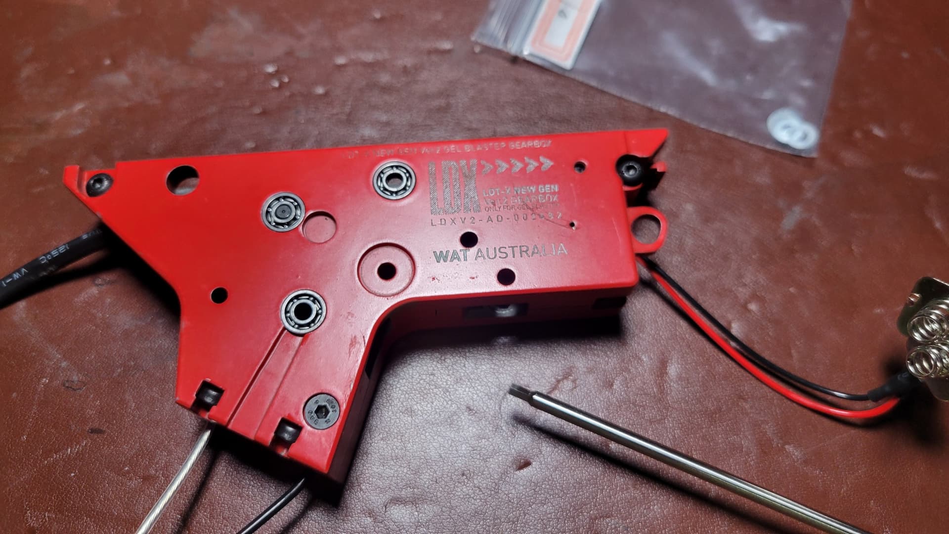

Very generous of you mate, I’m halfway through shimming the new LDT LDX gearbox so I think I’m sorted for now. Hopefully I don’t need to replace any more gearboxes in the near future!
Loving the three hex screws to undo during shimming Vs the x 8 Phillips heads

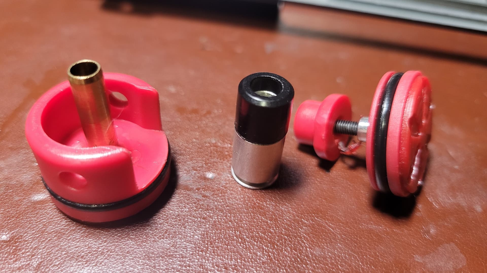

Air seal on the new box was surprisingly crap. Cobbled together a partially used LDT double oring cylidner head, a nozzle that had a stock CYMA rubber tip glued onto it, kept the original piston but replaced it with one I had spare from akgelblaster AU.
Air seal tested well so see how that goes
LDT LDX cylinder head, nozzle and piston head.
Everything is trial and error mate, no matter what the brand or “double o-ring” or anything………. It’s always a mix and match of whatever parts actually achieve the results that you are chasing! :+1:

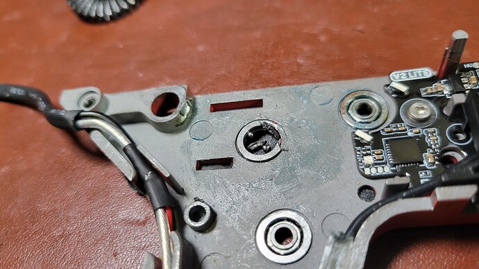

Managed to fire a magazines worth with some feeding issues then this happened :expressionless:
It’s running 13:1 gears and a T238 29k motor. I was confident with the shimming so not sure if this is a quality thing or I’ve screwed it up somehow.
Not sure where to go from here, try again with bushings?
