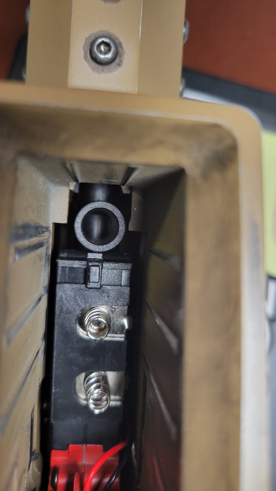

While waiting for the rescue parks to arrive I’ve been trying to diagnose the feeding problem.
Earlier, prior to the bearing detonation, when looking into the t piece after a jam I noticed the nozzle protruding into the “chamber” by 1-2mm which I think was preventing gels from feeding past it.
On the bench with the top half of the gearbox off, I can pull the tappet plate back another 1-2mm and the gels feed into the “chamber” nicely.
Is there a way to make the tappet plate go back further on each cycle?
Is it protruding into the t piece chamber with the tappet plate at full retraction? :person_shrugging: It’s not an easy thing to spot with a V2. Hard to wind back by hand with the spring out to see where the nozzle is when the sector releases.

At full retraction the nozzle pulls back another 1mm or so which is far enough to let the gels past.

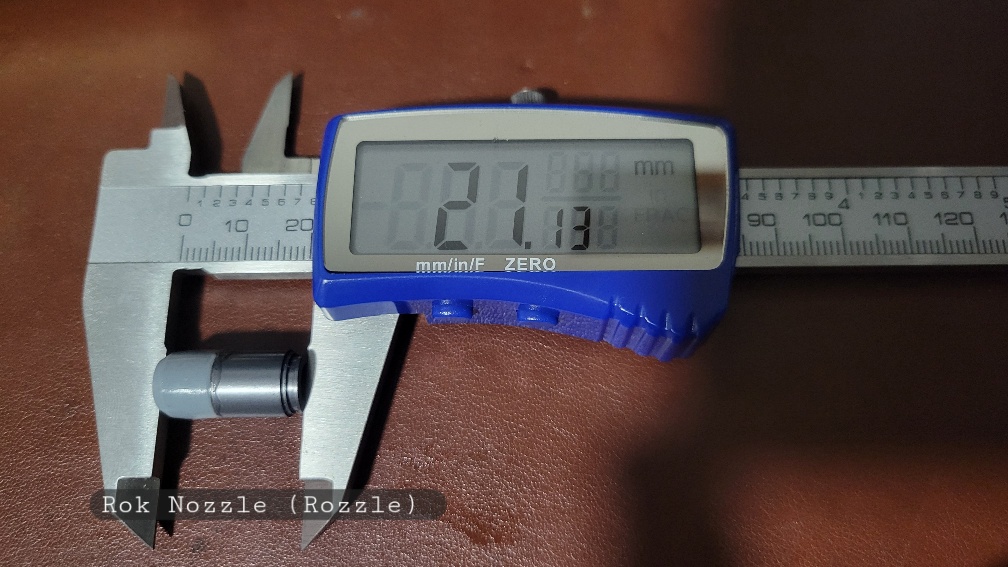

It’s not the nozzle that came with that gearbox but I did a measurement on the new nozzle and they were the same length. Might be a shape thing? Or I’ve measured wrong

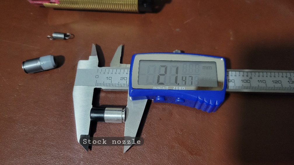

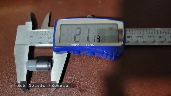

Took the nozzle out and compared it again to the nozzle that came with the box, turns out the stock nozzle is slightly longer that the one I’ve replaced it with
Nozzle that came with the box, 21.47mm
New nozzle 21.13

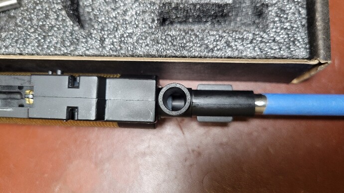

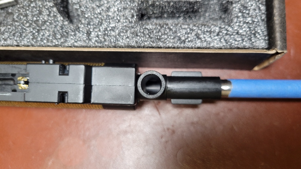

Think I did the test as described correctly, wound the gears and took note of where the nozzle finished up. That test showed that there should be plenty of clearance for a gel to get past. Dropped a few gels in there as a test with no issue
Looking down into the t piece after the sector gear had pushed the tappet plate back as far as it would go

I haven’t had issues with these nozzles apart from sometimes they aren’t fast enough for over 30rps builds as they are a bit tighter than the older black body version- they were awesome for this. The newer grey anodised version is a bit tighter seal which doesn’t attribute as well to high rps. Have contacted manufacturer on this, but I am one guy getting maybe 100 a year so yeah, nothing changed.
The length has never been an issue for me, check it slides freely in the t-piece too. Sometimes a bit of excess glue can slow it down significantly. Even prohibit getting a seal.

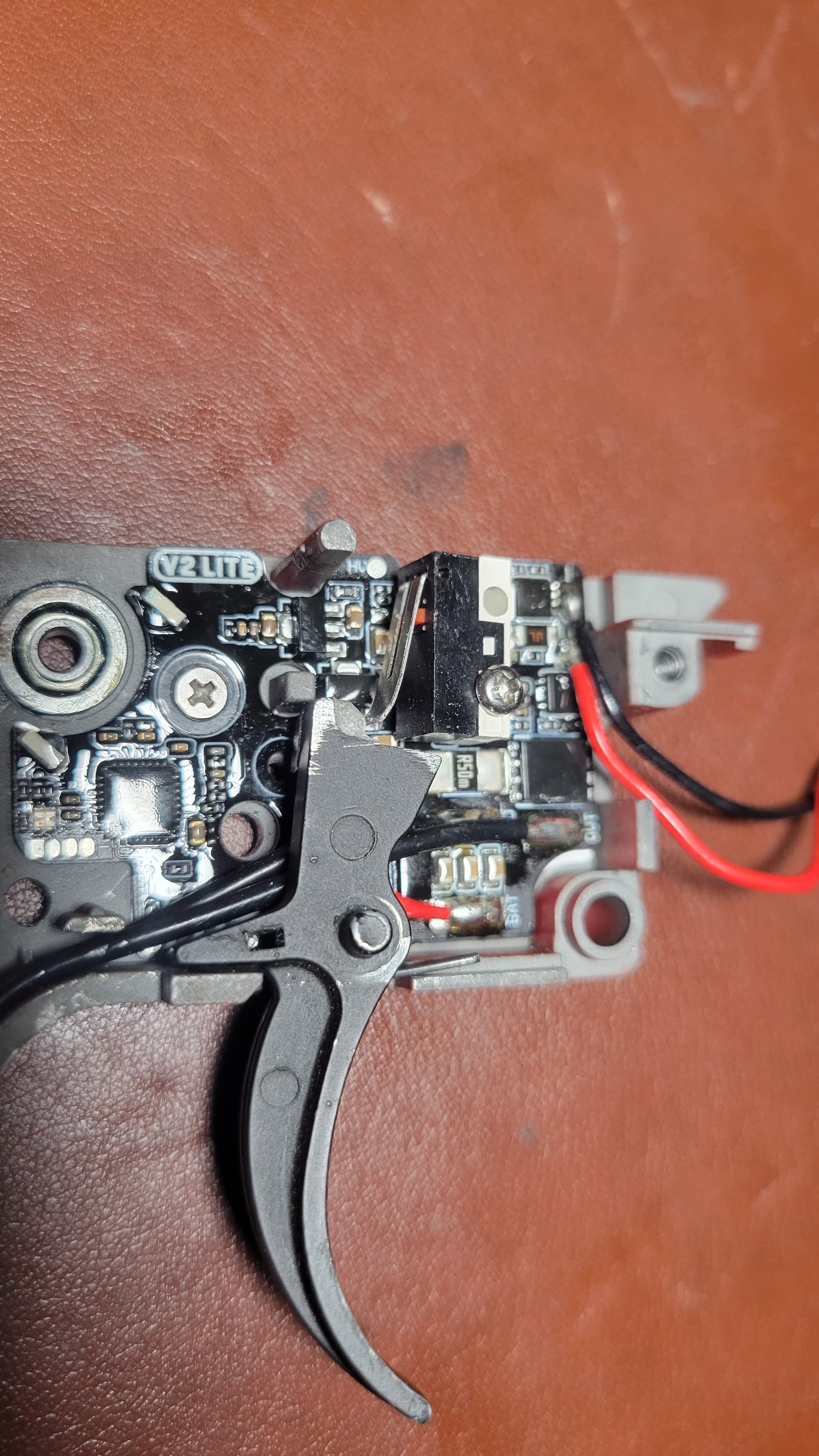

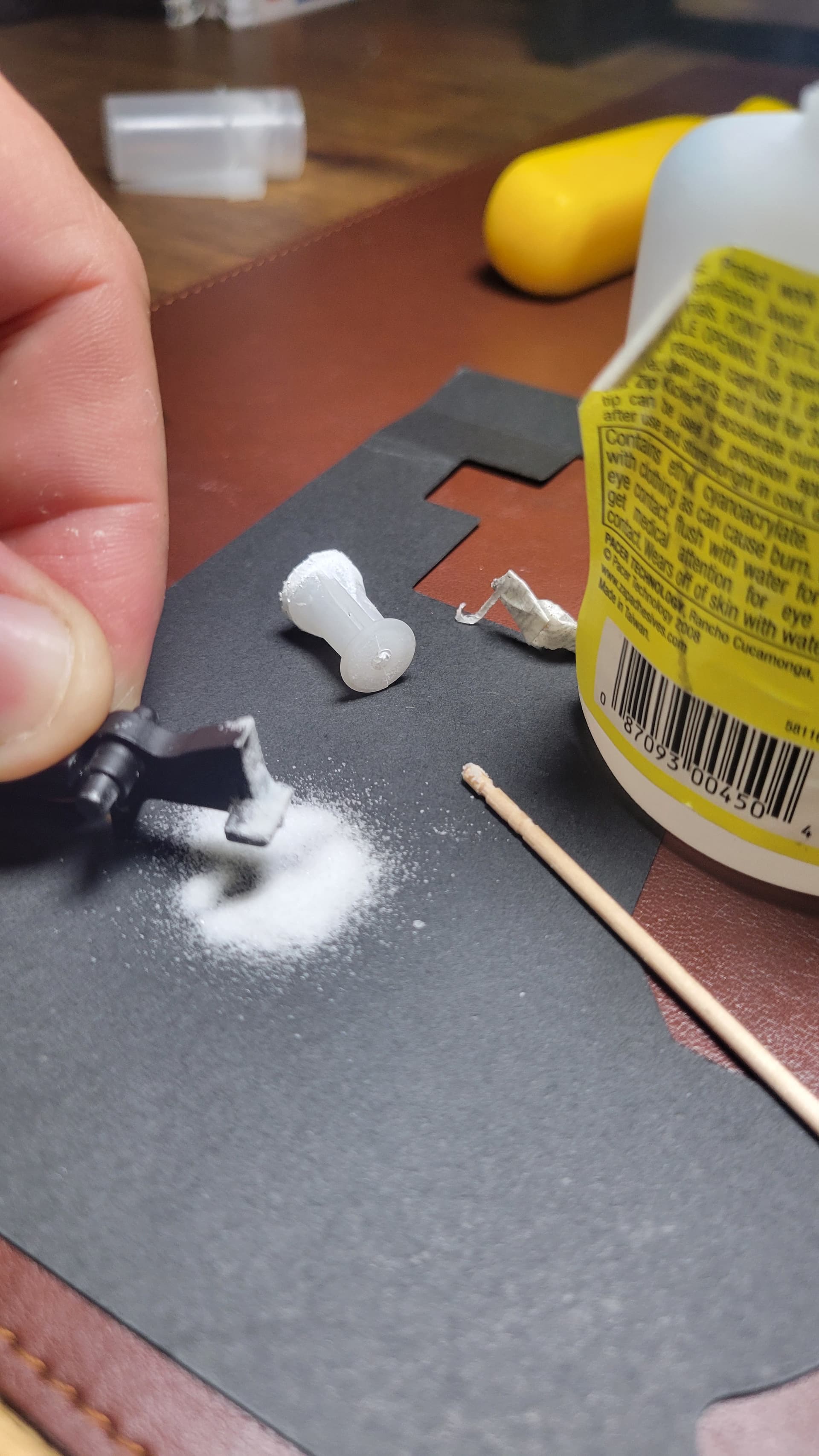

Not sure if this is the correct method for getting a shorter trigger pull but I bent the trigger switch slightly inwards and built up the trigger with some CA glue and baking soda. Needs a field test but seems to work fine with a 2mm trigger pull now :metal:
You can also bend and shape the switch lever slightly on the ldt ETU and T238 basic to reduce the distance, it is best to add a grub screw or material to reduce the travel as well so you don’t bend it back if the trigger is pulled to hard or fast.
The catch is some receiver/trigger and gearbox combinations will need the trigger hole in the receiver elongated slightly to allow it to fit too.
Not needed if it’s only you using it and you have discipline to not pull trigger to hard or far but more for if someone else uses it who isn’t aware of it.
I quite like the t238 basic and ldt ETU for this ability and the nice tactile feeling switch, that is big and durable.

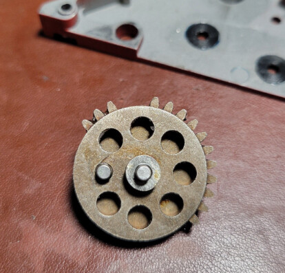

The 13:1 gears were giving me a heap of grief, just couldn’t get them to spin smoothly and felt like there was a knocking or grazing of gear against gear, or maybe gear against gearbox shell, spent hours fault finding and couldn’t get them to spin without an unwelcome noise.
Figured I’d put the original 18:1 gears that came with the box back in, just so I could test the air seals and maybe diagnose the feeding problem. Put those in and they spun well, no strange noises. Fired two magazines then it started screeching, opened up to find two teeth broken off the sector gear.
The good news, for the two magazines it was doing 25rps and 300fps. This ones kicking my ass so I’ll take a win where I can get it
mm crash wish 18’s that speed. It’s all good your methodical working through things is impressive. All part of the fun :+1:
