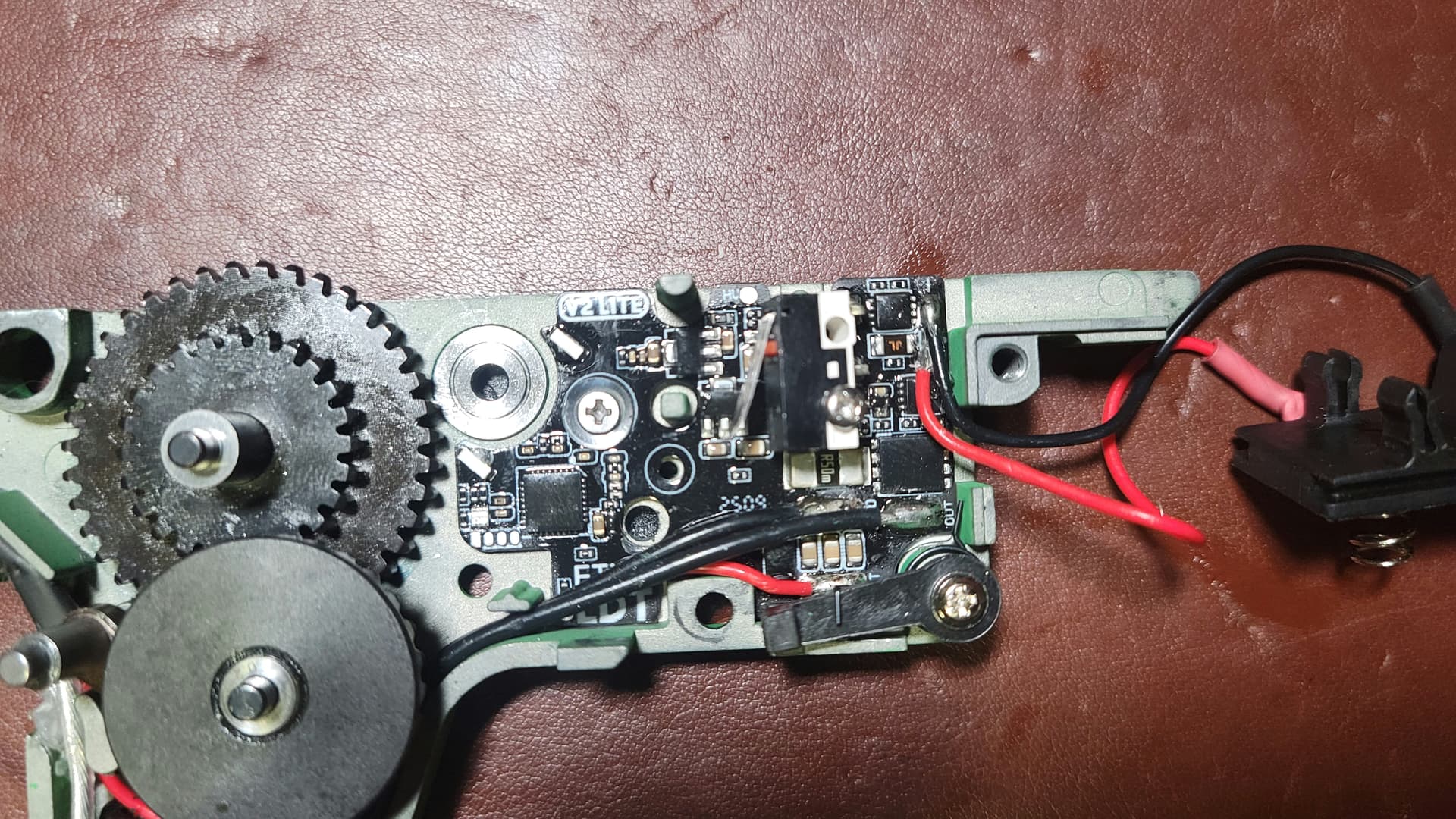

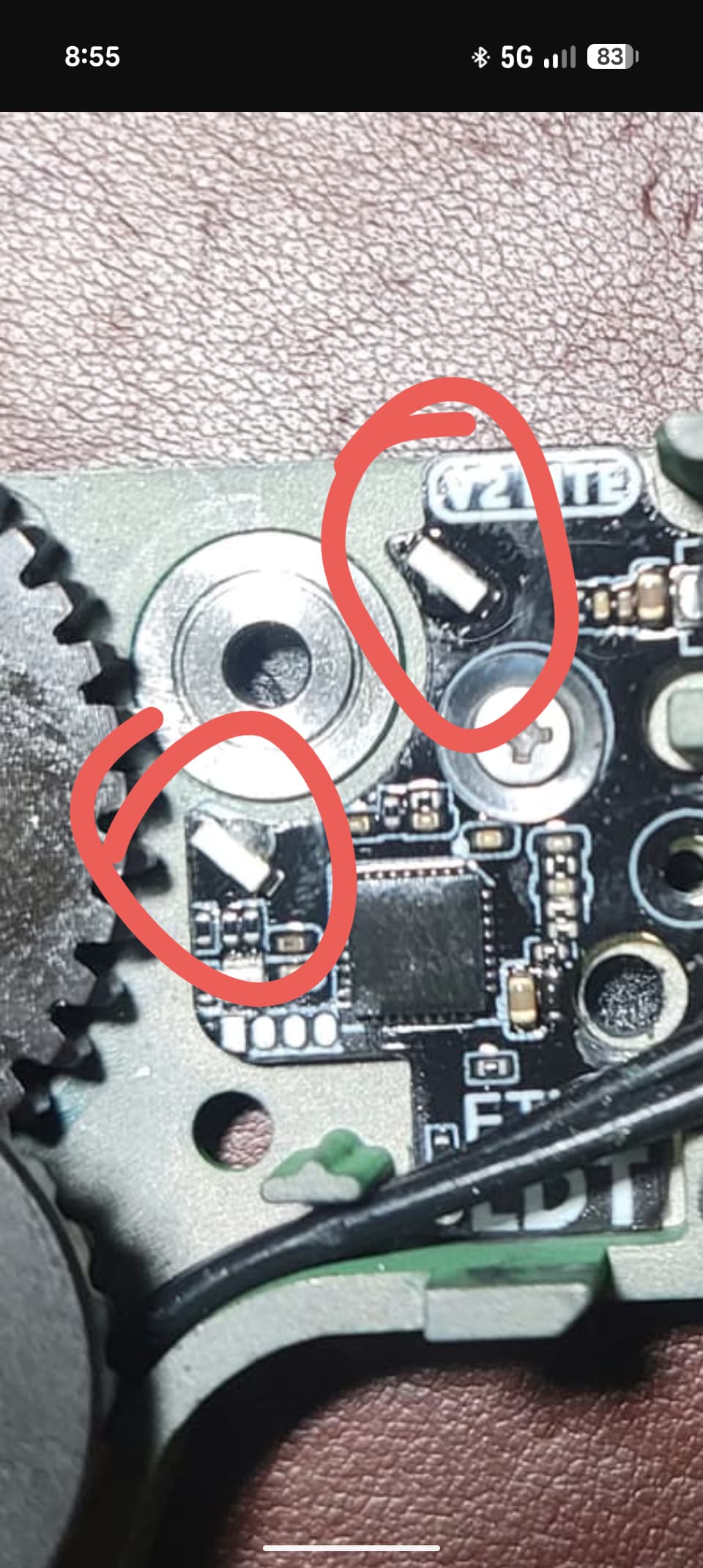

Any chance you’d be able to point out the sensor for cleaning on this fella?
One is a transmitter the other a receiver… doesn’t matter which is which, cutting bud and a bit of isopropyl alcohol should clean em up.
Hopefully I hats the issue.
Thanks mate will give them a wipe down.

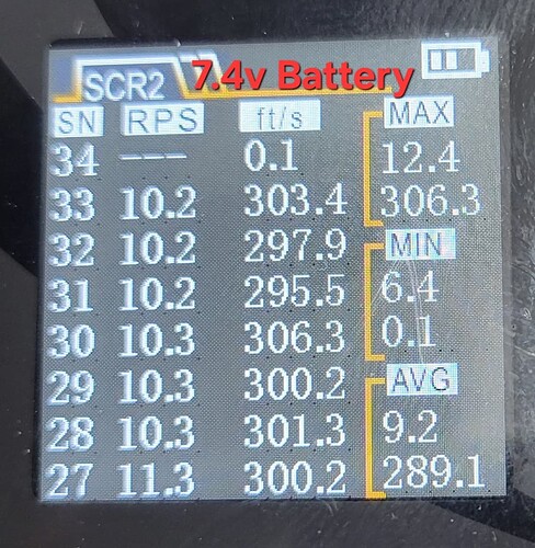

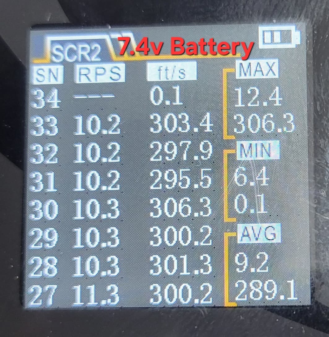

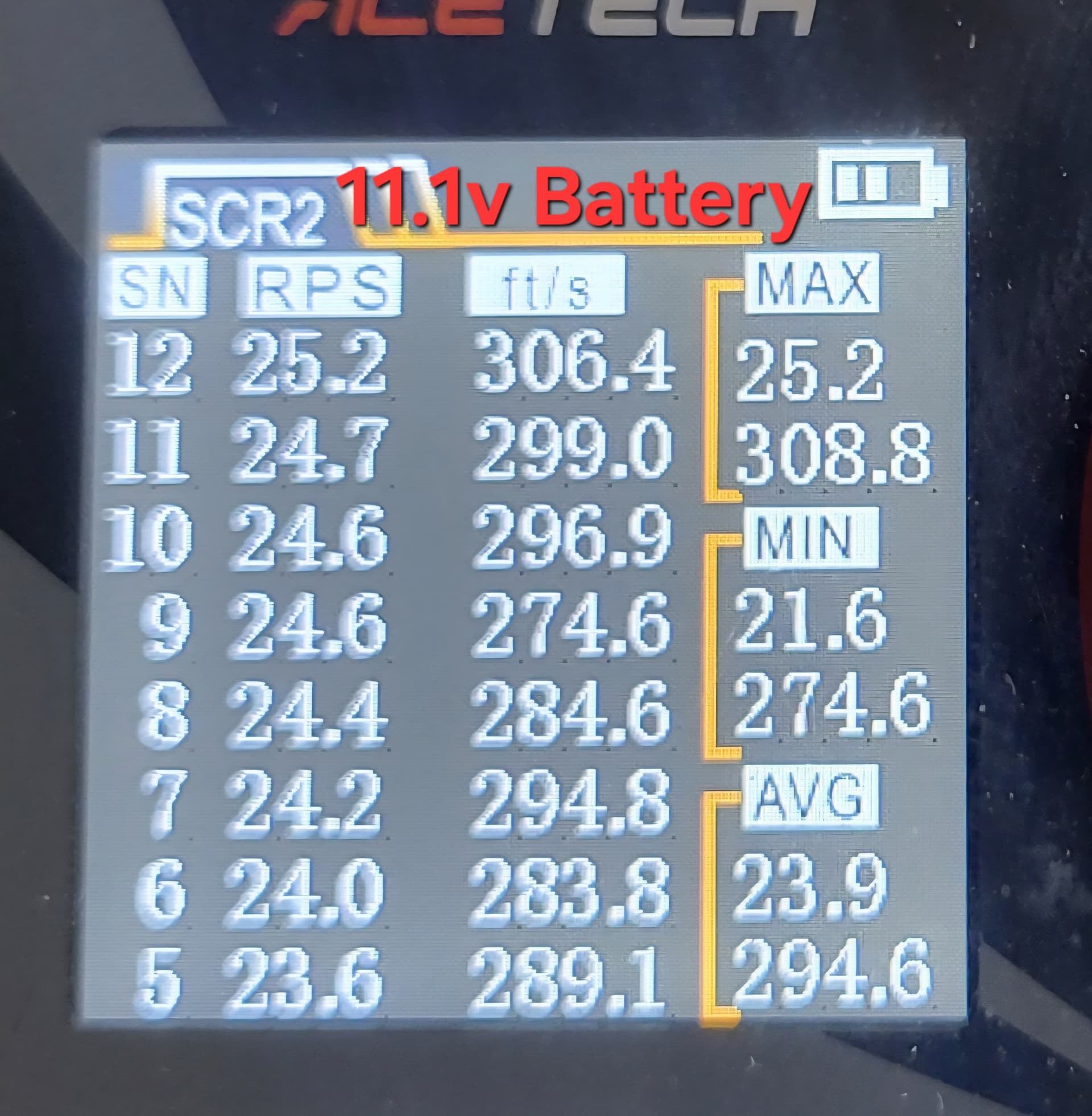

Getting closer with the 11.1v and 7.4v comparison. So far 2 loops off the tappet plate spring and maybe 0.5mm off the tappet plate fin.
Owes me another 5 hours this morning :expressionless:
Trimmed another 1mm off the tappet plate tale, while there checked the gears were spinning freely, found the spur gear tight yet again, previously thought it was bad shimming but on closer inspection the bushings are coming out of their holes causing them to squeeze the spur and bevel gear. Use the fang dangled bushing installer/remover tool to push them back in. Blaster back together, fps is down to 250. Head scratching.
Pull apart again and the spur and sector gear are tight once again, pull it all apart, pop the bushings out and rough up the inside of the bushing holes to give the bushings more resistance. Back together again with a complete re shim. Test again, 250 fps with 11.1v battery, 1 in 5 shots or so there is no gel coming out of the barrel. Head scratching.
Tear down and find the air seal lacking for some reason I can’t fathom, since I haven’t screwed with that lately. Pull the top half apart, clean, new o rings, new oil, desktop test air seal appears to be back. Spin the gears and the spur and bevel gear are tight again so assuming the bushings are coming out of their socket again.

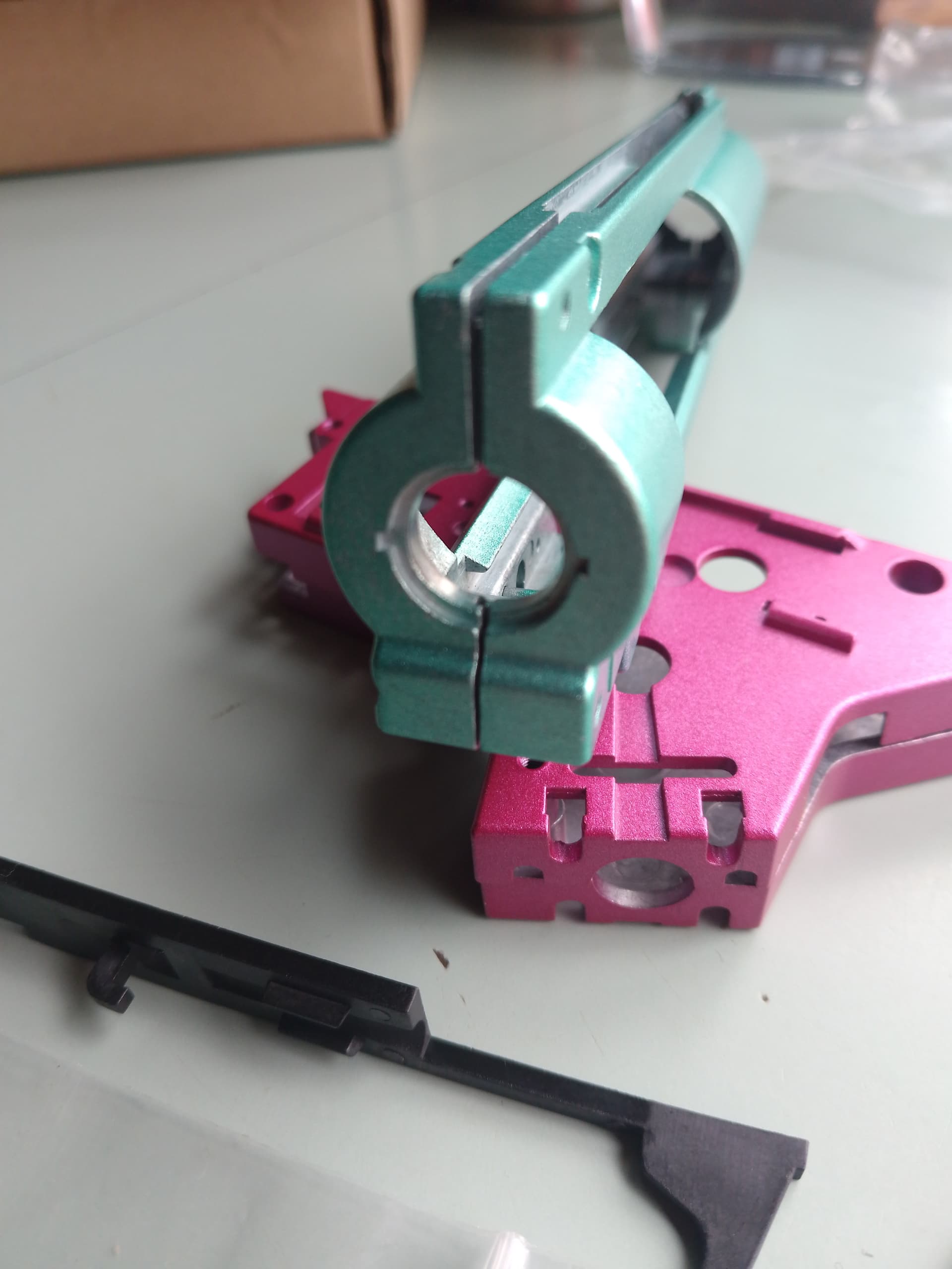

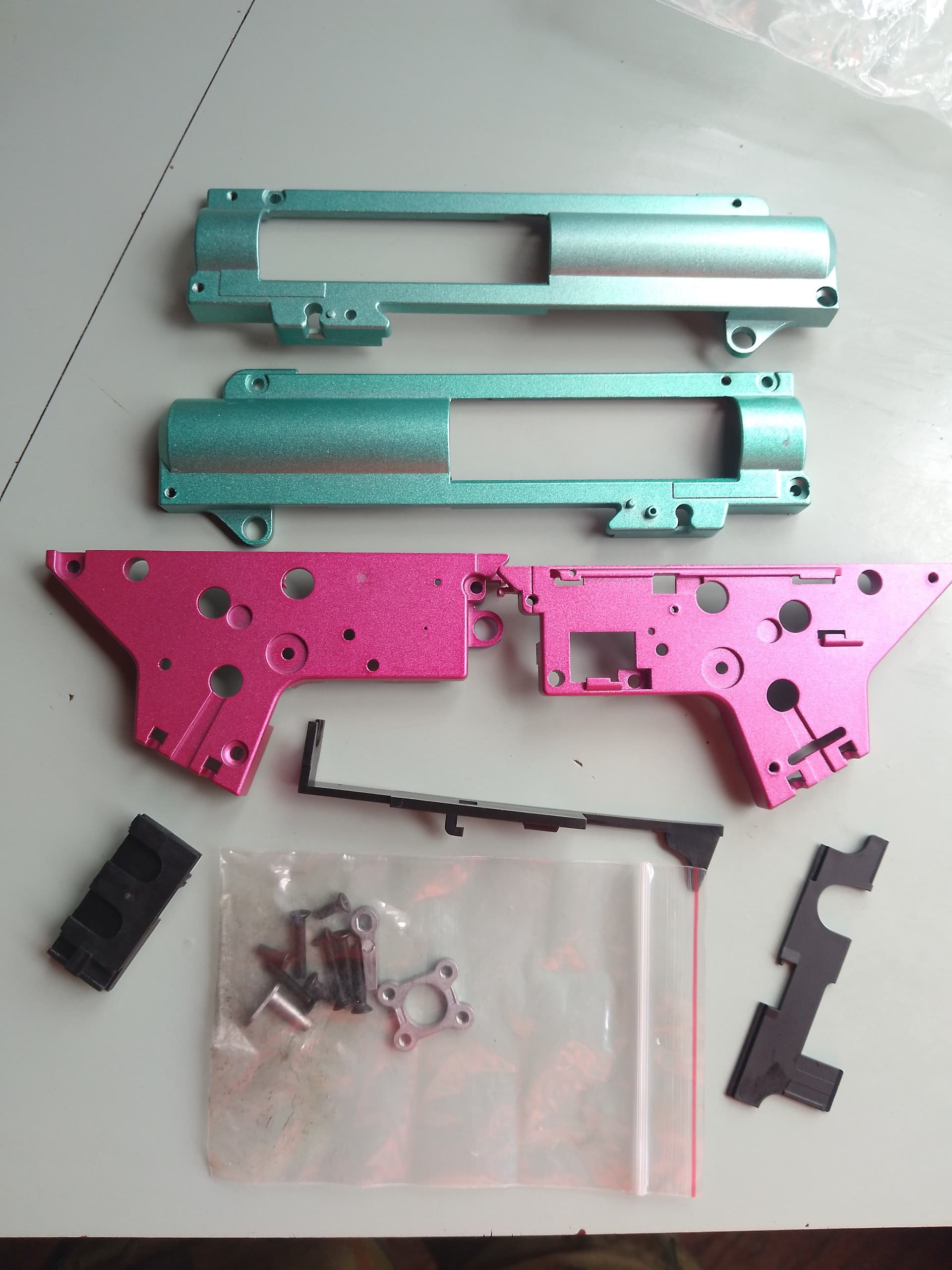

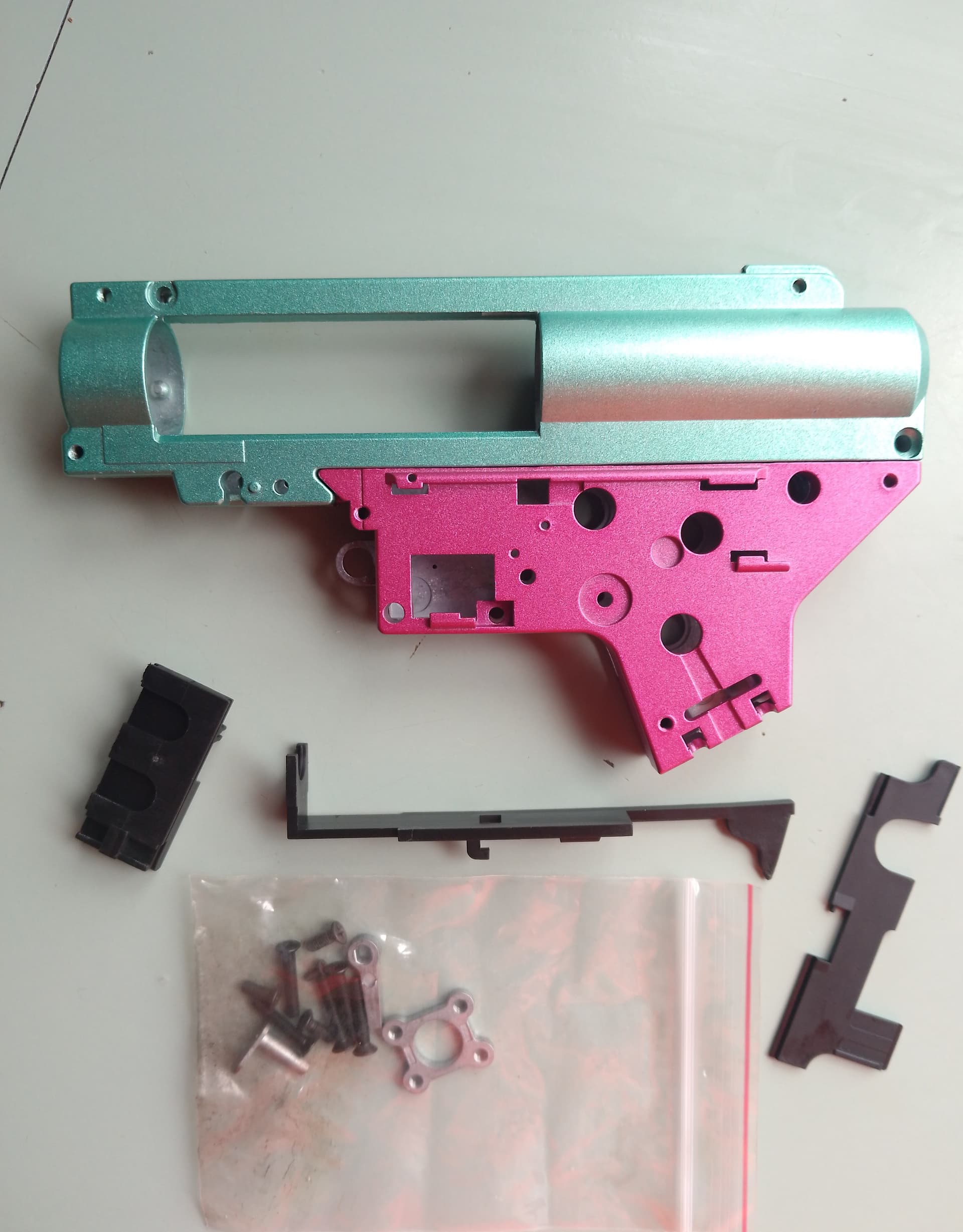

Apologies for the wait, but this rainy day finally gave me some time to dig through the pile of boxes and get some pics of the old Silveredge/Titan Split gearboxes.
I’ve got quite a few here still unopened in their original boxes…
But as you can see, they are just old Pot Metal boxes and the very first aftermarket ā€œSplitā€ type design that were released, so nothing special in this day and age, but quite ā€œspace ageā€ technology back then!:smile:
The included parts bag normally contains a set of bushes, mag terminal plate, metal motor mount, tappet plate, selector plate, metal safety latches, cheap cast 18:1 gears and a metal strip for the selector switch… but I’ve obviously raided this particular parts bag somewhere in the past, even though the gearbox itself was still all taped up in its original bubble wrap packaging.
The only issue I had with them is the specific design where the T-Piece engages the front of the gearbox.
I should have measured it whilst I had it on the bench, but didn’t cross my mind at the time of taking these pics.
I believe the inner diameter is smaller than most common T-Pieces/ & Gen8 style Nozzles, and uses a recessed/keyed type locking design that only suits certain types of T-Pieces unless modified to suit.
(Most likely an Airsoft design.)
It’s way too many Beers ago to remember which T-Pieces I used or whatever I modified, but I’m sure that @RokSolid or @Friendly_Fire might be able to shed some light on these types of T-Pieces.:thinking:
I did build a handful of these back in the day when there was nothing else available of their kind on the market, and also sent @ZeHamish one on the old Forum that he put together and seemed happy with the results… but that’s quite some time ago and there’s MUCH better products available in this day and age in comparison.!:+1:
That looks very LDT-esque. Same looking in almost every way as the LDX 2.0 except the colour!
The front looks like an LDT tpiece would find as they do the same keyed tpiece design.

I can only remember that at that early stage of the game I had mainly early JinMing/STD/SKD etc parts and none of that stuff would fit
I obviously eventually got it sorted out, but just too long ago to remember exactly what I used to finish the jobs. :smile:
Wouldn’t surprise me if these came from the same factory as LDT and just sold at a cheaper price with a different sticker on the Box!:stuck_out_tongue_winking_eye:
Hard to say when in China copying is considered a form of flattery!
Even if the front presents a problem with t piece fitment, as long as it’s on the small side it would be pretty easily altered to fit, I reckon.
Gelati colours aside, they don’t look half bad as an option for nylon replacement. :+1:

Yes I have memories of filing one out trying to adapt Gen8 style T-Pieces and nozzles prior to finding parts to fit properly, but even then they could only be used in certain blasters as those nozzles didn’t necessarily align with the mag wells/magazines correctly in some models.
I think @ZeHamish put his in an SLR for memory, or possibly a WELLS PDW/CQB.:thinking:
I Do have an SLR here somewhere, but my WELLS CQB and PDW models were some of the first to go when I had my cleanout, even though they were still the latest thing on the market.
Might have to start digging through and see if I have any T-Pieces that fit, even though I would have no idea what make or model they are as just random parts rattling around in boxes somewhere!
