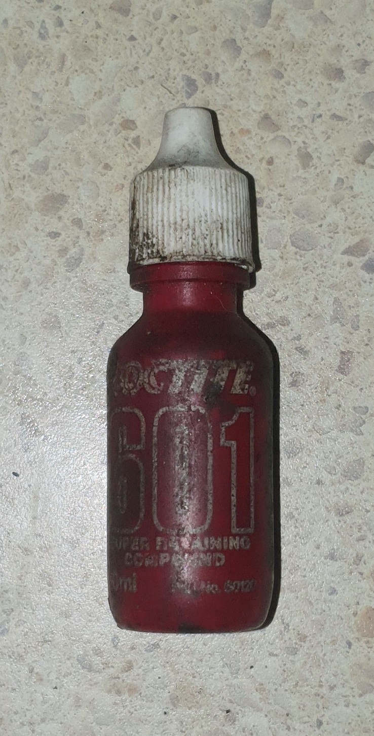

Not red as it melts when it will get warm from normal use.
Superglue, or Loctite 609 retaining compound I have used with success to sort that exact problem in other gear boxes you mention.
Superglue, ya gotta be quick. Loctite gives you a bit more time.
Thanks mate but I committed to red loctite last night, I know of the retaining compound but at $32 a bottle its a bit exxy. Failing that I have some slow setting medium viscosity superglue I can try, failing that I’m putting this thing up for auction and donating the money to the Emotional Health Unit of the Mater Hospital, where I’ll end up.

@Jug bit cheaper here Loctite 609 Retaining Compound Cylindrical bonding Adhesive 10ml. | eBay Australia
You only need a couple drops per bush. Worked for me anyway. Hope helps out.
You can tell my 601 Loctite retaining compound’s had a hard life… :wink:
It’s what I use, even if it is blue… :rofl:
Specifically for cylindrical parts, fills gaps to 0.1mm, 30 minute cure time, good for between -55°C to 150°C.
Mind you, the red is much stronger and good for 270°C temps, but red’s just a bit too permanent for a gel blaster for mine.
If you’re blaster’s running at temps over 150°C and melting 601 blue, you’ve got a problem. :laughing:
General rule of thumb is blue Loctite if it has to come apart again, red if it doesn’t… unless you want to heat it up to 270°C with a blowtorch.
Yep, that is what I meant and you kinda don’t want to take a oxy super heater to your blaster to get it apart for a simple o ring or spring change.

That was always the confusing thing trying to explain Loctite to my customers.
Red Loctite is Blue bottle and Blue Loctite is the Red bottle… makes perfect sense!:roll_eyes::joy:
I know, forget the bottle, look at the number and what is actually inside. All genuine Loctite bottles are red anyway. Knock offs are not.

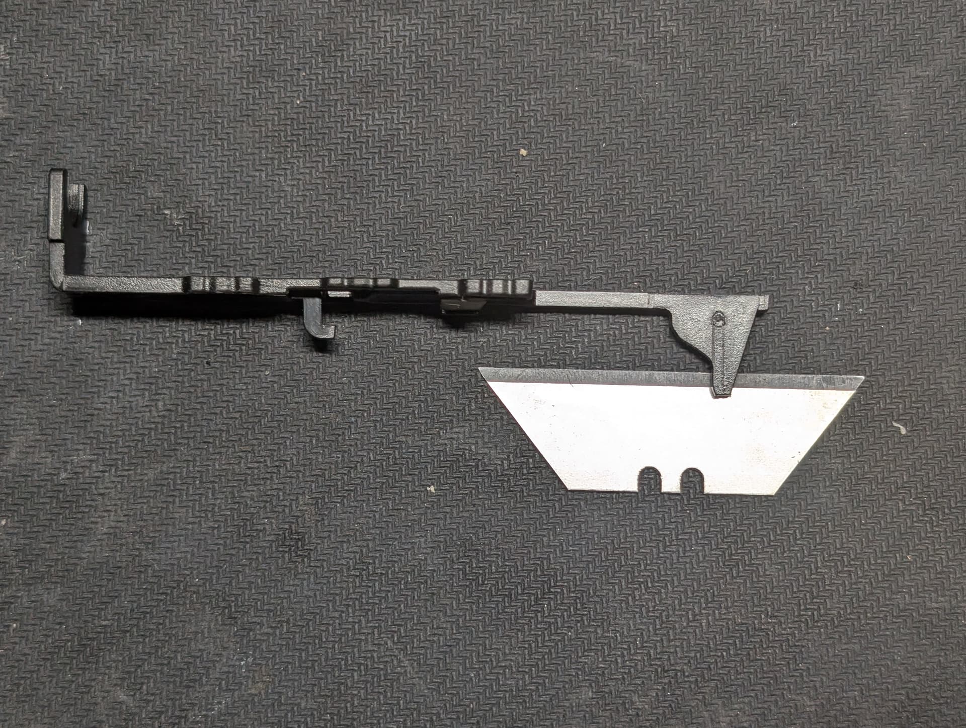

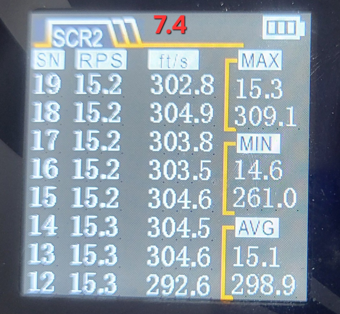

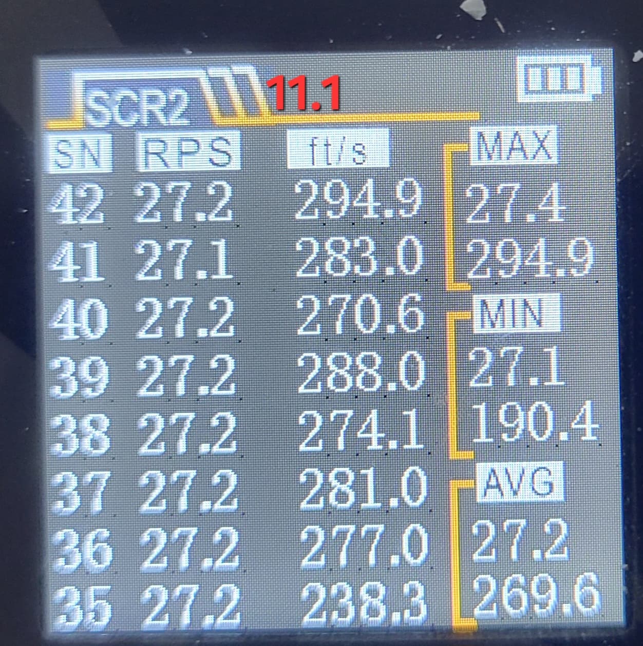

After trimming the tappet plate the FPS has gone down, rather than UP.
Was
7.4 = 300 fps
11.1 = 270 fps

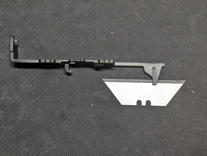

After another 1mm trim its
7.4 = 300 fps
11.1 = 250 fps.
I’ve taken bugger all off it, should I try another mm and re test?
115e7d4e-bc96-437e-a0ce-62d59040a0d3

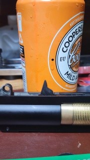

You can usually cut to the pictured blades edge region. But as a guide, this is my starting point for my next 30rps build. I expect my trim might be a little conservative and another mm or two may be needed, so you are a fair way off trimming too much.
It is best to go in small increments, as too far and you will run into feeding issues.
Thanks mate — I’ll keep trimming 1 mm at a time and see if it brings the FPS and consistency up to match the 7.4V.
Worst case, I can always grab another tappet plate.

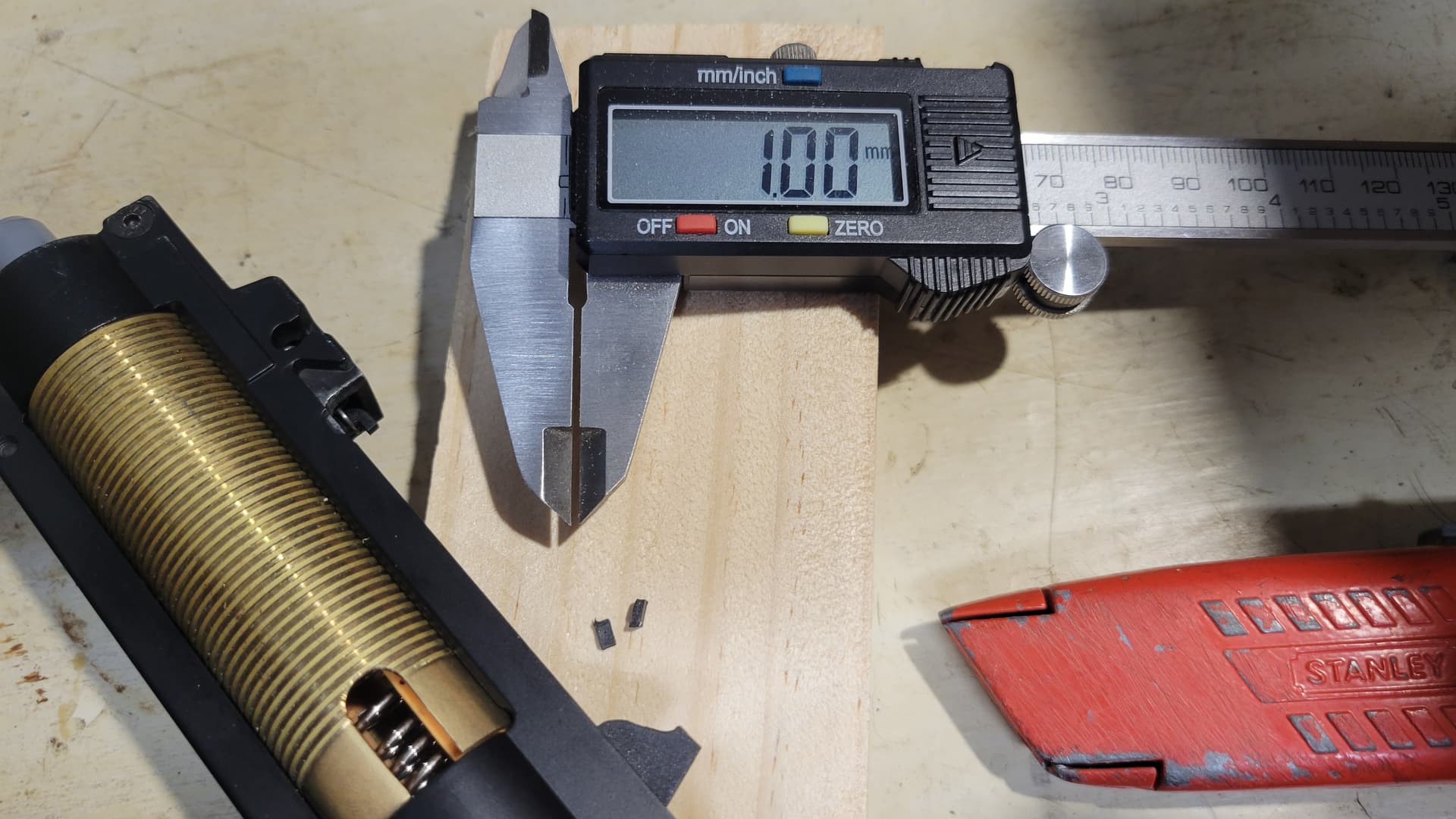

1mm at a time. Proof no power tools in sight
Ran out of time to do anymore than 3mm but getting closer to the 7.4v numbers. Trimming the tappet plates seems to have helped with the feeding, that’s now sitting at a steady 27rps.
That’s some pretty decent numbers mate, slowly getting there, well done!:ok_hand::clap:
Gonna be hard to beat the 7v fps consistency, that’s a nice high bar to will for, but so close on 11v now
