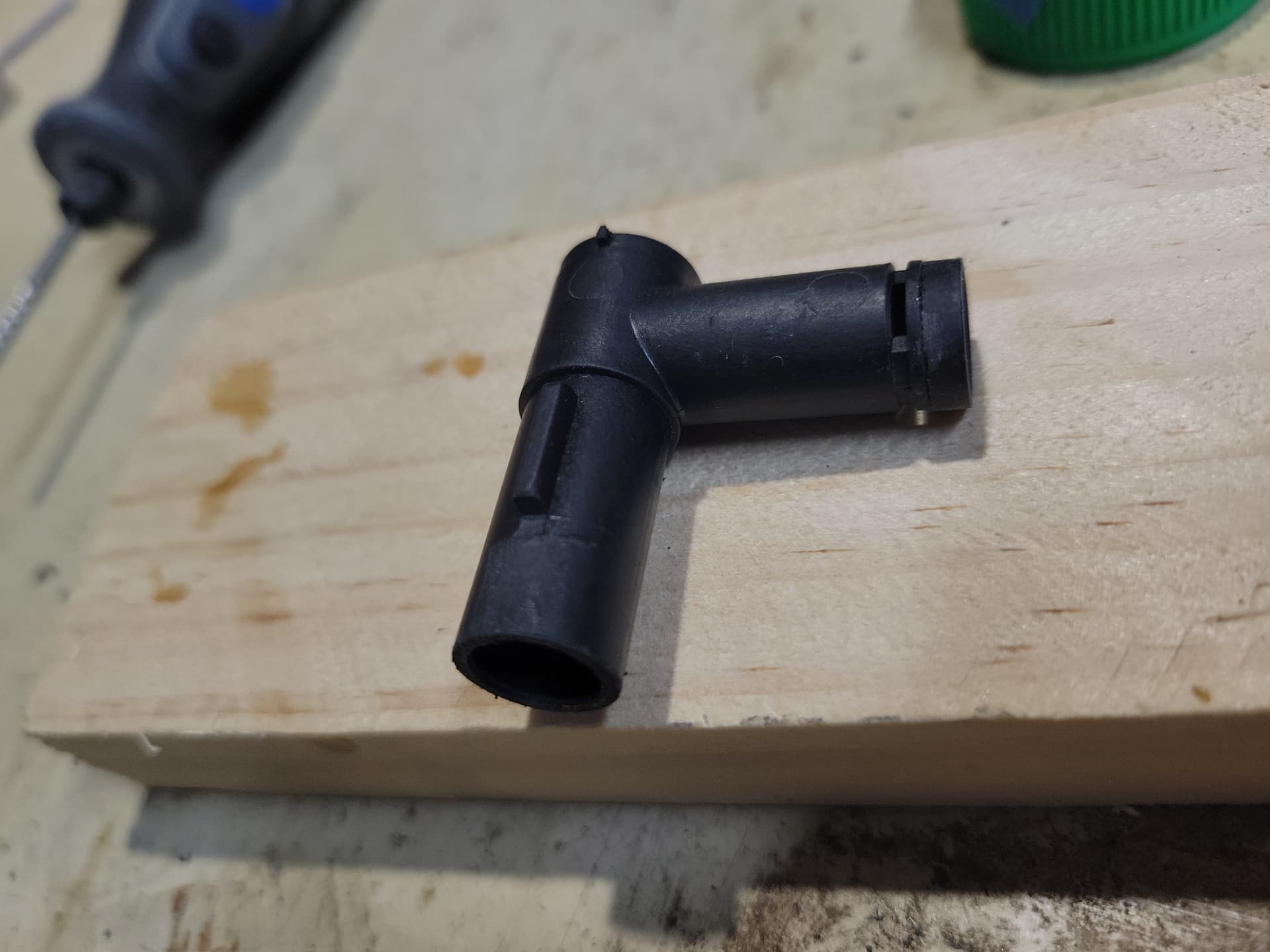

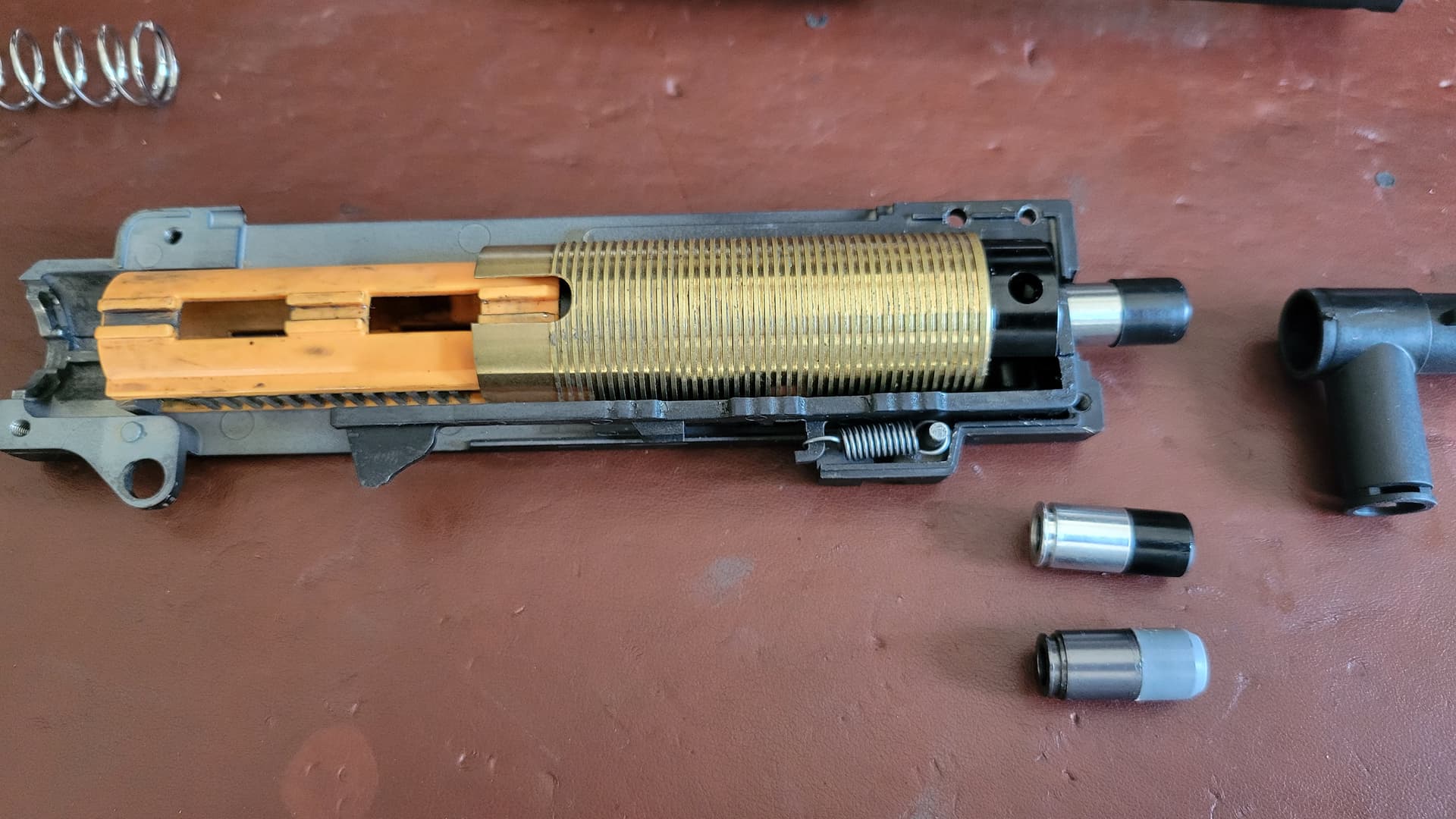

I found an old post from @DocBob about air seal tests with the nozzle at full extension so I tested that with the setup in the pic below and got some interesting results.
Tried all three in the picture and the one with the best air seal at full extension was one that I must have picked up ages ago as a spare, cant remember where from but its labelled as an LDT nozzle and appears to be stainless steel whereas the middle nozzle is alloy.

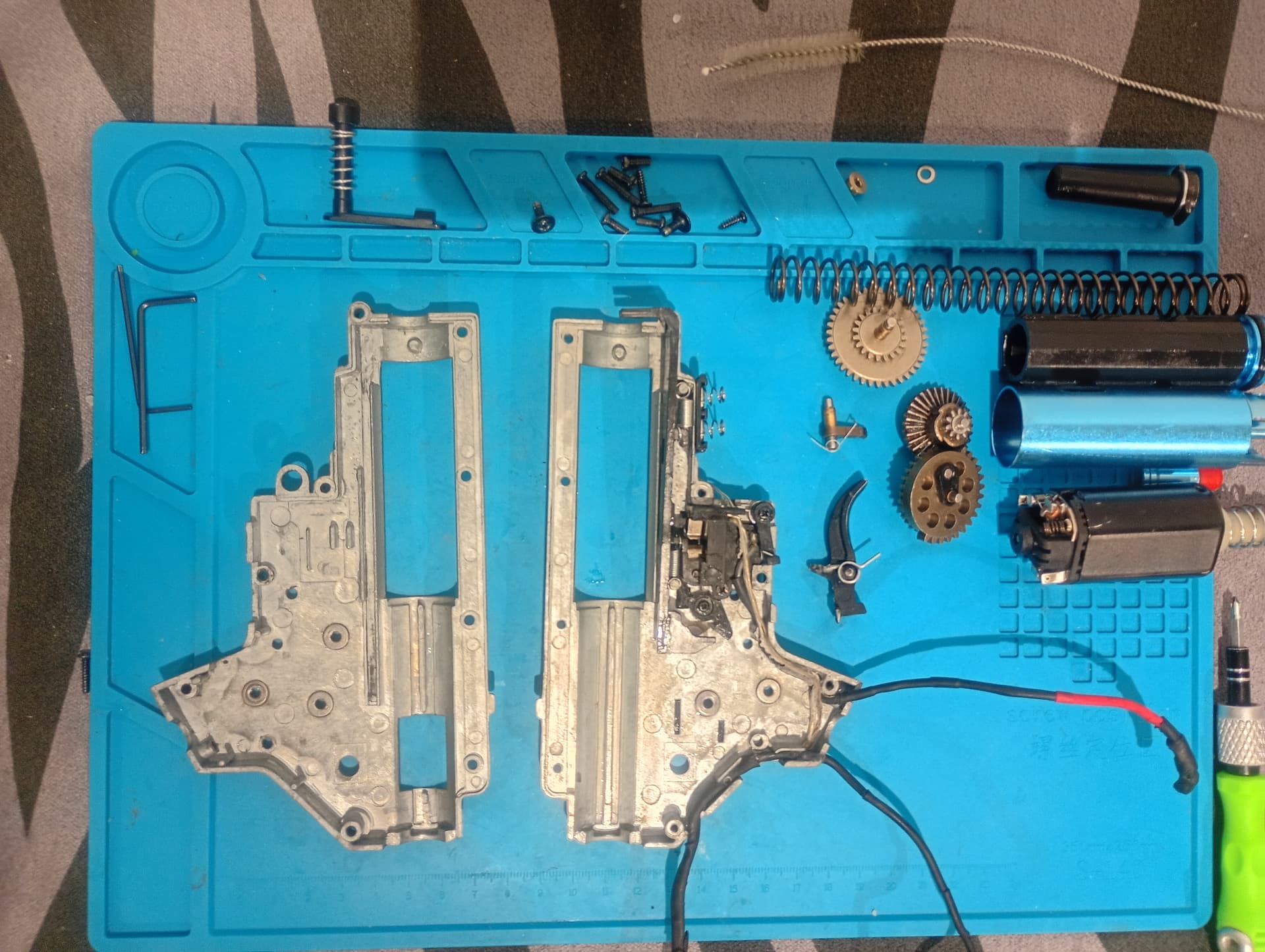

Anyway the airseal at extension is now really good. Time to put it all back together again

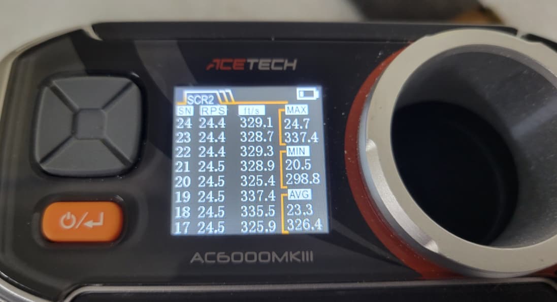

It is increasingly difficult to get numbers like that at 25+rps.
If the better sealing nozzle drops the fps it will be because it is too good of a seal/tight.
Very fine line between the nozzle moving freely and sealing. Too tight and fps will drop due to nozzle not making it seal in time, too loose and fps will drop as the seal isn’t there.

Thanks for the intel as always :+1: Interestingly the nozzle swap with the better airseal at full extension made zero difference.
All these tests are with an M110 and a 7.3 barrel so thought it would have gone quicker. Not that this is about chasing the FPS. Don’t need it to do 330 but if its capable of doing 330, I want to learn how to get there.

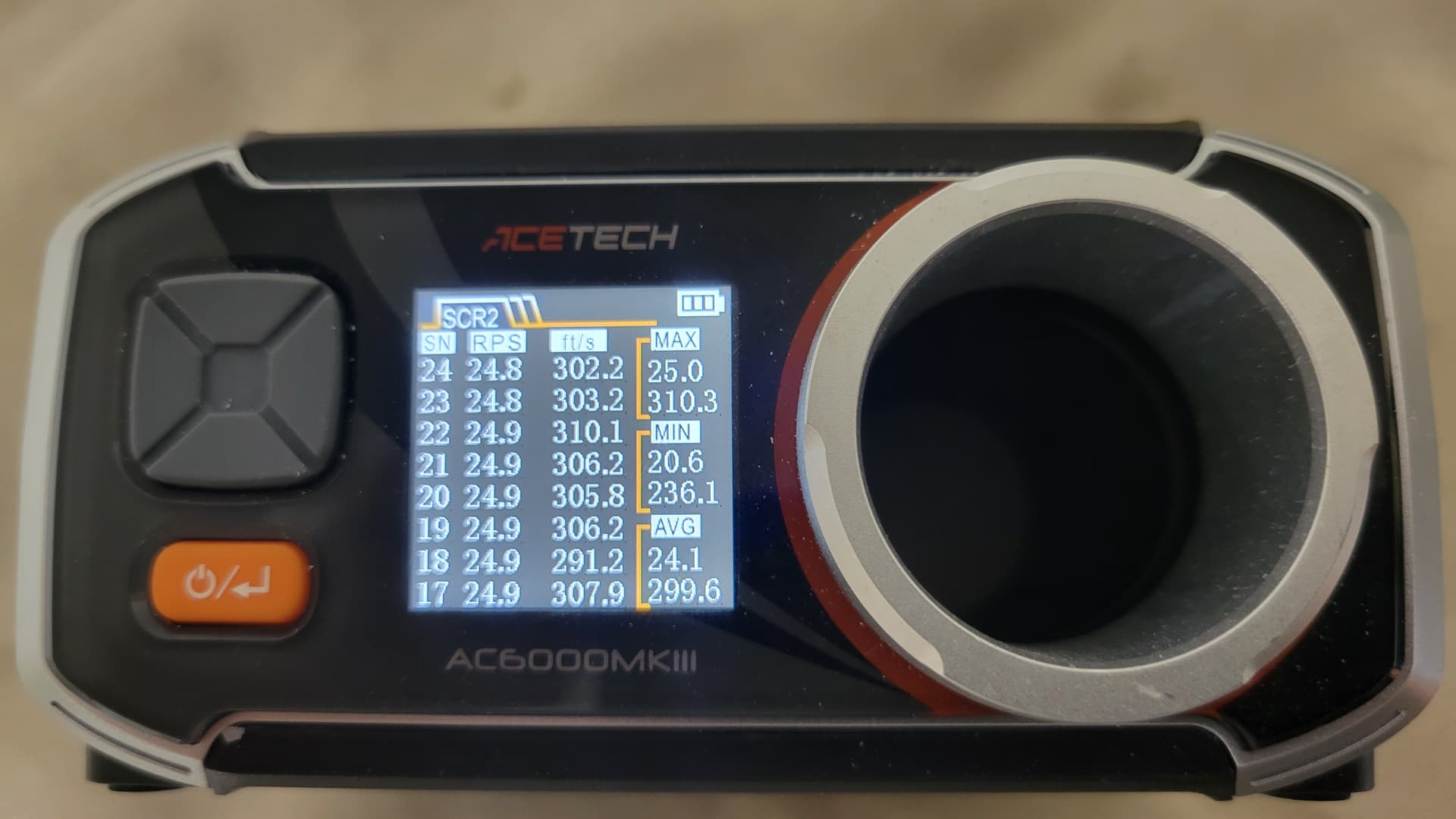

The chrono is an Acetech AC6000MKIII from xforce. Has been very reliable :+1:

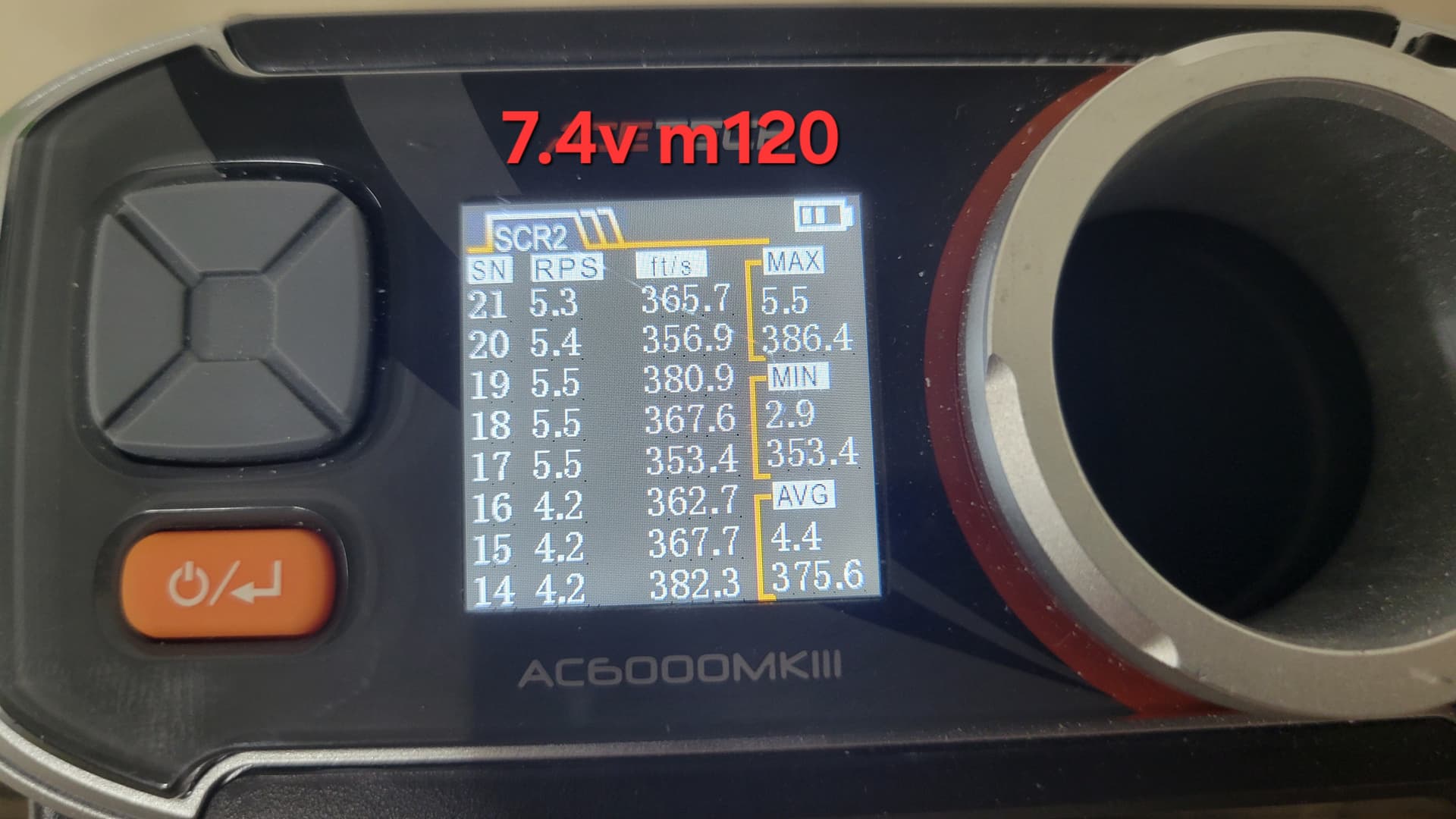

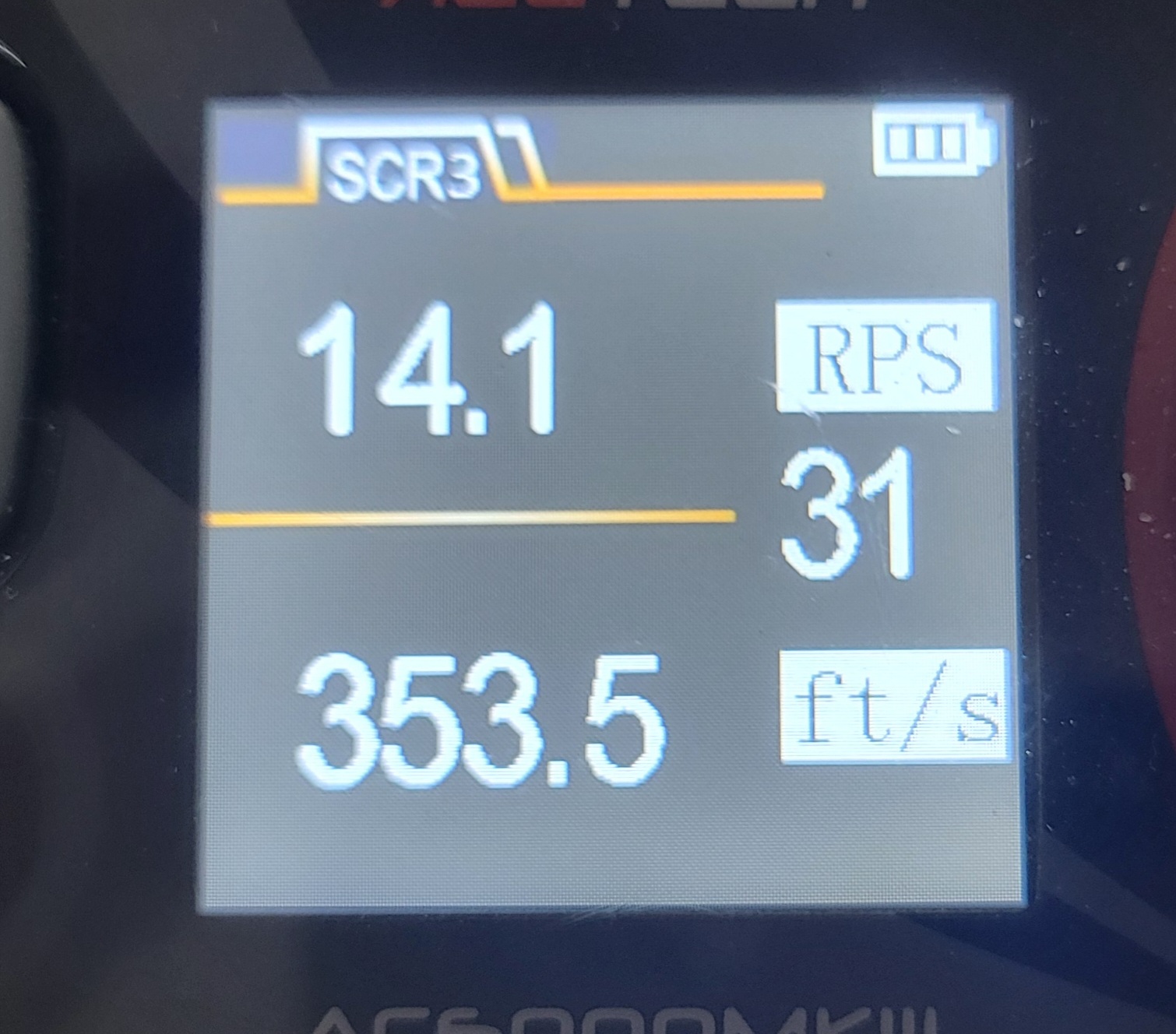

As an experiment I tried an m120 with a slower motor and 7.4 battery this morning and got this. Guessing that the seal is better now that it has more time to create that seal?
Average 375fps which is way too high for my needs

M120 is a bit angry! Go back to m110?

Seems it has the seal it just doesn’t want to keep up at speed.

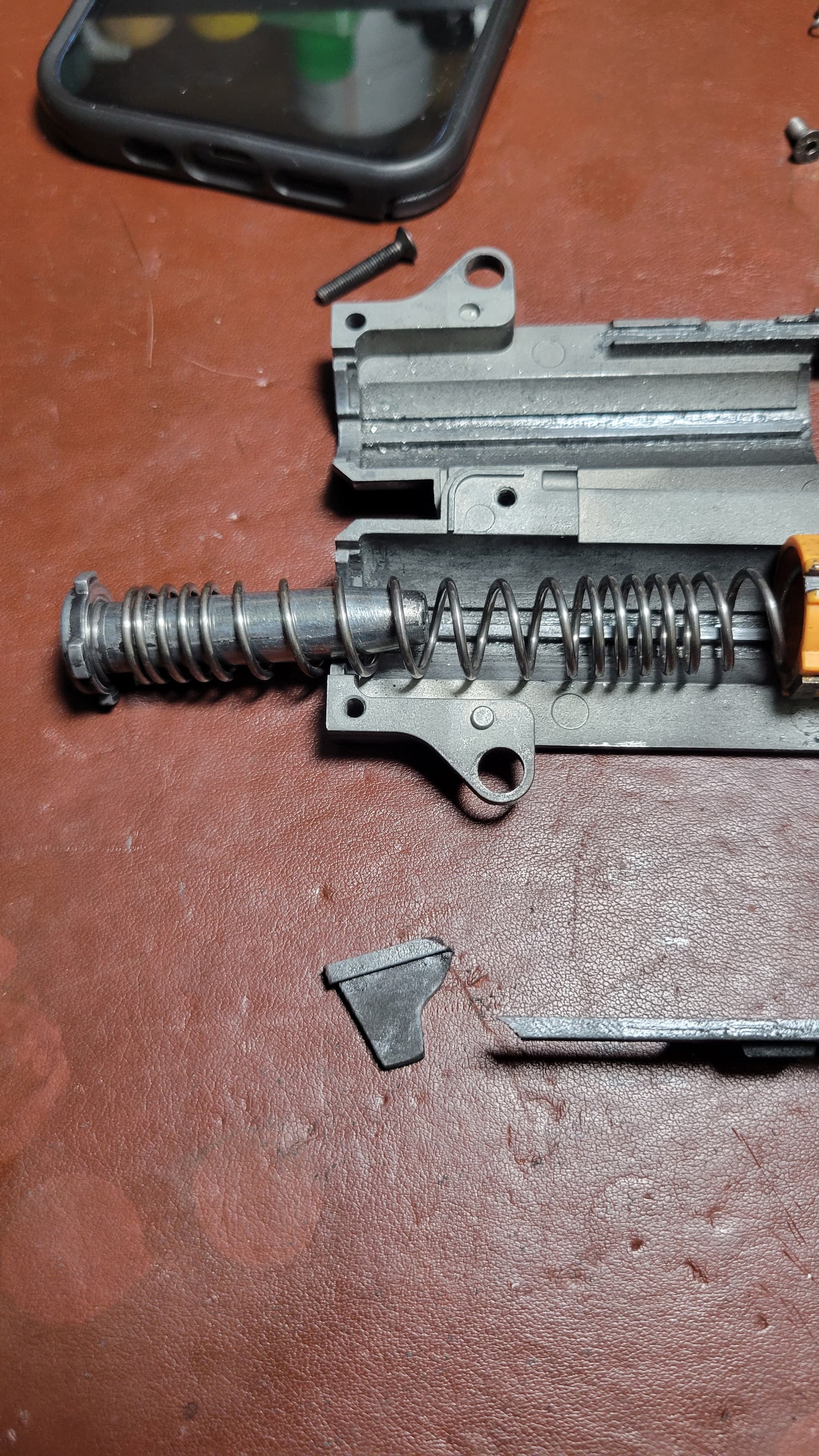

Ended up buying a couple of spare tappet plates, the fin got mangled on one of them, looks like it had been pushed to the side. The other I cut down in 1mm increments until I’d gone too far, just for the exercise to see how ā€œtoo farā€ was. The original APS tappet plate that came with this receiver is in there now with a mild trim.

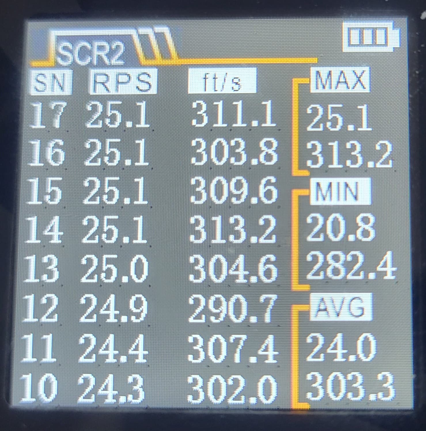

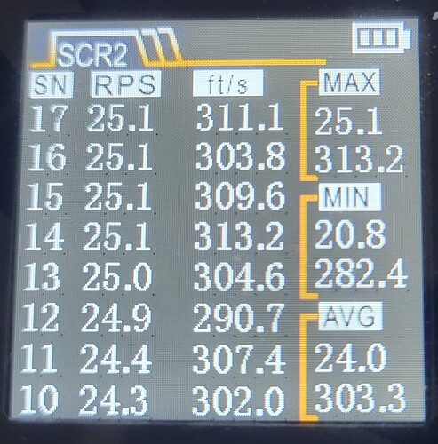

Bought a T238 brushless adjustable motor and set that to 24 - 25 RPS so nothing too nuts.
The M110 spring I was using is a bit suspect and possibly the cause of the 270FPS I was getting. Tried and old azreals spring that didn’t feel too strong and that was getting 300FPS. Ausgel unequal 1.38 was getting 330 and an M120 spring was getting 360.
Using the 300mm 7.4ID barrel that @AKgelblaster sent me as a bonus replacement part

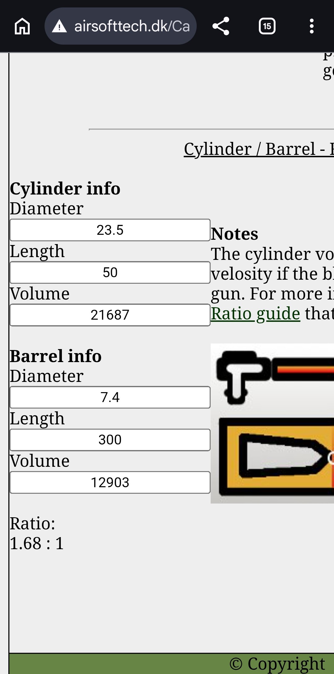

Got a reasonable VE ratio too

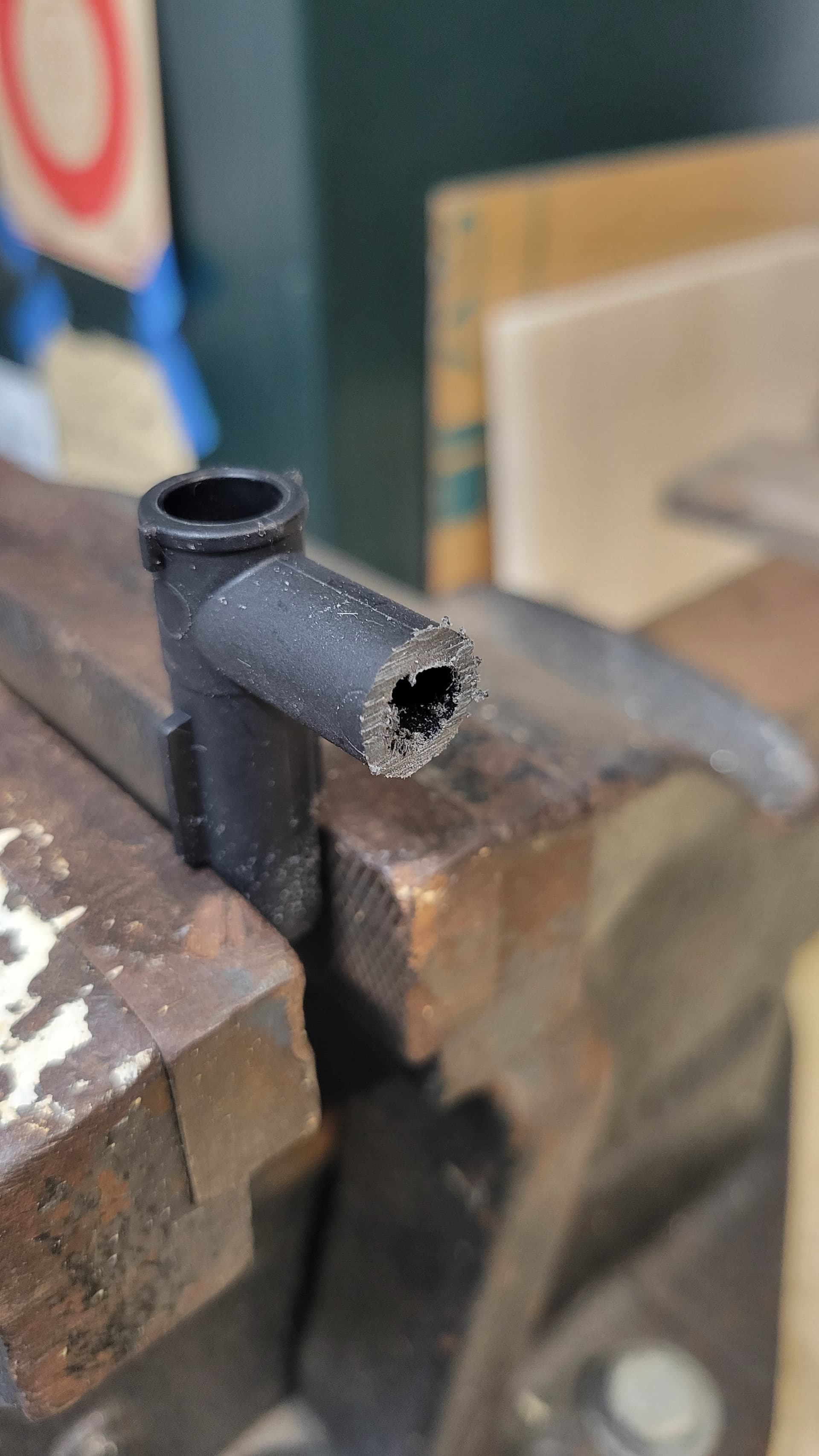

It had been getting gels jammed up when making the leap from the magazine to the T so to extend the T a spare LDX 2.0 T was sacrificed. Cut 2mm off one and glued it to the other for an extension. Seems to have fixed that problem

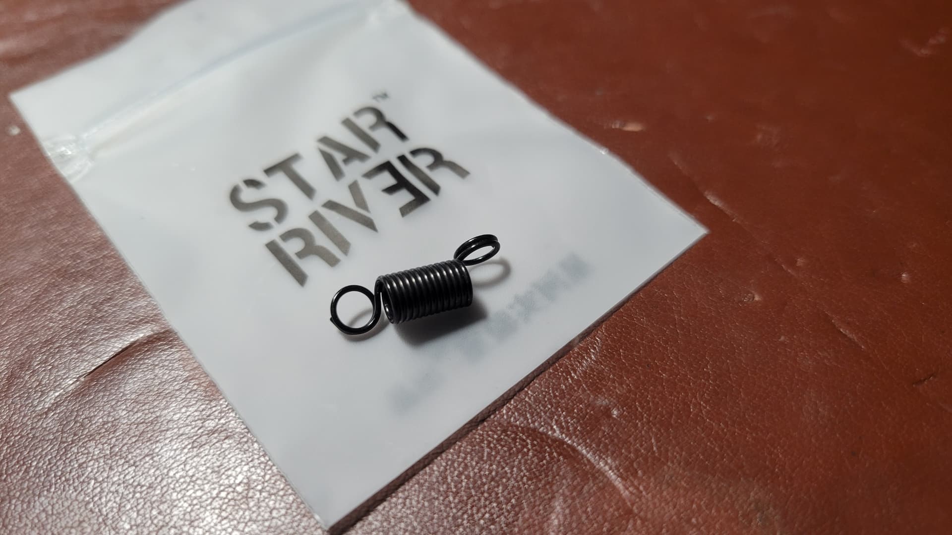

Broke a tappet plate, which was the original APS plate that came with this receiver. It was pretty stiff, so maybe it was too brittle and didn’t have enough flex, or perhaps taking three coils off the return spring was too much? Bought another LDT tappet plate and gave it a small trim.
Few days later broke the return spring that I cut 3 coils off. Fortunately Rok sent me a harder return spring as a test unit with another order which turned up the day spring broke so once again Rok delivers :+1:
