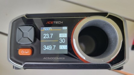

Its doing around 26 RPS at 330FPS with a fresh M110 spring, so I’m hoping that spring will settle down to 300FPS to improve the accuracy.
