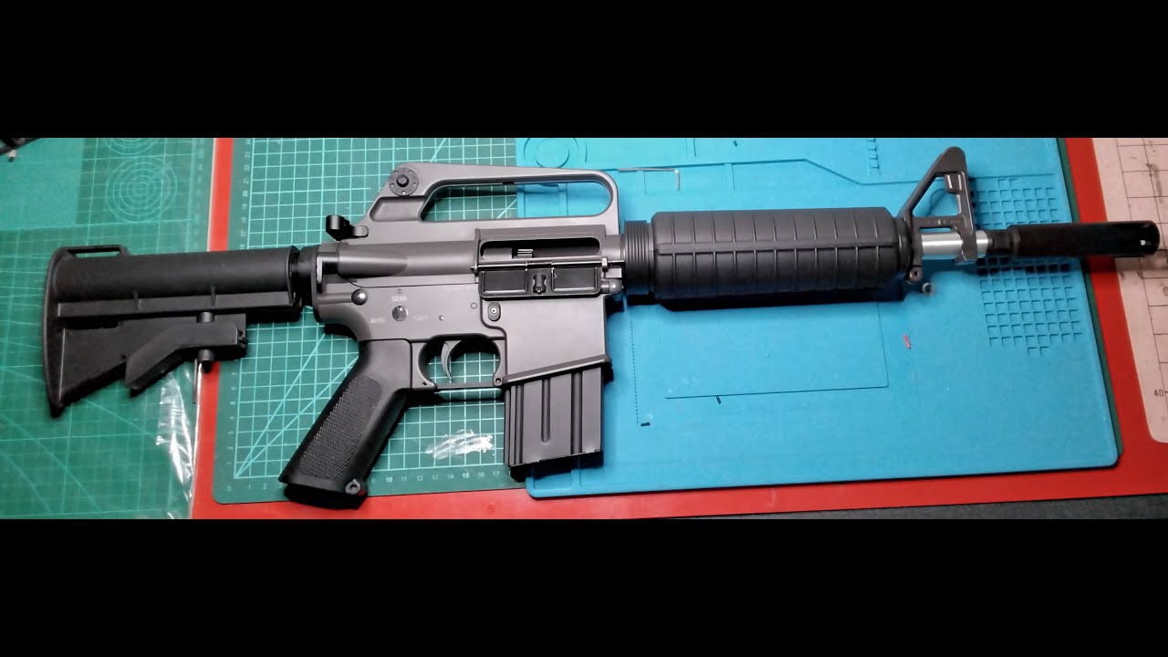

Furthering the adventure of fitting the LDT ATM gearbox into classic army XM177. Needed more room at front of receiver for the bolt to come forward 3mm or so.
ATM6
Bought a 26mm hole saw and turned some holders on lathe to hold it in place.
5 mins later…
ATM4
Removed edge with dremel, couple of slips.
ATM2
Back together for some test fire. Still some points touching.
ATM

LDT ATM classic army xm177

So I bought most of a CYMA marine of a guy, gearbox receiver, barrel and handguard. It was cheap and I can resurrect anything so why not. At this point in the hobby I get more of a kick from getting some broken neglected shit working than just buying something and upgrading it, also I am a sucker for punishment. Disclaimer, it is going to be upgraded modestly, otherwise it just wouldn’t be mine!
looks wise, its been well used and apart many times… looks like it had been on the patio in the weather for a while, anything metal is rusted, cobwebs and dead insects all through it, and a mud wasp nest in the upper receiver and barrel for bonus points. I spent an entire afternoon pulling it apart and cleaning it as best I could. Came up ok, just need a fake bolt release, body pins, and a mag release… and a stock and buffer tube bolt and plate… nothing too hard to find, though my luck says these parts will need some fit and fiddle to get working properly. They almost always do!
The gearbox… may not have been in the weather outside, but was the subject of all the advice of the internet done as poorly as possible. Bushes were jb welded in, were not all straight and sat proud enough that shimming would have likely been more compromise than good. Spent half hour every day, with various substances removing epoxy and then reinstalled the bushes correctly.
It has SHS gears in it the guy says… They were the worst fakes I have seen, the bevel was stuffed, the sector was short stroked TERRIBLY, the teeth removed were jagged AF, and not removed enough so it looks as if it was probably still picking up the piston! All the gears were worn and damaged so in the bin now.
The piston, was an aztech piston and head… the rack was munted to hell from the poor short stroking, the head was scuffed to fuck (to be fair… they do that them aztech heads) and as a result the stock aluminium cylinder is stuffed also.
The stock head was siliconed into the cylinder… that was easy to remove as it didnt work, probably didnt clean the cylinder oil off before attempting this.
There was a piece of cardboard with tape for the mag terminals and a busted ldt tpiece. I would guess it didnt work, but all good I have a 3dprinted mag terminal block for this so you can run gen8 style mags with an LDT tpiece and nozzle and not other changes.
And the best part, for me; the wiring is out of an LDT warinterest nylon box, with nicks everywhere in the wires, and a deans that was so melted it probably wouldnt go in the battery without force, and the heatshrink was not covering the melted mess so there was exposed terminals that were plain dangerous.
Finally, what looks like an SHS m100 or m110 from wire diameter, is bent and twisted, so I am tipping the poor thing had many attempts and changes before the previous owner gave up.
Gearbox case, spring retainer, tappet plate, selector plate, and anti reverse latch are all that I didnt toss to landfill from this mess… still a good deal as I love me a CYMA metal box and I can still get it working.
After a week of owning this, its cleaned, bushes are installed correctly, I have succesfully shimmed gears into it, just waiting on a motor to arrive before finishing the gears’ shimming.
I have also modified the shell slightly to accept a T238 1.9 basic mosfet as I have a few, and I just dont want to chance the ldt cutoff lever not working, also gives me an excuse to use one as I have them and have never used them yet.
A week of an hour a day, and the restoration side is done and I am finally feeling like its moving forward, also, the lower half of the handguard can be removed to barrel mount my m203 launcher! YEW!!
A few decisions on grip, stock, inner barrel and hopups to go, and a few parts to source, but reckon I can have it rocking in a week or two!
