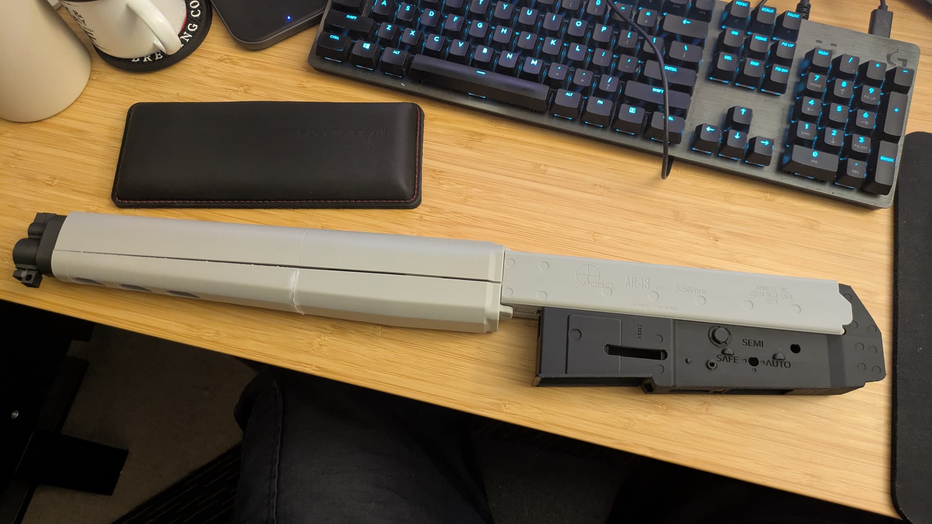

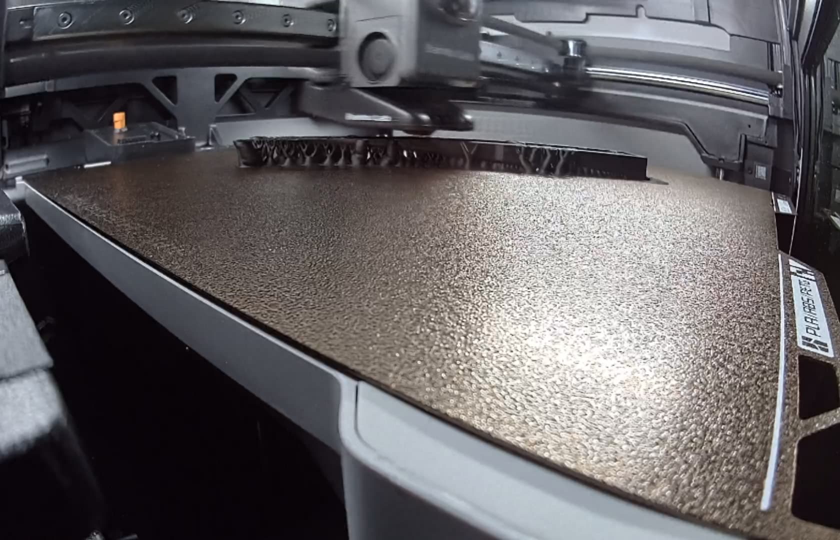

Next project has started taking shape, this one’s gonna take while thou.
Assuming I don’t have amy failed prints or need to reprint anything all up it’s something like 4 days straight total print time.

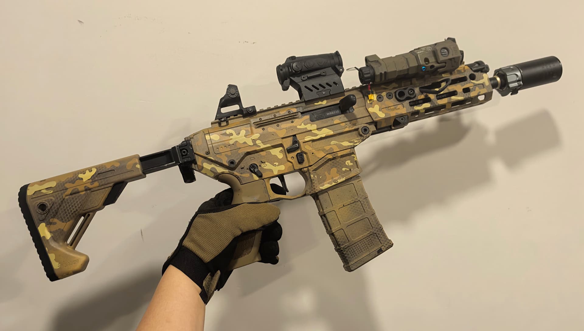

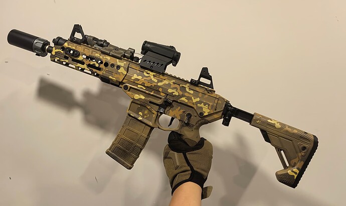

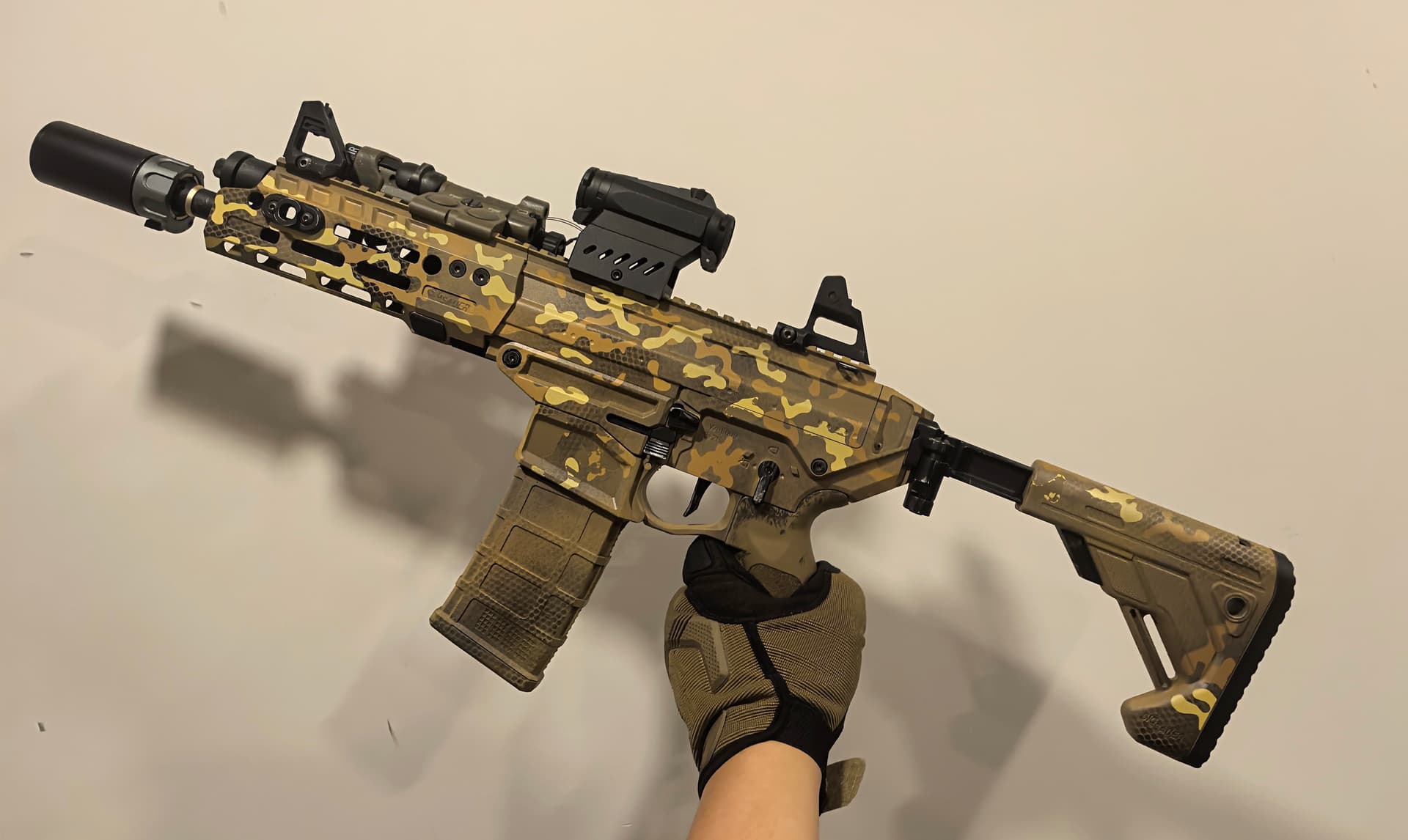

Just to update on this one: got the blowback cylinder installed, put the blowback thing back in, new inner barrel to fit and a bigger spring means its sitting comfortably at 75 MPS now which is what I wanted.
Decided to give it a new paintjob since the “weathered” look was a tad overdone lol - slowly sprayed over several days since thin layers and ample time to dry inbetween is the key here, final result is alright I guess. Could be better, for some reason the paint peeled in some places but eh, not too worried about that. I think it turned out quite well.
Mate it looks awesome. And that is the standard sentiment of anyone doing a camo paint job! The owner sees the imperfections, everyone else sees how good it is!
Remember the best camo paint jobs, end up with natural imperfections and wear, and that is when they look the best! :wink:
The first thing i saw was the stock…!!
Just what im after…!!
that finish looks nice and sharp.!

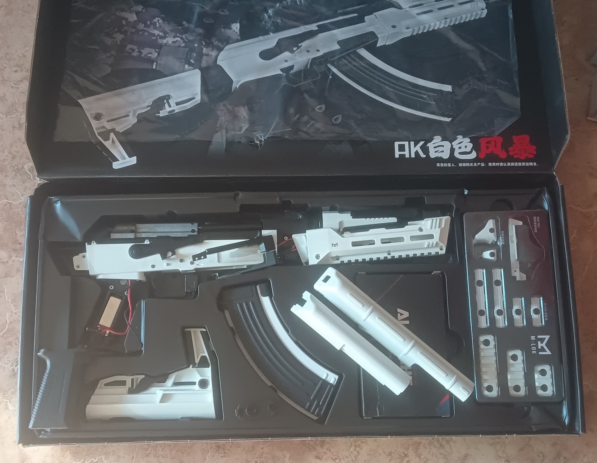

Fucking shitass RX AK STORM that fucking didn’t fire so I fucking disassembled it and found nothing fucking wrong so I fucking started it fucking assembling back but this shit is so fucking confusing it made me fucking mad and then fucking sad I fukcing gave up

Welcome to gel blaster teching! That is stage four.

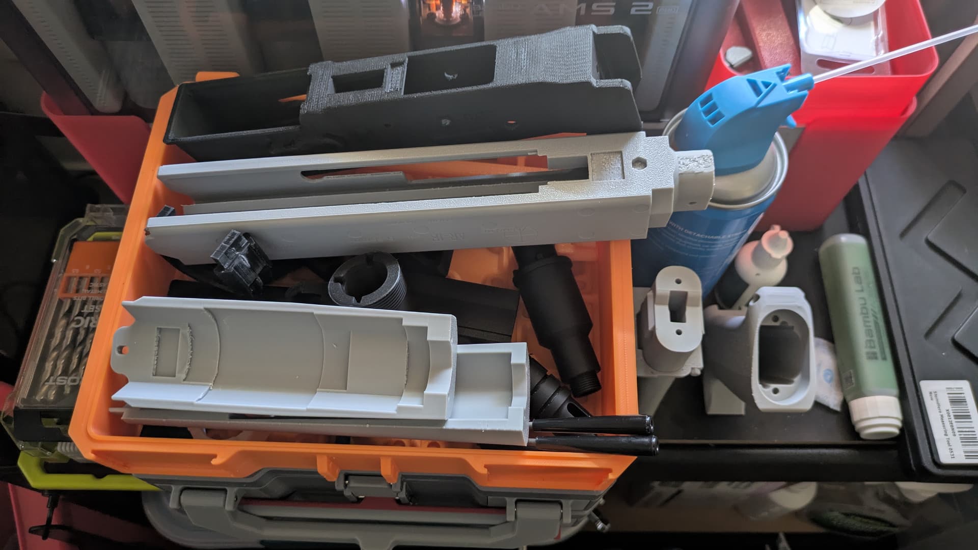

Almost finished printing, did have to reprint a couple of parts.
Gotta either find or make a grip base cause OP used a metal one, but it’s specifically for a G&G Airsoft M4 and can’t find anything local that looks like it’ll fit :confused:
This one’s gonna be a paint o sand and paint too :expressionless:

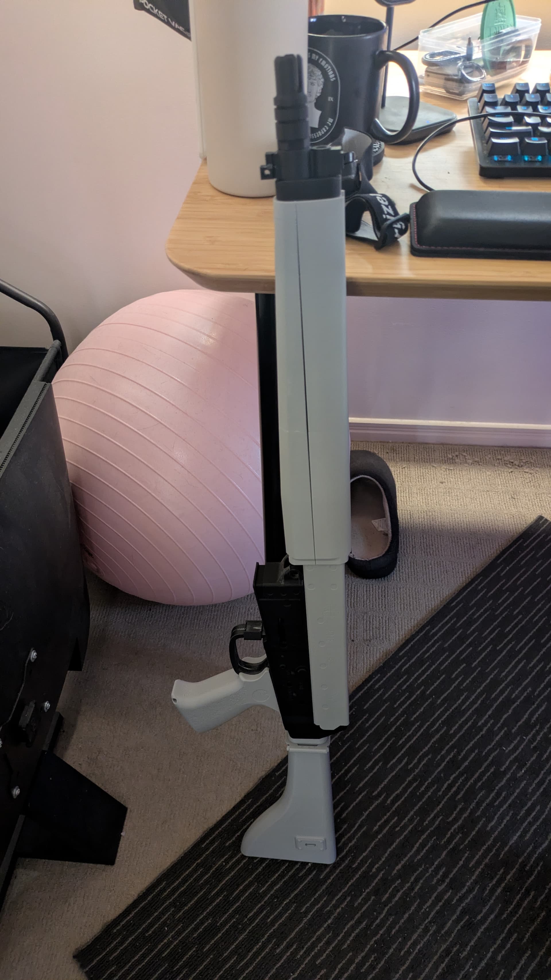

Think I’m done printing, unless I break something.
Looks to all be fitting alright, except that gap in the handguard, not sure what’s causing that yet.
Next is a proper sand down before primer goes on and still gotta sort out the motor base, need a longer outer barrel too.
Stock was a lot narrower than I thought and kinda looks disproportionate, but that might just be me.
Oh it’s an AR18 if I hadn’t mentioned.
Wow…looks great…!!
L O T S of sanding, in your future…!!!
