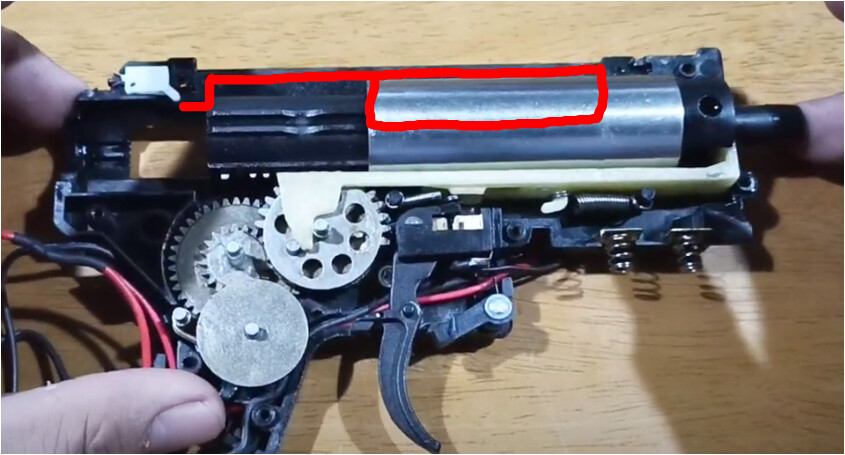

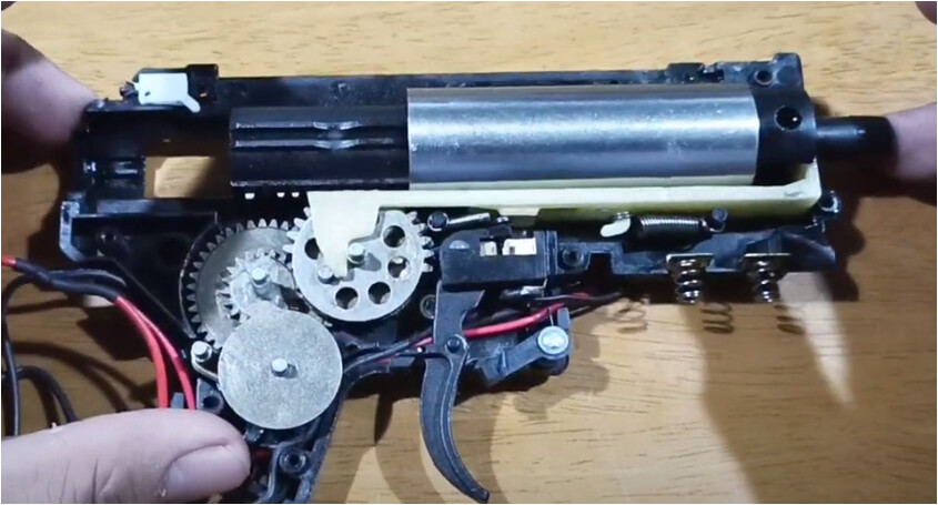

here’s the mag prime btw , and the gearbox opened ( credits to grimfoxyt channel )
what should i do now ?
1000006357
Thats the switch for the mag prime, there would have been a plate or something that sits in the track and pokes down behind the piston to act as the blowback, but that same plate is what the charging handle pulls on to press the mag prime switch, so if you’ve removed that plate completely there’s nothing to press the switch anymore to actively the priming.
You can grind off the tab that hits the piston to remove blowback without affecting the. Other functions but that’s a permanent fix.

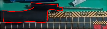

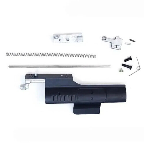

now , i need a blowback plate , so what’s the compatible blowback plate for this thing ?
the blowback’s something like this snip example
Couldn’t say what plate is used for that specific model, they’re kinda all different unfortunately.
The plate looks like sijun , will sijun fit this ? its an fjs m4 , fjs uses the same strategy as sijun according to akgelblaster , so atp i could maybe run sijun dust covers and sijun metal blowback in this thing , even the charging handles so similar
AKG would know more about those ones than me, I’d trust them if they say they’re compatible.
Charging handle are usually more specific to receivers rather than gearboxes.

You have all the parts already and anything aftermarket will likely not fit. It is delicate to get the blow back installed. Why like I originally said we get rid of them as we do high volume and that trinketry does not hold up.
Look at the parts you hopefully have still and take better pictures and we will try help.
Something about the charging handle went bye bye, well it won’t work without that nor will it with any aftermarket one,
Recommend not cross manufacturers as they differ greatly. To save you money.
