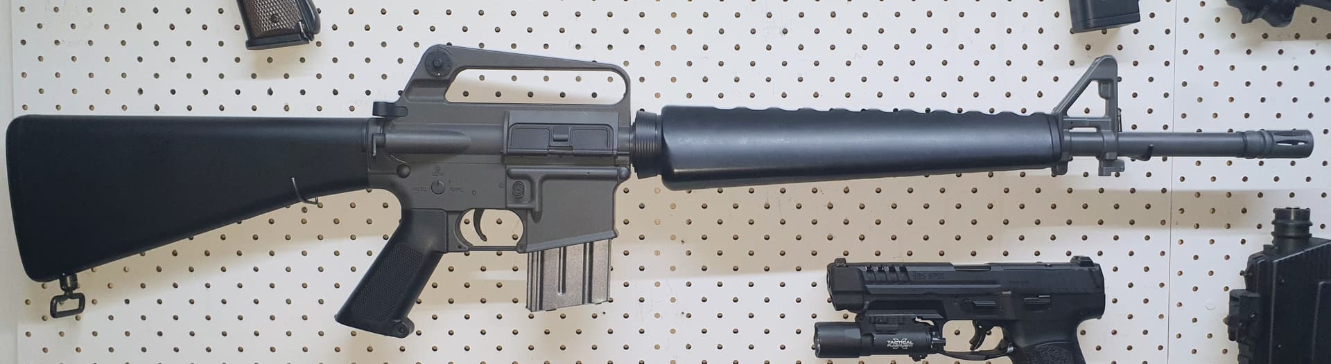

Put the XM-177 back into M16A1 config… how many short arse blasters does a guy need, after all?

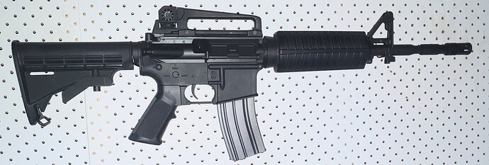

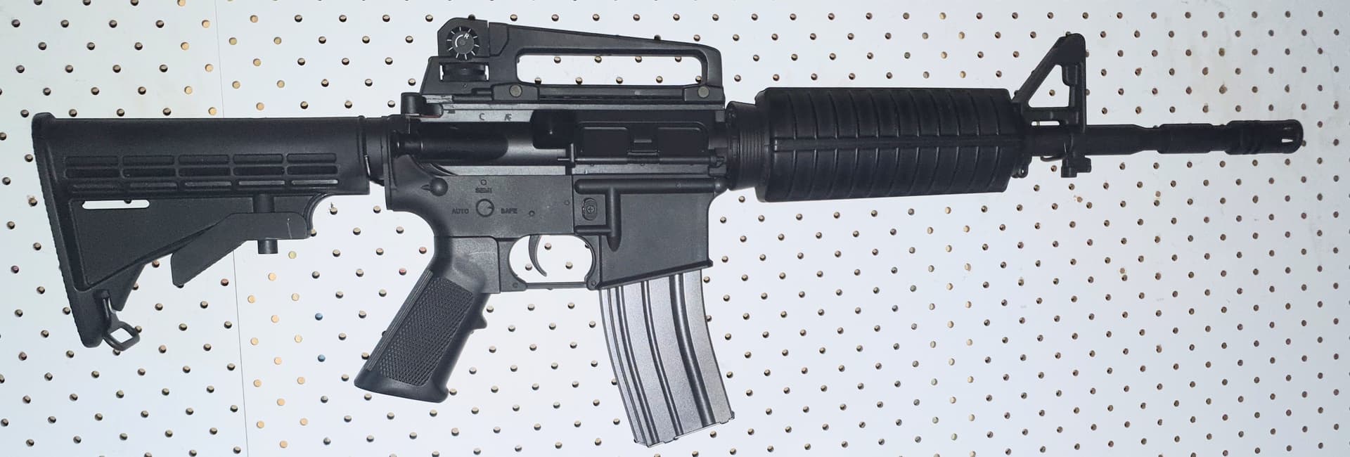

Then I settled on a solid polymer handguard rather than the alloy fishbone for the CYMA M4… I blame @Wombat for planting that seed. :wink: Looks good in Colt M4A1 carbine trim though… like a high quality Gen 9. :+1:
