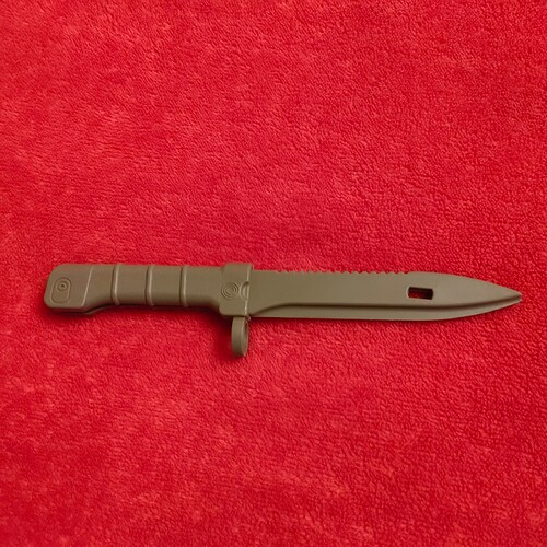

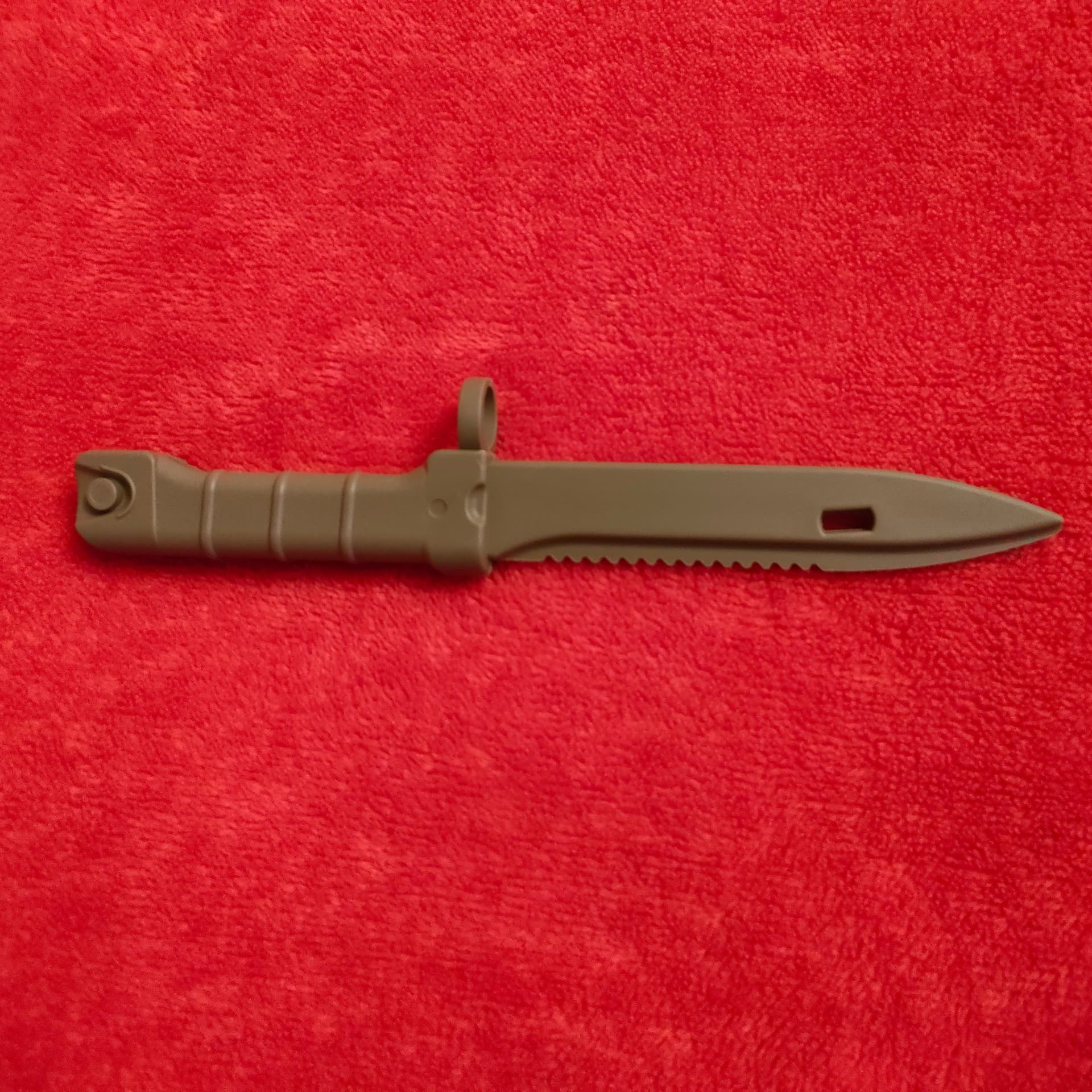

Wondering what the best paint to use on this rubber ak47 bayonet :thinking:
Tamiya silver or gunmetal on the blade, black or brown on the haft.

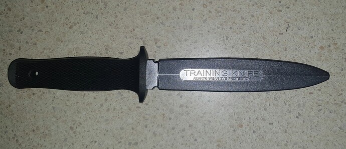

I’ve got a cold steel training knife, went with gunmetal on the blade. It’s polyproylene, not rubber but Tamiya should stick to yours okay. :+1:
:thinking: mine don’t have ā€œtrainingā€ imprinted on it :rofl: :v:
Good to see it came through @shadow187 thought that should work, :wink: :+1:
I’m just happy to see that you took my advice and was able to import this cool bit of kit for your young fella! :sunglasses:

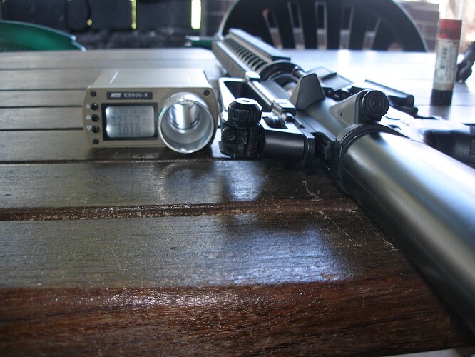

I beat ya with a 20" barrel and an APS back when I was allowed to test in my backyard. :rofl:
Finally got time to dig old photos up.
Wells V2 alloy cylinder head, 1.18mm AG sproing, SHS piston, POM piston head, pretty standard nato and accurate. 7.3mm ID SS IB. Non ported 72mm cylinder. APS V2 gearbox still in one piece :joy:
321… that’s choochin’ nicely. :+1:

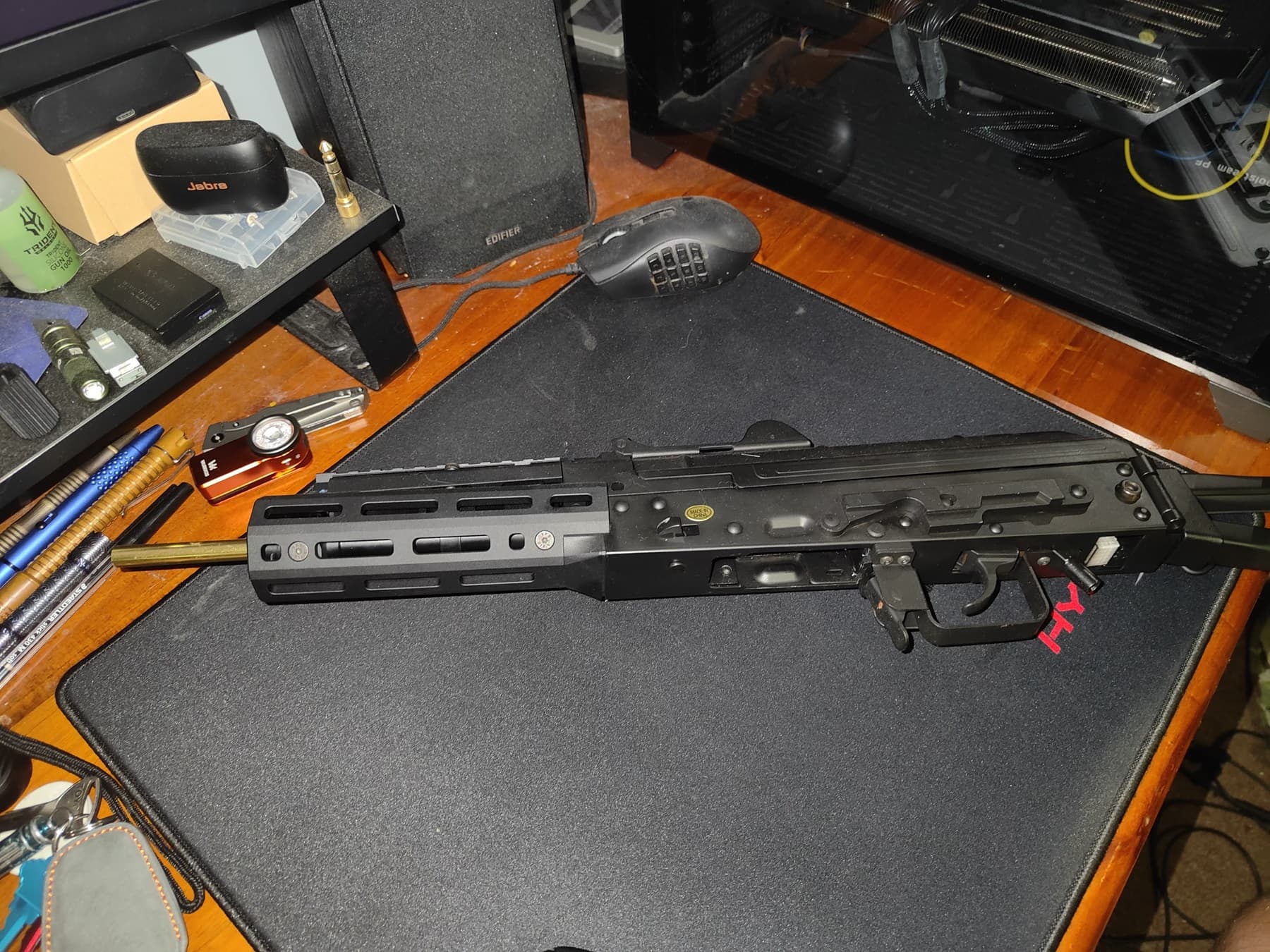

got a wells ak74u and a bunch of parts for it but kinda gave up when it wasnt a bolt on operation.
handguard doesnt fit ill need to file down quite a bit.
this would be fine on its own but the front sight post doesn’t fit either so ive got to figure out how to get that to bind well enough without drooping the barrel (ive got a pbs-1 to fit onto it and it goes onto the front sight post threads). im really not sure what to do next hence the 2 months just sitting on it.
Hmm is that the GBB C02/green gas one?
Seems like a lot of custom work would need to be done to get it complete.
Weren’t exactly cheap either.
Is back to original an option rather than going the full custom mod work if you want it usable :man_shrugging:

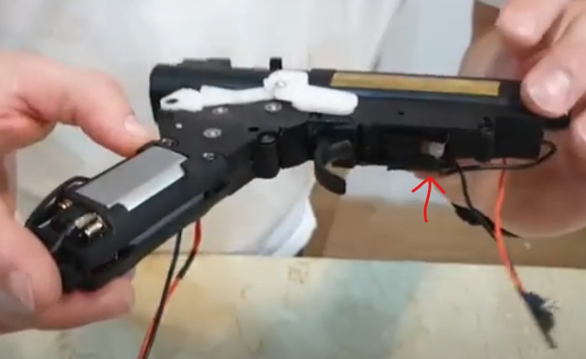

Time for a new J12 gearbox. The brass plate that provides power to the mag has split so no power to the contacts. Guess I’ll have a bunch of J12 gearbox parts and more ideas than talent
Shame you can’t buy that terminal plate as a spare part. :person_shrugging:
Plenty of the early J11s with the old spring terminals could do with them.
Can you not get positive battery terminals and just cut them down to fit? Or replace them with the spring ones?
Actually how would you manage to crack one of those to begin with?
There is a brass tab that sits in the gearbox where the mag contacts would be on a v2 gearbox. The earth wire is soldered to that and that wire runs runs to the terminal plate. Looks like the brass plate has work hardened and the end where the wire is soldered (see arrow) has snapped off
Oh the bit attached to the trigger switch, I thought it was the actual mag terminal.
