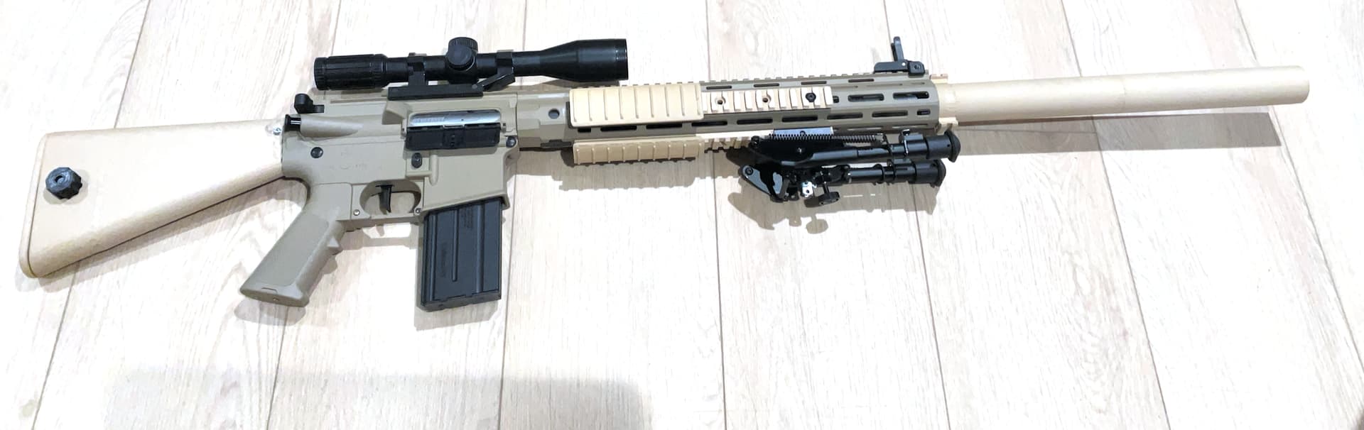

Its been a minute since I posted on this forum, but I just wanted to post the final product of my M110 SASS.
Shooting pretty hot at about 450 fps on semi (I don’t use full auto since its a DMR), has about a 1-2 foot grouping at 200 feet. I decided to use a metal UBAND hopup, since it worked the best with this build. If you didn’t know already, this used to be a Bohan Ar16. I tested about 5 different more popular hardened gel balls, but somehow the cheap Amazon gells that you get with a stock gel blaster (100k for $20.00 CA) were the most accurate…(and i have no fcking idea how :dotted_line_face: :face_in_clouds: :nauseated_face:). They somehow have insane accuracy and range (as I said before, a 1-2 foot grouping of 10 gells at 200ft).
At 200 feet :thinking: guess my foot is bigger than yours :joy:
Yeah I really had to double check it myself :sweat_smile: however there was virtually no wind that day so it definitely helped :grin:
So that is AS as gelballs wouldn’t go that far. Sorry you were not specific in your post. All good my friend :+1:

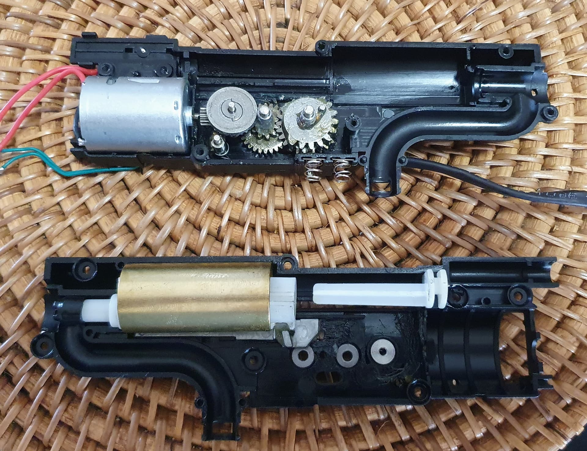

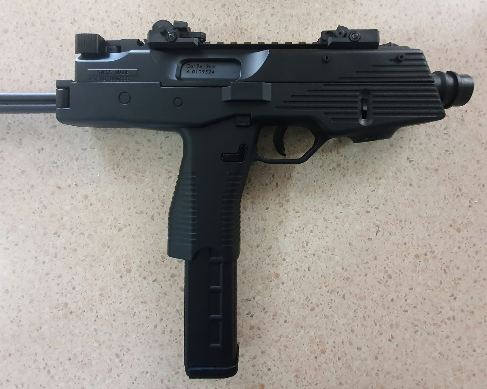

Intetesting day on the Le Hui MP9…
Keen to up the FPS on these… I have two, one full tactical and one in B&T pistol trim. The pistol is the guinea pig.

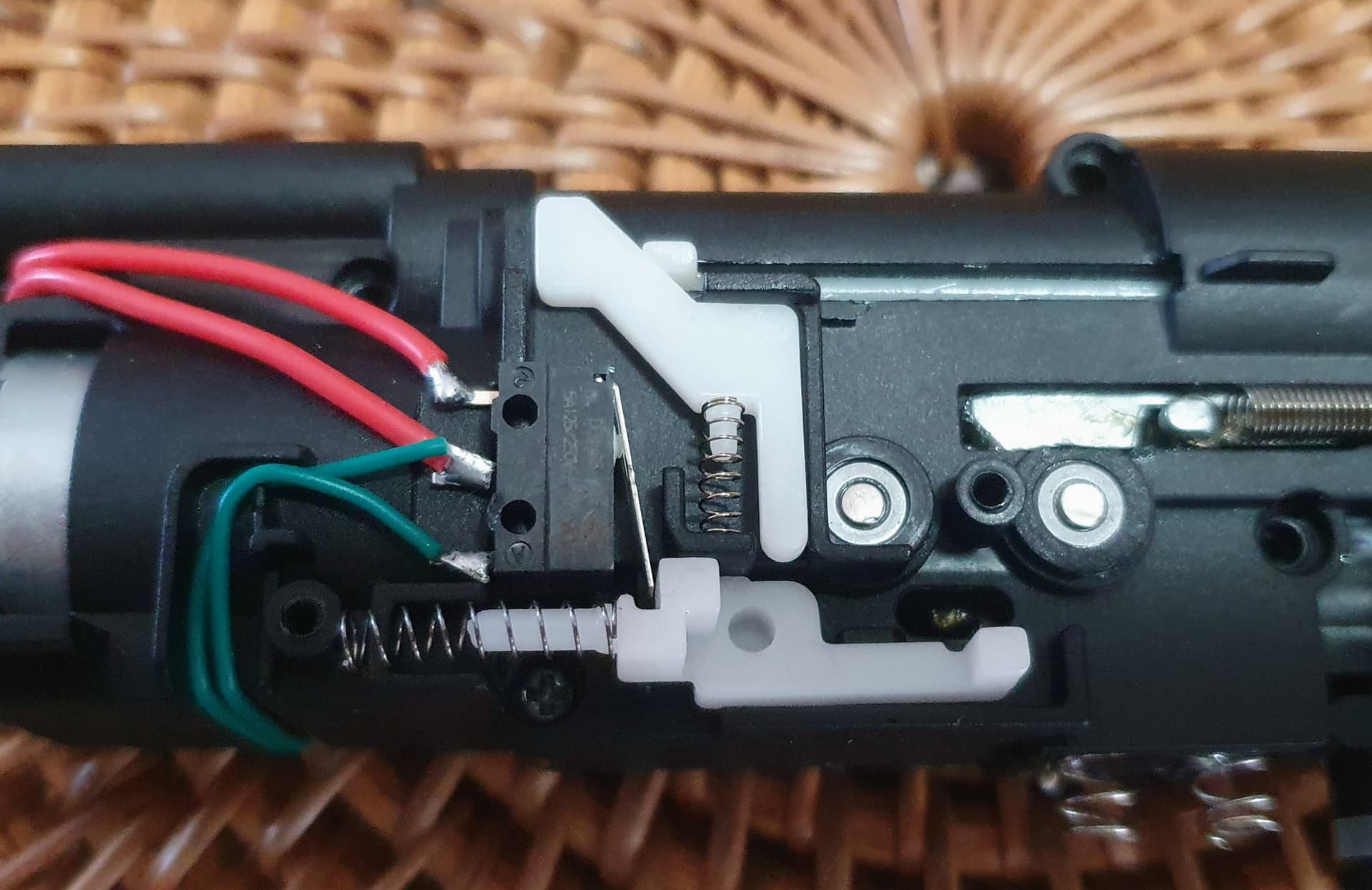

Very proprietry gearbox, lots of little parts and springs to go boing on disassembly… and wires routed around the shell which need watching. I would say not for the fainthearted, requires a fair bit of nouse and patience.
Once it’s apart it’s just another inline box however. Lack of quick change spring release is a pain, although the retainer does locate fairly positively in the shell… and reassembly is frustrating with the a/r latch to keep engaged and the cylinder wanting to pop out under piston spring tension, but not impossible. Went back together with a lot of swearing and very surprised to see metal gears in it, bodes well for FPS upgrades.
Short version of the mod, a very conservative spacer of about 10mm on the piston spring resulted in a gain of about 20-30FPS, was sitting around 170-180, is now hitting around 200FPS depending on the gel. A heavier spring transplant isn’t really viable, being a proprietry 9.5mm OD spring.
The upside to that 9.5 OD spring is that short lengths of 9.5mm inner barrel are perfect as a spacer on the spring retainer with no binding or interference issues at all.
Compression was ordinary with the factory o ring and standard AEG o rings are too large, so some investigation on my part needed there.
Next job is to upgrade my primary MP9 with a 20mm spacer… the goal is to get it up around 220FPS or more, a decent enough amount of power from such a short barrelled unit, hopefully should be acheivable.
Might post more detailed photos on the teardown of unit 2 if anyone’s interested. :person_shrugging:
New custom o ring and spring spacer… getting there.

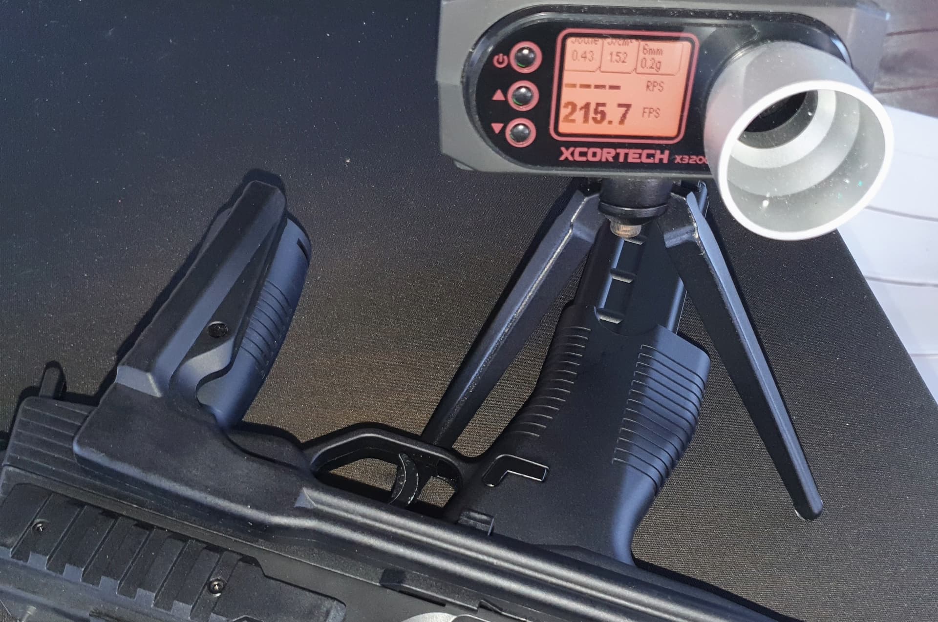

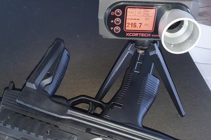

Still some work to do, but that’s a gain of 35FPS. :+1:
@RokSolid no need for you to make time in your hectic schedule for this one, matey. :wink: I faced down my fear of the MP9 gearbox and conquered that sucker. :laughing:
That is a cute little gearbox! Well done mate. I would say 215fps from such a small platform is a good effort, and enough a boost to get it above the hopper fed kids blasters!
There really is almost nothing in that that isn’t proprietary!
Yeah, it’s basically a pistol gearbox in an SMG platform. :blush:
You should see the porting on the piston head! :laughing:
The replacement o ring I had to make from a standard o ring, nothing like it in my kit.
I’m tearing it down again in an effort to improve airseal and try out a few other ideas, I’ll see if I can get a photo of it.
The thing pretty much just an inline box and, like most boxes, once it’s been apart and together again you learn the sequences and it gets easy. :+1:
Just a pain having to juggle the a/r latch and the cylinder under tension while you pop the shell together…

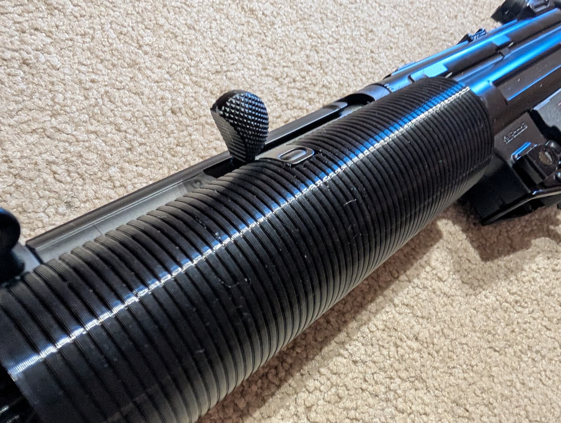

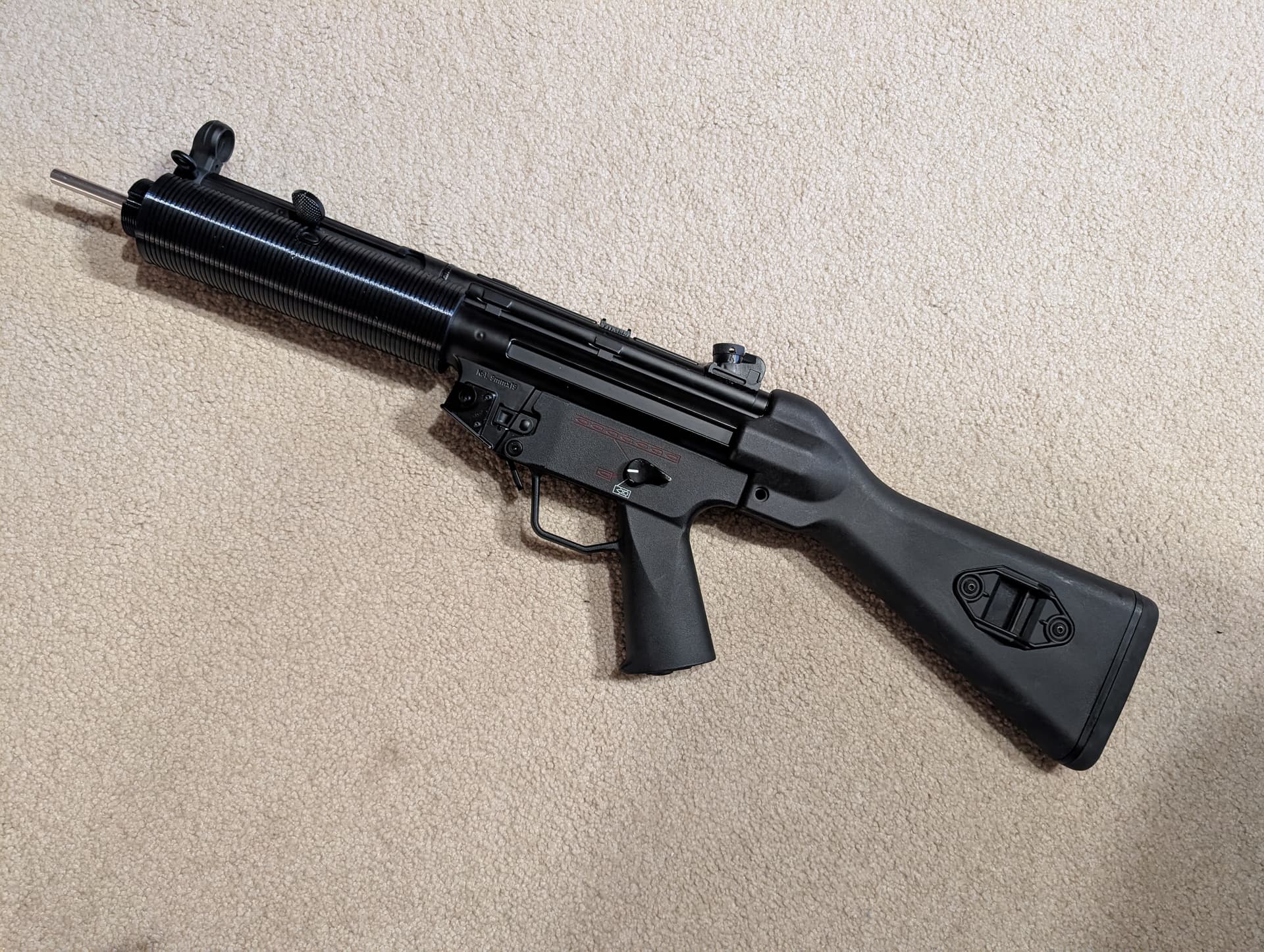

My 3d printer has been busy… I’ve spent a couple minutes a week modelling and finally printed a SD6 handguard for the parts of shell I received from you… need length of the can and then at some point I might have to buy one of my LDXs for it… low priority but… something I will need to finish at some point!
Printed handguard is reasonably accurate enough… fits really well and isn’t that weird rubber that may deteriorate. PETG for the win.

The handguard looks good.!
Interesting texture.
The rubber one are Soooo much better, when painted, and covered with a clear coat.
No exposed rubber to the air…which will go funny.
Feels " sealed and solid", not sticky , to the touch…
