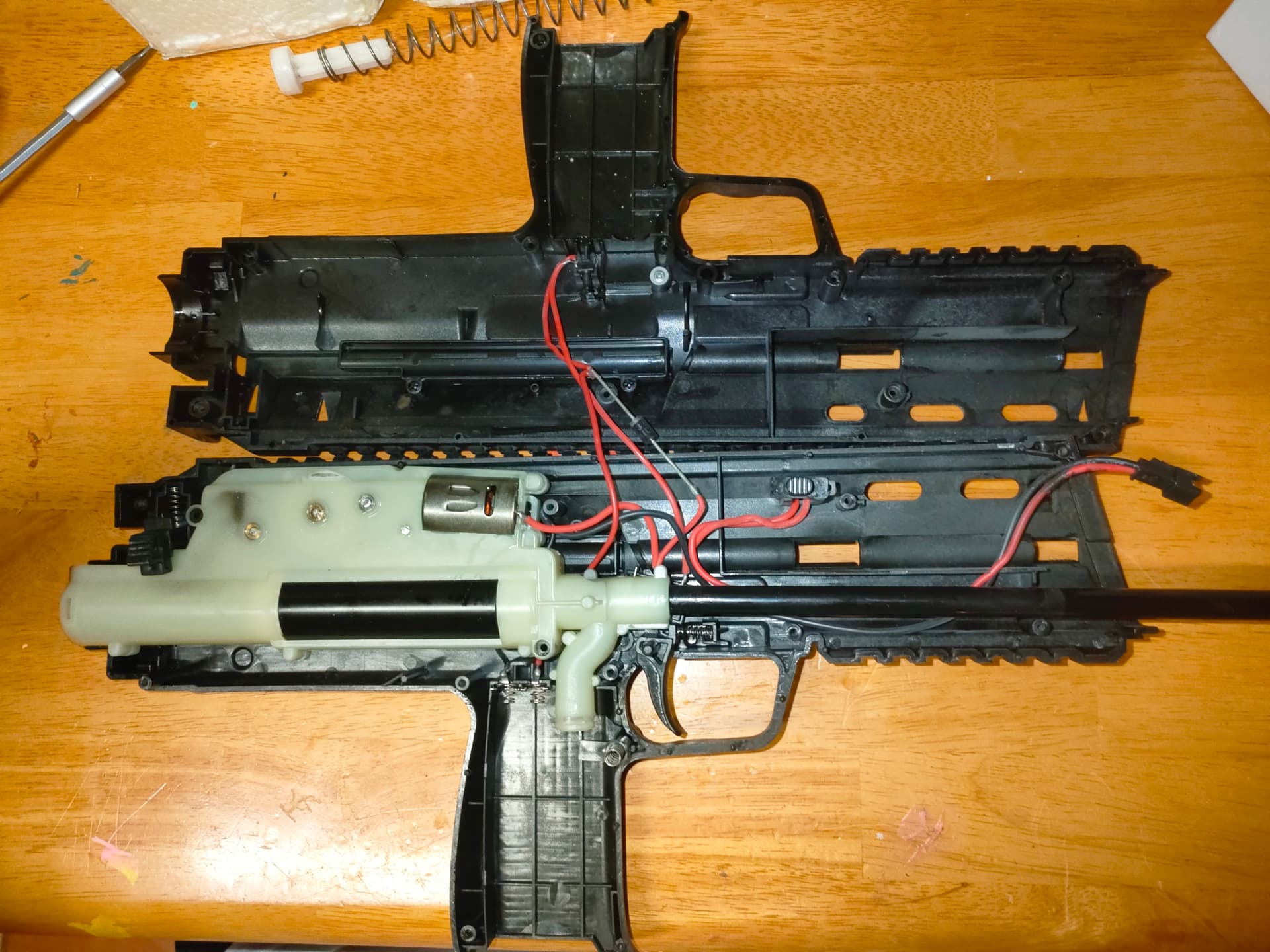

Green oring, mild spring and ported cylinder. Dont recommend going to nuts on them as gears are basically unobtainable these days. Entire gearboxes still exist I believe.
Yeah I’m pretty sure I seen some gearboxes for them on AliExpress
The standard spring in its about the same length as the m97 shotty but it’s a bit thicker, would you suggest m90 at most? Not sure I’ve seen anything smaller available in my spring search travels
Definitely m90 at most. Even m85 or m80, or a spring or of a stock blaster that is a little bigger than the mp7s if you have one.
Fortunately the spring is really accessible on these

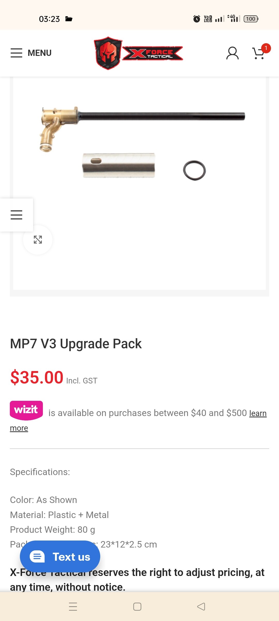

Good news is x-force has V3 gearboxes available for $40
Edit: no they dont, I think vipertac does, nope but they have metal gears for unspecified brand mp7

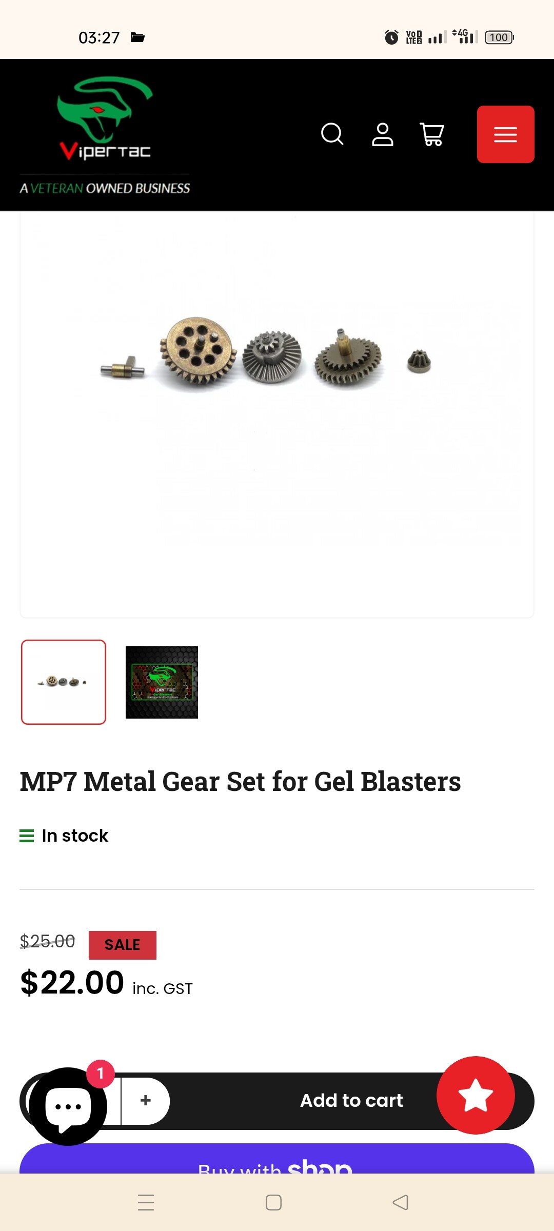

This will make life easier
Not sure if these are the right metal gears tho

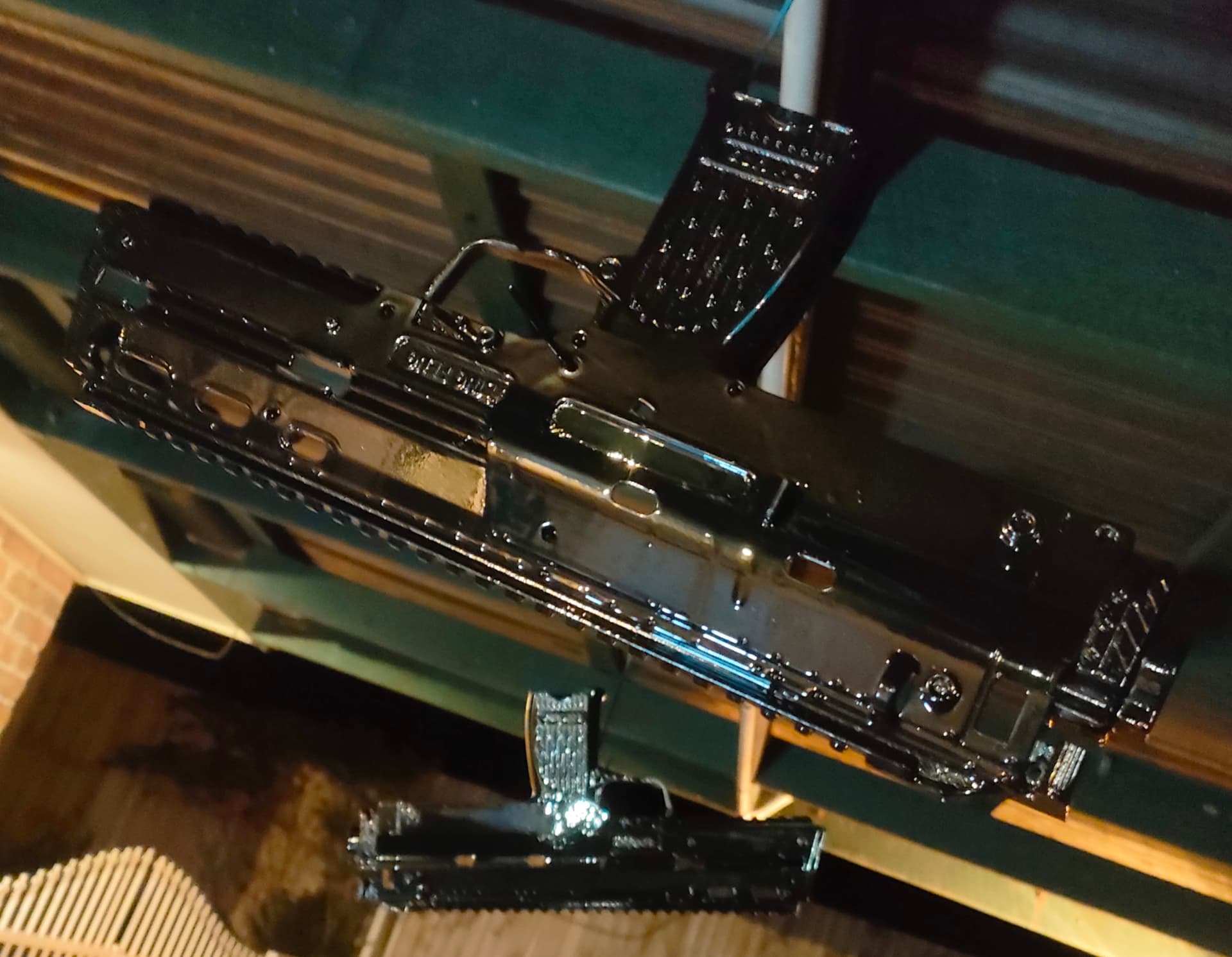

Yeah, like Beemer said, just paint over it, it’ll be fine. :+1:
I think I’ll leave the painting to beemer :face_with_symbols_over_mouth:
Stay away from “white knight - squirts” spray paint
They don’t call it squirts for nothing :roll_eyes:

Check out the spray can itself about what type of product is used for “clean-up”.
Is it Nylon or ABS plastic?
The sooner you can remove it after application, the better chance of getting it all off.:+1:
It’s made of ABS and cleanup says turps but I don’t have any and Bunnings will be closed by the time I get there unfortunately
Might just be stuck with it :sweat_smile:
That consistency looks like black honey…!!
It’s not a mistake…it’s a learning experience…!!
Trust me…I’ve done lots of learning…!!
Some spray brands are better than others…
Rustoleum is okay…but goes on a bit thick…and can splatter occasionally.
Honestly, I’ve found tamiya the best…
It doesn’t spit or bubble, light fine application, and good adhesion.
Yes, it’s smaller and expensive…but you don’t need much to paint a blaster.
If you try other brands, try them out on a spare sample first…flat bit of wood, old pvc pipe…get a feel of how it sprays, before you apply…
