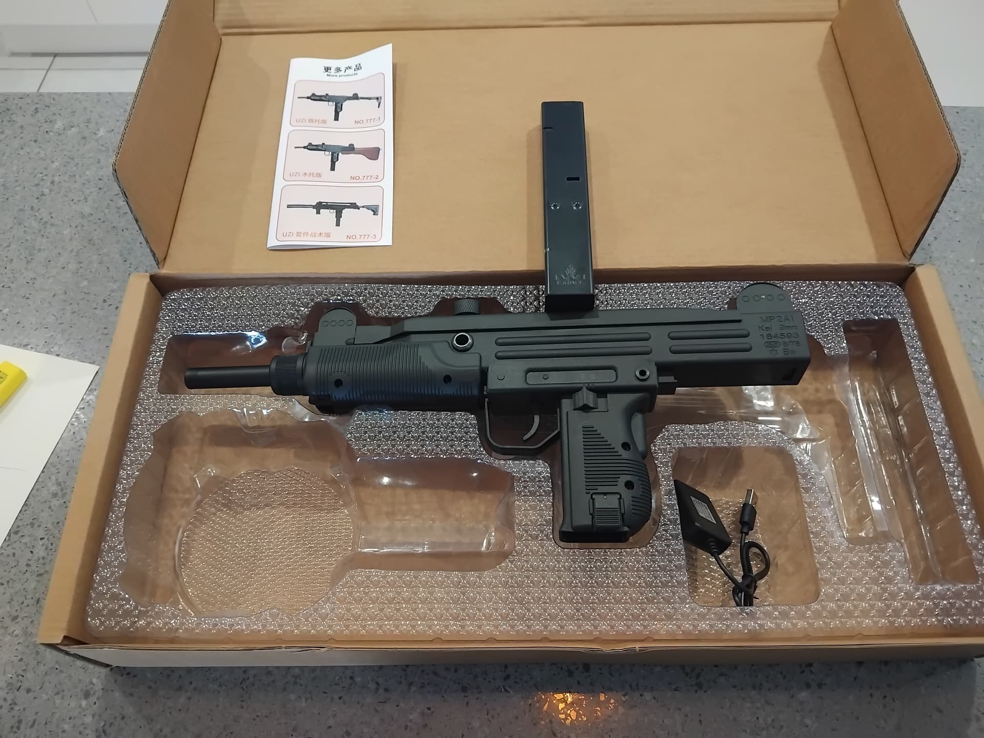

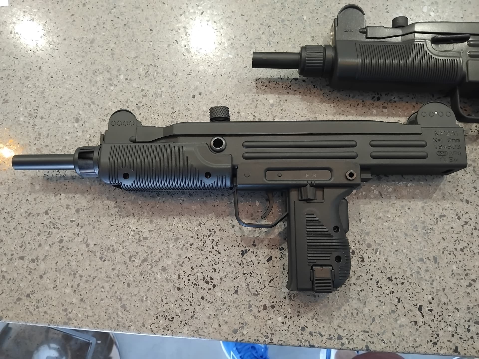

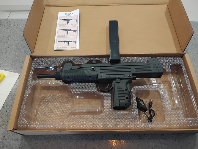

This is what you get… ( battery installed)

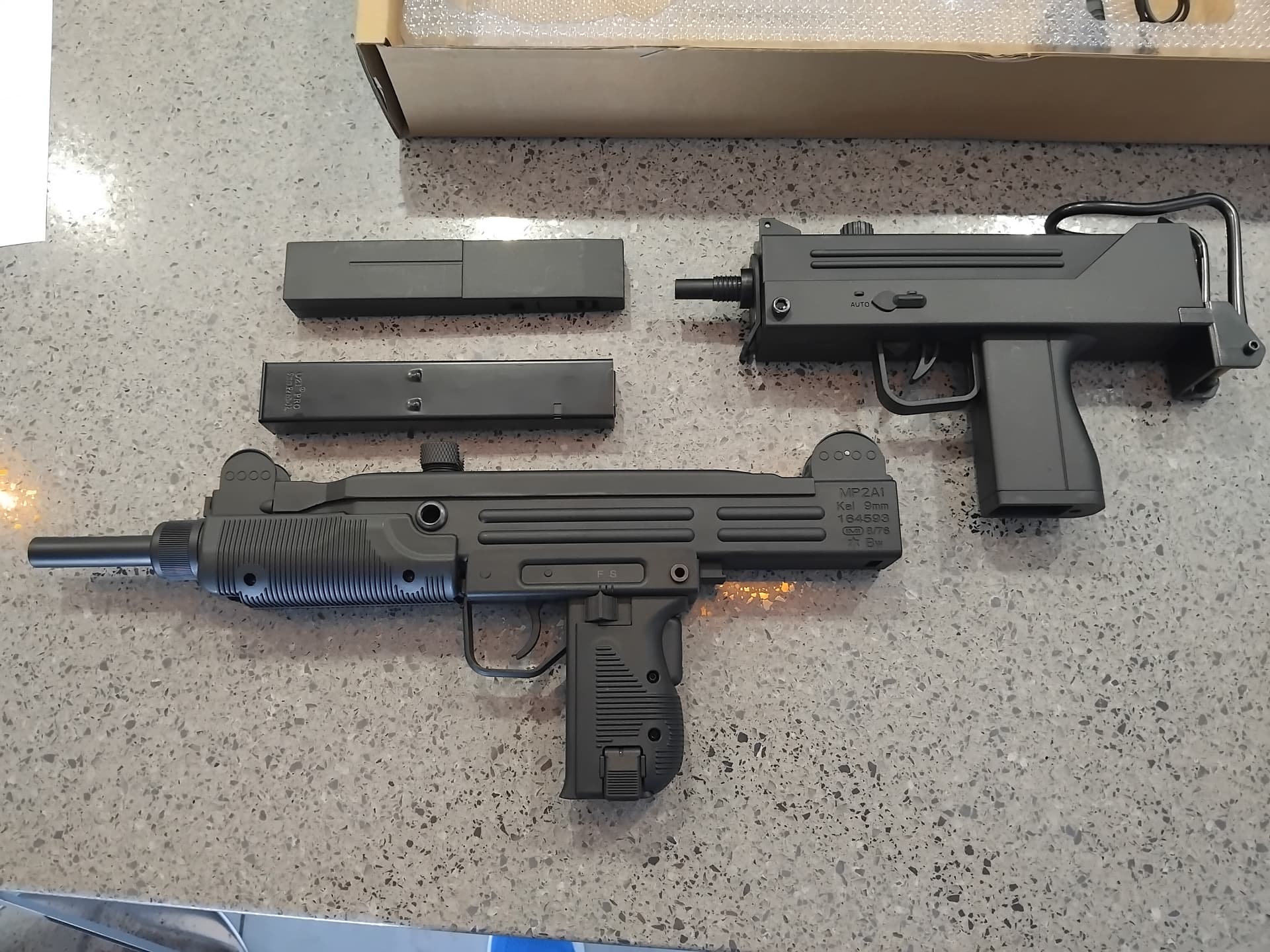

Before we go any further, a quick comparo, of the Mac-10…
Very similar build and price point…and the Mac-10 includes a drum…
The build quality is quite good, with a very sturdy feel in the hand.
The upper battery cover is metal, and the rest of the blaster is nylon.
Features and details are quite good, with pronounced markings.

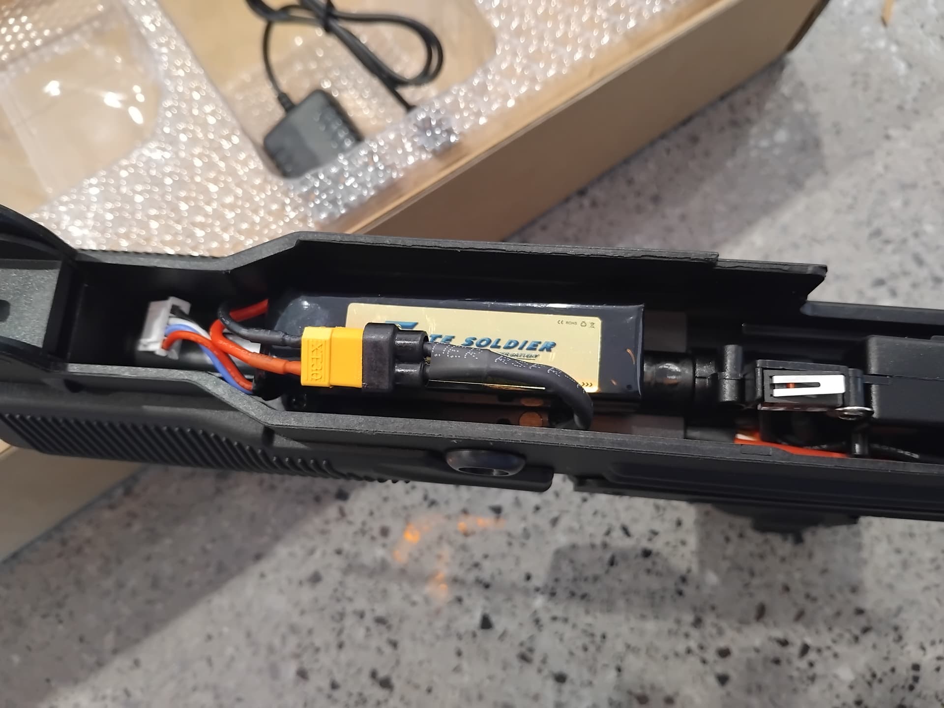

The included battery is XT30, 11v. That gives a ROF of about 1100 r/min… abit high for an uzi.
I’d be using a 7.4 for closer to the standard 600 R/min of an UZi…

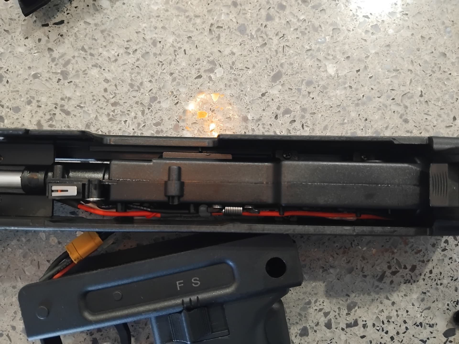

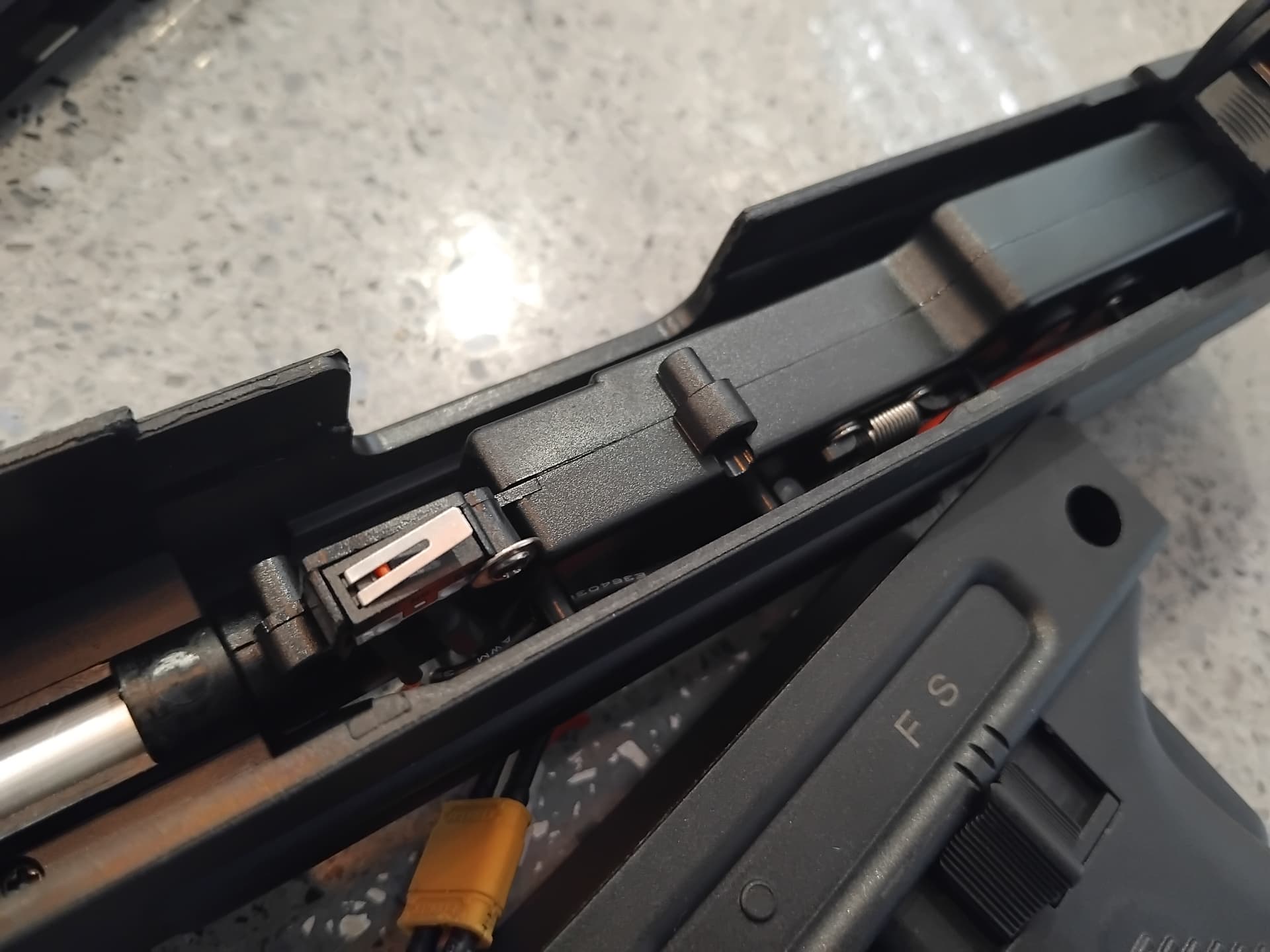

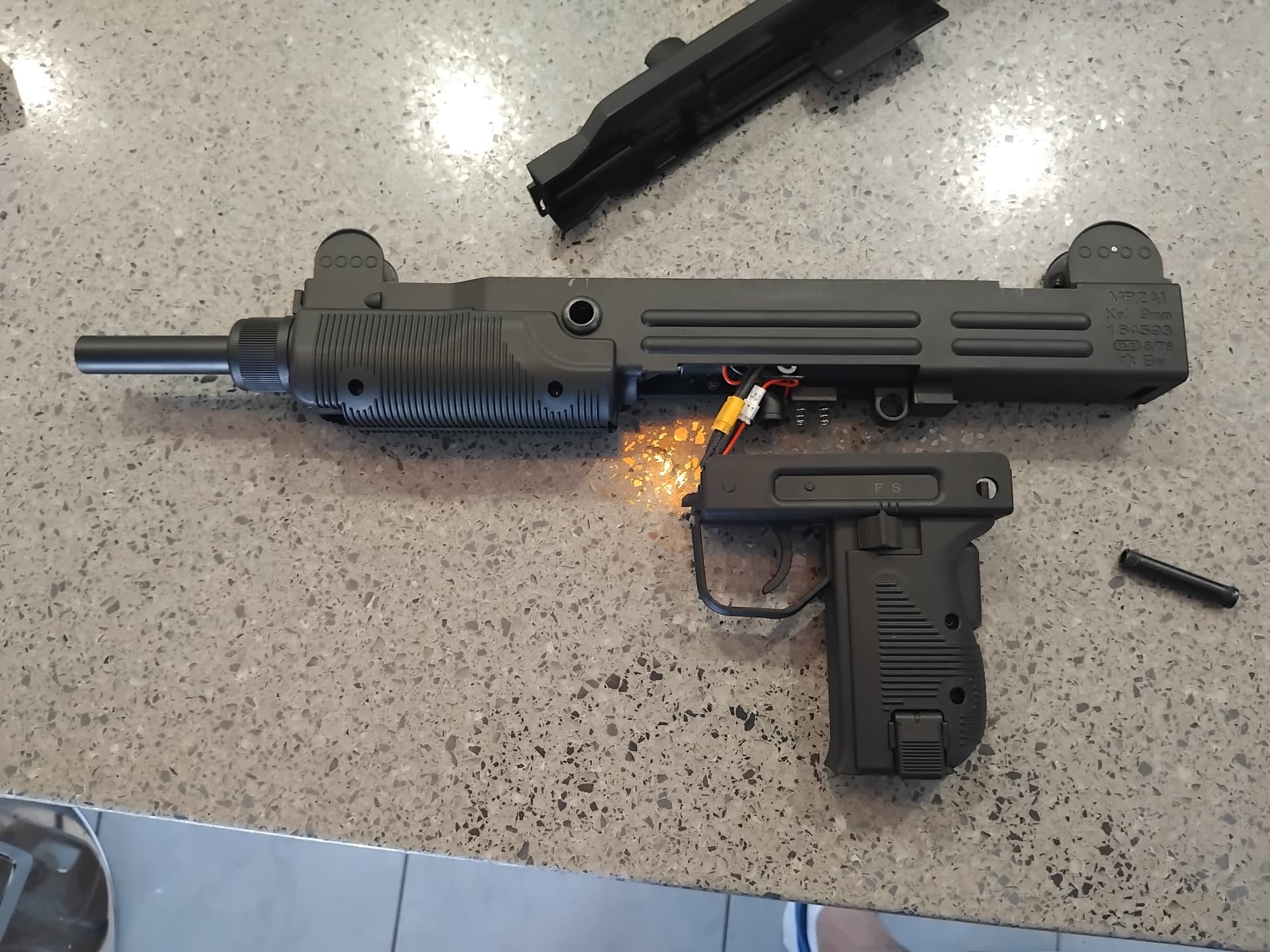

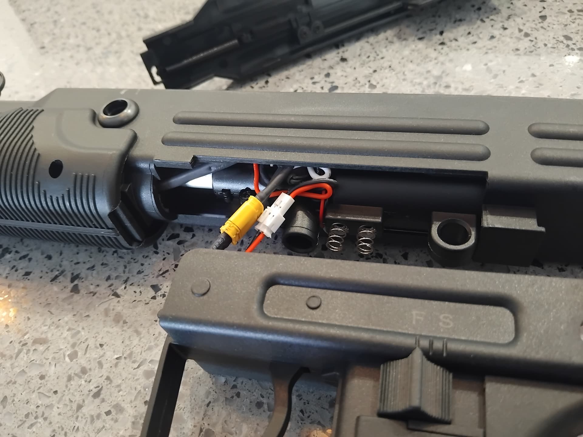

Quick partial tear down.
Easy to do, with the top cover coming off easily, then the rear pin coming out easily.
Quick disconnect plugs, for the electrics…
Mag prime on top.
Proprietry inline gearbox…

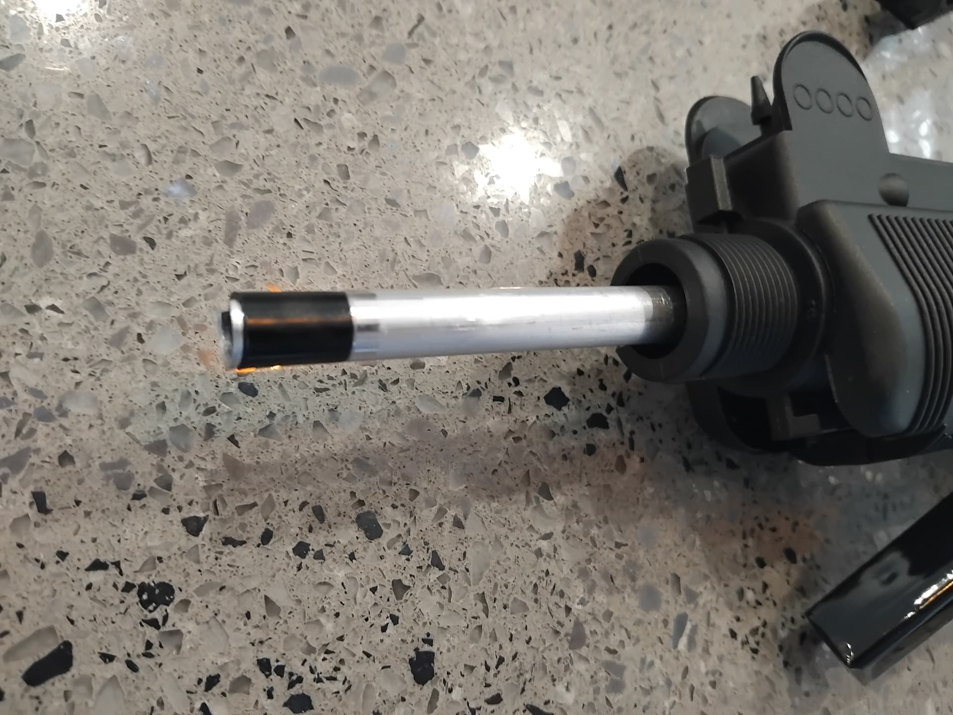

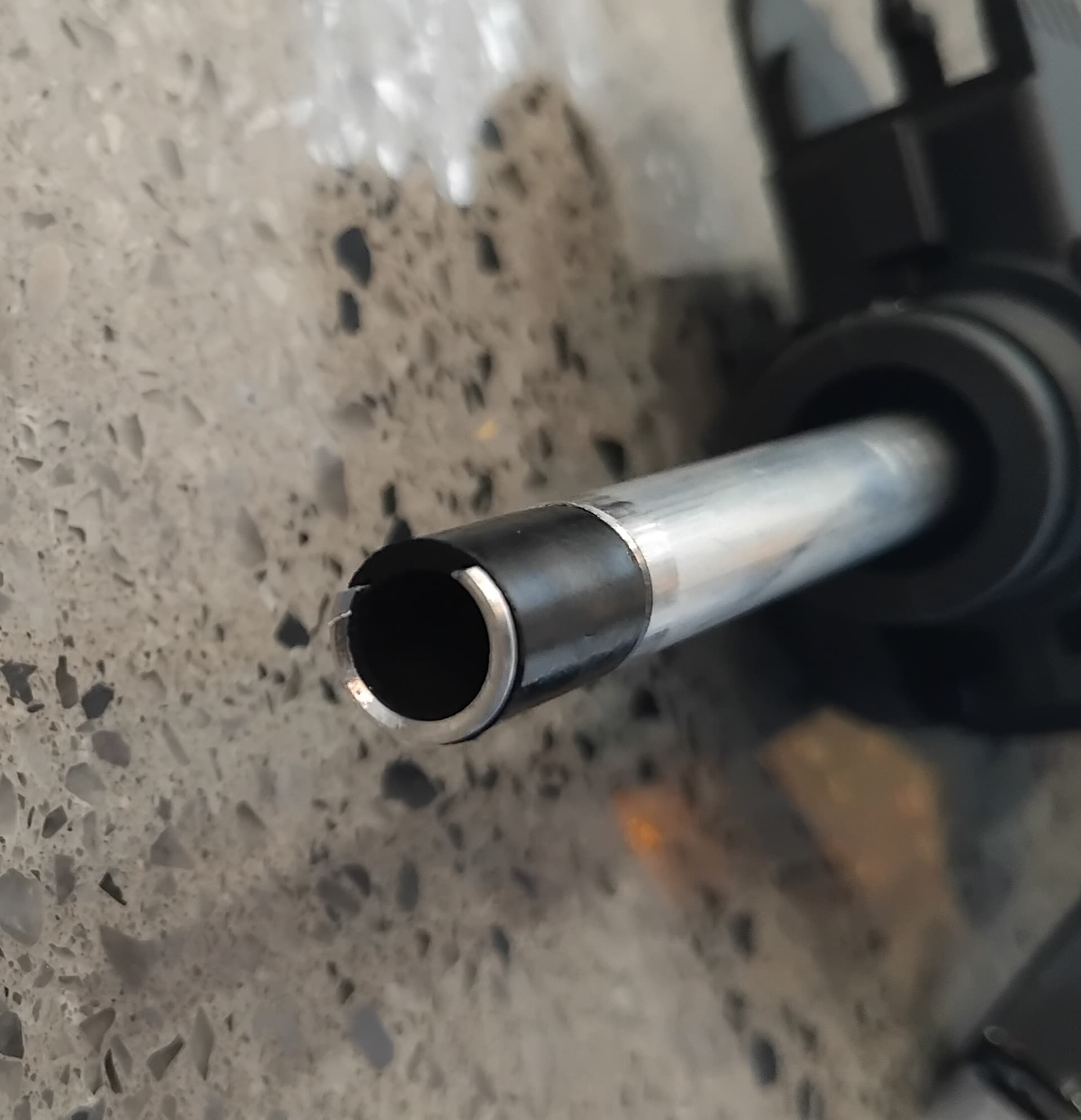

The barrel has a inbuilt “hop up” of sorts…
It seems the rubber on top gets compressed, and gently puts some pressure on top of the gels…
It would also help stabilise the inner barrel… it is quite accurate over the shorter distances…

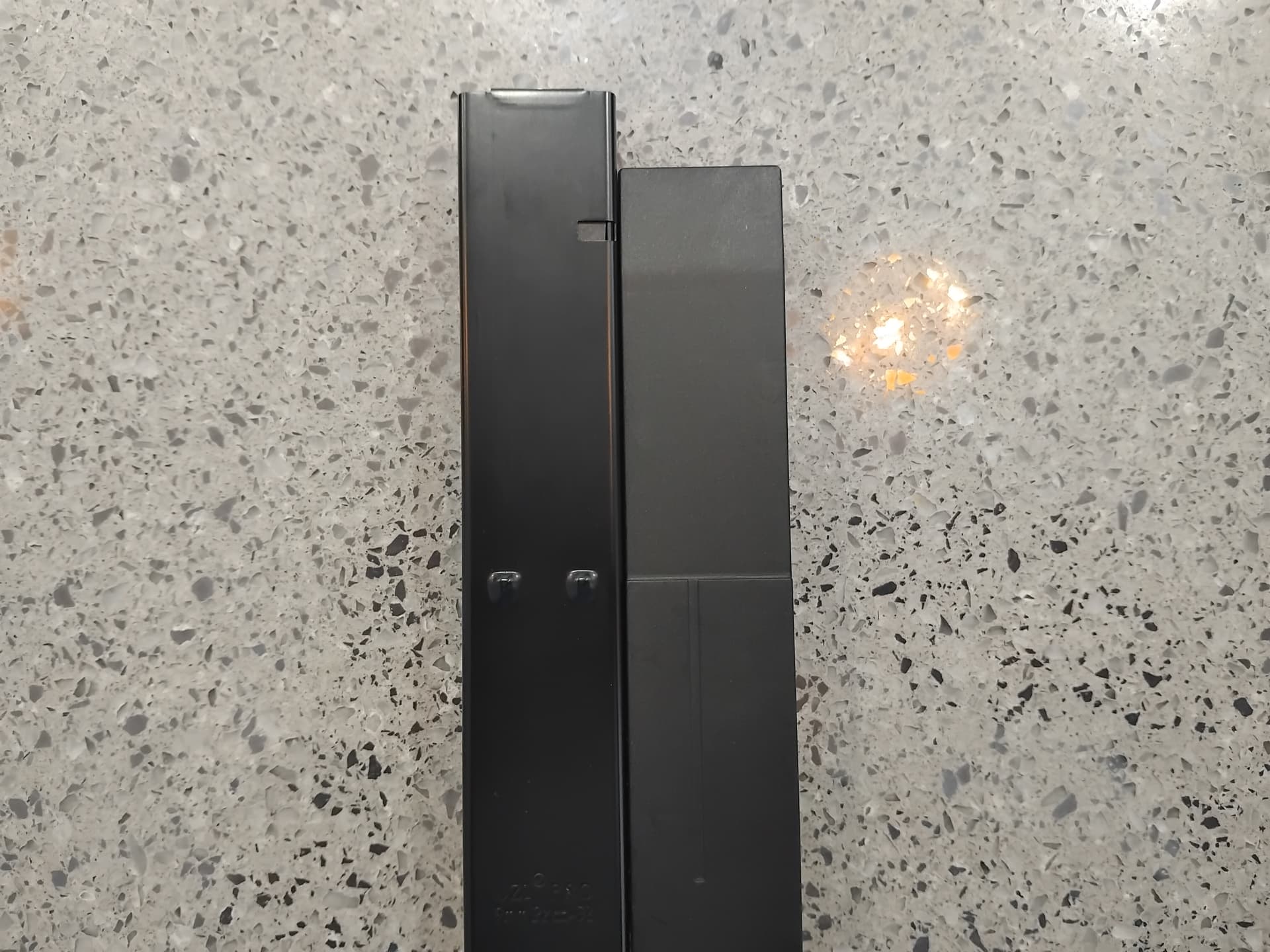

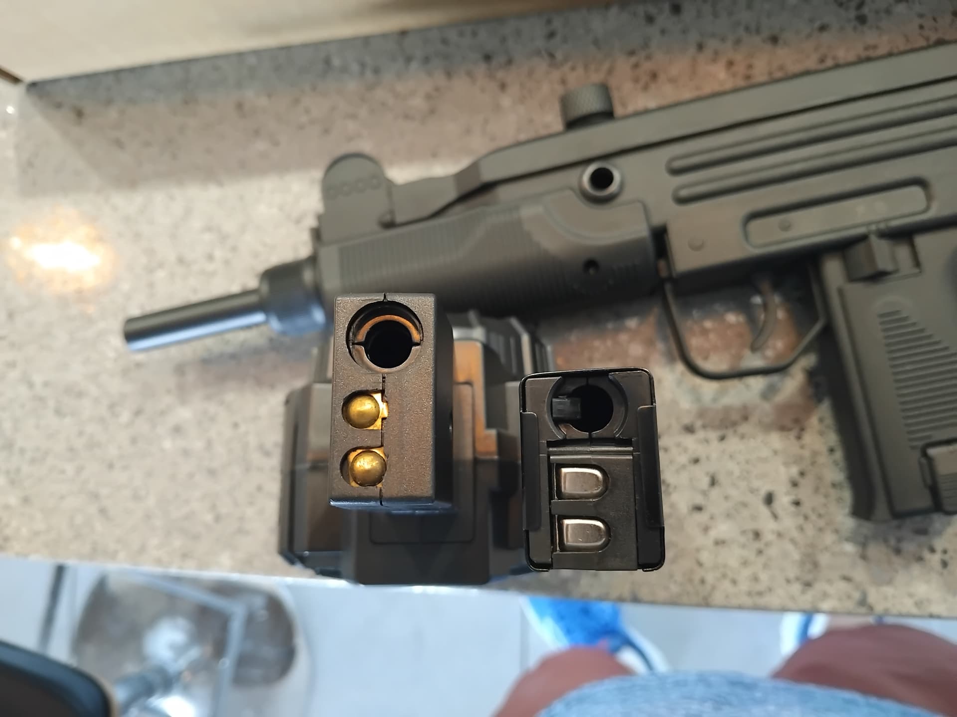

The stick mag is metal, and well made.

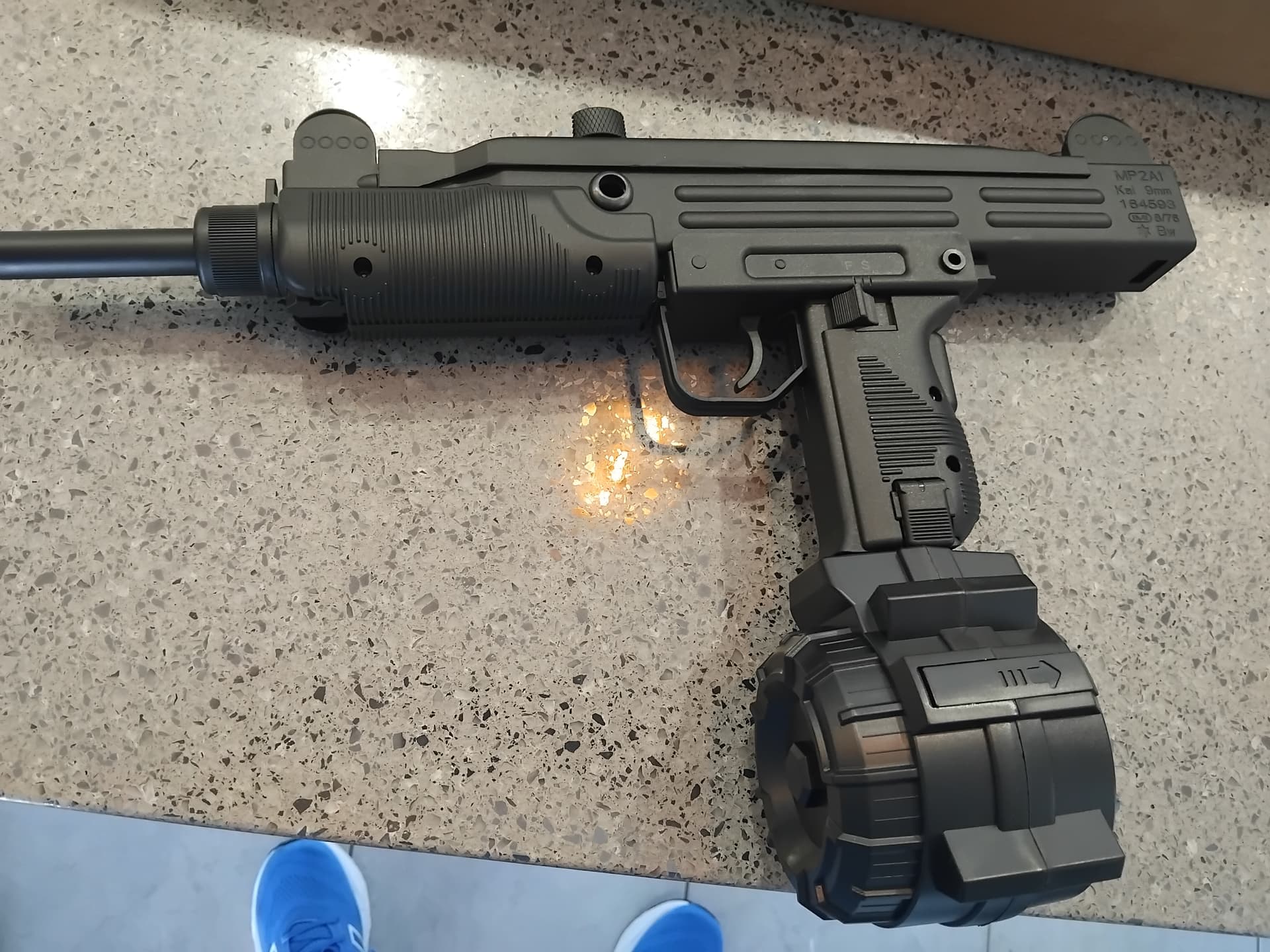

Out of interest, the Mac -10 mags do fit in the grip quite snugly…and have similar top contacts… they just don t reach… UZI on left…
MAC 10 drum mag…
Similar top contacts…

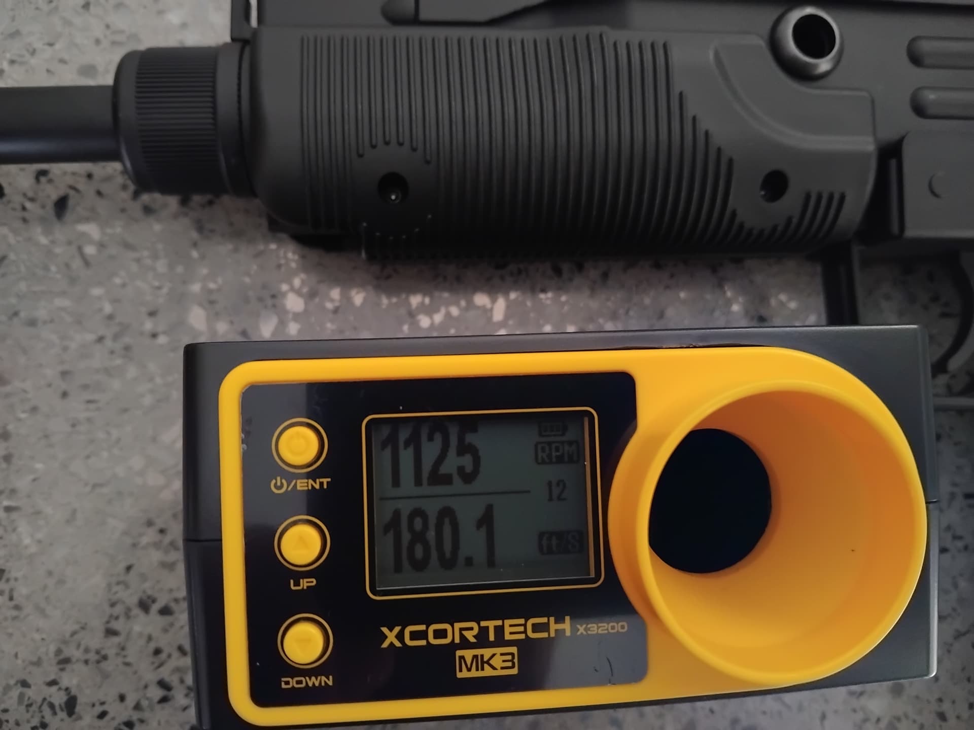

So…how does it go.?.?

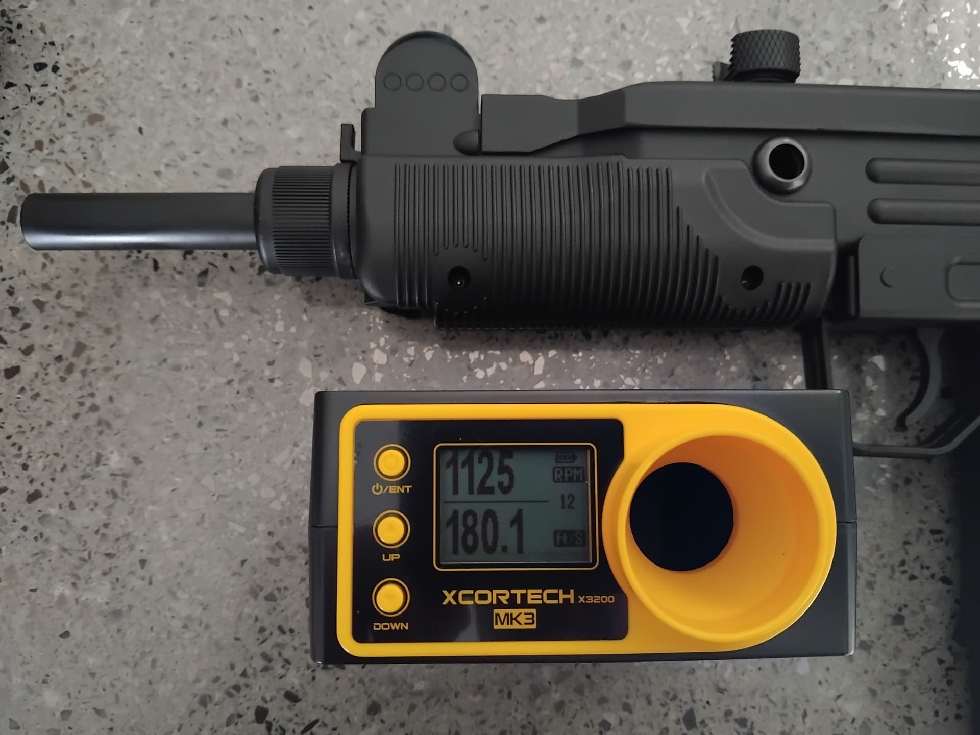

Well, so far ive tried my old crowd favorites… xforce pink, and i hobby blues.’
around 190 fps, at 1100 r/min…
That was a quick burst, with some older gels, but gives you an idea.
I saw a range of 180-200, but around 190 is a fair average so far.
Limited upgrade potential, but some gains can be made im sure.
And, maybe other gels perform better.

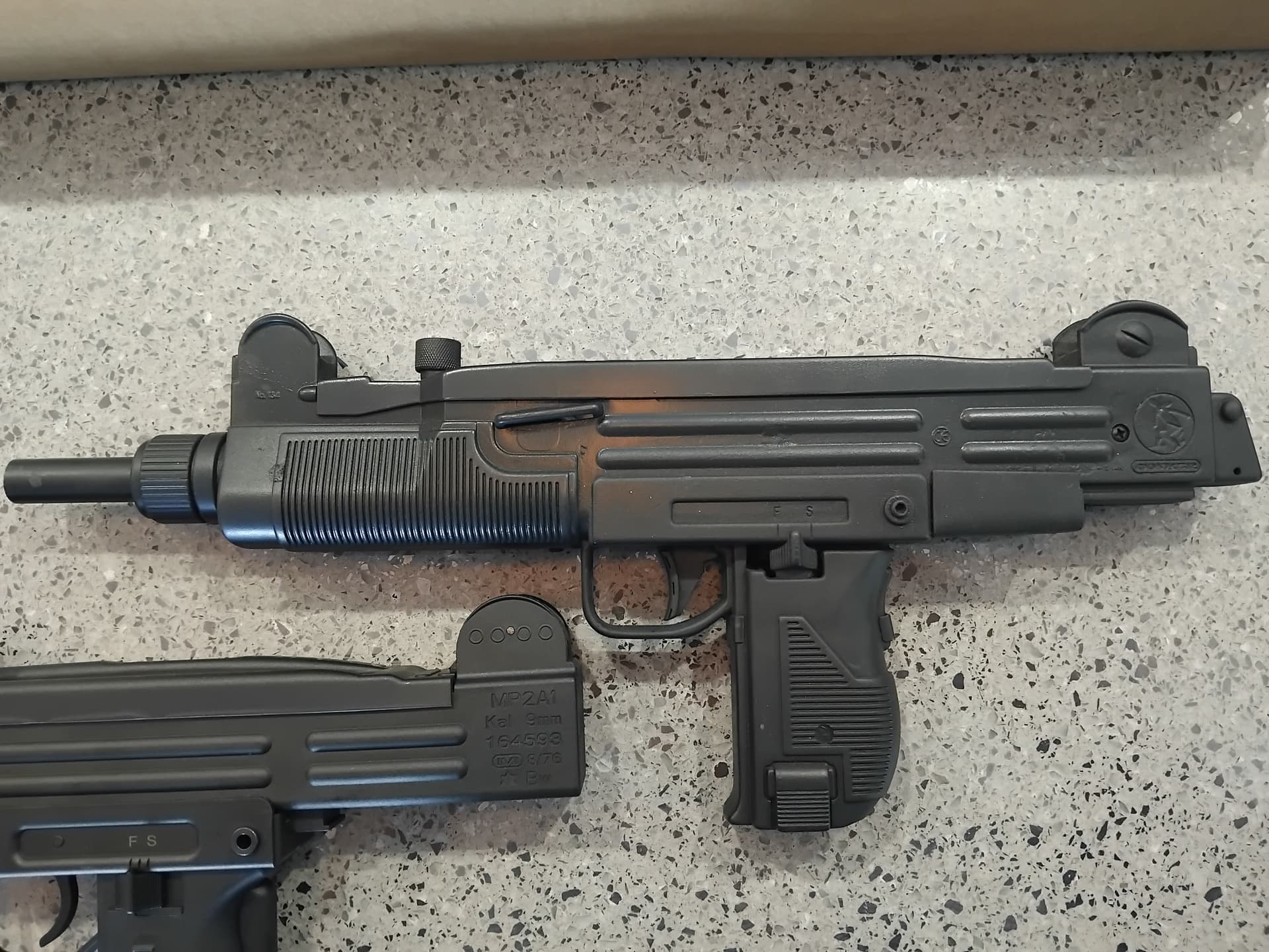

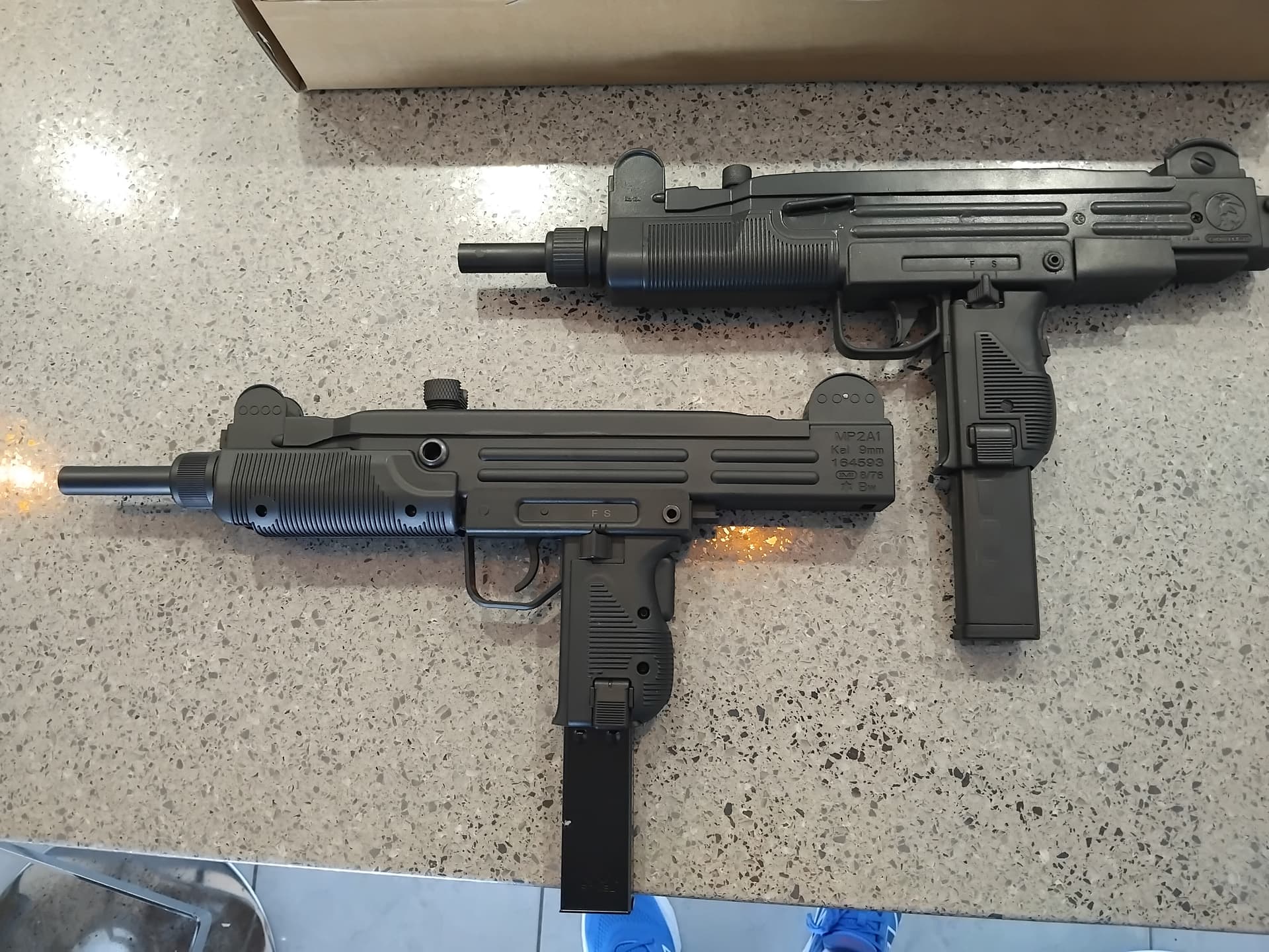

Finally…comparing to @Friendly_Fire 's masterpiece…
The real uzi is all metal, so F/Fires has the edge there.
It also has way fewer of the screw holes holding the nylon blaster together, so looks cleaner…particularly on the foregrip.
The newer blaster has the edge on performance…maybe the boxes can be swapped.?.? :rofl: :rofl: :rofl:
( I can hear the swearing from here…!)
All in all, F/Fires piece is still very much a valued part of the collection.
All metal , with fewer holes , is a big win.!

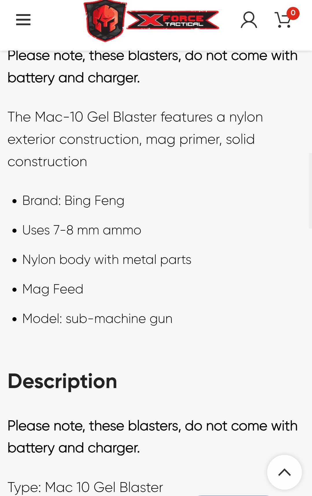

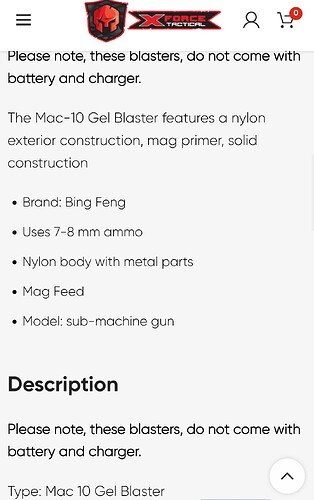

Thats why i included the Mac-10 for comparison…
Similar size / build…
Xforce still sell the Mac-10 , for $155…

this is the correct way, to lay the battery…
It is tight in there… lay it on the side, and it interferes with the charging handle opening / closing.
Here, it cycles nicely…
Without a battery, charger or drum mag

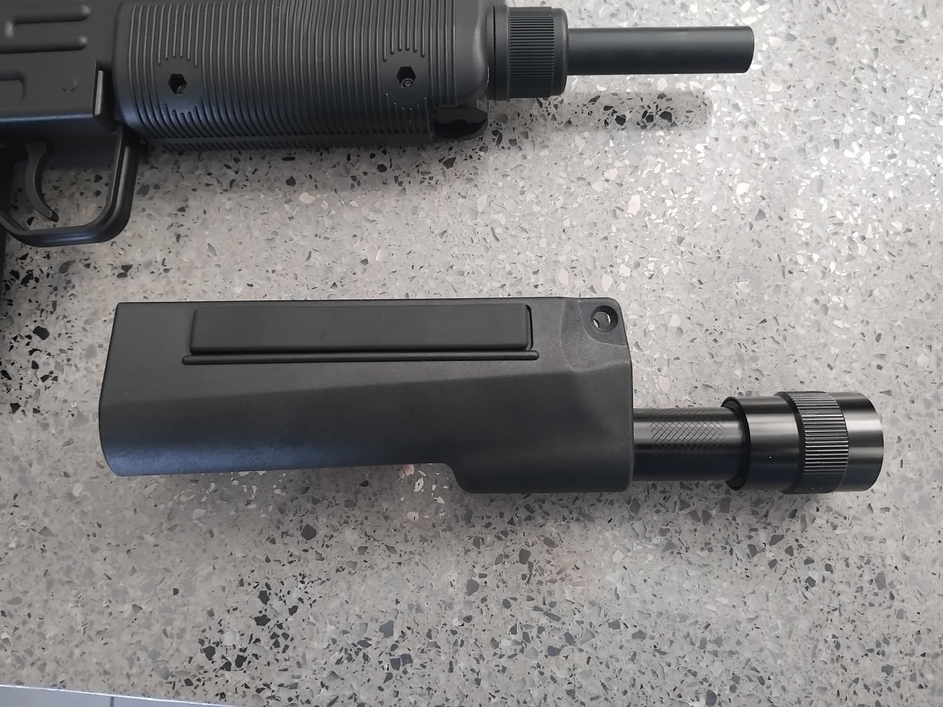

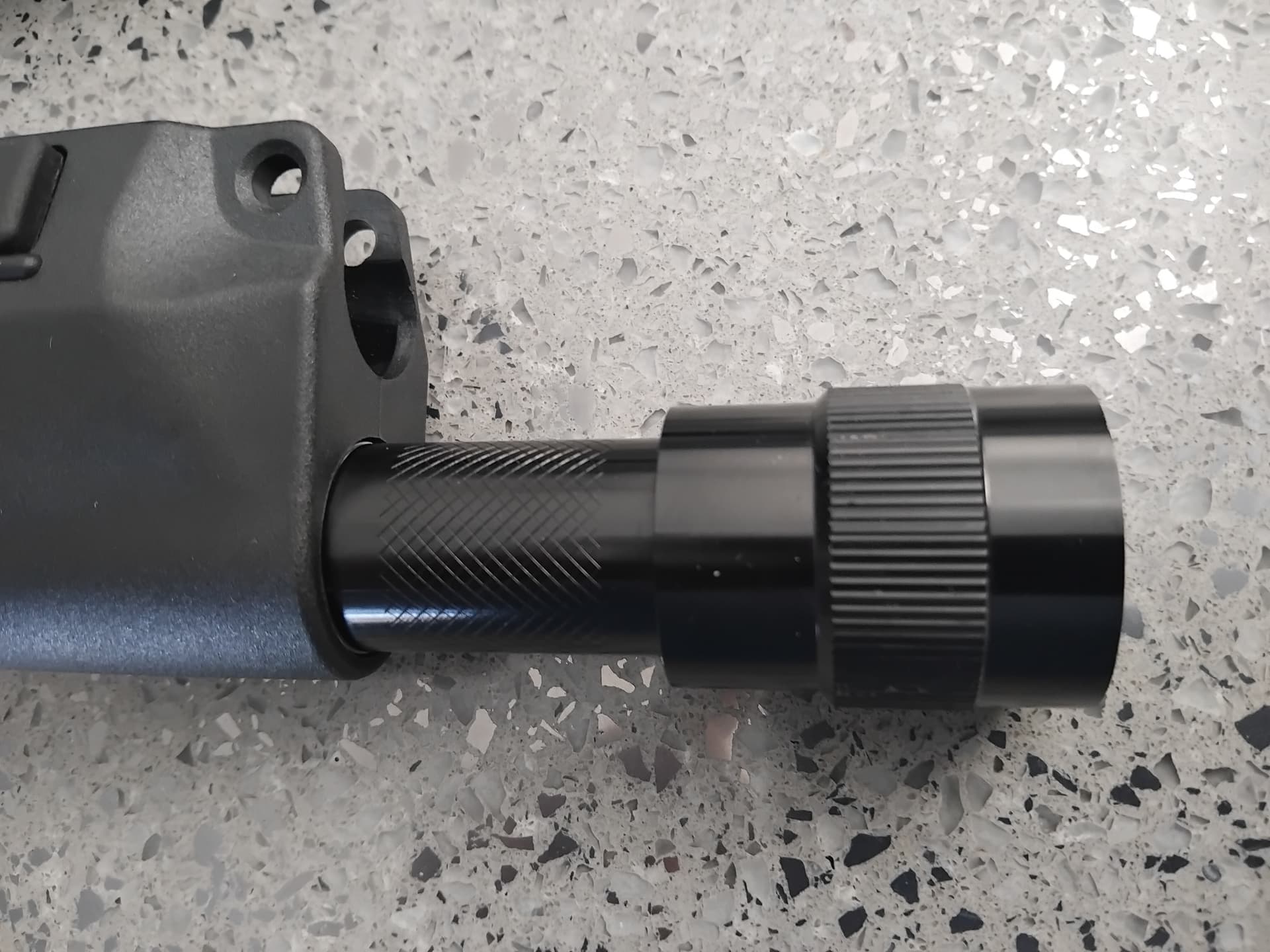

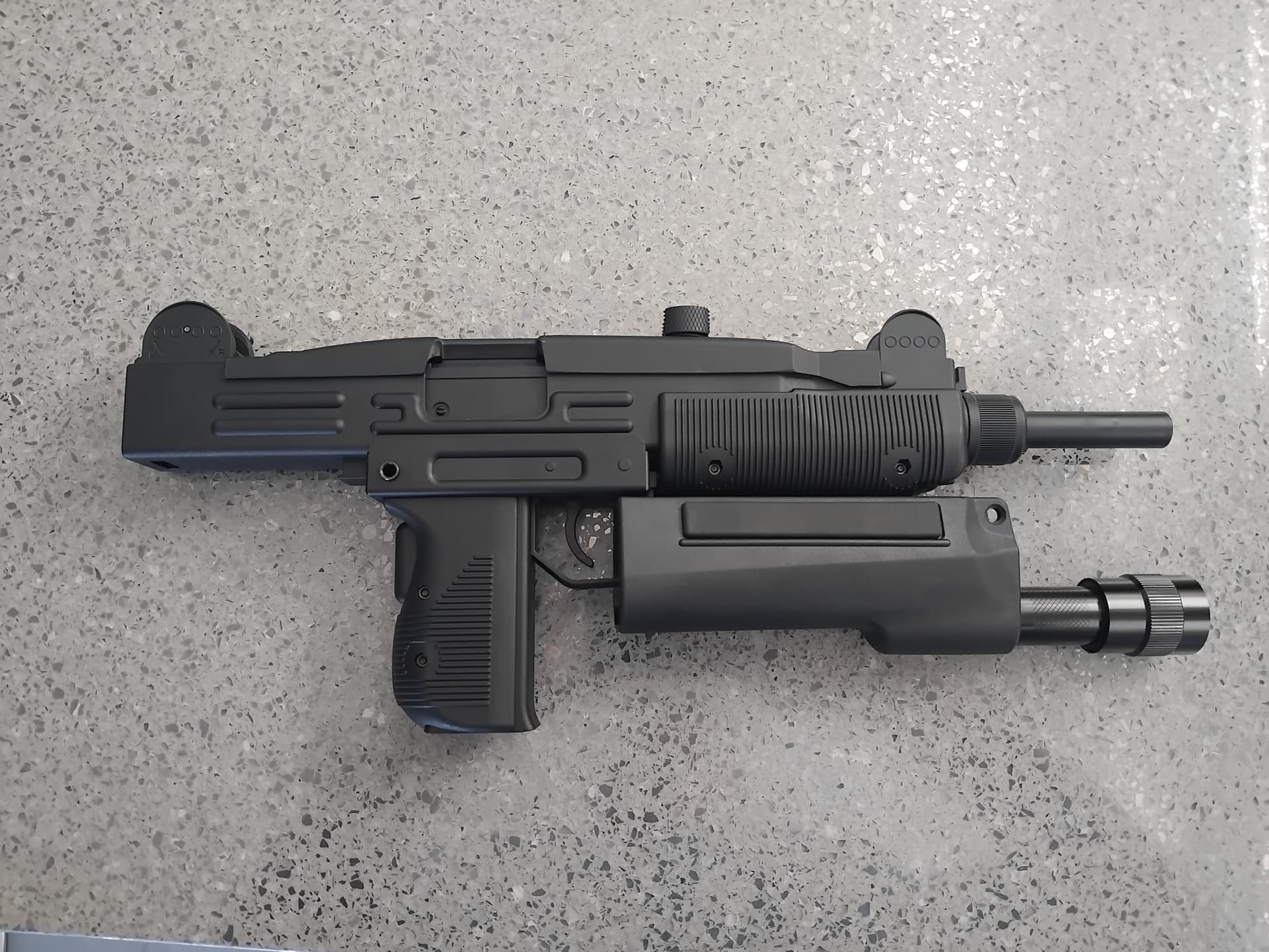

Also…forgot to mention…
Picked up the $10 MP5 light…its all good…
I’m sure you can see where this is going…!
Found this, looking at images online…
Looks cool…wonder how they’d go, getting into Aus…??
SYD customs, anyone…??
