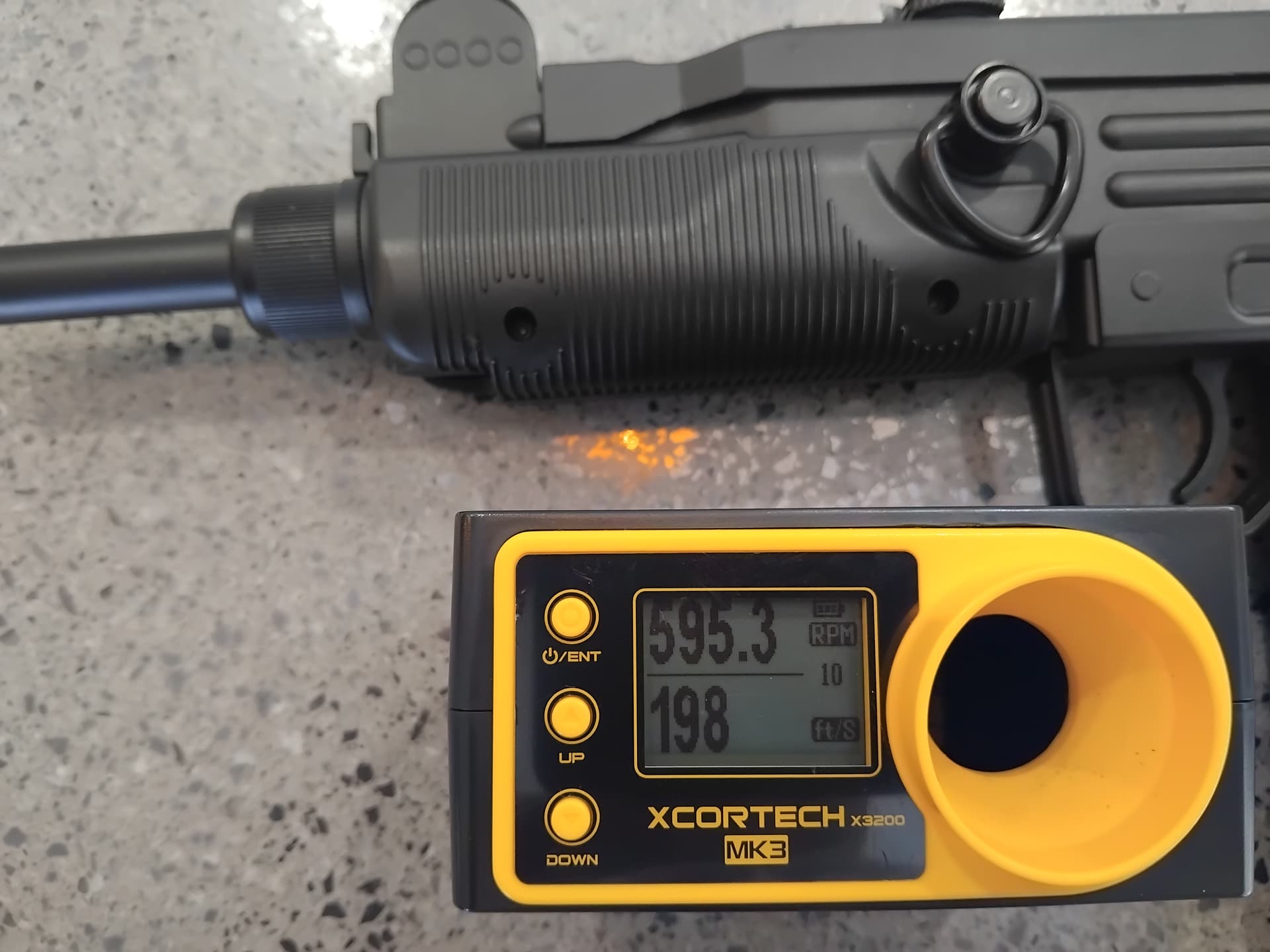

Cant post a photo but…
200fps average, at 590 r/min average… on 7.4 v .
good enough for CQB…!

Uzi post spring spacer upgrade…
a more consistent 190-200 fps…

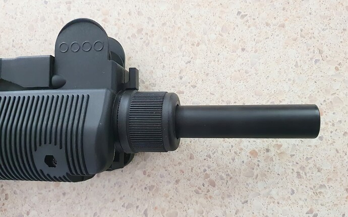

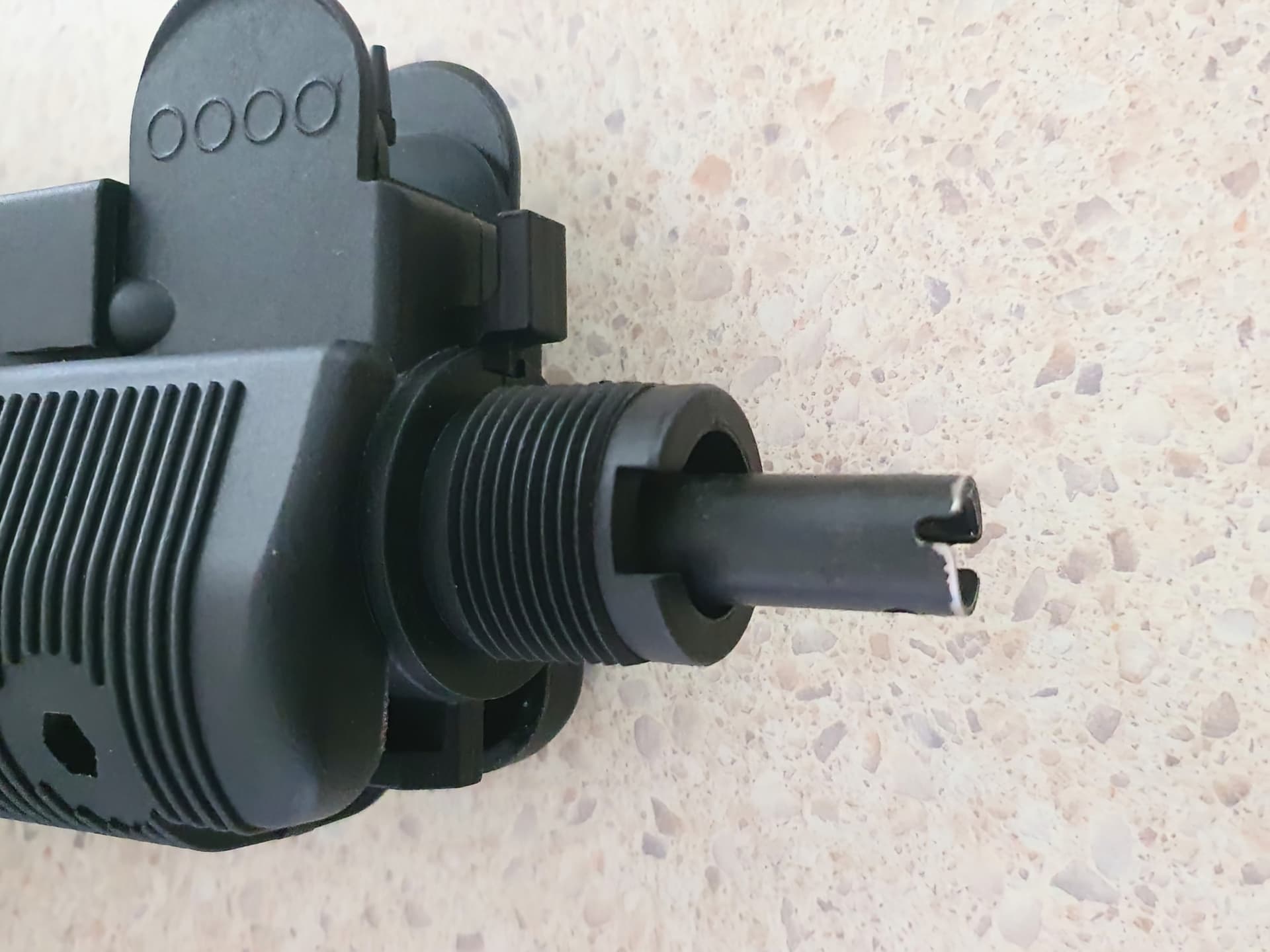

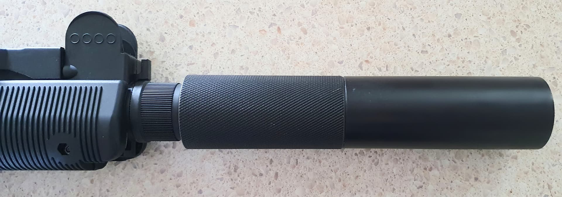

Final stage of development.
11mm slim hop up fitted to the shortened inner barrel and dialled in…
Plastic outer barrel bored out at the receiver end to 11.2mm, neat sliding fit over the hop up.
Still showing high 190-205 FPS, better grouping. But as expected, at longer ranges seems to not hit as hard.
Oh, and a cheeky suppressor because… SMG. :wink:
