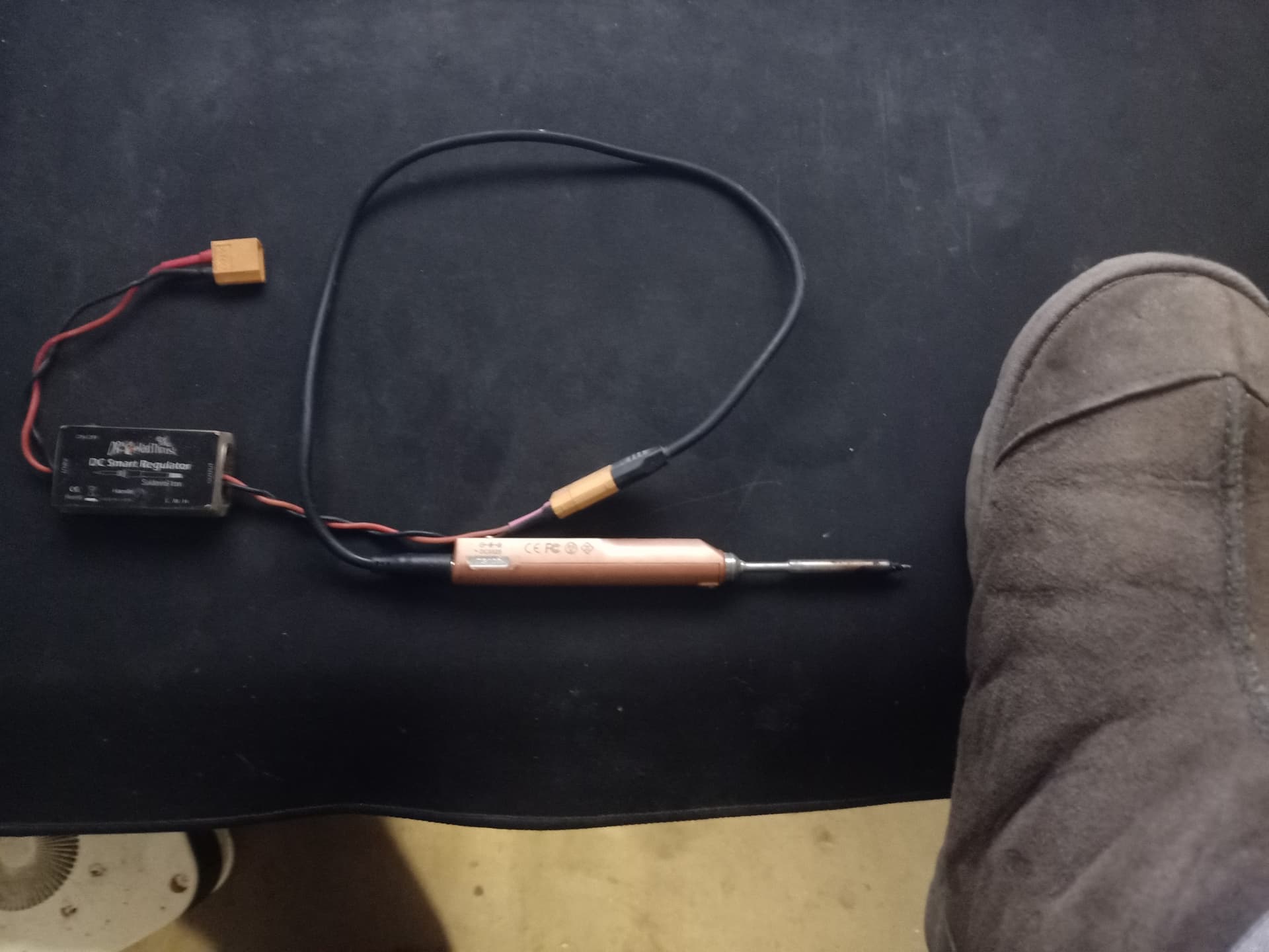

Here this has been my go to for a few years now. You know I’m serious as I threw an UGG boot in for good measure which I never do for just anybody.
Oh look I can plug a 3S lipo in it so I can use it in the middle of bumfuck nowhere to solder a 400hp tractor cable back on which it does nicely. Adjustable power to more than enough for 1/2" cable and tone it down for the finer stuff on what’s those things again, oh yea blasters. It’s a good one Zehamish put me on to many moons ago.

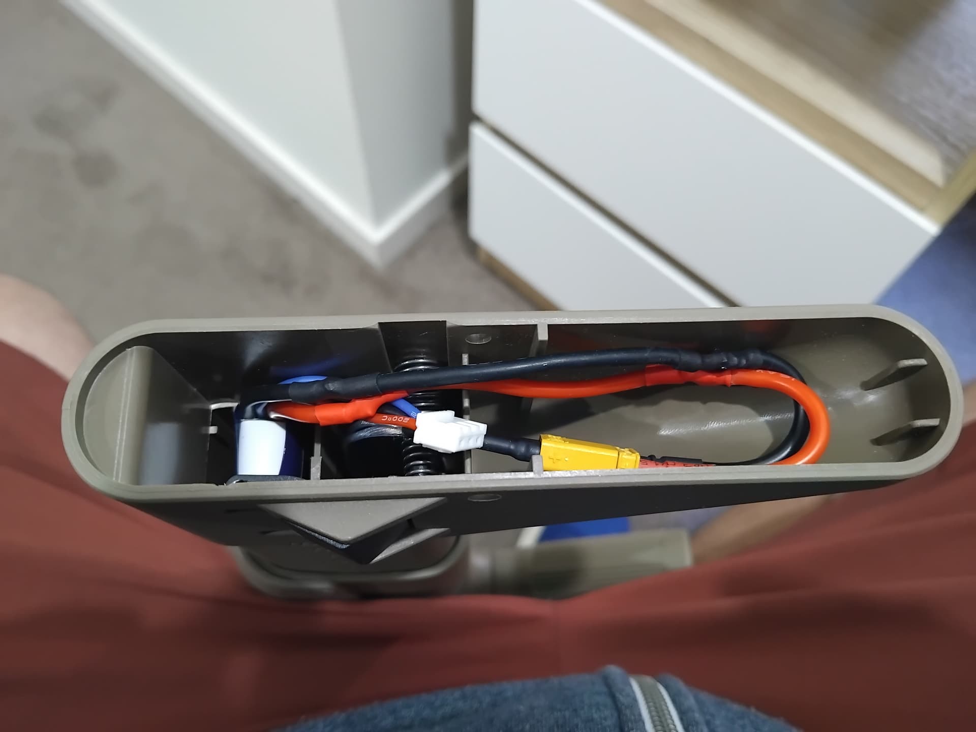

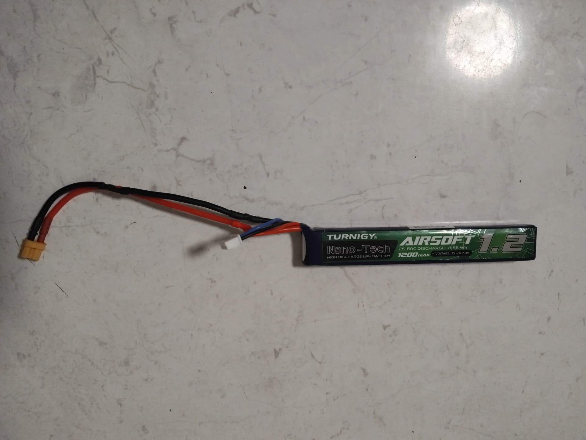

Got the ‘quick n easy’ solution for the existing batteries, @RokSolid …
Just lengthen the existing battery cable by about 5cm… and all is good.
Not as good as replacing all the cabling…but a quick fix to use existing batteries.
went to xforce to look at other battery solutions…
They kindly did a soldering job, on the original battery cable, and lenghtened it. ( Thanks Jamie).
It now fits in properly, stock moves without binding, and xt30 connector barely moves from resting position.
Photos when i get back home…
Ok…

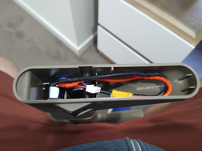

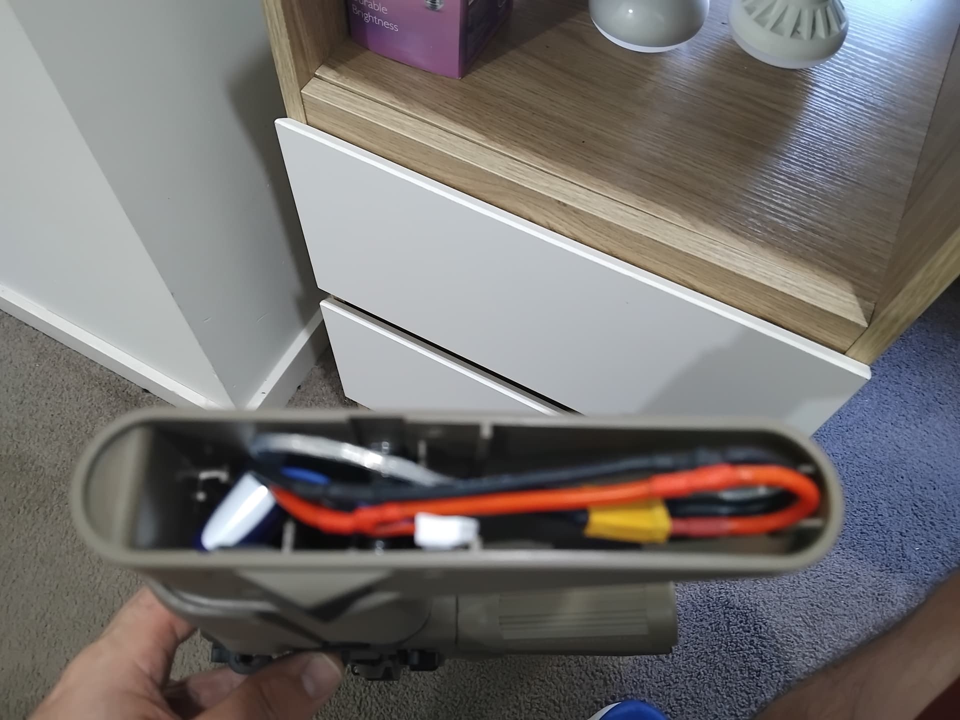

Batt cable extended.
Batt connected…stock Fully Retracted…
And, Stock Fully Extended…
The original battery can move around a bit, in the compartment.
The XT30 Connector barely moves.
Easy Extension / retraction…no pulling on the wires.
Not the ideal solution, with regards to permanent wiring solutions…But…
Quickest and easiest way to get blasters out the door, using existing batteries, with no dispatch faults and nothing snagging causing returns.

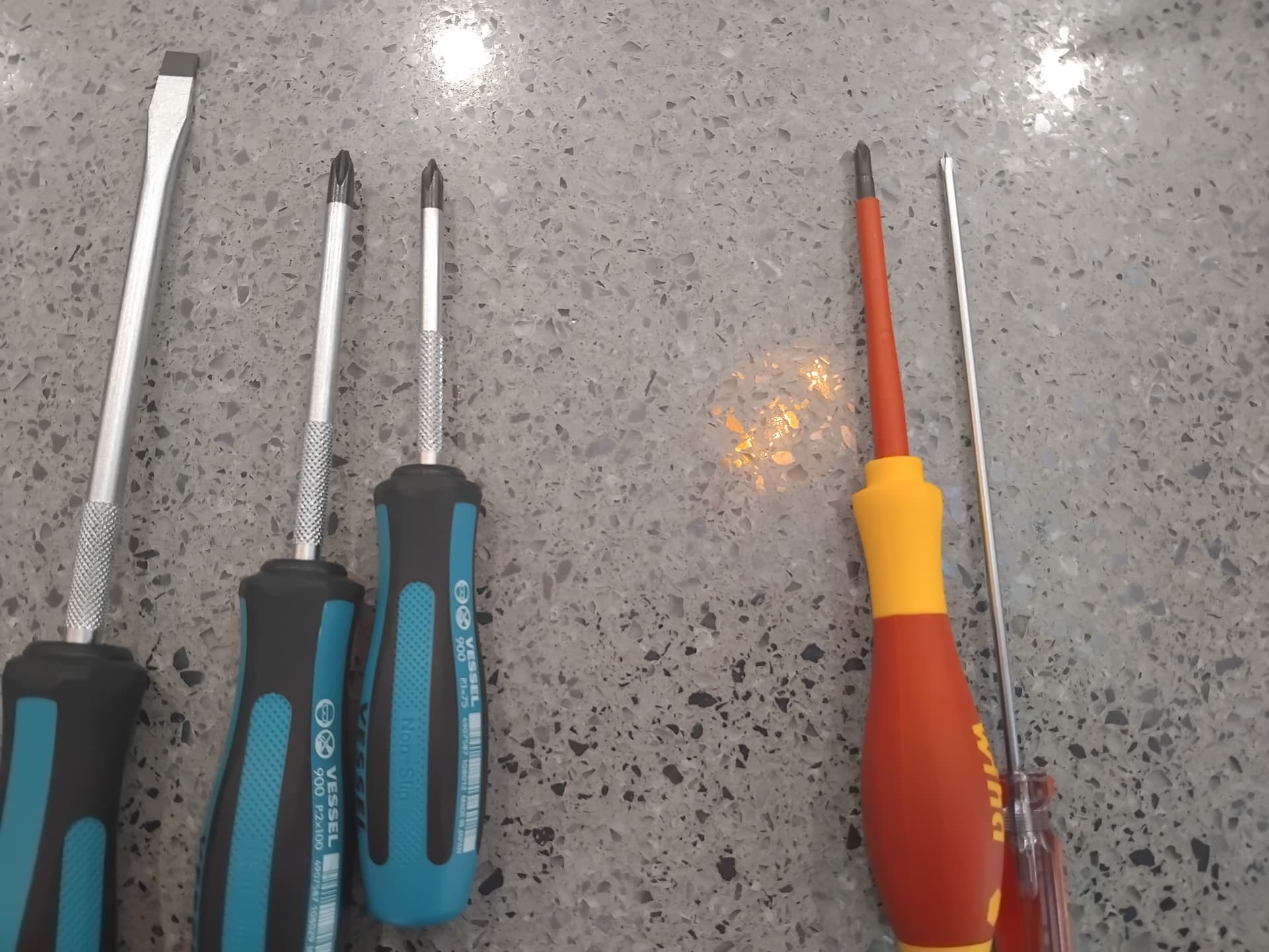

Been meaning to ask, did you get around to a set of Vessel JIS screwdrivers @BME ?
Or is the jury still out on those :joy: You wanna be careful you’ll have everything apart and forget what goes where :rofl: :+1:

Yeah, i got a set from Sydney tools, on sale.
Combo of phillips, and flat edge.
The phillips have the rough, corrugated super grippy heads.
I leave them for the stubborn screws…that grippyness would shred virgin chinesium screws, if its not called for…!!

Oooh… they’re not JIS though, Beemer.
Be careful, Phillips strips screw heads. :person_shrugging:

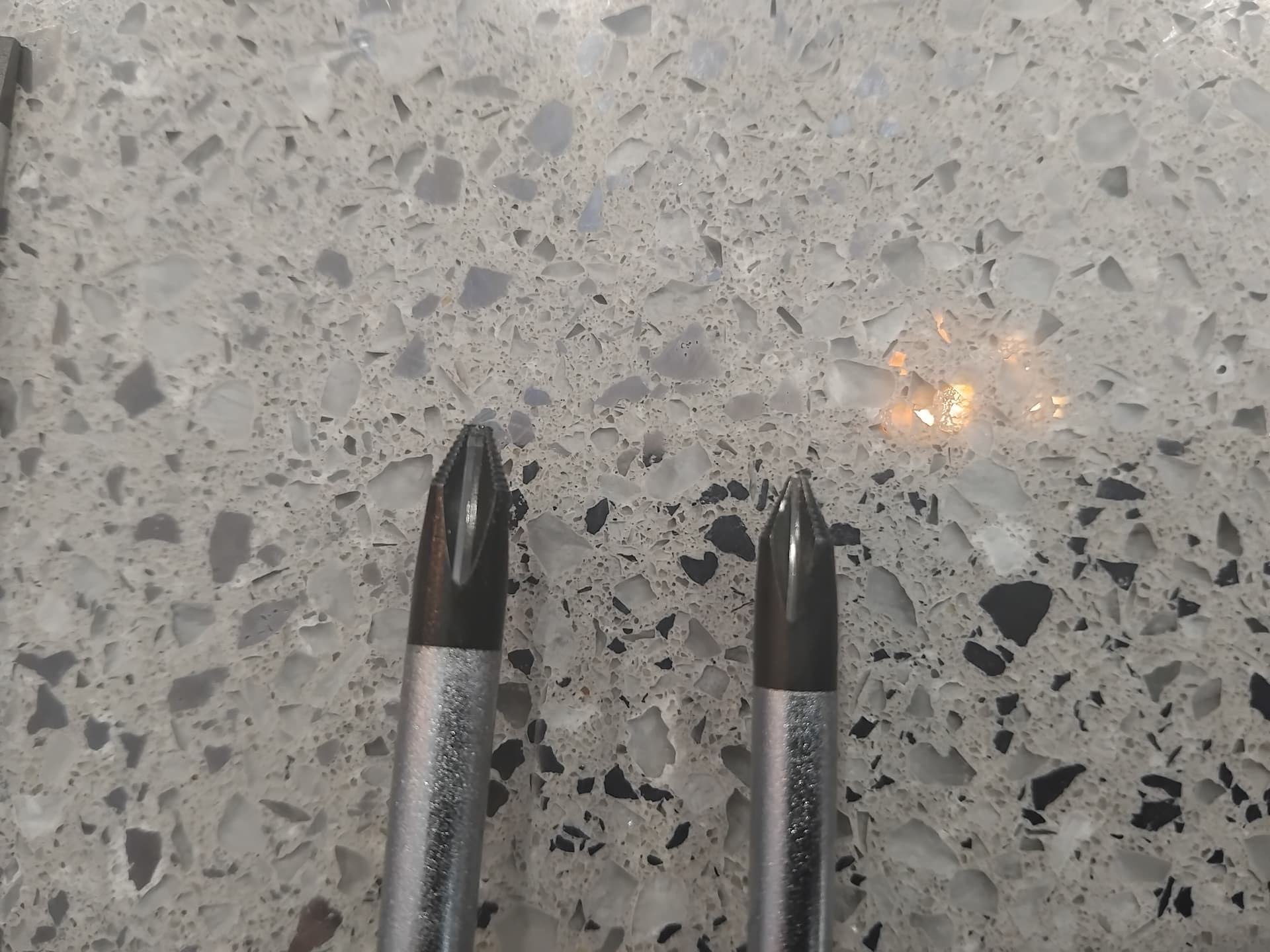

Here’s some of the Vessel drivers…
3 Each, of phillips and flat.
The others on the right, were bought for long reach etc.
If you zoom in on the Vessel phillips…they have a rough corrugated head.
For extra grip, on stuck screws.
Get em out…then get rid of the screw.
I’d only use these of stuck screws… I figure they would mark normal screws if used with force.
Hence, standard screwdrivers used, most of the time…
